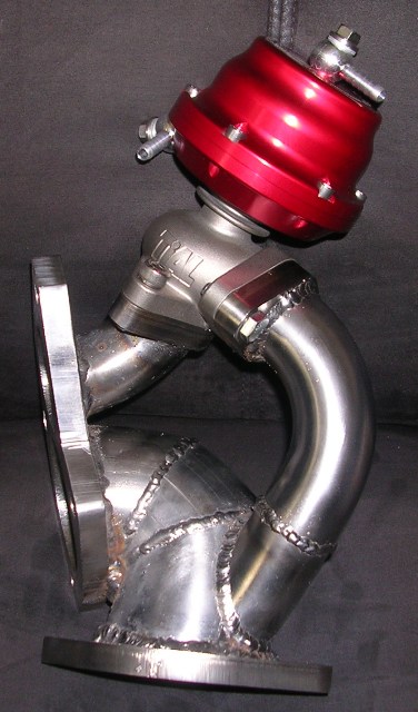

You are running a T3/4 aye?? With a 5 bolt exhaust housing (that has a wastegate port)??
If you are, you can get the port enlarged and run a 38mm WG off it.
Like this:
Or run one of these if you have room:

Nope, Have not sorted the external wastegate yet. I have thought about using a spacer but it would put the turbo through the hood lol.
Yup t3/t4 and yup 5bolt exhaust flange and yup has a hole for the gate, Thought of that too but didn't know if was possible or how you go about doing it ? You mean use the hole that is there for an internal gate correct, Make a hole in the exhaust flange and then use the wastegate from there ?

Yip, thats exactly it!!
I know someplace on the net sells a 5 bolt flange with a 38mm WG flange & V band outlet, just can't find it right now sorry.

What just how it is, it would work ? Like get the hole cut, Pipe and flange put there and that should be sufficient or more like take it in to have that hole made bigger cos it is pretty small anyways? But damn that would save alot of effort and money if I didn't have to try fit it onto the stainless manifold.
That. what you just said again...
Definitely get it ported as much as possible (out with your die grinder & rotary burr).
