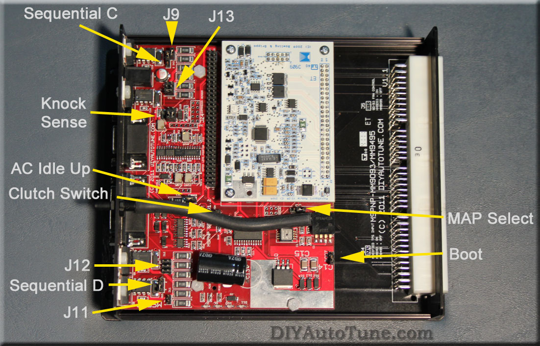

thorburn 123 Report post Posted May 19, 2012 Would you be able to post up some photos of the board? In particular the knock detection part. Didn't realise this was common on pnp megasquirts Quote Share this post Link to post Share on other sites
Andre3000 55 Report post Posted May 19, 2012 Would you be able to post up some photos of the board? In particular the knock detection part. Didn't realise this was common on pnp megasquirts I think knock detection is pre-installed only on the gen2 mspnp. Only gonna work if there is knock sensors originally, but there is an aux connection ready to go if you want to install aftermarket sensors. Quote Share this post Link to post Share on other sites
