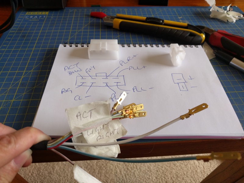

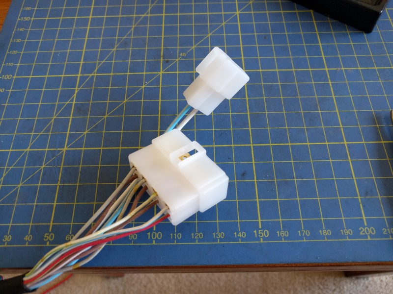

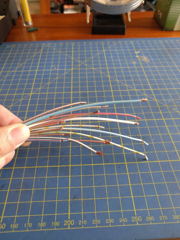

M3AN 4182 Report post Posted November 1, 2017 (edited) It's been a while, not much to say really except the car's off the road at the moment because of a dodgy DME (ECU). In the meantime I've been replacing the wiring loom in the trunk, it's common for the wires from the lid to the main body to wear and break or short (you should check yours if you have an e36 or e39). Anyway, the e36 replacement "repair" loom from BMW (61-12-8-391-788) comes with wire tails and silly little solder connectors so I replaced those with a proper plug. How they come: Spades clamped on ready to solder: Finished plugs: Trunk lid is now done and back together, including routing the existing spoiler cable. Now I need to do the chassis side which will be a little less convenient! Edited May 18, 2018 by M3AN 2 Quote Share this post Link to post Share on other sites

M3AN 4182 Report post Posted November 2, 2017 Finished the trunk loom, should be good for another 20 years and it's one of those little details that I'm hoping sets my example apart from the masses. In the end I ran the spoiler cable (two wires in a rubber sheath) on the outside of the repair loom. Feeding it through just didn't seem feasible (it probably is, I just don't have a method). It's weatherproof and fed through both boots so fits the bill just fine. Pro Tip: when you're checking continuity then your separate earths will still connect... duh. Don't spend 30 mins trying to work that out. Brake light, plate lights, lock actuator and lid closed signal all work! Nice. Quote Share this post Link to post Share on other sites
