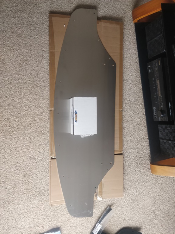

M3AN 4182 Report post Posted September 7, 2020 Long time, little love for the M3. But this arrived today after being ordered in April. I knew it was extended lead time but they originally said July, then August, then September. All's well that ends well. This is just a tempter, more details to follow when I come to install... but feel free to guess. I've been wanting something like this for years. Quote Share this post Link to post Share on other sites
Secniv 182 Report post Posted September 7, 2020 3 hours ago, M3AN said: Long time, little love for the M3. But this arrived today after being ordered in April. I knew it was extended lead time but they originally said July, then August, then September. All's well that ends well. This is just a tempter, more details to follow when I come to install... but feel free to guess. I've been wanting something like this for years. KW Coil overs? Quote Share this post Link to post Share on other sites
M3AN 4182 Report post Posted September 7, 2020 (edited) On 9/7/2020 at 9:40 PM, Secniv said: KW Coil overs? No, nothing that adventurous. Box is 6 foot long. Maybe if the weather's good this weekend? Edited September 19, 2020 by M3AN Quote Share this post Link to post Share on other sites
sweetm3 180 Report post Posted September 7, 2020 Under-tray or front splitter 1 Quote Share this post Link to post Share on other sites

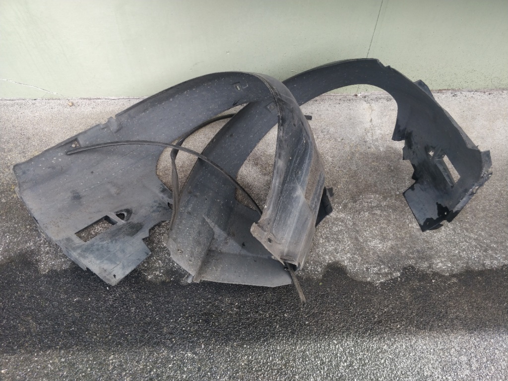

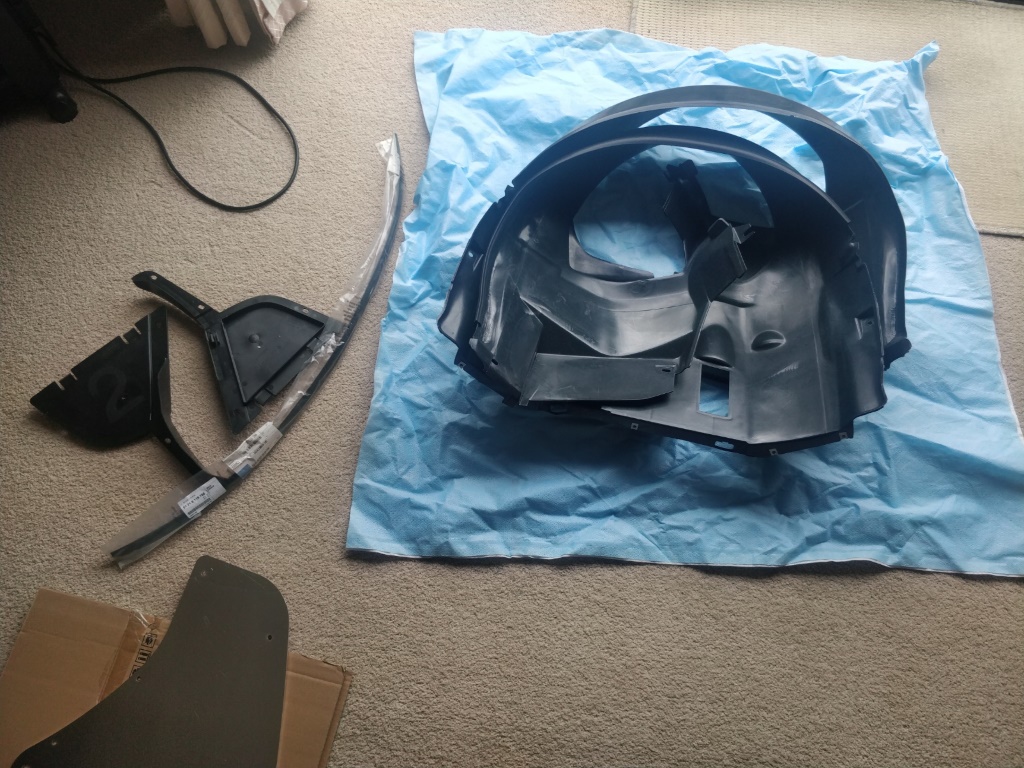

M3AN 4182 Report post Posted September 19, 2020 (edited) Old, torn, worn, tired and broken arch liners out... all the guards checked and swept, no rust at all, just 24 years of crap and some fat spiders... Fresh OE liners with all new hardware ready to go in... Ohh, what's that in the bottom corner @sweetm3? ? Edited September 19, 2020 by M3AN 1 Quote Share this post Link to post Share on other sites

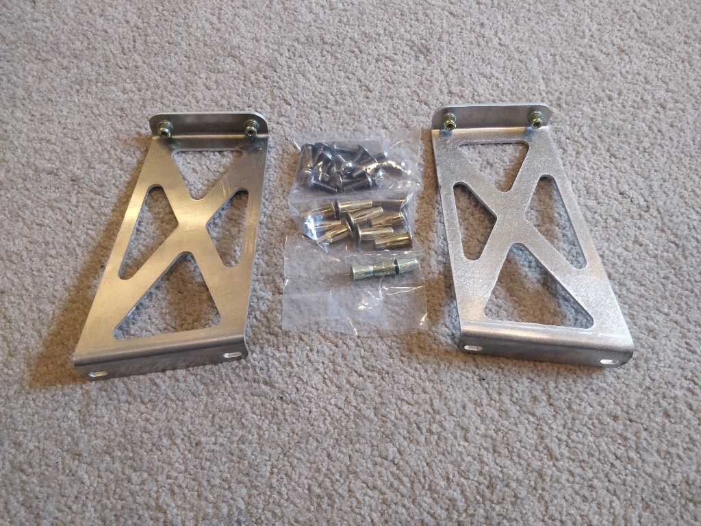

M3AN 4182 Report post Posted September 19, 2020 (edited) I succeeded in installing the new arch liners today, not a terribly difficult job once you've lined everything up and it looks so much better now and they don't flap around in places. I ordered 2 x Turner Motorsport undertrays in the first lockdown (April) and they only arrived the other week. I realised they were on backorder but June slipped to July which slipped to August and then September so I did start to get a little concerned but they arrived well packed in the end, Turners aren't a particularly high risk. But my install attempt failed, they missed sending a rivnut tool with my order but no worries, mate has a mechanical rivnut gun. No bueno. The mandrel on the gun is too short for the longer rivnuts included in the pack and there's no way in hell I can get enough leverage to squeeze the handles to collapse the smaller nuts (which are stronger than the long ones). They've posted the tool and that should be here by next weekend. I have another method to try tomorrow which is essentially the same approach as their tool, we'll see how that goes. Both involve nuts, bolts, spanners and ratchets and, whilst more complex to arrange than with a gun tool (barely) you can lean on a spanner or ratchet assembly so much easier. Regardless, the tray and accompanying hardware is excellent and they've fixed all of the design problems of earlier trays (such as the Motion Motorsport one). I've been waiting so long for a good one. I got two so perhaps I can sort a pattern part? ? Edited September 19, 2020 by M3AN 3 Quote Share this post Link to post Share on other sites

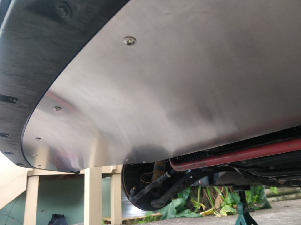

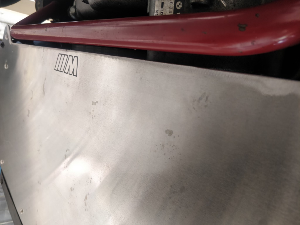

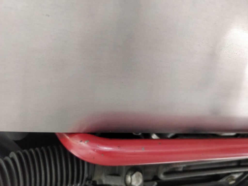

M3AN 4182 Report post Posted September 26, 2020 (edited) So, after some trials and tribulations I got the undertray installed today but she's not ready to drop off the stands because the tray fouls the sway bar (at full droop). Perhaps they haven't found the perfect solution? ? It will be easy enough to fix by trimming ~10mm off the rear of the tray but that shouldn't be necessary. I've gone back to Turner, who have been great so far, but I can't imagine what type of solution they can offer. That issues aside the tray is awesome and locks the whole front end, including my new arch liners together, it's far superior to the jumble of stock plastic bits! Edited September 26, 2020 by M3AN 2 Quote Share this post Link to post Share on other sites
aja540i 1925 Report post Posted September 26, 2020 Just grind some notches in the sway bar, will be mint as bro! 2 Quote Share this post Link to post Share on other sites
M3AN 4182 Report post Posted September 26, 2020 But why ruin a good sway bar? I could just remove it altogether and put it up for $1 reserve, I'll come out ahead that way. ? Quote Share this post Link to post Share on other sites
KwS 2450 Report post Posted September 26, 2020 Does the bar clear at ride hight and only hits it at full droop? If thats the case why not just leave it and move on, the only time you're going to be full droop is on a hoist/stands. Quote Share this post Link to post Share on other sites
M3AN 4182 Report post Posted September 26, 2020 8 minutes ago, KwS said: Does the bar clear at ride hight and only hits it at full droop? If thats the case why not just leave it and move on, the only time you're going to be full droop is on a hoist/stands. Yes, it's clear at normal ride height... but not if I got airborne! Sure, it will only make contact under limited circumstances but it shouldn't at all really. I'm regularly putting my cars on stands and wouldn't want to bother with this every time, you can't really remove it or put it on unless you undo the drop links or prop up the hubs. I don't think getting it cut would be that expensive but I've not explored that yet. Quote Share this post Link to post Share on other sites

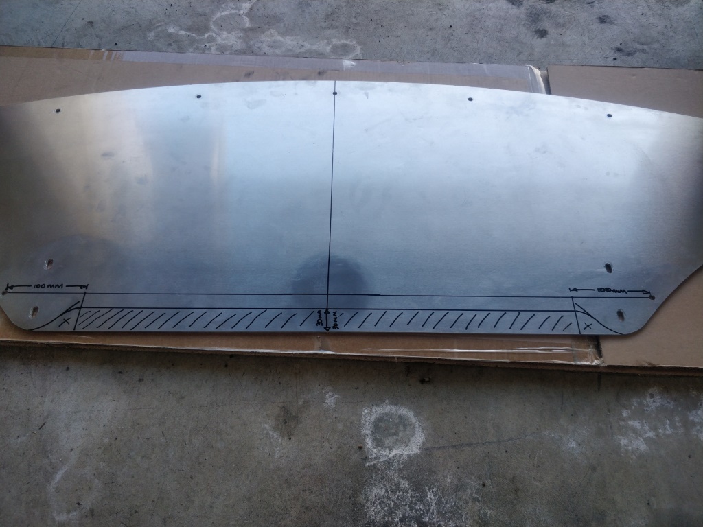

M3AN 4182 Report post Posted October 10, 2020 (edited) The Turner undertray - I've measured up the required cut and, as you can see, this is not a trivial or marginal fitment issue. With the bar set to the softest setting (rearward holes) I need to shave 30mm off the tray, with the bar set to stiffest (forward holes) I'd need to shave a whopping 40mm off the tray. Edited October 10, 2020 by M3AN Quote Share this post Link to post Share on other sites

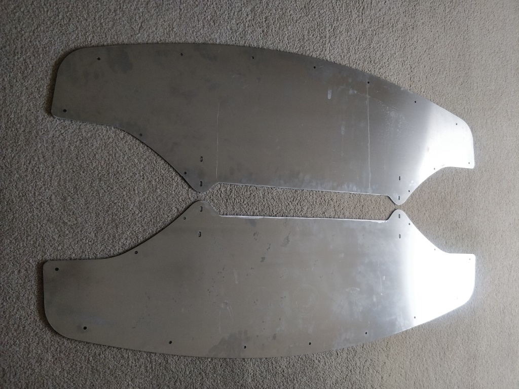

M3AN 4182 Report post Posted October 17, 2020 (edited) I took both under trays around to @aja540i place this afternoon to get them cut to measurement with his plasma cutter and the results are fantastic, I couldn't be happier. He made short work of it too. Thanks Andrew, you're a legend! ? I got one cut back by 30mm and the other by 40mm to allow for a few variations in sway bars. I'll hopefully fit the one I want to go with before Bathurst kicks off tomorrow. Edited October 17, 2020 by M3AN 1 Quote Share this post Link to post Share on other sites
M3AN 4182 Report post Posted October 18, 2020 Fitted up the 40mm cut version today and it's perfect with my swaybar set to the hardest setting. Pic is of car with both front corners at full droop. Ace, thanks again @aja540i. ? Now, to work out how to get these fabricated locally, plate itself is easy, brackets are a different proposition. 2 Quote Share this post Link to post Share on other sites
