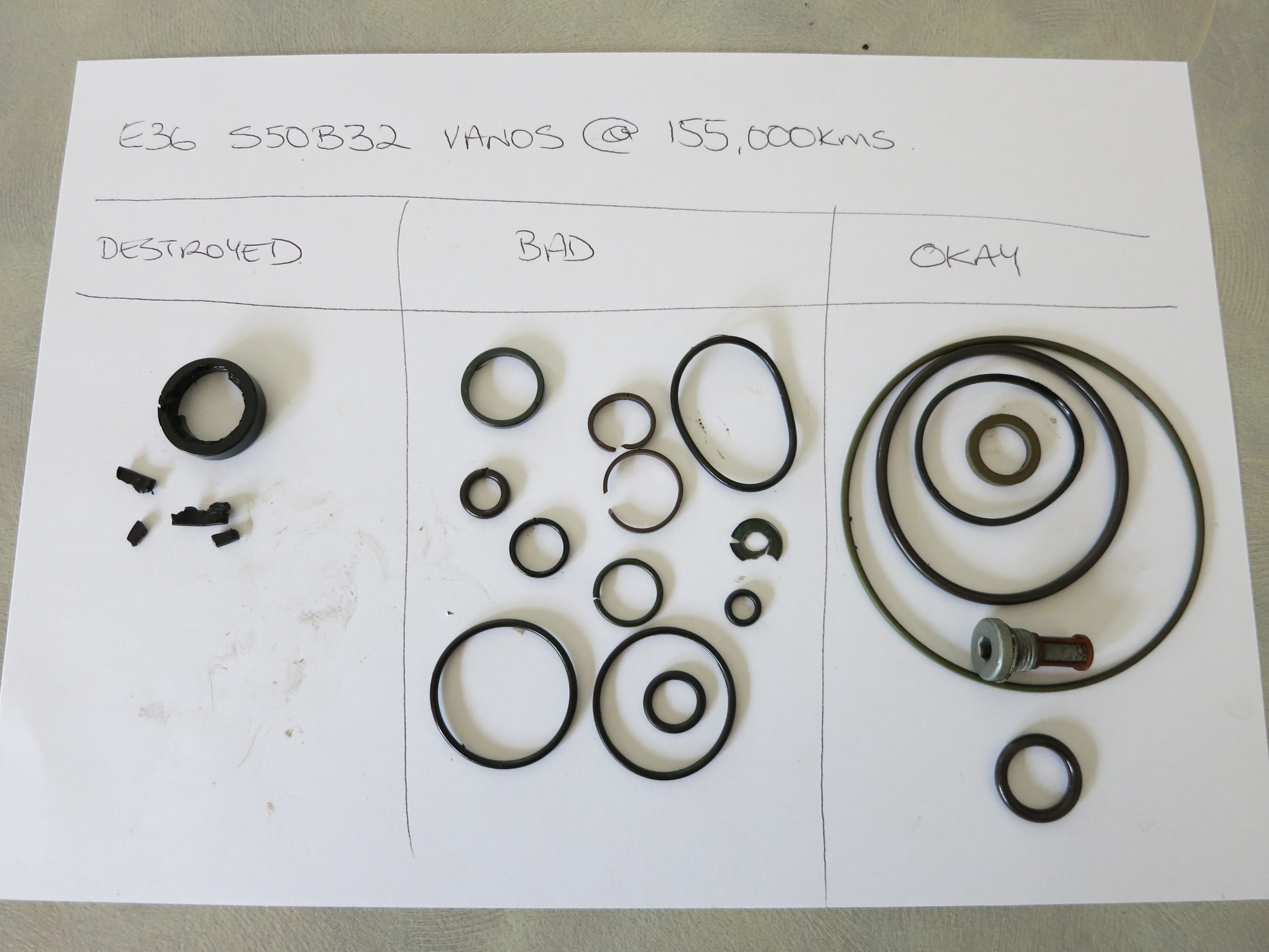

M3AN 4188 Report post Posted February 14, 2014 (edited) Cheers folks. 100km Update Well I'm very, very happy I've done this and there are no obvious leaks or crazy noises after 100km which is good. I am keeping an eye on the discussion in Mark's thread here about the alignment of the shafts before I get too excited. Either way if I am off it's only by a fraction and something I can deal with a little later. NB: Mark (SweetM3) just came around and heard the engine running, he reckons there's nothing wrong with how it sounds. I suspect I'm being paranoid. The Good Peace of mind now that I've done it. Assuming I've built it correctly the VANOS is now bulletproof. Viton and Teflon seals, S62 diaphragms and S54 oil pump retaining bits. Since my solenoids are also sealed in they're unlikely to move/leak either. Here's what came out of my VANOS (some of the 'bad' ones were cut for removal) so the job needed to be done: It runs very, very quite now, especially when warm, There's no ticking or rattling at all and it's almost scary because you can hear all of the other sounds the engine is making. I didn't think it would make such a difference to the noise. In my limited testing so far everything is running smooth (*see below). I enjoyed most of the experience, learned a lot and met some great people. Mark spotted my weak oil pump retaining ring and I got upgraded parts for that too, something to look out for on early S50B32 engines. The Bad It took a LOT longer than expected because of the saga recorded in this thread. The rattle kit procedure makes the job about 1000% more complicated. I'm glad I did it but you need to factor in the exponential increase in complexity. * I'm constantly doubting whether I got it all lined up and correct and I probably worry too much about things I needn't to. I am interested in the discussion in Mark's thread and hope I don't need to do any more work on it. The Ugly Damn chain tensioner! Lining up the exhaust cam sprocket and hub with the cam sensor impeller was a royal pain in the arse. I must have been doing it wrong because it took hours and I couldn't find anybody else who had experienced the same drama. Because resetting this requires the removal of the chain from the intake sprocket and therefore the tensioner and other stuff it's quite the procedure to adjust, reinstall everything and measure... only to find you need to disassemble everything because it's 1mm out... ? Only required if you're doing the rattle procedure. Damn chain tensioner! Edited May 28, 2018 by M3AN Quote Share this post Link to post Share on other sites
