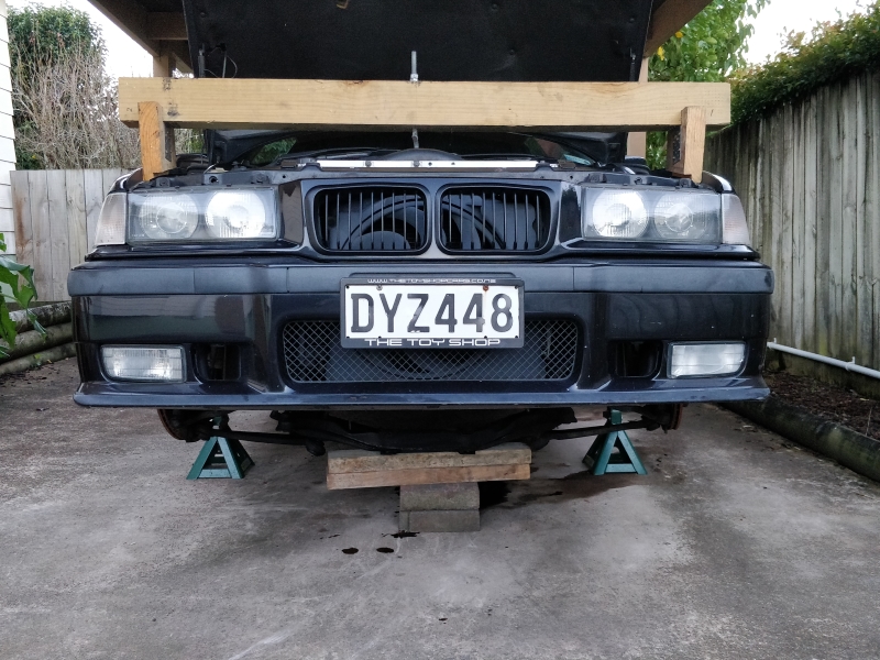

M3AN 4191 Report post Posted May 29, 2018 (edited) Dropped the front subframe today to get at the oil pan, a couple of issues I'll need to work through tomorrow: 1. Can't detach the control arms from the subframe, nuts are off but the bolts won't slide through. I've sprayed them with lube and will check again tomorrow if they come out. It's not essential to get them out I can just hang the subframe down and work around it but it would be easier with it out entirely. 2. Some of the sump bolts are really difficult to get to and I'll need to be creative to get to at least two of them... not sure how yet, ran out of light. Edited May 29, 2018 by M3AN Quote Share this post Link to post Share on other sites

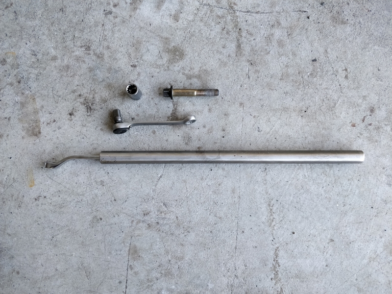

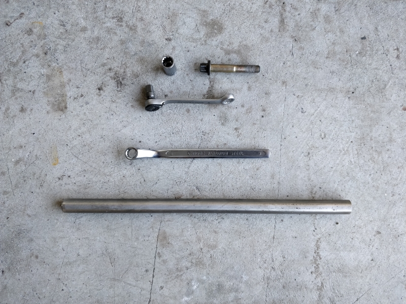

M3AN 4191 Report post Posted May 31, 2018 (edited) Got the bitch. Took another 2 hours and a visit to the local engineering shop. Got the guys to chop the end off a sacrificial 8mm 12 point spanner (it's an external Torx (six point) bolt - 6x2=12) and chop up a piece of steel tube and crimp the end for a tight fit. It was my last idea really. Only had about 1 degree of rotation to crack it but after a few tries I heard that reassuring break. Still took another 10 mins to wind it out, used a tiny ratchet to do that 1 click at a time... Edited July 1, 2018 by M3AN Quote Share this post Link to post Share on other sites

M3AN 4191 Report post Posted June 1, 2018 16 hours ago, zero said: I wonder why it was so tight? Maybe it had had a shunt, or had rusted in? TBH I don't think it was any/much tighter than the other two of the same type. It's just that access was too limited to put a proper tool in there and once anything was in, there simply wasn't enough space to move it. I literally had about 2mm of space to move the tiny 8mm spanner I ended up using - had the head of the bolt been rotated even another 15* I don't think I would have been able to seat the spanner at all. But the 2mm I did have was amplified (to about 10mm) with the extension and that was just enough. I used a small 1/4" ratchet to break the other two free no trouble. Getting it back on and torqued (lol) will be interesting. 7 hours ago, aja540i said: Because there's ALWAYS one ! Yes, I'm discovering this seems to be a law of mechanical engineering. Quote Share this post Link to post Share on other sites

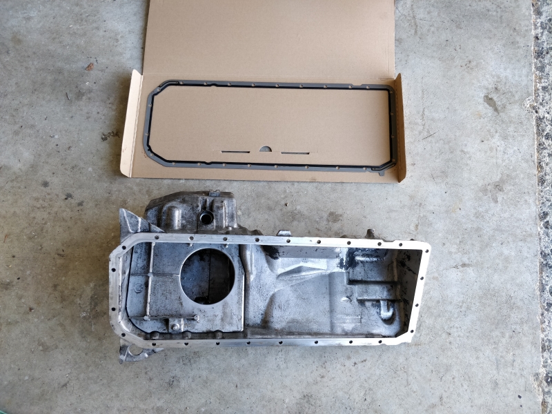

M3AN 4191 Report post Posted June 1, 2018 (edited) Replacement sump and gasket both landed... sets me up for a fun long weekend! Don't think I'll get back under today and my parents have their 50th wedding anniversary (!) on Saturday so perhaps Sunday afternoon, all day Monday, we'll see. Thanks again to @BimmerShaun for a good deal, easy transaction and fast delivery on the replacement sump, it looks to be in great condition! ? Any thoughts on whether to use any sealant and if so how much and where? The gasket actually has what looks to be a sealing material already applied to each side (the black stuff in the picture). Cheers. The great news is that the difficult to get to bolt into the transmission will just need to be tight (but not too tight) and not specifically torqued as it's not a sealing bolt. Edited June 1, 2018 by M3AN Quote Share this post Link to post Share on other sites

Michael. 2313 Report post Posted June 2, 2018 Anymore pictures of your DIY engine holder made of wood? Loooks interesting! Quote Share this post Link to post Share on other sites

M3AN 4191 Report post Posted June 3, 2018 22 hours ago, Michael. said: Anymore pictures of your DIY engine holder made of wood? Loooks interesting! I can take some more no problem. Mark (@sweetm3) made it, it works very well indeed. 16 hours ago, bradgalbraith said: With those control arms you just need to whack them with a hammer and they pop right out, no need to heat up etc. Even if you try get a pet bar between them and the subframe a hammer always does the trick. I did give it a good try, no joy. But as it stands I think I can work around it okay. Quote Share this post Link to post Share on other sites

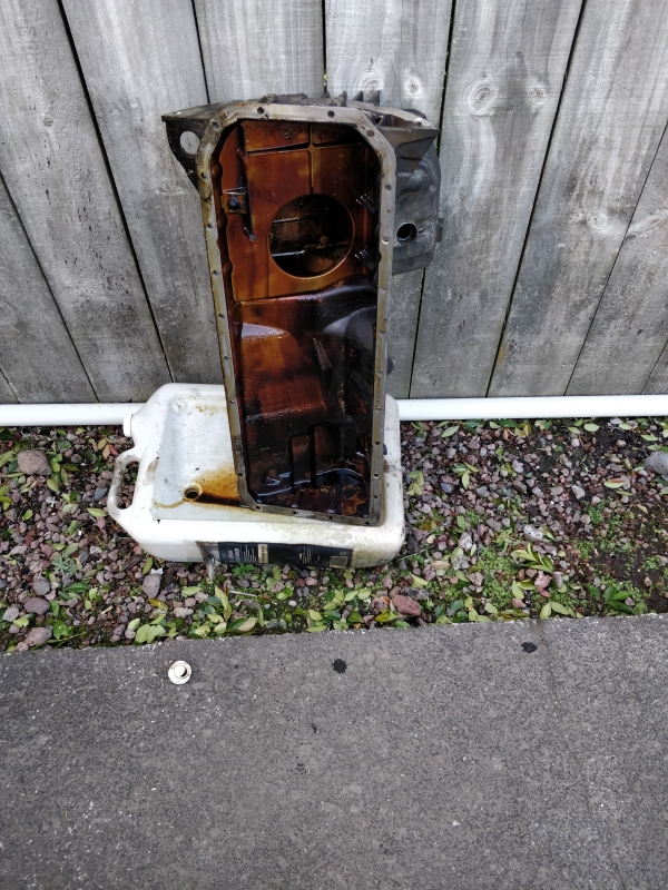

M3AN 4191 Report post Posted June 7, 2018 Some fine (if not cold) weather and I got the bugger out. After a week sitting there with no bolts it just fell off when I removed the dipstick tube. ? Getting it out around everything was a bit of a jigsaw but not too bad in the end. It would be much easier without an auto tranny and the fluid lines up to the cooler. Quote Share this post Link to post Share on other sites

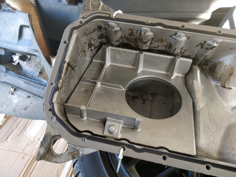

M3AN 4191 Report post Posted June 13, 2018 (edited) The weather has been miserable and I'm working outside so progress has been slow but I got the replacement sump on and all torqued up on Saturday. Looking forward to a fine afternoon tomorrow when I'm hoping to put it all back together. Found a pro-tip for keeping the gasket in place when putting the sump back in... cable ties! Clip them off after you've put a couple of bolts in to locate it all. Worked a treat. Edit: remember to only put cable ties in places that will be easy to reach after you've mounted the sump! Two at the front on opposite sides as in pic and one at the back on the RHS is enough. Edited June 13, 2018 by M3AN 3 Quote Share this post Link to post Share on other sites
