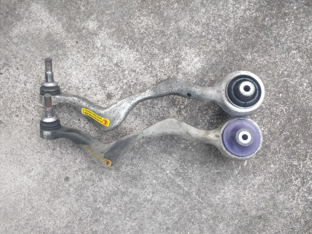

M3AN 4199 Report post Posted June 13, 2020 (edited) Failed to remove the oil filter cap for an oil change so skipped that and moved on to installing the M3 front control arms. I was utterly stoked to find all of the nuts and bolts are new(ish) and had anti-seize on the threads. Somebody has loved this one in the past. Low and behold, as I inspected the current upper arms I noted that they were poly-bushed but removed one anyway to check it out. Turns out it's already an M3 arm, same length as the one I had to put in from the M3... Edit: I've been advised that the M3 and stock arms are the same length, only the bushing is better, the M3 one is far superior to the stock one. The poly bush negates that advantage. So, unless I'm advised otherwise the poly-bushed ones will go back in and I'll sell I've sold (1 hour) the M3 ones to recover my costs. Lower arms are definitely stock... And the M3 bushing is obviously far superior... Should finish tomorrow, then off to Autolign for an alignment. Edited June 13, 2020 by M3AN 3 Quote Share this post Link to post Share on other sites

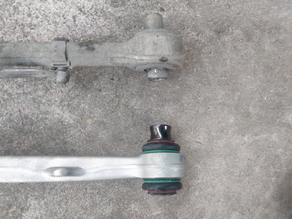

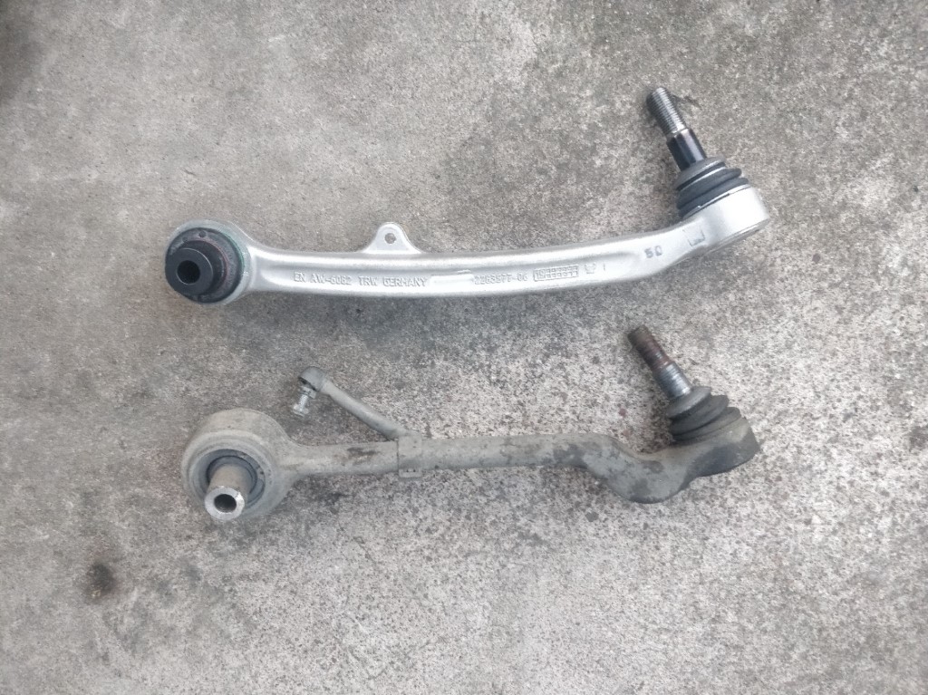

M3AN 4199 Report post Posted June 14, 2020 (edited) I finished the front control arms today, greased, reinstalled and torqued the upper arms and greased, installed and torqued the new lower arms. I also installed the replacement headlight adjuster (Xenon) arm. A few tips: Have a T40 torx bit handy in case you need to hold/lock the ball joint shafts. The M3 bearing assembly on the lower arm is a fraction wider (~0.5mm) than the standard item but a bit of gentle persuasion with a rubber mallet and a block of wood fixed that (3 mins per side). None of the DIY's I read mentioned that the new headlight adjuster arm doesn't come with nuts, you can reuse one from the stock item but you'll need another. A quick bike ride to Mitre 10 and I had a pack of stainless self locking M6 nuts. Took it for a quick drive around the block to see if there were any knocks and, as expected it handles terribly, dangerously even. I certainly wouldn't allow anyone else to drive it in this state. But no knocks and an alignment this week. Also nice to meet @Navin today when he came and picked up the spare M3 arms for what I paid for them so that worked out perfectly. Lovely E82 mate! Holy camber Batman! Edited June 14, 2020 by M3AN 1 Quote Share this post Link to post Share on other sites

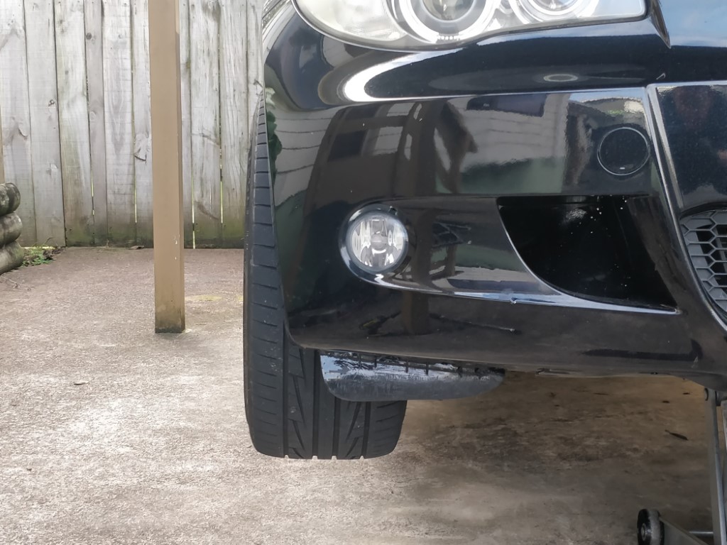

M3AN 4199 Report post Posted June 14, 2020 4 minutes ago, Jacko said: You going for E9x M3 numbers on the alignment? Very little adjustment available so I'll spec my own: Max front camber that can be matched both sides (up to 2 degrees), I'll be surprised if they can get much more than 1.6* so about ideal. Weighing up either 0 toe or perhaps 10 minutes toe out up front for turn-in, if I go out at the front I'll go toe in (50% of front e.g. 5 minutes) at the rear for tracking. Might go for 0 all around to experience the new camber changes alone... undecided. Raise the rear ride height by 5mm - to see if that eliminates the slight rubbing I get with the 255's on there at the moment. Max rear camber which will be very little I imagine (I don't know what e87 spec is to be honest). I have a bit of time to decide, can't get an alignment until next week now. The M3 will get some love in the meantime. Quote Share this post Link to post Share on other sites

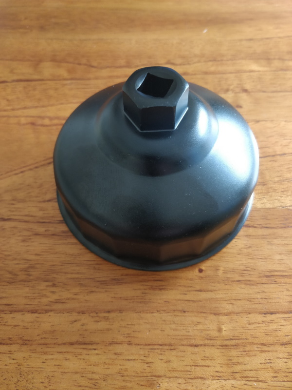

M3AN 4199 Report post Posted June 19, 2020 I didn't realise this would be so inexpensive, nor did I know this tool actually existed. I thought the "proper" tool was the vice grip like one which I didn't particularly want. So, all going to plan oil change this weekend. 1 Quote Share this post Link to post Share on other sites
Jacko 2402 Report post Posted June 19, 2020 Next week, the can opener... no need to smash cans with rocks anymore! 1 Quote Share this post Link to post Share on other sites
Eagle 1788 Report post Posted June 19, 2020 4 hours ago, M3AN said: I didn't realise this would be so inexpensive, nor did I know this tool actually existed. Shouldn't need to exist it weren't for cost costing or dissuading people to work the car. Goes along some of the low rent air, cabin filter and under tray designs that appeared in the first N series motors, probably VAG inspired. Quote Share this post Link to post Share on other sites
M3AN 4199 Report post Posted June 19, 2020 1 hour ago, Eagle said: Shouldn't need to exist it weren't for cost costing or dissuading people to work the car. Goes along some of the low rent air, cabin filter and under tray designs that appeared in the first N series motors, probably VAG inspired. Yes, and no dipstick! ? 1 Quote Share this post Link to post Share on other sites
Jacko 2402 Report post Posted June 19, 2020 No choke or ignition advance lever for the magnetos either! 1 Quote Share this post Link to post Share on other sites
M3AN 4199 Report post Posted June 20, 2020 (edited) Used my new tool today and completed the oil change. The oil and the filter that came out weren't pretty which undermines the claim on the MTA window sticker about the last oil change. It did however have a magnetic drain plug (another good sign that it's been owned by an enthusiast) and there wasn't a spec on it. Filled it back up with 6.5 litres of golden HPR5 5w40 and a new K&N filter (which I've been advised I should have skipped for the Mann Mahle brand - so I'll change it after 1000kms, no harm done) and she's good to go. 127,558 km for the record. Currently aiming to pick up an M3 front sway bar and need to keep my eyes open for an equivalent rear. Alignment on Tuesday. Exciting. ? Edited June 21, 2020 by M3AN Quote Share this post Link to post Share on other sites

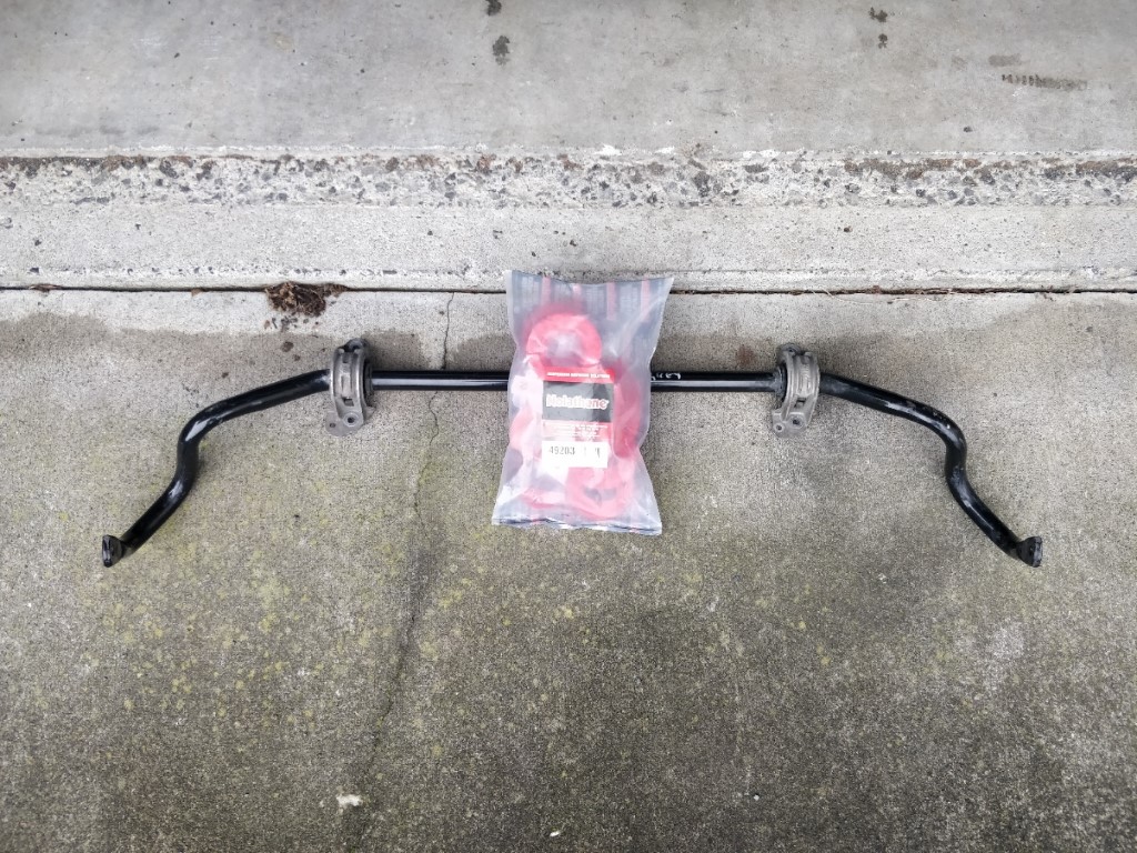

M3AN 4199 Report post Posted June 21, 2020 (edited) And just collected these, thanks for a simple and good deal Kyle (@///M) - spied your car at the same time, looks like a nice example! Not sure when I'll install them, the front bar (e9x M3) is relatively easy, a bit more faffing around to get the rear bushing inserts installed. I might order new drop links (and some oil filters) from FCP. Edited June 21, 2020 by M3AN 2 Quote Share this post Link to post Share on other sites
