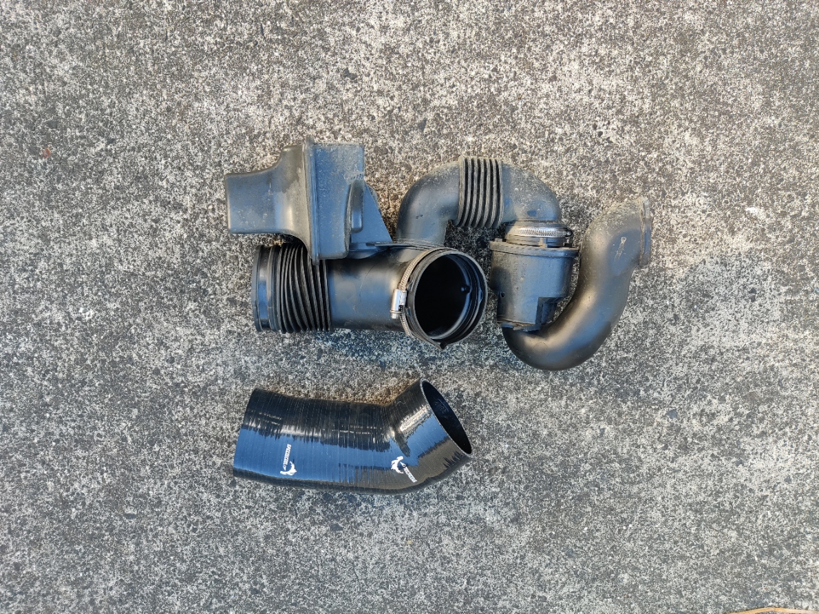

M3AN 4182 Report post Posted May 1, 2021 Installed my speed and cool stuff... fits fine, what it does remains to be seen. Quote Share this post Link to post Share on other sites
gofaster 102 Report post Posted May 1, 2021 excuse my ignorance Dave, but where does the speed and cool stuff go? Quote Share this post Link to post Share on other sites
M3AN 4182 Report post Posted May 2, 2021 4 hours ago, gofaster said: excuse my ignorance Dave, but where does the speed and cool stuff go? It's the pipework between the air box and intake manifold. Quote Share this post Link to post Share on other sites
qube 3570 Report post Posted May 2, 2021 Link please for the speed and cool flame intake hose? Quote Share this post Link to post Share on other sites
M3AN 4182 Report post Posted May 2, 2021 (edited) On 5/2/2021 at 1:14 PM, qube said: Link please for the speed and cool flame intake hose? https://www.aliexpress.com/item/1005001971634527.html Although it was less than that two months ago... but still, that's half the cost of the Mishimoto one! Edited August 9, 2023 by M3AN Quote Share this post Link to post Share on other sites
NZ_InFerno 397 Report post Posted May 2, 2021 I've had one of those sitting here ready to install for a couple months now, not a speed and cool one but a Turner Motorsports. Any differences with it installed? How easy was it to put in? Quote Share this post Link to post Share on other sites
M3AN 4182 Report post Posted May 2, 2021 (edited) 14 minutes ago, NZ_InFerno said: Any differences with it installed? How easy was it to put in? I haven't noticed any appreciable difference to be honest but it was easy to install... remove airbox, unbolt power steering fluid reservoir and move it out of the way, undo existing hardware, install new hardware... maybe 30 mins? Edited May 2, 2021 by M3AN 1 Quote Share this post Link to post Share on other sites

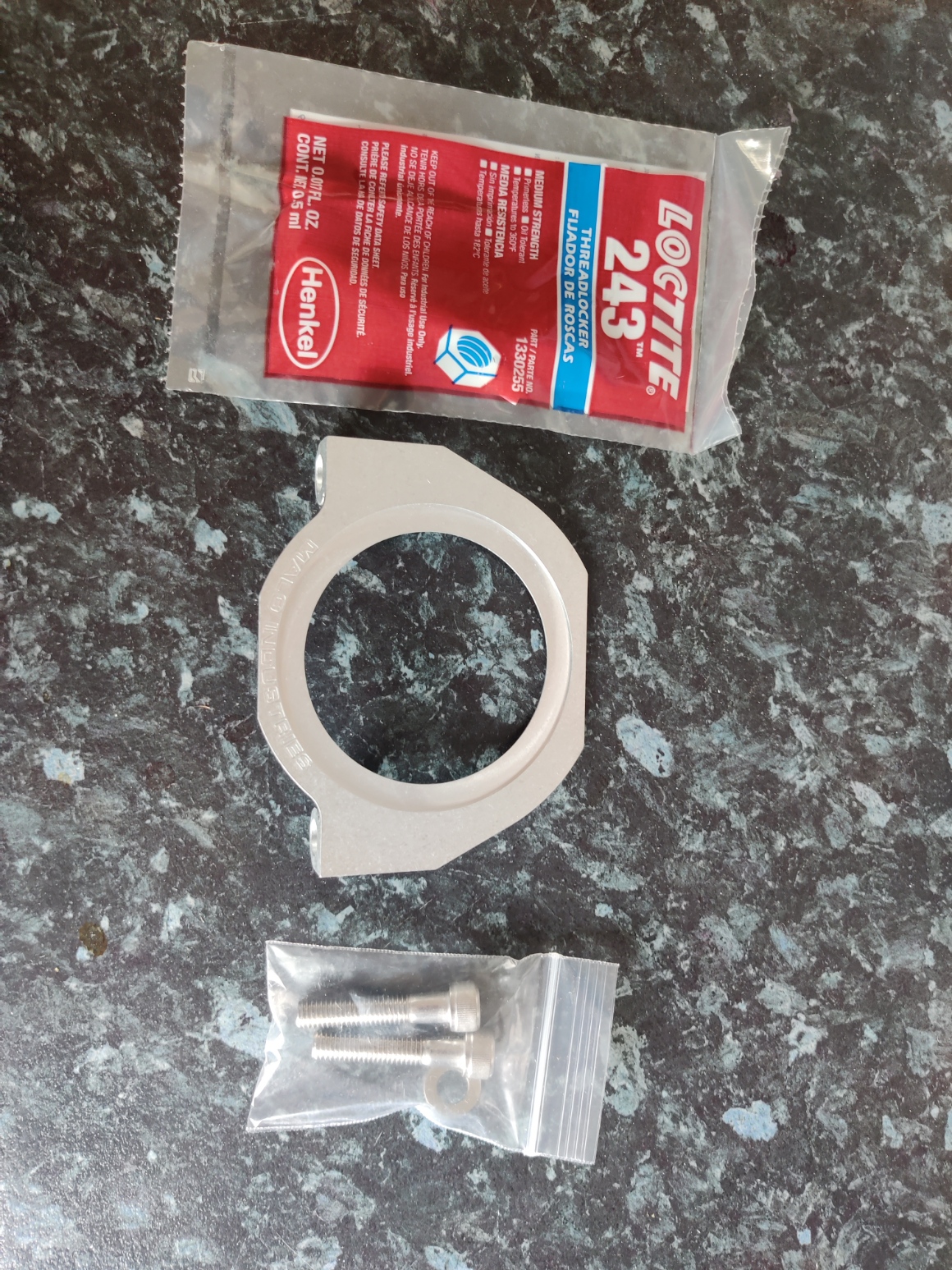

M3AN 4182 Report post Posted May 7, 2021 New bits arrived from Canada to prevent an uncommon but catastrophic engine failure on the N52... belt ingestion. 1 Quote Share this post Link to post Share on other sites

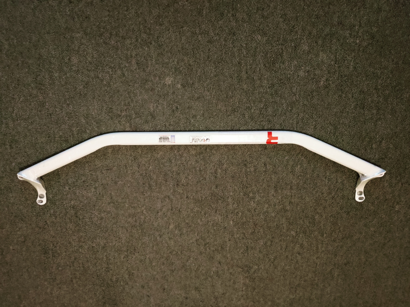

M3AN 4182 Report post Posted July 9, 2021 (edited) Acquired... Front strut bar... necessary? Probably not. Worth a punt? Probably and won't hurt. Edited July 9, 2021 by M3AN 1 Quote Share this post Link to post Share on other sites
IainR 55 Report post Posted July 9, 2021 12 hours ago, M3AN said: Yes, and 18 months in they're still so awesome. I drove a normal auto about two months ago and kept reaching for "my" paddles, it was a terrible experience. Thanks! These are definitely top of my list 😍 Which version did you go for? There seems to be V1, V2 & 'Steptronic'🤔 Quote Share this post Link to post Share on other sites
M3AN 4182 Report post Posted July 9, 2021 3 hours ago, IainR said: Thanks! These are definitely top of my list 😍 Which version did you go for? There seems to be V1, V2 & 'Steptronic'🤔 Just looked back at my invoice... BMW E-series (Pre-LCI/Steptronic) V1 Paddle Kits × 1 (Billet Black) https://www.nelsonracingwheel.com/collections/paddle-shifters/products/bmw-e-series-paddle-kits?variant=15653226545187 1 Quote Share this post Link to post Share on other sites

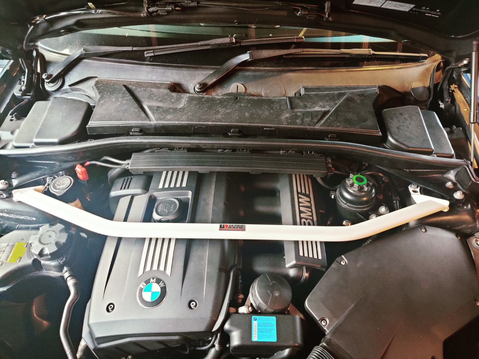

M3AN 4182 Report post Posted July 10, 2021 Installs easily enough, even accommodates the "camber pin mod". Car seriously needs a wash! Quote Share this post Link to post Share on other sites
Jacko 2334 Report post Posted July 10, 2021 30 minutes ago, M3AN said: Installs easily enough, even accommodates the "camber pin mod". Car seriously needs a wash! Is it OK? I had Ultra racing braces on my E30 and they were made of some sorta cheese based alloy (it was softer than 6061T3), I'm hoping they've improved. Quote Share this post Link to post Share on other sites
M3AN 4182 Report post Posted July 10, 2021 2 hours ago, Jacko said: Is it OK? I had Ultra racing braces on my E30 and they were made of some sorta cheese based alloy (it was softer than 6061T3), I'm hoping they've improved. It seems fine, good welds and proper powder coat. I'm far less dubious about them now than I used to be, have one in the rear of the M3 and it's sweet. Quote Share this post Link to post Share on other sites

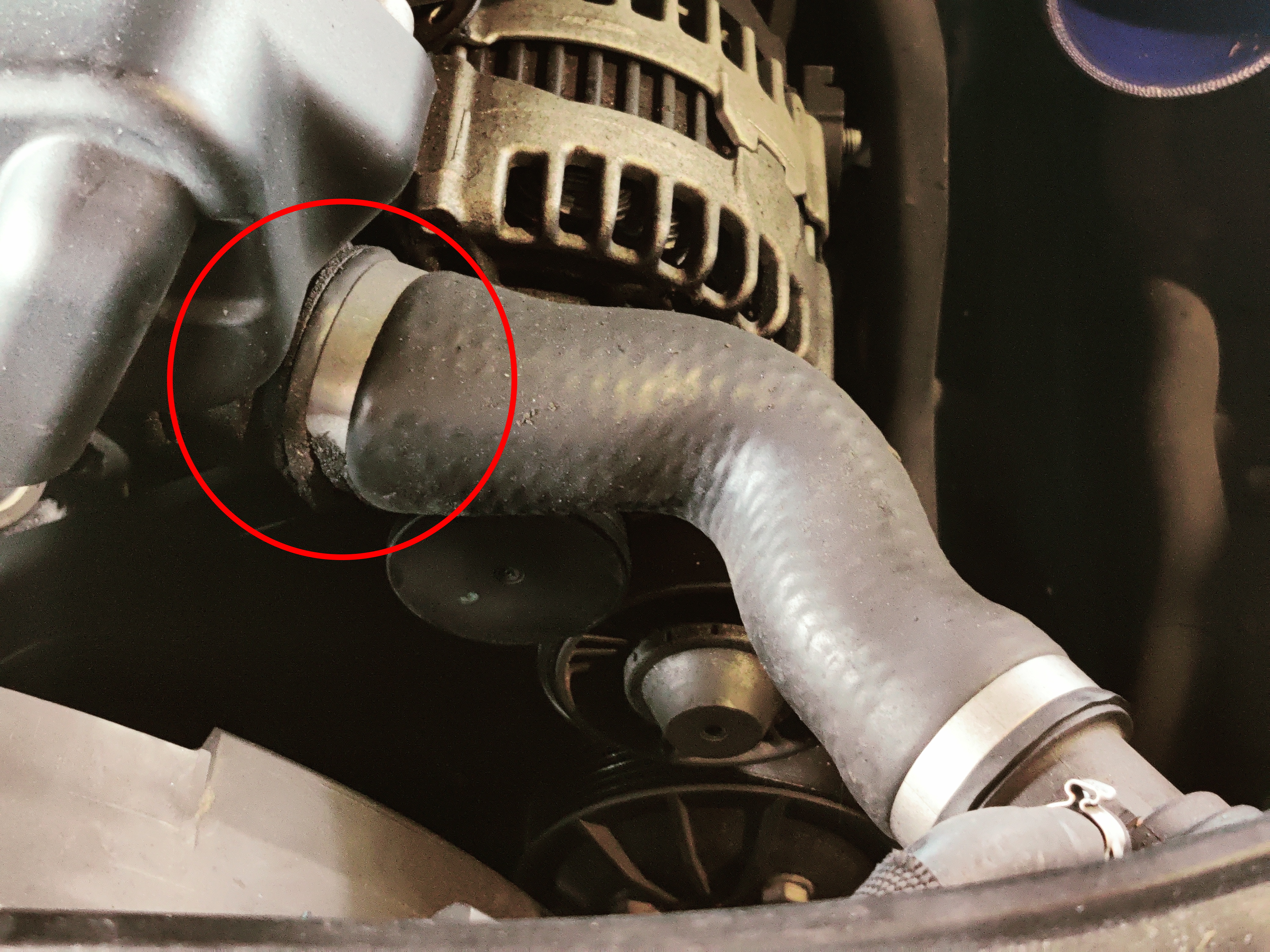

M3AN 4182 Report post Posted June 6, 2022 Two weeks or so ago I pulled out of my garage and left a small pool of coolant, kept an eye on vitals as I drove the short trip to work. Left another small pool in my parking spot at work and got a low coolant warning as I pulled into the driveway at home. For various reasons I've not driven, or been able to work on the car since then. Pulled bits and pieces off today to have a look and was initially pleased to find it was only the upper radiator hose, but then I saw that BMW have made it far more complicated as a single part than it needs to be. 🙄 I read they're a crap design from various forum posts here and elsewhere. At least they're readily available in NZ. 3 Quote Share this post Link to post Share on other sites
NZ_InFerno 397 Report post Posted June 6, 2022 5 minutes ago, M3AN said: Two weeks or so ago I pulled out of my garage and left a small pool of coolant, kept an eye on vitals as I drove the short trip to work. Left another small pool in my parking spot at work and got a low coolant warning as I pulled into the driveway at home. For various reasons I've not driven, or been able to work on the car since then. Pulled bits and pieces off today to have a look and was initially pleased to find it was only the upper radiator hose, but then I saw that BMW have made it far more complicated as a single part than it needs to be. 🙄 I read they're a crap design from various forum posts here and elsewhere. At least they're readily available in NZ. Good early spotting. Makes me wary of my cooling system. Whole lot is still the original. 1 Quote Share this post Link to post Share on other sites
M3AN 4182 Report post Posted June 6, 2022 1 hour ago, NZ_InFerno said: Makes me wary of my cooling system. Whole lot is still the original. Yeah, I don't know the provenance of my cooling system either. This will be a quick fix but I think I'll start working out the parts list for a full overhaul come next summer. Although I'll keep the radiator, it still looks mint on both faces and around the joints. 1 Quote Share this post Link to post Share on other sites
NZ_InFerno 397 Report post Posted June 6, 2022 5 minutes ago, M3AN said: Yeah, I don't know the provenance of my cooling system either. This will be a quick fix but I think I'll start working out the parts list for a full overhaul come next summer. Although I'll keep the radiator, it still looks mint on both faces and around the joints. I'd be interested in that list! Changing the cooling system along with the front pulleys and belt, I'd have done nearly everything on the motor 😅 Quote Share this post Link to post Share on other sites
M3AN 4182 Report post Posted June 6, 2022 I still need to do all the motor seals and gaskets, another "next summer" job. 😇 Whilst it's not a priority at the moment I will share the list once I've created it. Just ordered the OEM (Renn) hose from Australia for $5 less, delivered, than I could have got a no-name brand locally and that included Australian GST lol. Hopefully here this week. Quote Share this post Link to post Share on other sites
Jacko 2334 Report post Posted June 6, 2022 (edited) I have a full load of cooling system hoses (and a new rad) sitting here if you want one fast (I just ordered Realoem.com...), just replace it with the ordered one when it arrives. Edited June 6, 2022 by Jacko 1 Quote Share this post Link to post Share on other sites
M3AN 4182 Report post Posted June 6, 2022 28 minutes ago, Jacko said: I have a full load of cooling system hoses (and a new rad) sitting here if you want one fast (I just ordered Realoem.com...), just replace it with the ordered one when it arrives. Nice one, thanks Chris. I'll yell out if it doesn't look like it will land pre-weekend. 👍 Quote Share this post Link to post Share on other sites
Driftit 2239 Report post Posted June 7, 2022 My favorite hose. If that one has gone the next to go is the plastic fitting on the front of the motor. Get the upgraded alloy fitting with hose attached. 1 Quote Share this post Link to post Share on other sites
