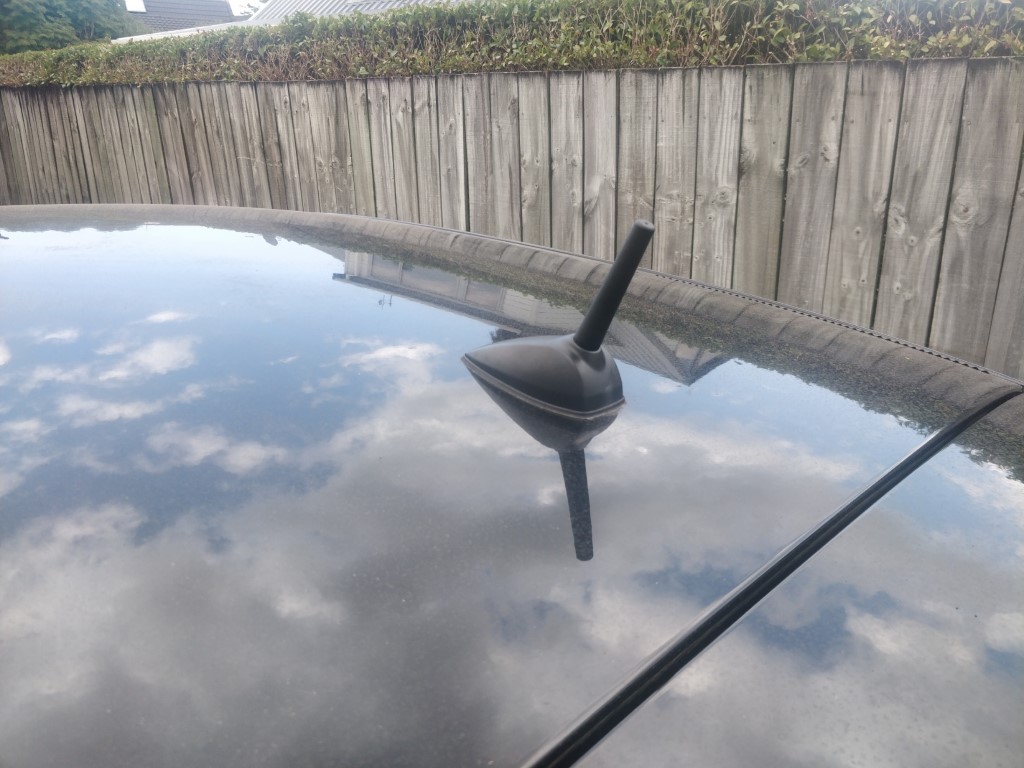

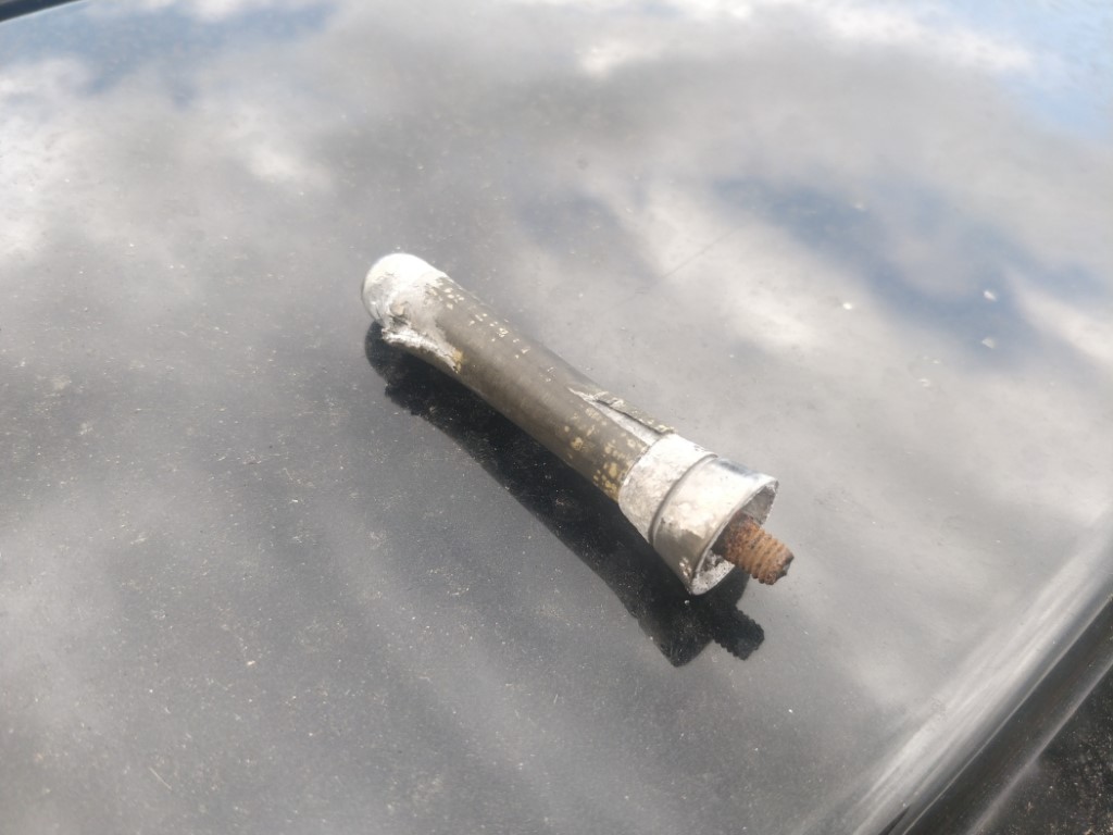

M3AN 4199 Report post Posted January 16, 2020 The aerial that came off, worked perfectly, looked tatty... BMW "sport" replacement, longer but tidier... Quote Share this post Link to post Share on other sites

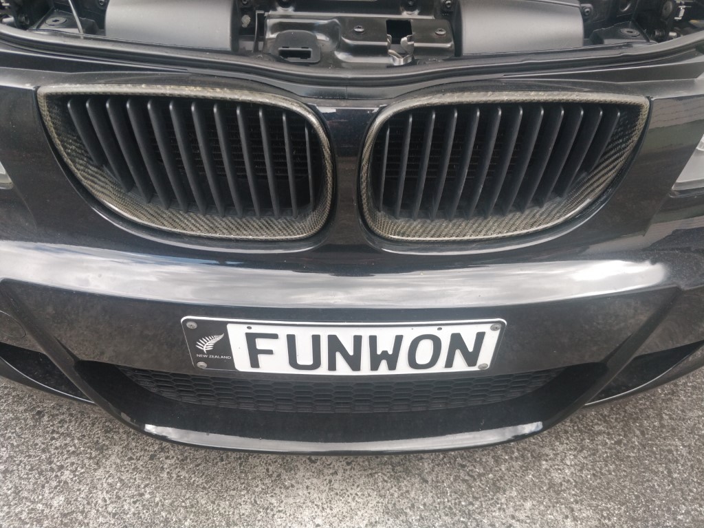

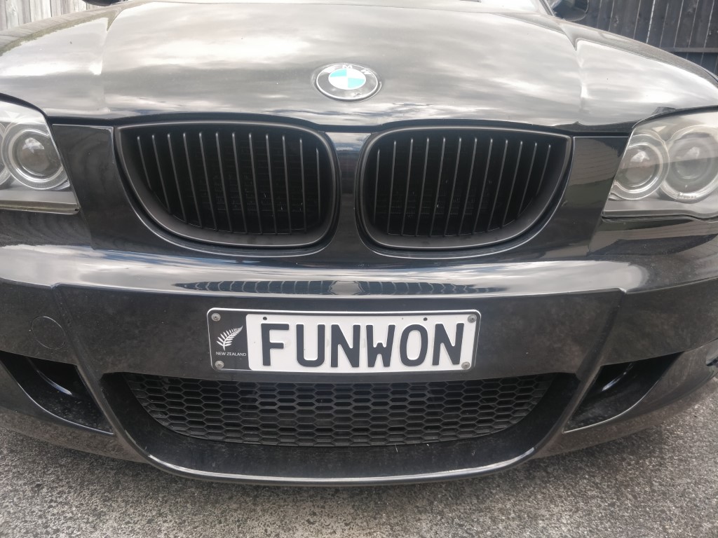

M3AN 4199 Report post Posted January 16, 2020 (edited) I also replaced the tired looking kidney grills, they look worse in person than the photos (much like the rest of the car actually). And too yellow. With these matte black ones which fit perfectly and I think look great... Seems I need to adjust my bonnet a little. ? Edited January 16, 2020 by M3AN 3 Quote Share this post Link to post Share on other sites

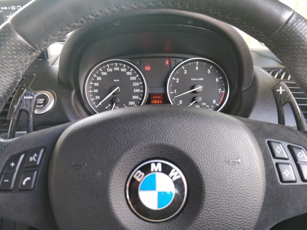

M3AN 4199 Report post Posted January 18, 2020 (edited) BMW Performance Alcantara steering wheel insert... and look closely... ...because proper conventional paddle shifters... And they work as expected, total WIN! ?? Edited September 10, 2020 by M3AN 6 Quote Share this post Link to post Share on other sites
M3AN 4199 Report post Posted January 18, 2020 (edited) This thing just keeps getting better, and my smile wider. The pretty slick auto with these paddles seems to me to be the best of both worlds, with a bit of imagination it's both an auto and a manual, a poor man's SMG if you like. The new shifters are from https://www.nelsonracingwheel.com/ and I had to take a bit of a punt as they never got the e87 or the 130 in the US so compatibility was a risk. In the end I opted for the "pre-LCI" ones for my LCI and they proved to be the correct ones. You disassemble the existing paddles, swap in some new framework and attach the actual aluminium paddles - all of the original BMW electrics and micro stitches are reused. Then you swap the down (push) wire on the left and paddle into the up (pull) terminal and voila right is pull up, left is pull down and you can't press either paddle. Took me about 40 minutes. The action is firm and has a satisfying dull 'click', the aluminium paddles both look and feel great, I couldn't be happier. They felt immediately intuitive to me, I'm already comfortable reaching for them with opposite hands if I'm turning the wheel a lot. New lock nut set from @Lewis91 turned up in less than 24h, how sweet is that? A few more small things still on the way, it's working out well for me so far. Edit: oh and bonus, any BMW or aftermarket DCT shift paddles will work with these new switches, pull existing ones off, slide new ones on, 60 seconds. Edited September 10, 2020 by M3AN 3 Quote Share this post Link to post Share on other sites

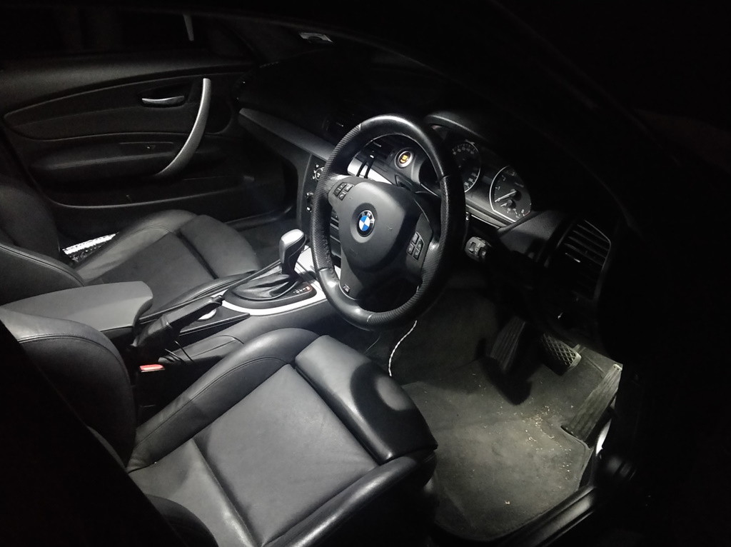

M3AN 4199 Report post Posted January 20, 2020 (edited) Changed all the interior lights (except for the ambient lights) to LED's for a fresher look although it took me 90 mins thanks to German (over)engineering... Both centre lights All four reading lights Footwell lights Glovebox light Boot light I'm happy with the result. Edited January 20, 2020 by M3AN 1 Quote Share this post Link to post Share on other sites

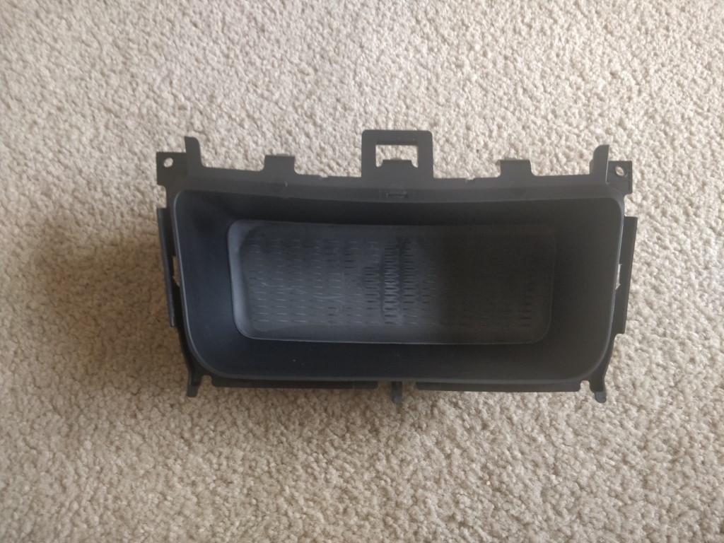

M3AN 4199 Report post Posted January 22, 2020 (edited) So this arrived today, an OEM storage pocket to replace the front ashtray because these things have poor (accessible) storage compared to an e36 which is what I'm used to. About 2 hours after ordering it I found out that you can actually use an e9x compartment and keep the ashtray cover. I think that would look better but may compromise the capacity. I'll probably install this one and see how I feel before committing to more money. Because I'm replacing the ashtray it does mean I can try and install lighting and a USB power socket in the tray pictured... a project for the long weekend perhaps... Edited June 14, 2020 by M3AN 1 Quote Share this post Link to post Share on other sites
Navin 180 Report post Posted January 22, 2020 That's great, where'd you get that storage tray? I'm wanting to try retrofit a wireless charging pad into one Quote Share this post Link to post Share on other sites
M3AN 4199 Report post Posted January 22, 2020 4 minutes ago, Navin said: That's great, where'd you get that storage tray? I'm wanting to try retrofit a wireless charging pad into one BMW - #51167136190 (single part comes with the rubber mat, you don't need to get that separately). I shopped around a bit and ended up getting mine from eBay with free shipping, arrived in about 12 days. Quote Share this post Link to post Share on other sites
Navin 180 Report post Posted January 22, 2020 Awesome thanks! will order one tonight. Quote Share this post Link to post Share on other sites
