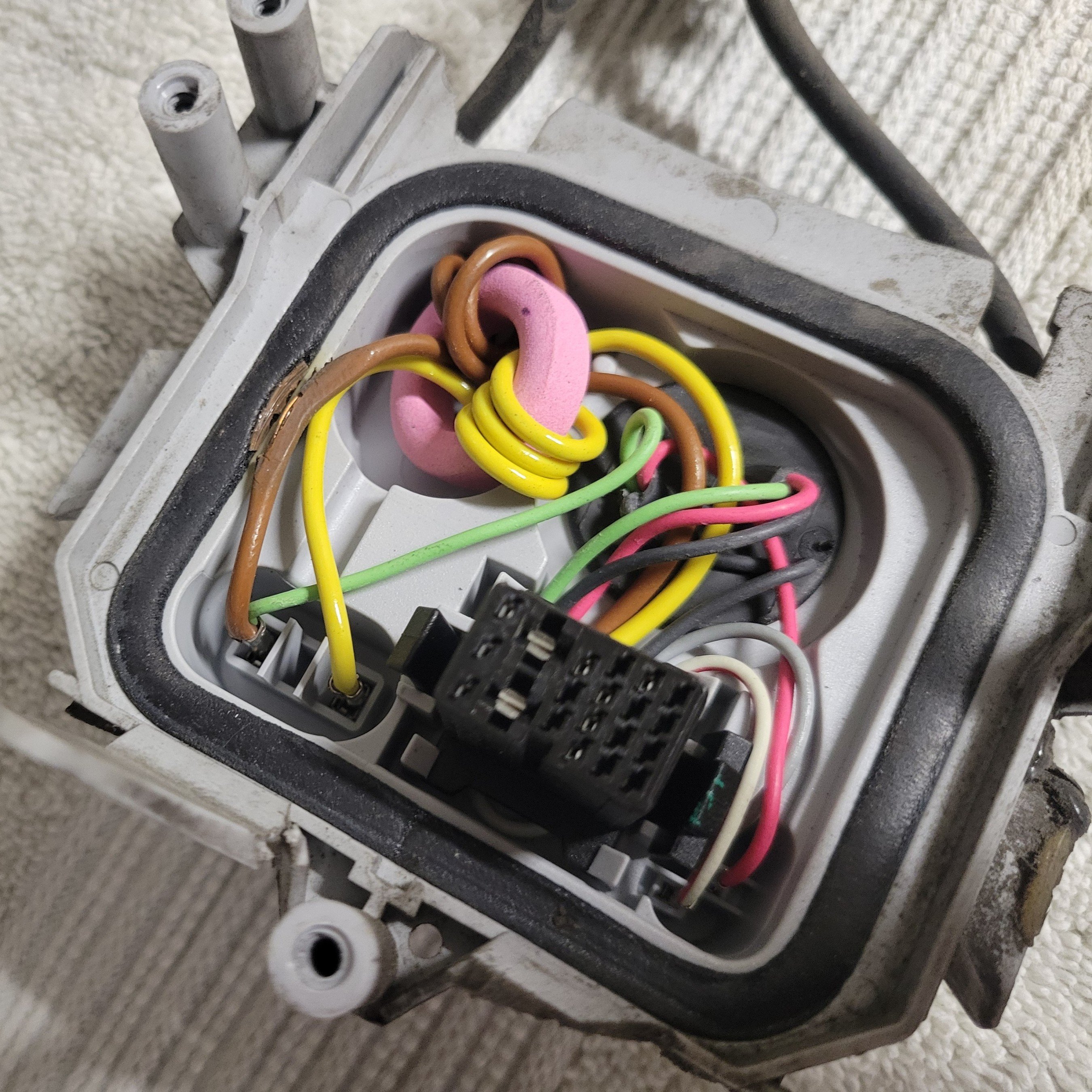

  • Been having an intermittent issue of the driver's side HID headlight not wanting to turn on. Sometimes it'll just take an extra minute for it to light up, sometimes it'll need a smack, others it'll work perfectly fine. I suspect it'll be something to do with the ballast or a loose connection as if it was a bulb then it probably wouldn't turn on at all. Will need to go on a mission of swapping components over to opposite sides to figure out what the culprit is exactly. Could even be the ignition switch, apparently, who knows...
Decided to revisit this issue since the frequency of it happening seems to have increased of late.
I had previously installed new HID bulbs, which made no difference.
Next up was the ballast, which I managed to grab a spare of. Fun fact - the E46 shares the same part number with the first gen (BMW-era) Mini, of which there was plenty of at Pick-A-Part so I nabbed a newer 2006 production date one. Seemed to work at first but a few drives later the issue resurfaced.

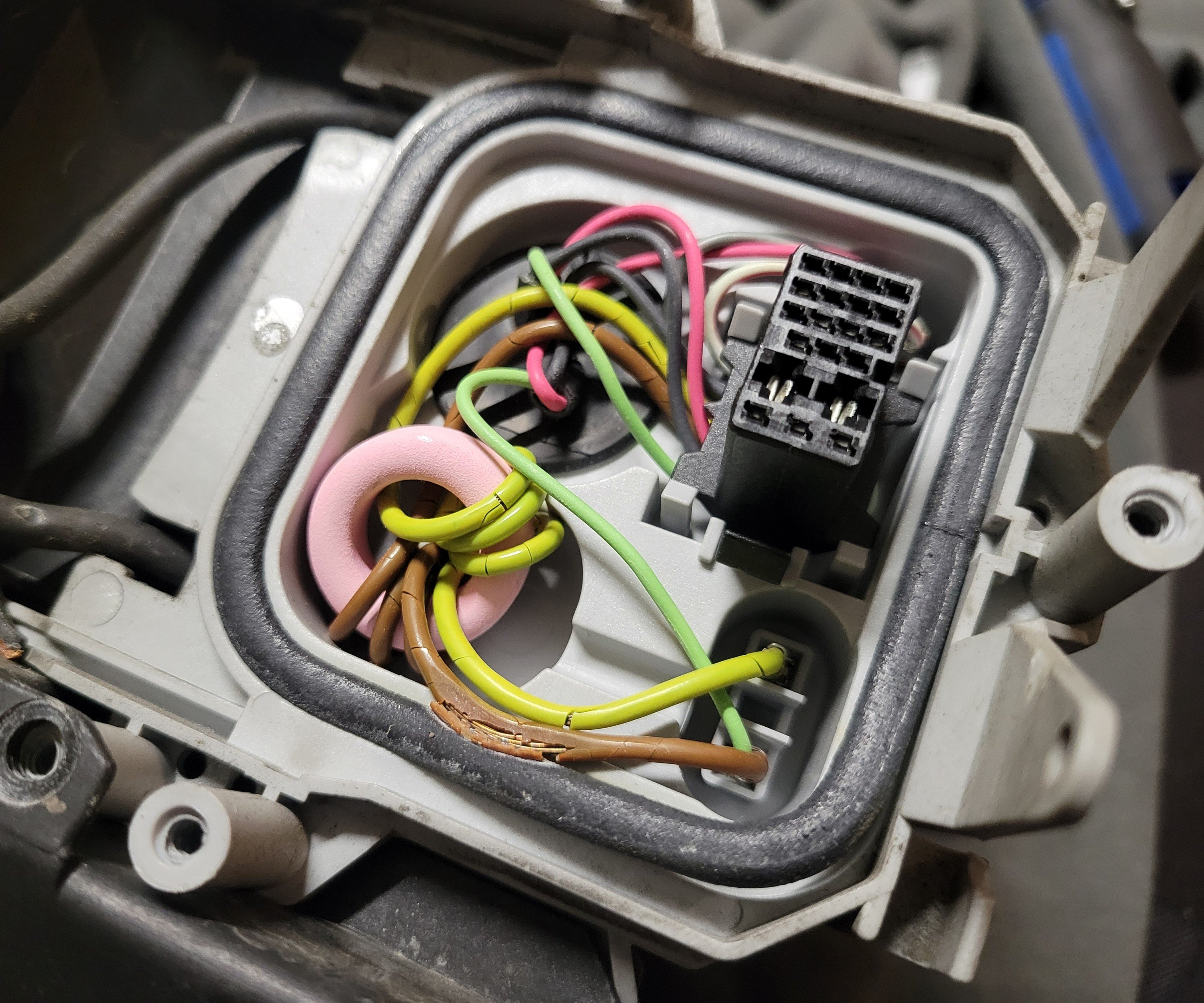

I then dug a bit deeper and took the lid off the housing where the ballast connects to only to discover this:
The insulation on the wiring had gone real brittle and was cracked throughout and one of the brown ground wires seemed to be crushed by the seal, leaving the metal completely exposed. Not even sure how to remedy this properly, rewiring seems like a mammoth task to get right looking at the way all the wires are intertwined. For the time being I just cleaned up the most obviously damaged part and wrapped it in electrical tape to at least somewhat isolate it.

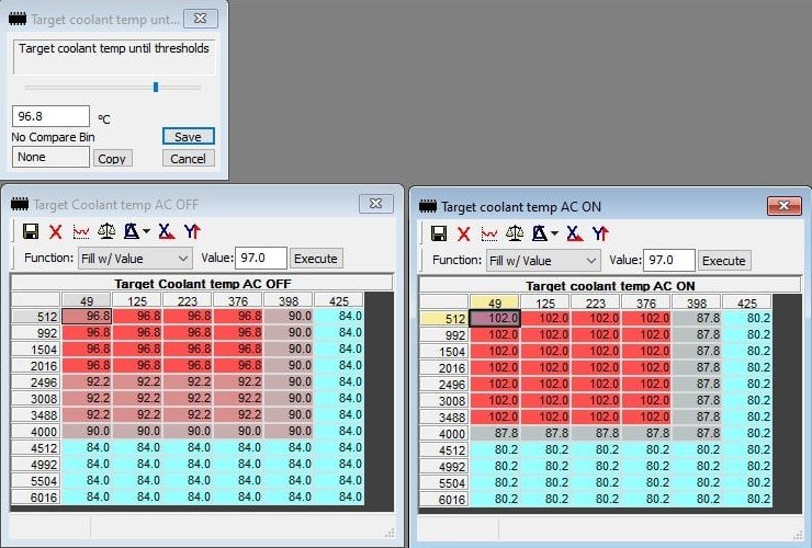

Did a few tweaks to the stock DME tune, main one being the thermostat target temperatures. Originally pioneered by @Eagle and I just followed suit. On my android headunit the coolant temperature display is always just 2 clicks away so I've been monitoring the running temperatures quire regularly. I believe they've always been within the norm but were constantly on the higher side, hovering around 99-100°C city driving and 101-102°C motorway cruising. With the below changes they've now gone down a tad to 97-98°C city driving and 94-95°C on the motorway. Eagle reckons some brand thermostats just run a bit hotter than others, in his experience he hadn't seen any M54's consistently run above 97°C so 102°C did seem a tad excessive. This tweak seems to have brought the temperatures down into a more comfortable range. Next time I change the thermostat I might give another brand a go, currently running a Borg Warner unit.
Originally, both tables had identical values, as per the right side AC ON table above. The screenshot is halfway through the process with only the left side AC OFF table values modified, the AC ON values were then also modified to match.

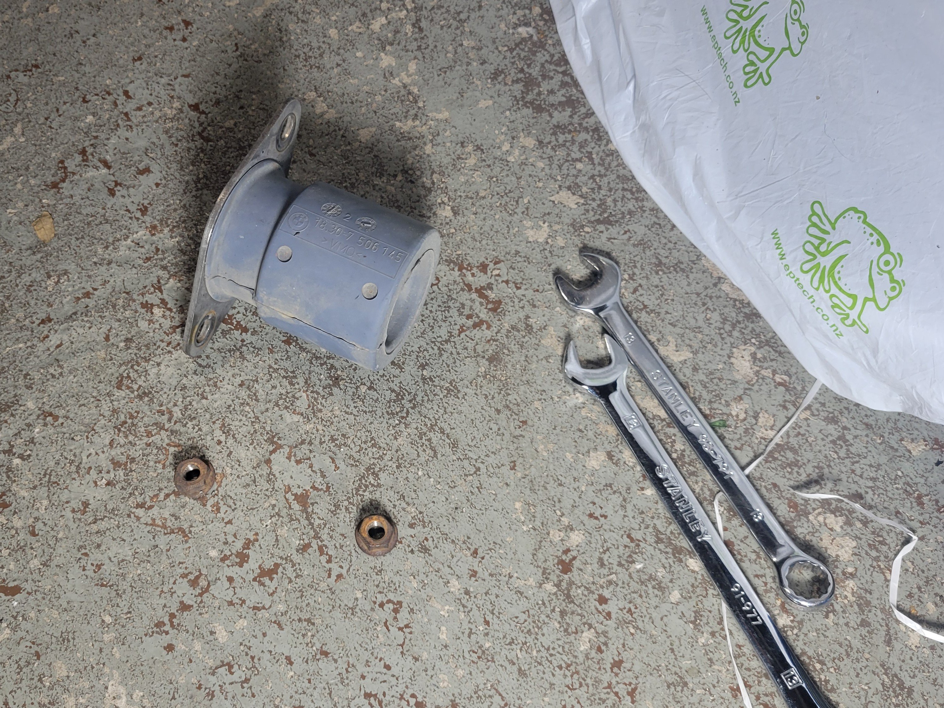

On the topic of exhausts, I stumbled upon a little titbit of information in Bryson's thread over on E46 Fanatics about the vibration dampeners on the stock exhaust system. Turns out automatic cars had two of them, both #4 & #12 on the schematic below, whereas manual cars only had #12. Mine being converted, I decided to unbolt the #4 dampener from the rear of the muffler. Can't say it made a discernible difference but it's now a tiny bit closer to a factory manual.
Pipe Automotive Exhaust Exhaust system Muffler Catalytic converter

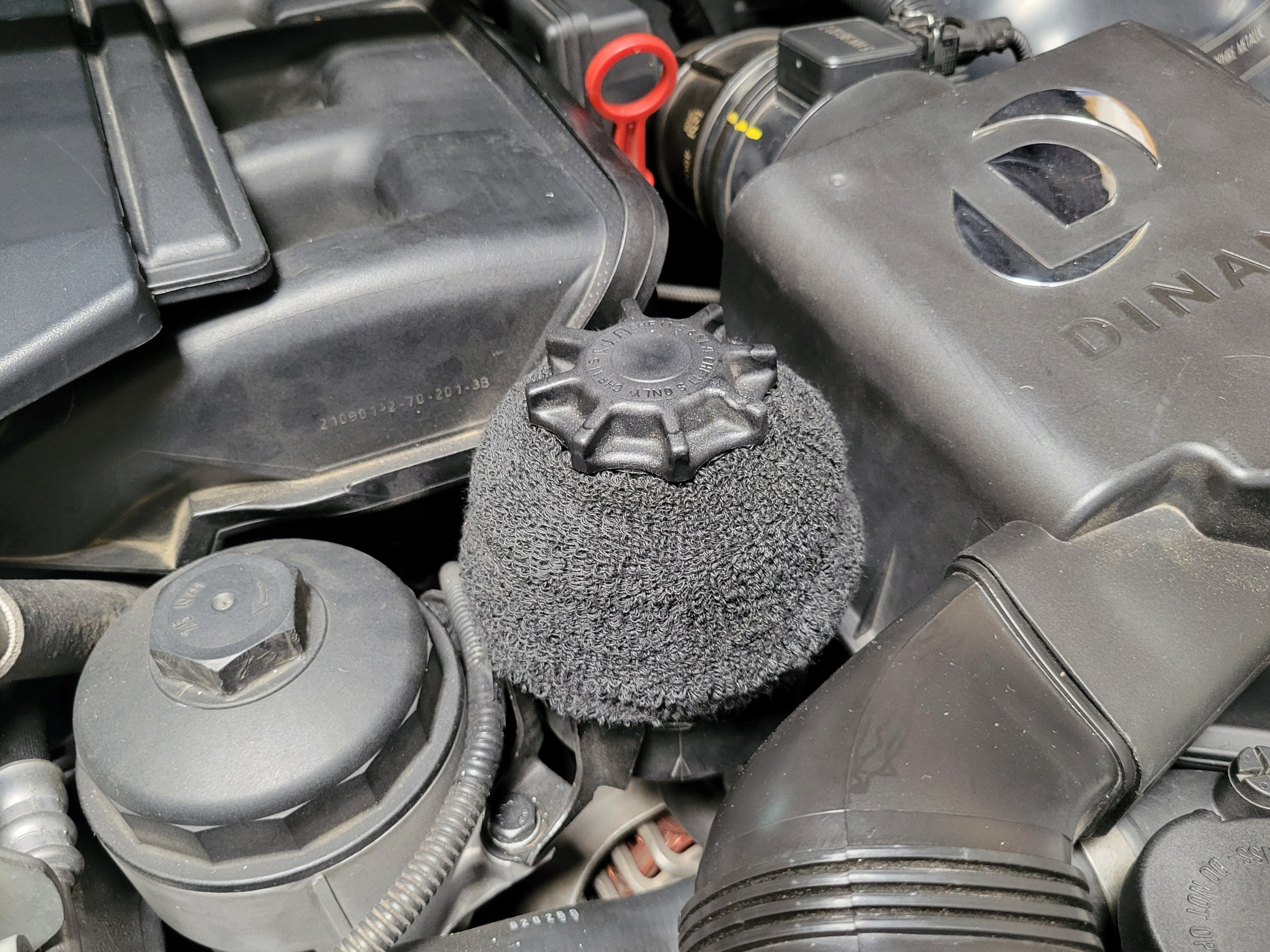

The power steering reservoirs on these are notorious for weeping and creating a mess. Mine is still fairly new and hasn't succumbed to this inevitability but as a little piece of security from a potentially messy situation I got myself a cheapo wrist sweatband and draped it over the reservoir. Fits well and looks quite inconspicuous being all black without any tacky logos. The idea was of course blatantly stolen from Garagistic but cost me a fraction of the price.
Getting flashbacks of VW's when going in for a simple bulb change. Liquid tape can help to some degree but its a bit messy. Re-wiring is the only proper fix.

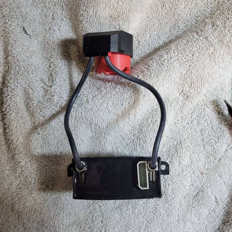

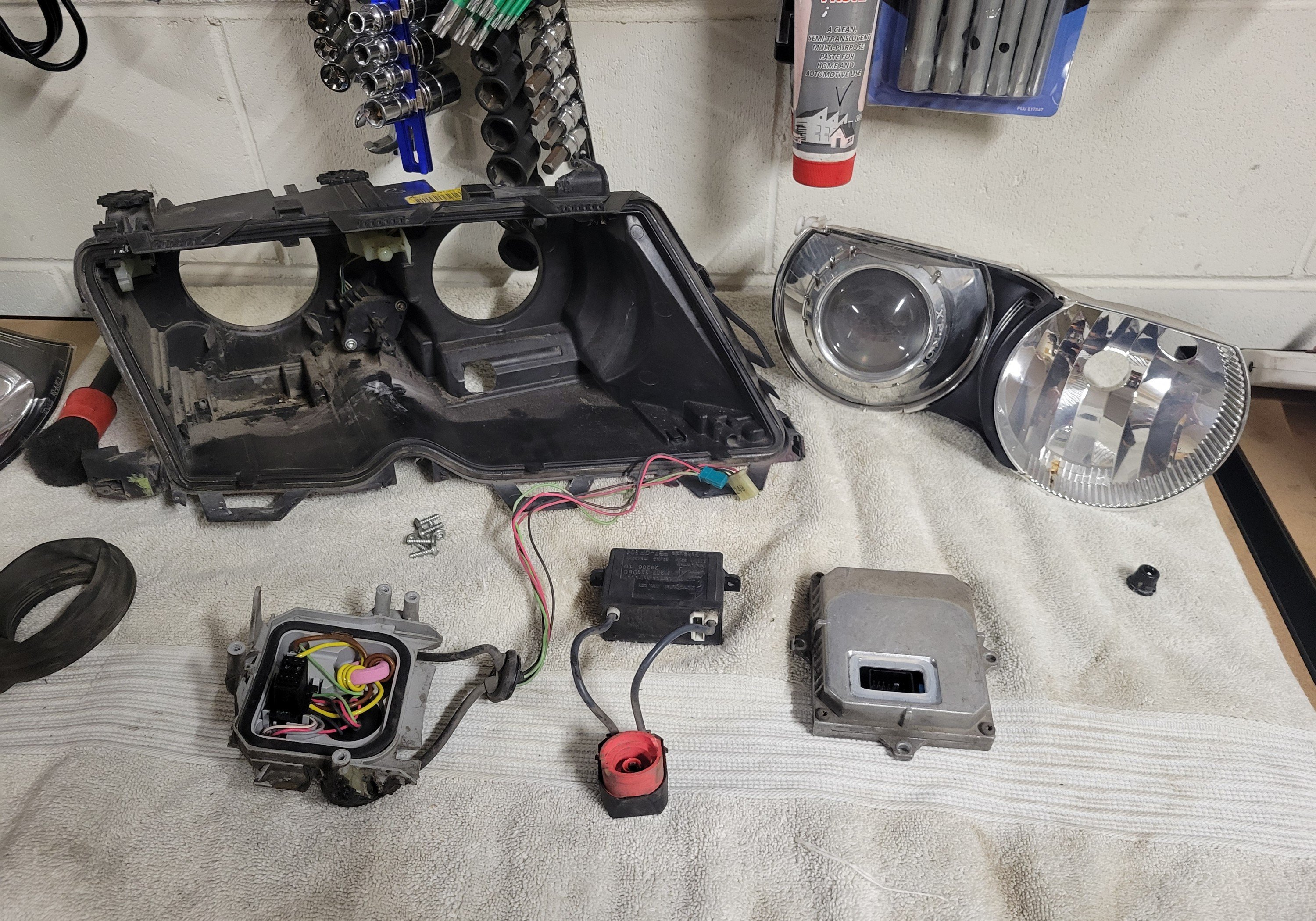

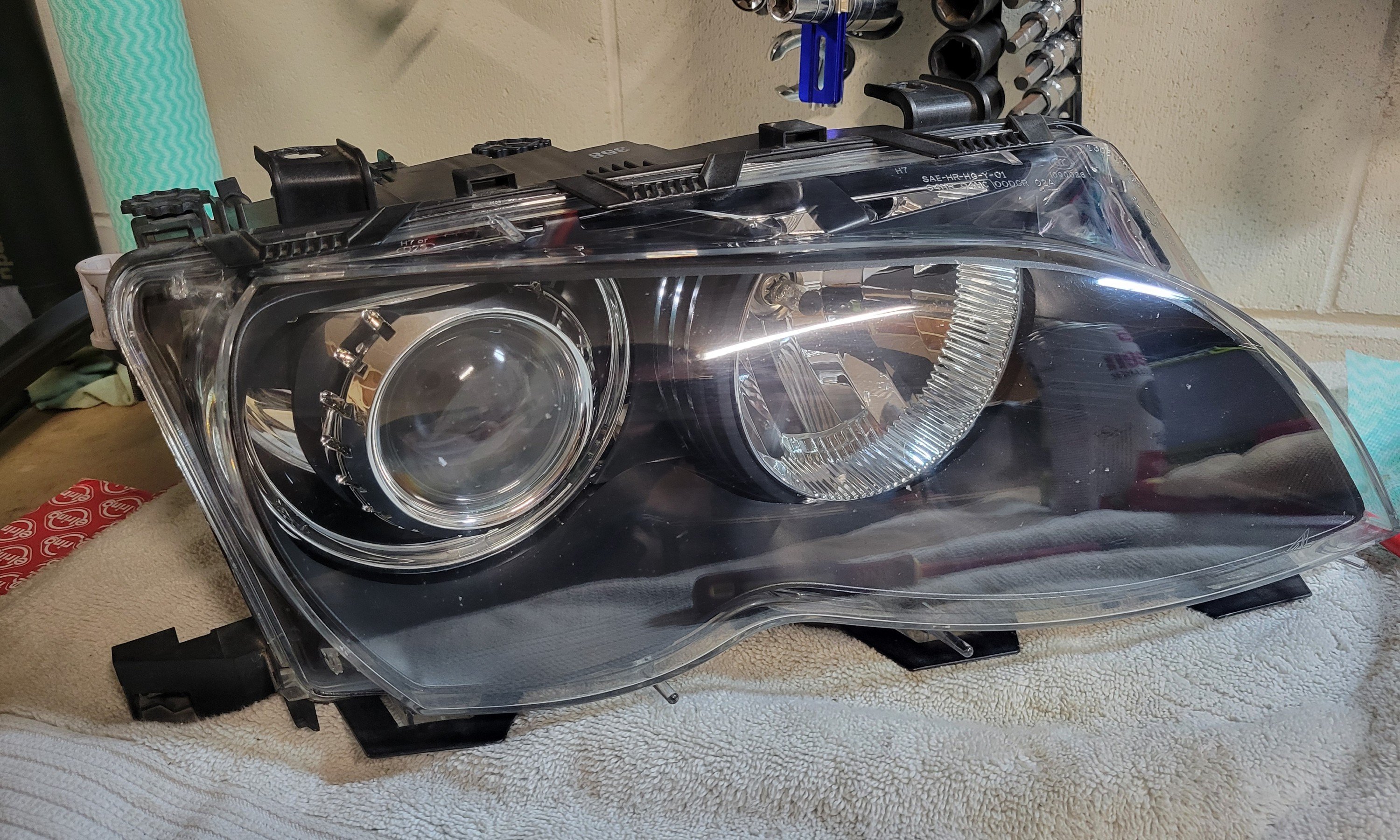

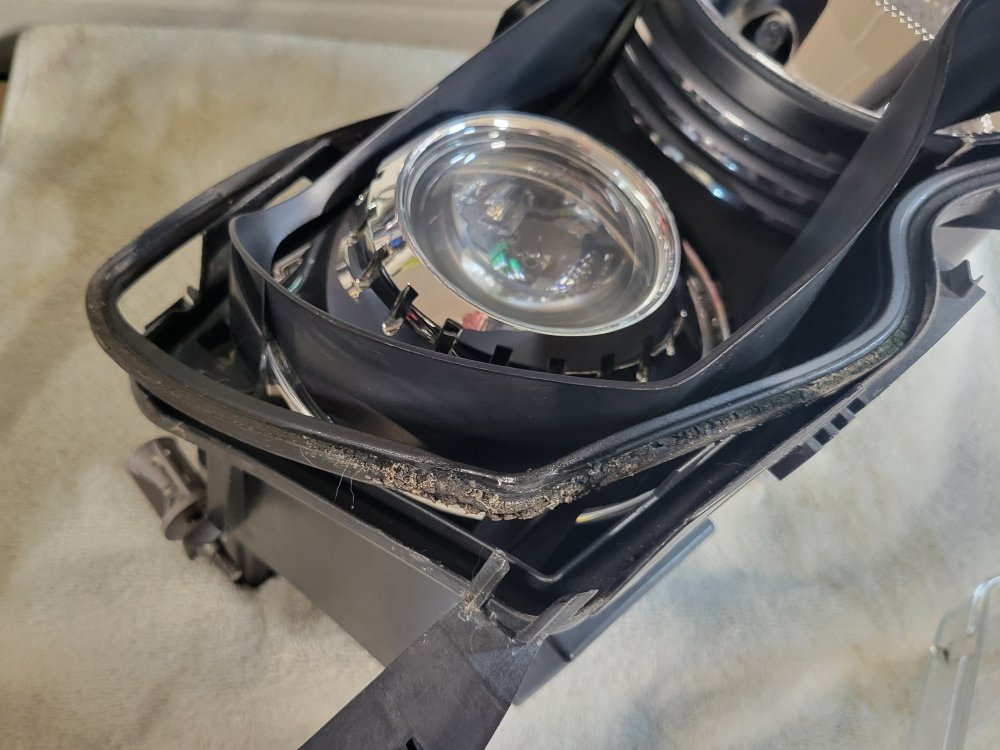

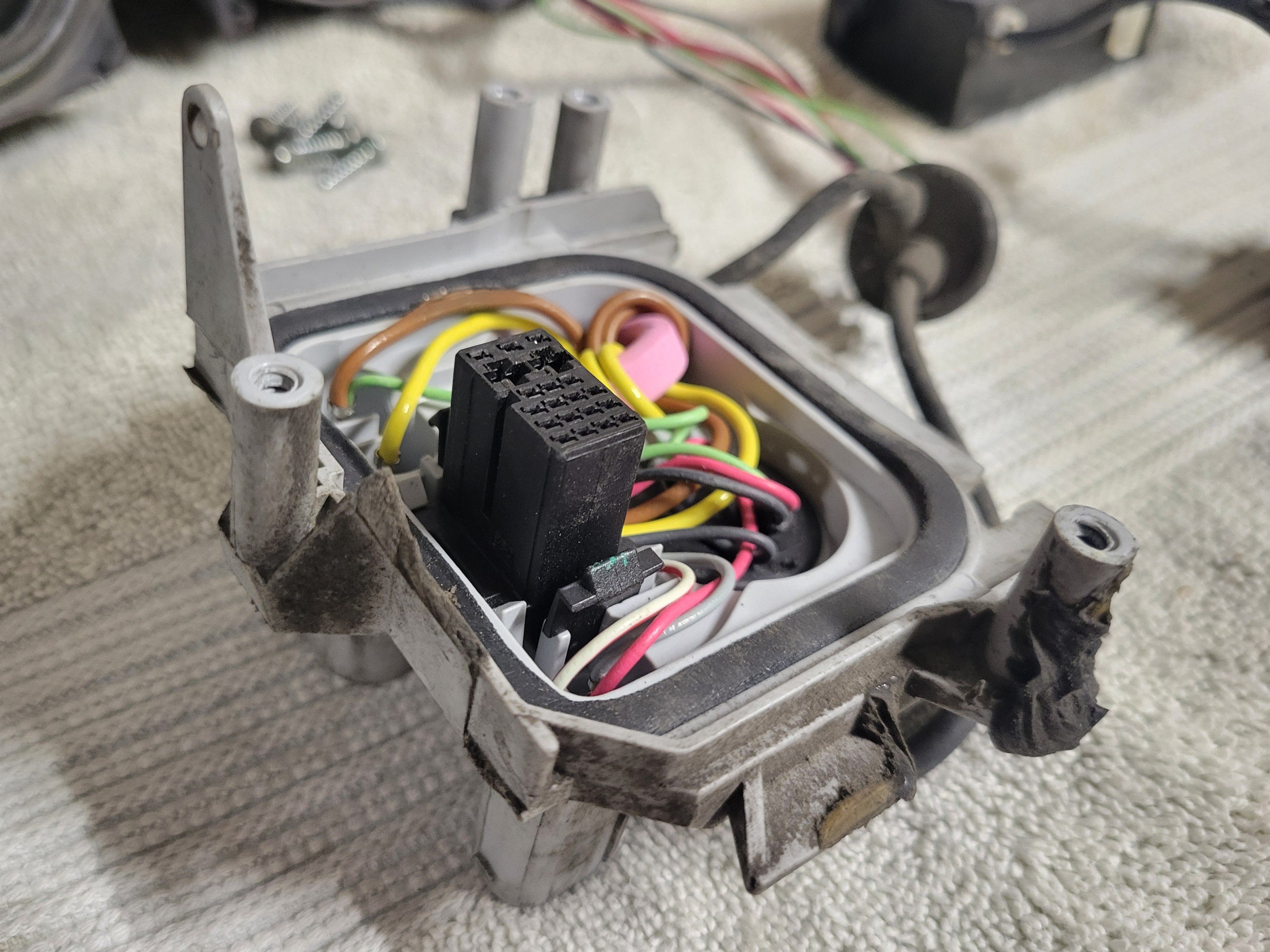

The driver's side headlight had fully deteriorated to the point where it wouldn't light up at all anymore, wet or dry, so it was time to properly address it.
I picked up a rather rough, but fully operational spare xenon headlight from Pick-A-Part a few months back used it as a donor to repair the existing one. The donor had unfortunately had a rough life with a bunch of clips broken and bulbs held together with some RTV-like goo so it was just too beat up to throw straight in.
The headlight disassembly task turned out not to be as daunting as I had feared. Was good being able to practice on the spare unit before moving onto the original one. I made several marks on the casing and adjustment dials to make sure it all went back together in the same way.
Ideally, I would have swapped over the main wiring casing where the ballast plugs into but it was in a rather shoddy state with the casing cracked, bits broken off and goo holding it to the headlight housing instead of screws. The brown wire had also been pinched on the seal and cracked in exactly the same place as on the original headlight. Third unit I'm seeing it happen on now so looks to be a very common thing, weirdly enough.

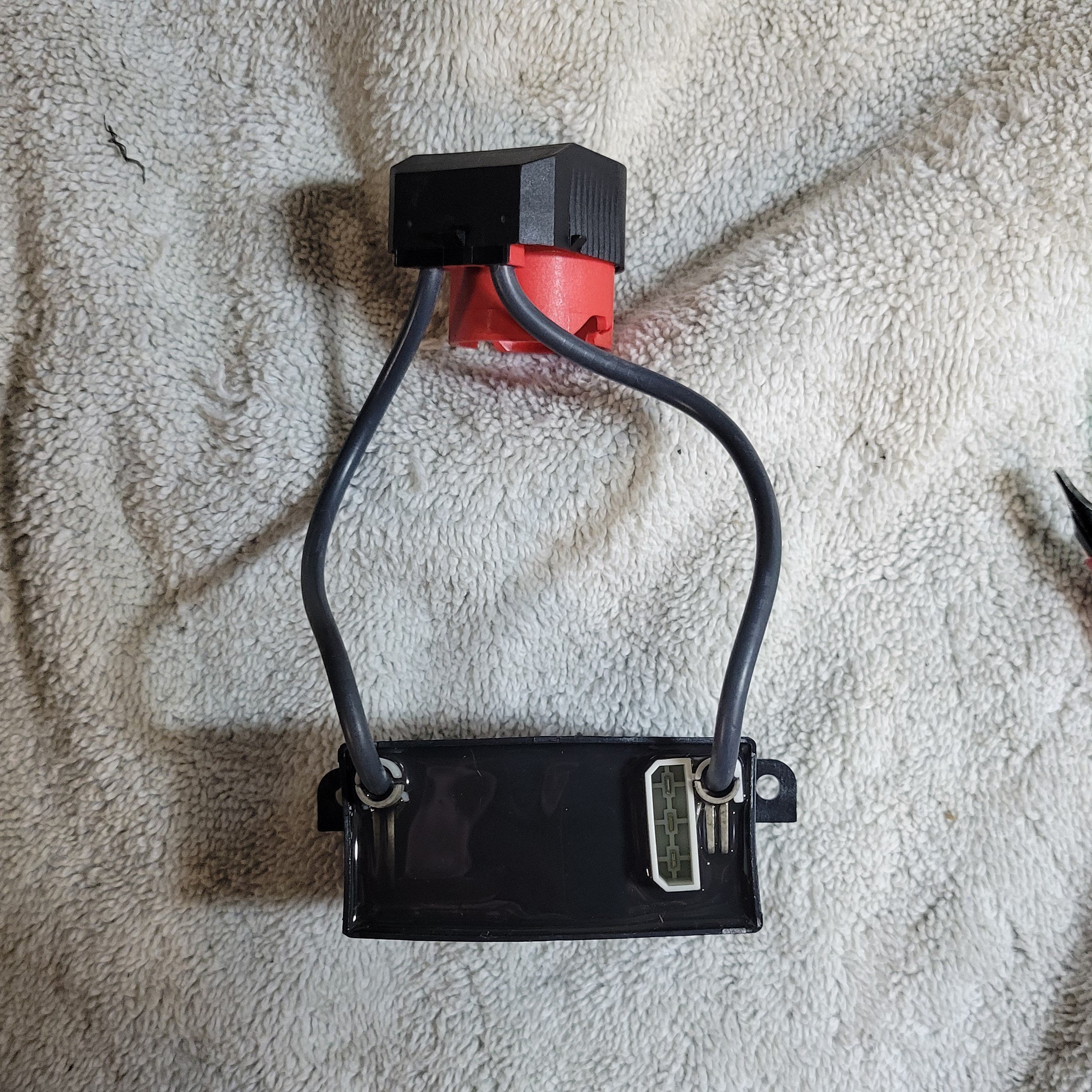

I decided to leave the wiring birds nest alone and start by swapping over the igniter unit, which seems to have turned out to be the fix. The original igniter unit was visibly "swollen" with the top & bottom edges bowed out, I'm assuming from absorbing all the moisture making its way into the headlight housing.

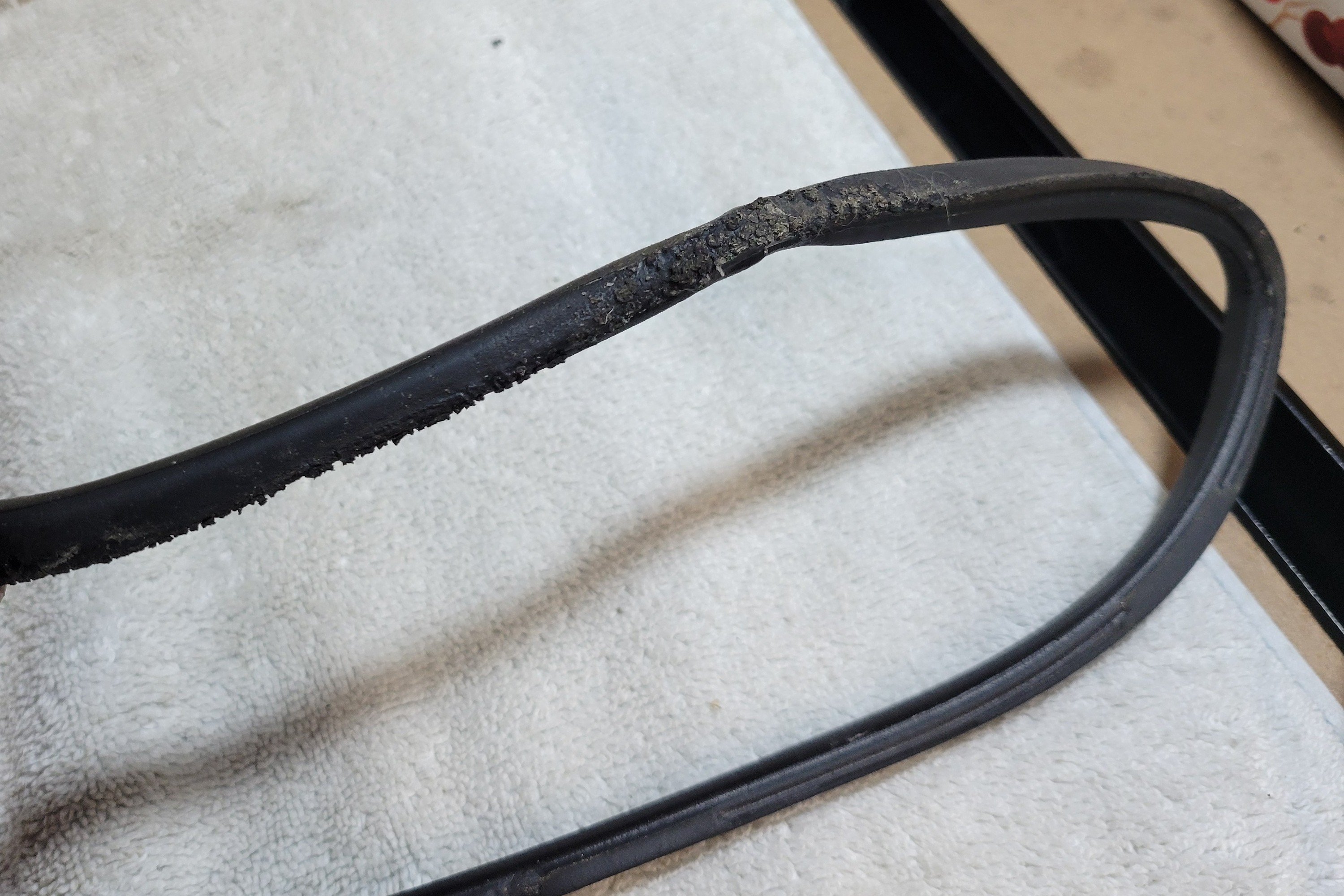

On the moisture front itself, the lens seal had somehow begun to rot and was in an absolute horrid state. Almost impressive how bad it had gotten.
Luckily, the one from the donor was in pretty good nick so I used that for now. Will order a pair of new seals at some point and replace both to future proof it. Unfortunately, it's one of those items that Spareto doesn't stock for some weird reason so will have to be a Schmiedmann order or a trip to the dealership.
All put back together and reinstalled in the car, both headlights now fire up instantly so looks to be a successful fix, although she's yet to venture outside and face the rain. Hopefully it'll hold up just fine tho.

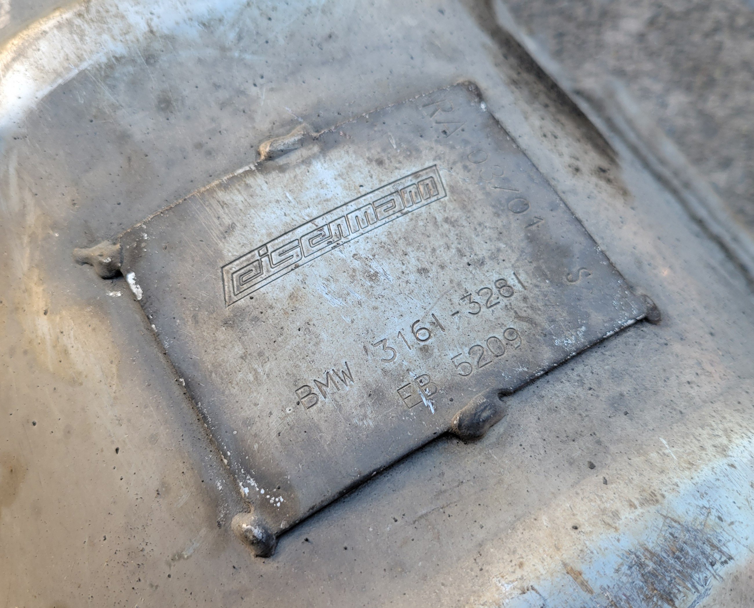

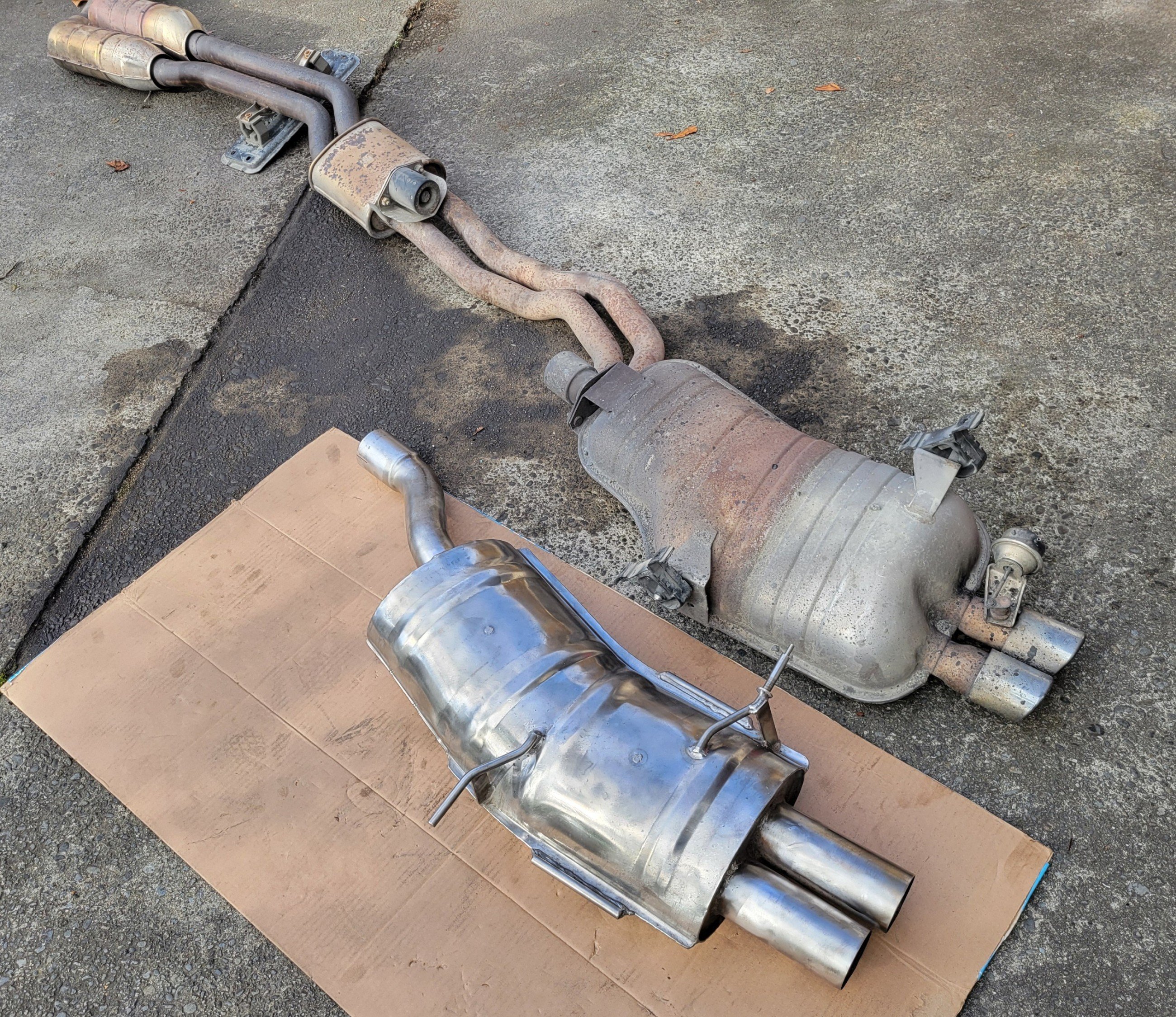

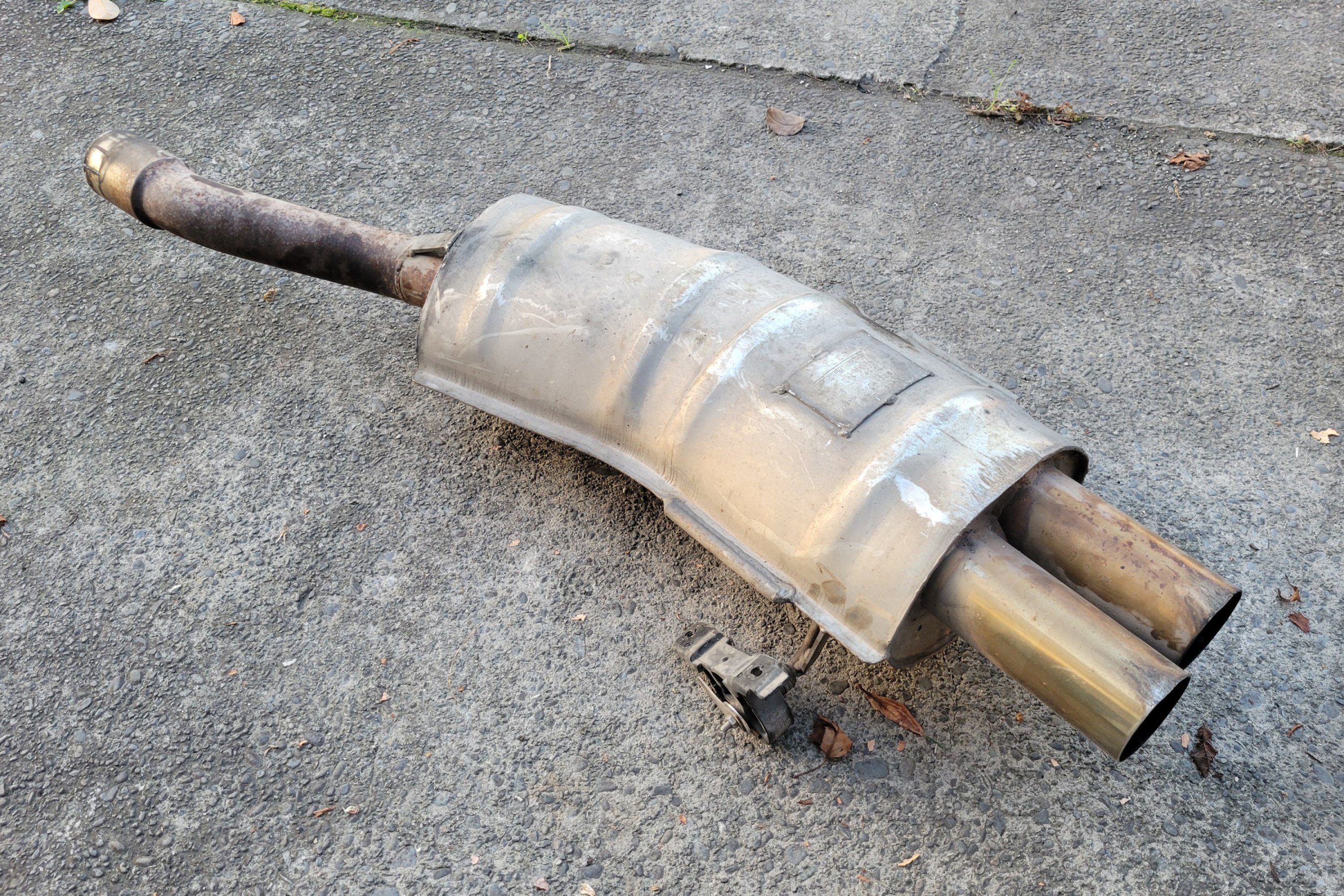

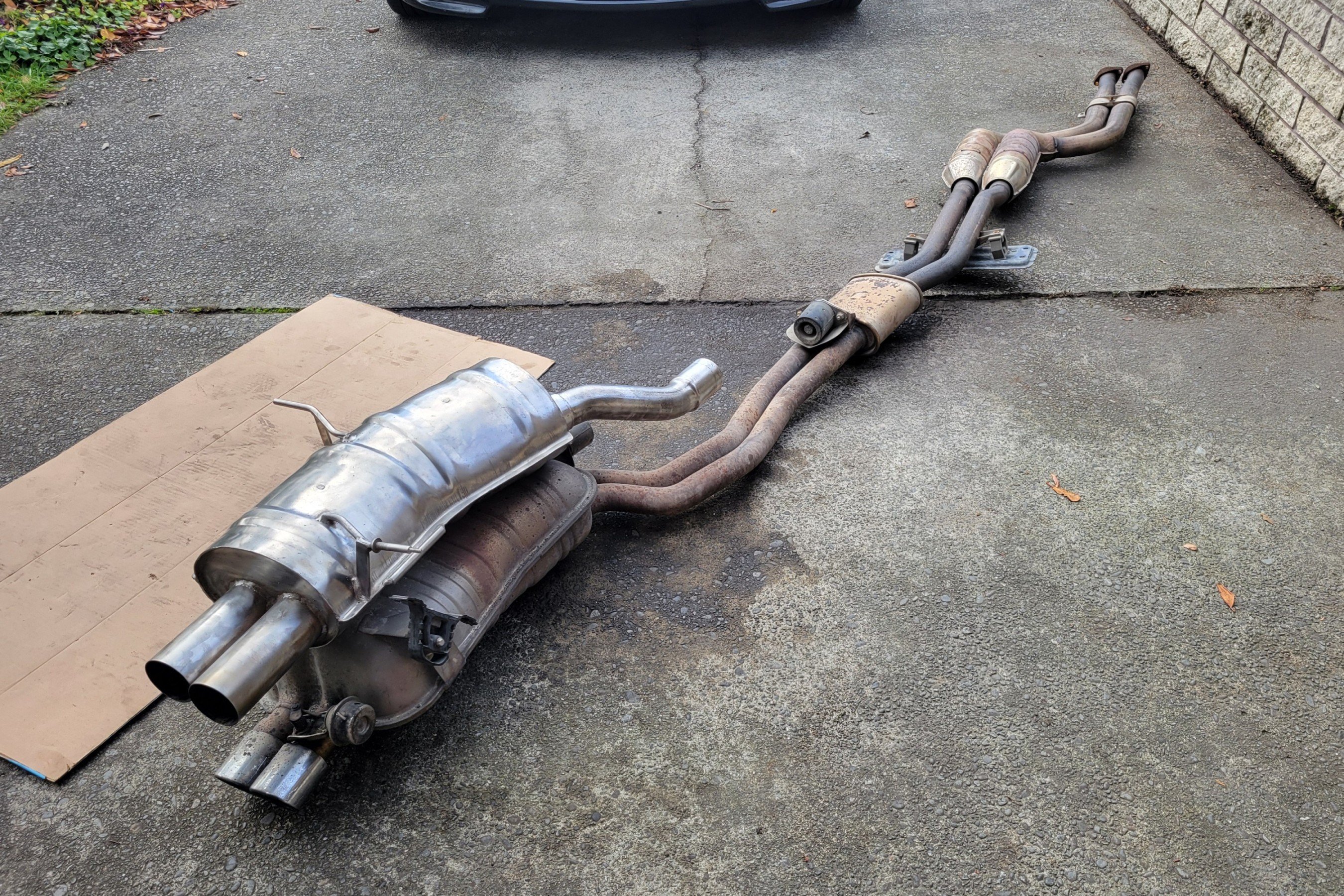

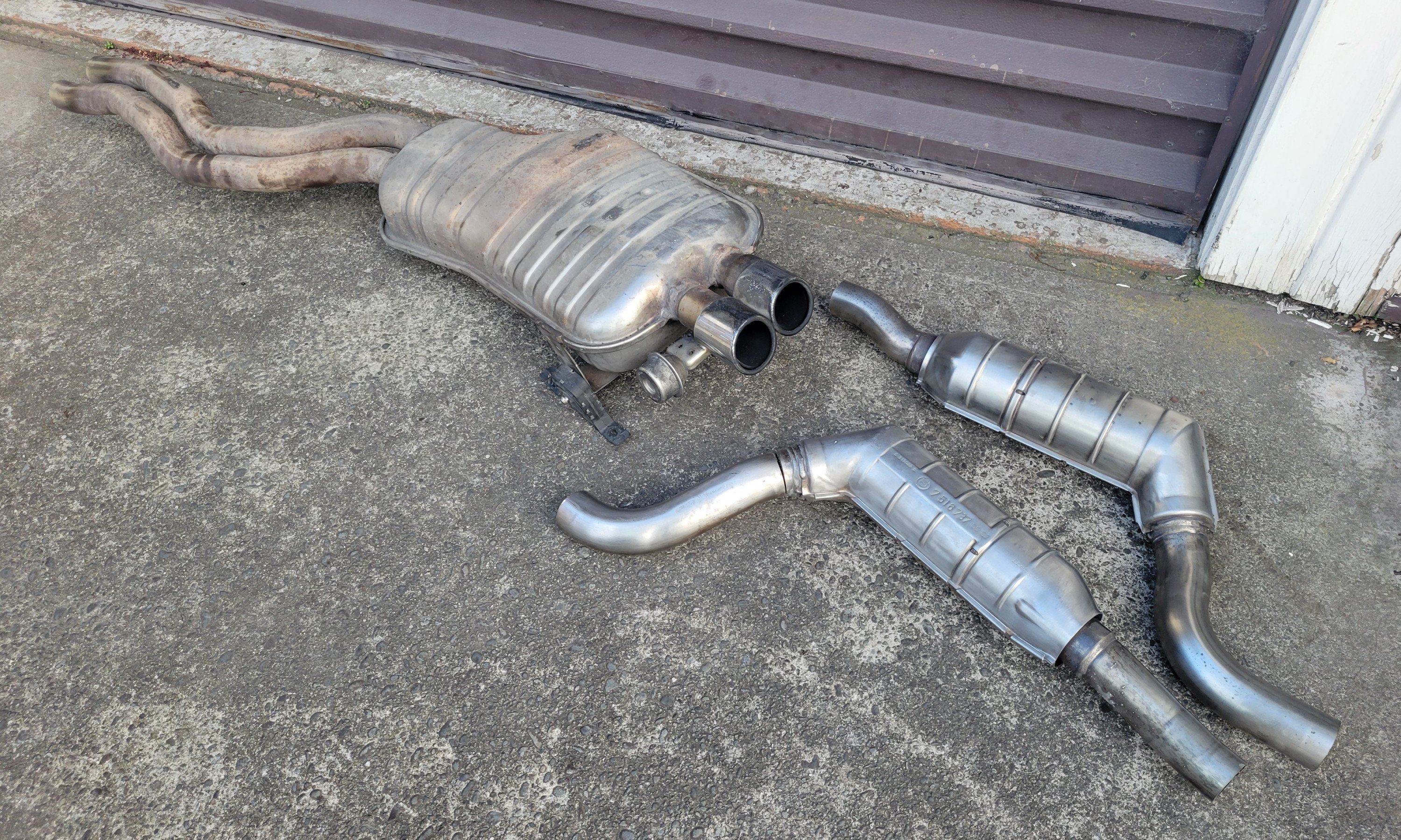

Had the pleasure of meeting @Gaz the other week. He reached out to see if I wanted to check out an Eisenmann muffler from a 330i that he's parting out, which naturally piqued my interest. The exhaust was still attached to the car, the exhaust nuts at the back of the headers had of course rusted themselves on and rounded out when trying to remove them so instead we fiddled around unbolting the stubby headers from the head and removing the whole exhaust in one piece. All part of the fun. The rest of the exhaust had rubbed through from dragging on the ground but I happily walked away with the muffler. Has lived a life but cleaned up quite nicely. Will give it a nice finishing polish prior to going on for good.
The donor was an earlier, PFL 330i and the exhaust setup on it was different to mine, whether from factory or from being modified at some point to make work with the muffler. The main difference being the Eisenmann muffler being a single 59mm OD entry whilst my setup is twin 50mm OD pipes running all the way to the stock muffler. This would mean a reduction in overall cross section area so technically introducing a restriction but it's probably not enough to even notice in real life, not exactly a race car after all. The muffler itself is technically meant for a 316i-328i but did come off a 330i so will send it and see how it goes. I've got a spare stock exhaust setup laying around that I'm happy to have cut up.
1332979712_2025-06-0612_52_33.thumb.jpg.d896de44432ea166e65fef3cbd43812e.jpg1831493091_2025-06-0612_53_06.thumb.jpg.01eb6c34f688ab45d878019db3cb6470.jpg
Have booked in with Flame on the 16th to get this thing made to work. I'm thinking retain the cats, cut out the resonator and put in a Y-pipe somewhere along the way. Can't wait to hear the result. Will no doubt be rowdier than it is, hopefully not too obnoxious tho. Will still keep hold of the stock setup just in case.

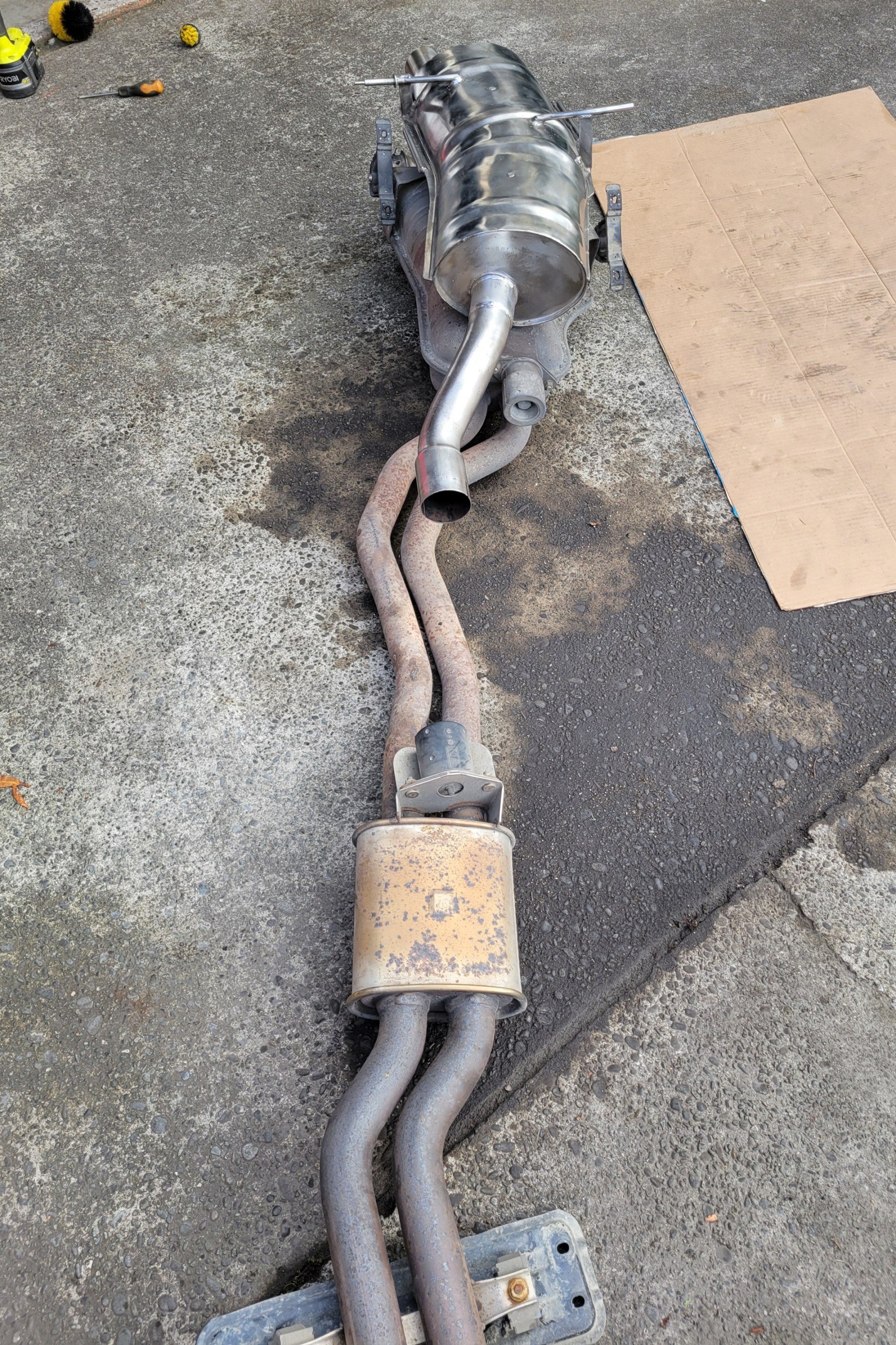

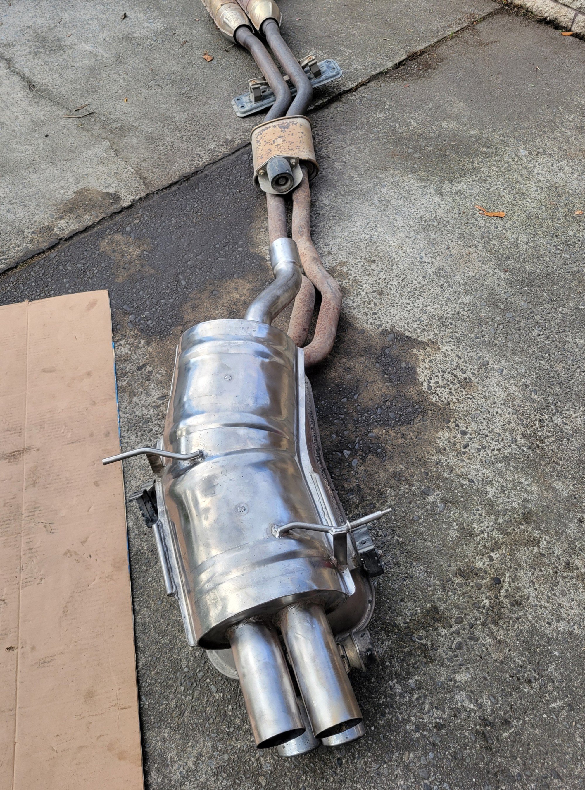

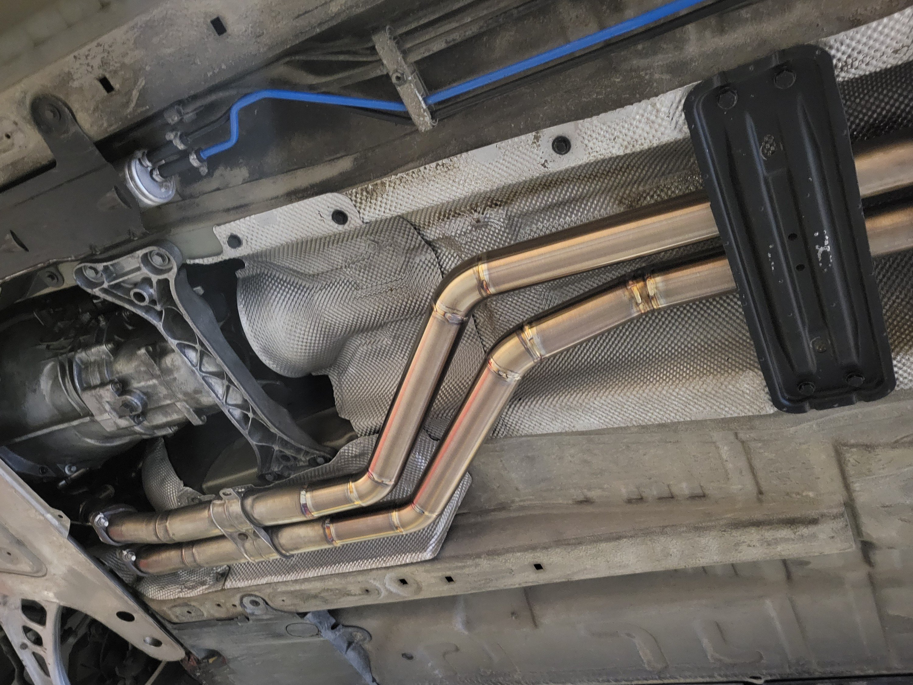

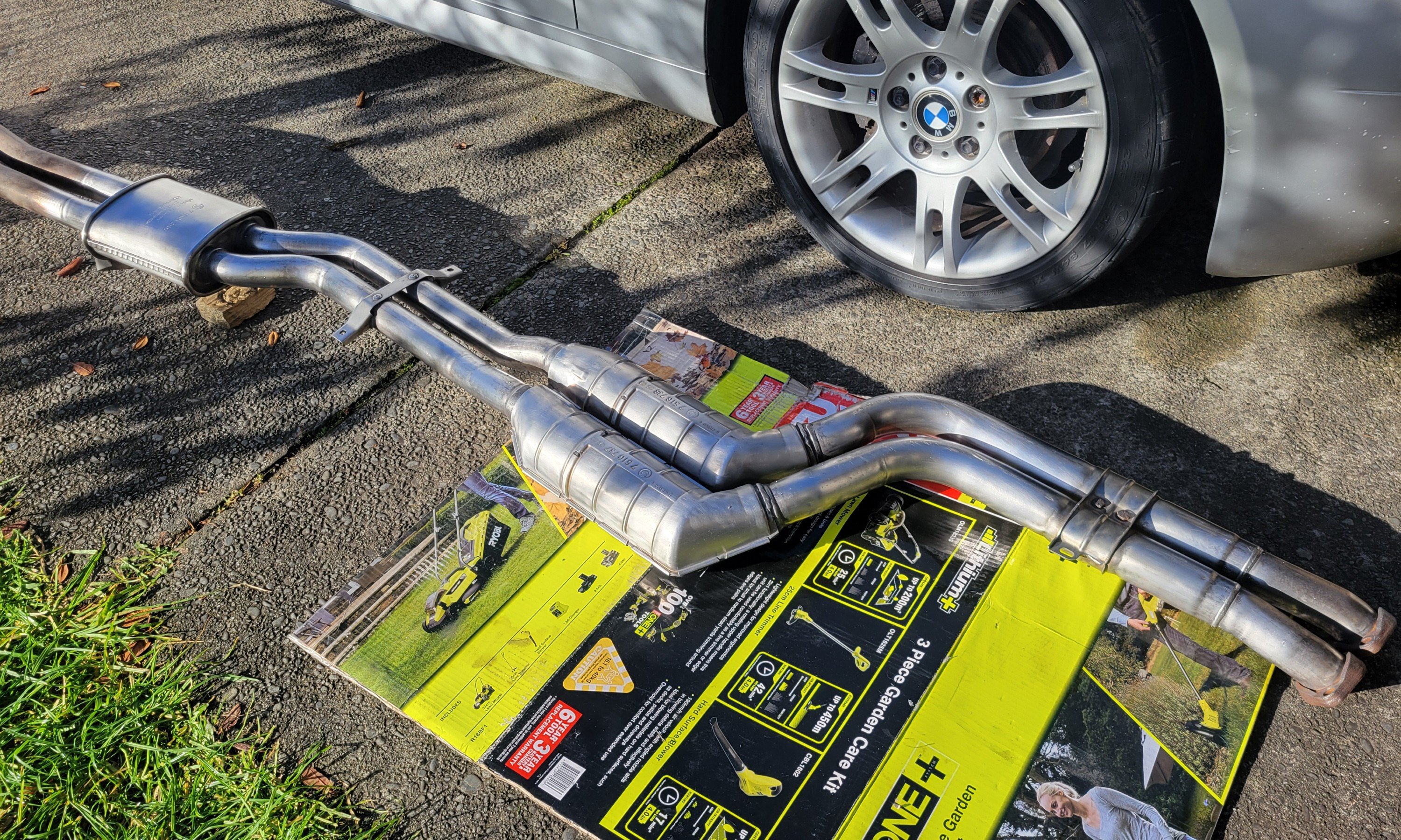

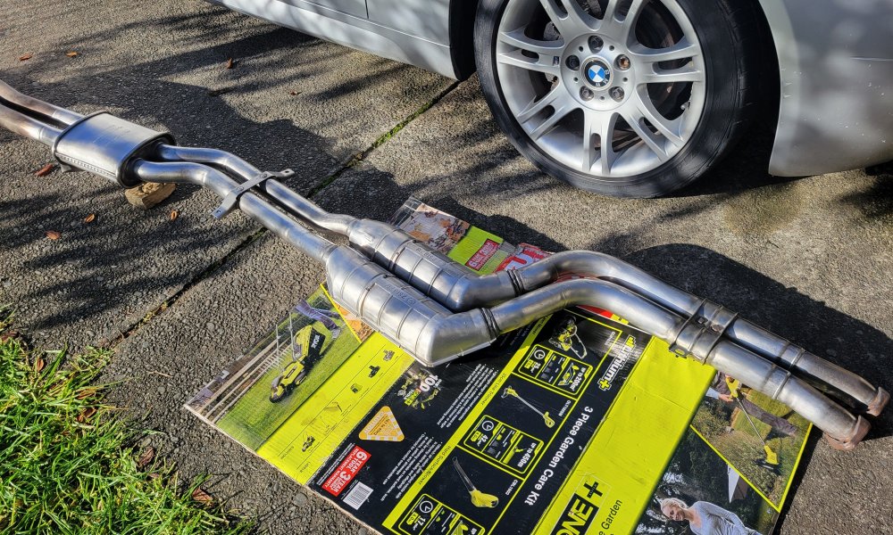

Gave the spare exhaust a quick lazy polish before bolting it up and dropping the car off at the shop.
Even on the way there I still hadn't fully decided on the final course of action - whether to cut out the resonator or the secondary cats. Sound wise both would probably have had the same effect but the smelliness of it all was my main concern. Had the guys at the shop start up a couple of decatted cars to get a sense of what life would be like cat-free. Don't know if I got an objective feel for it or if my sense of smell had simply been decimated from sniffing all the brake cleaner fumes over the years but it didn't feel as bad as I had feared so cat delete it was.

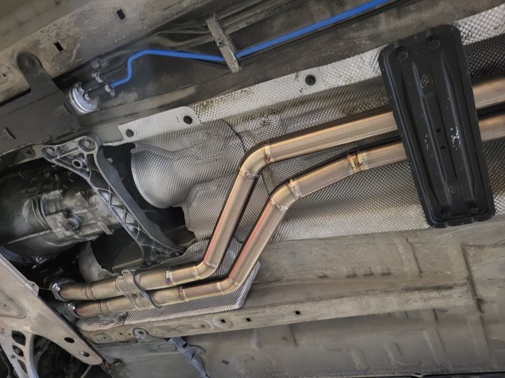

Somehow turned out to be a bit more work than I thought it would be, they cut out a bigger section than I'd envisaged but the end result looked really nice, the welds were tidy and the sound exactly what I was after.
This was a progress photo they'd sent through, I forgot to ask for a full underside photo at the end. I'll be taking the exhaust off shortly to fit new exhaust gaskets, refit the damper at the back of the resonator and finish off the polishing mission so will take a photo of the rear section then.
Loving the end result, the purr at startup is awesome, has a nice deeper tone to it throughout with a tinge of the signature BMW rasp. Loud enough to be enjoyable but not loud enough to be obnoxious so shouldn't annoy the neighbours too much. Once warmed up it's still surprisingly quiet at idle but definitely feel a bit more kick when giving it some beans. Took it onto the motorway to see if there's any droning but all good on that front too. The smell isn't nearly as bad as I'd feared as well, probably would only ever be an issue if left idling inside the garage for a while.
