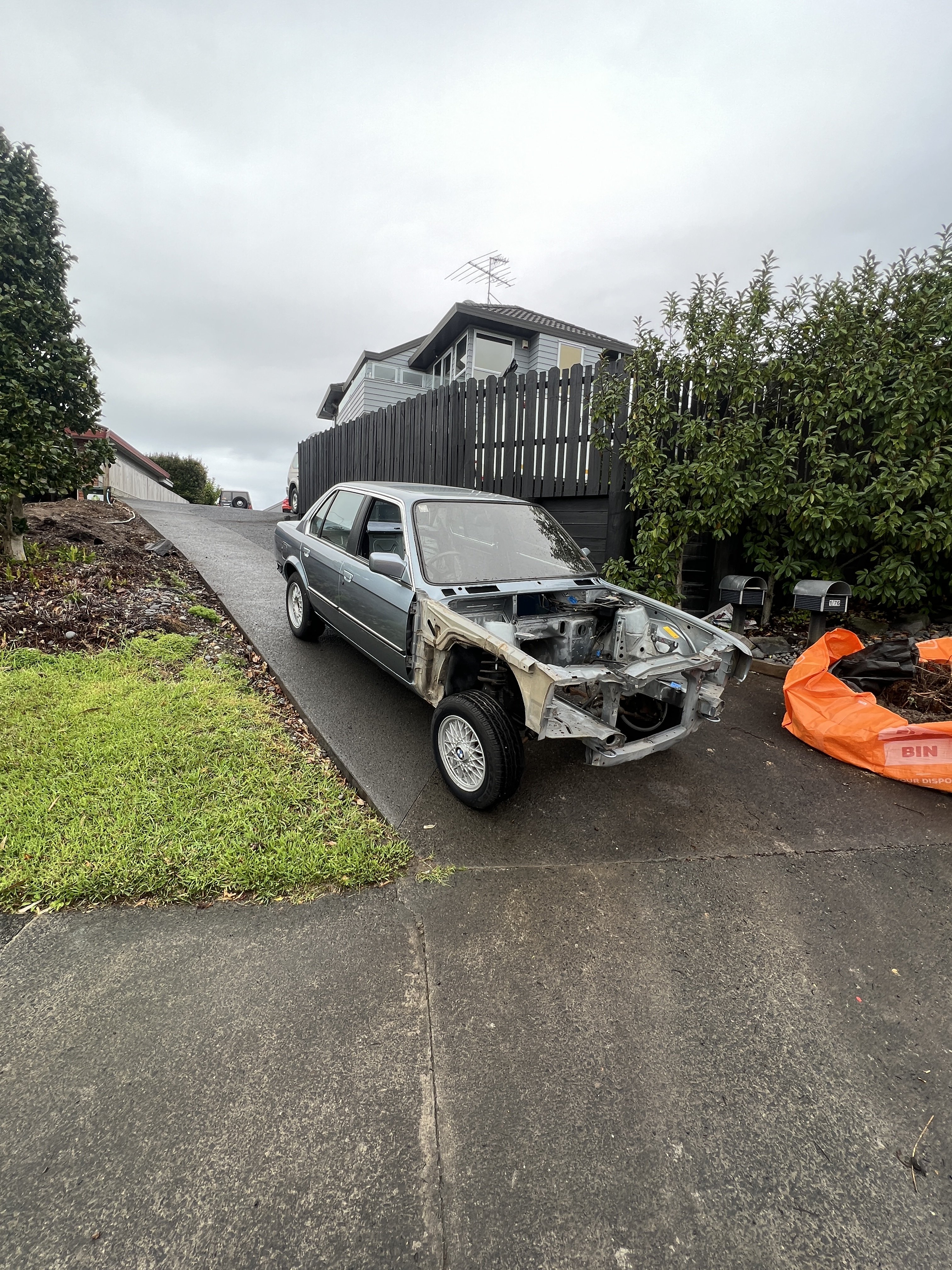

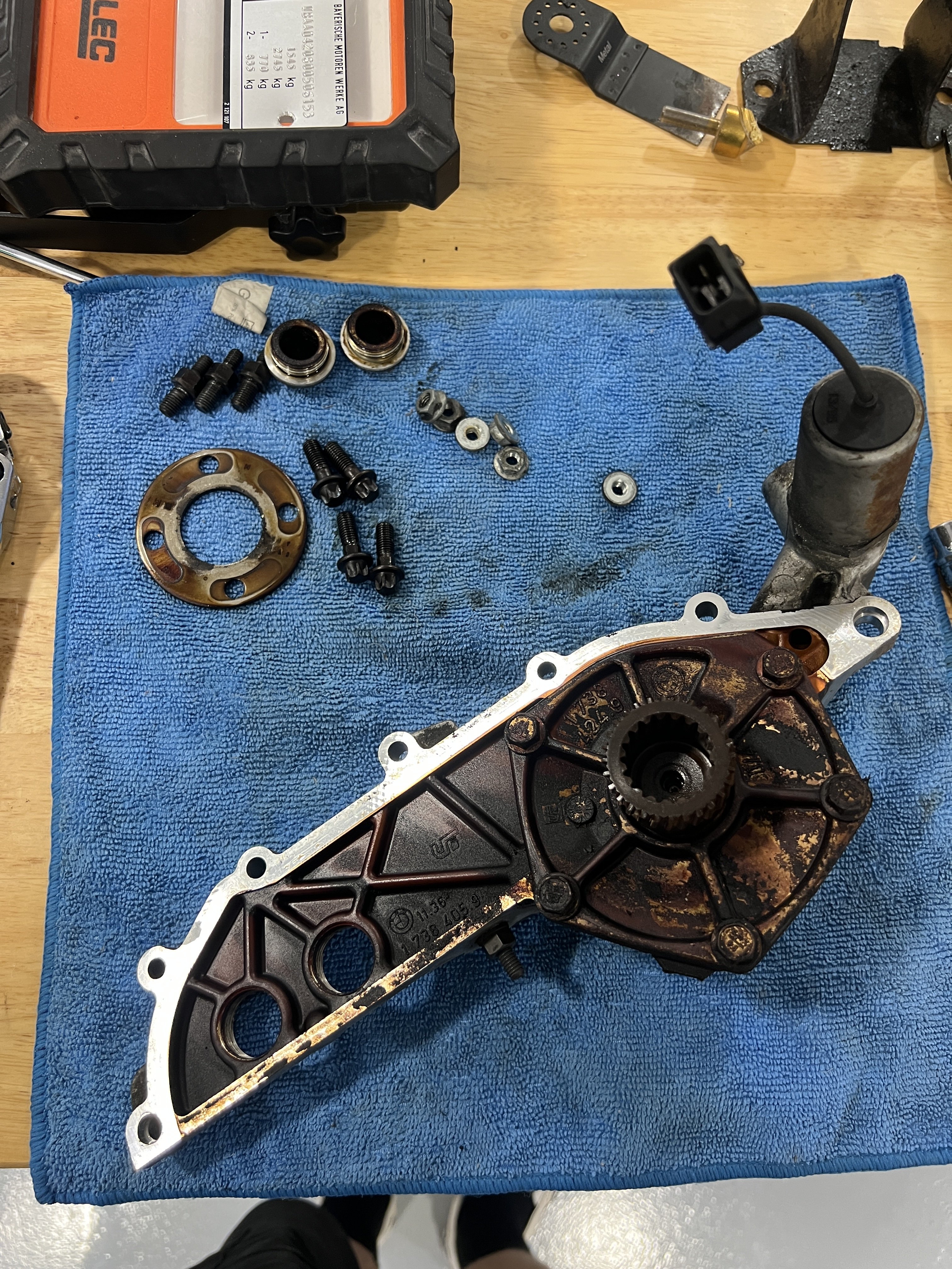

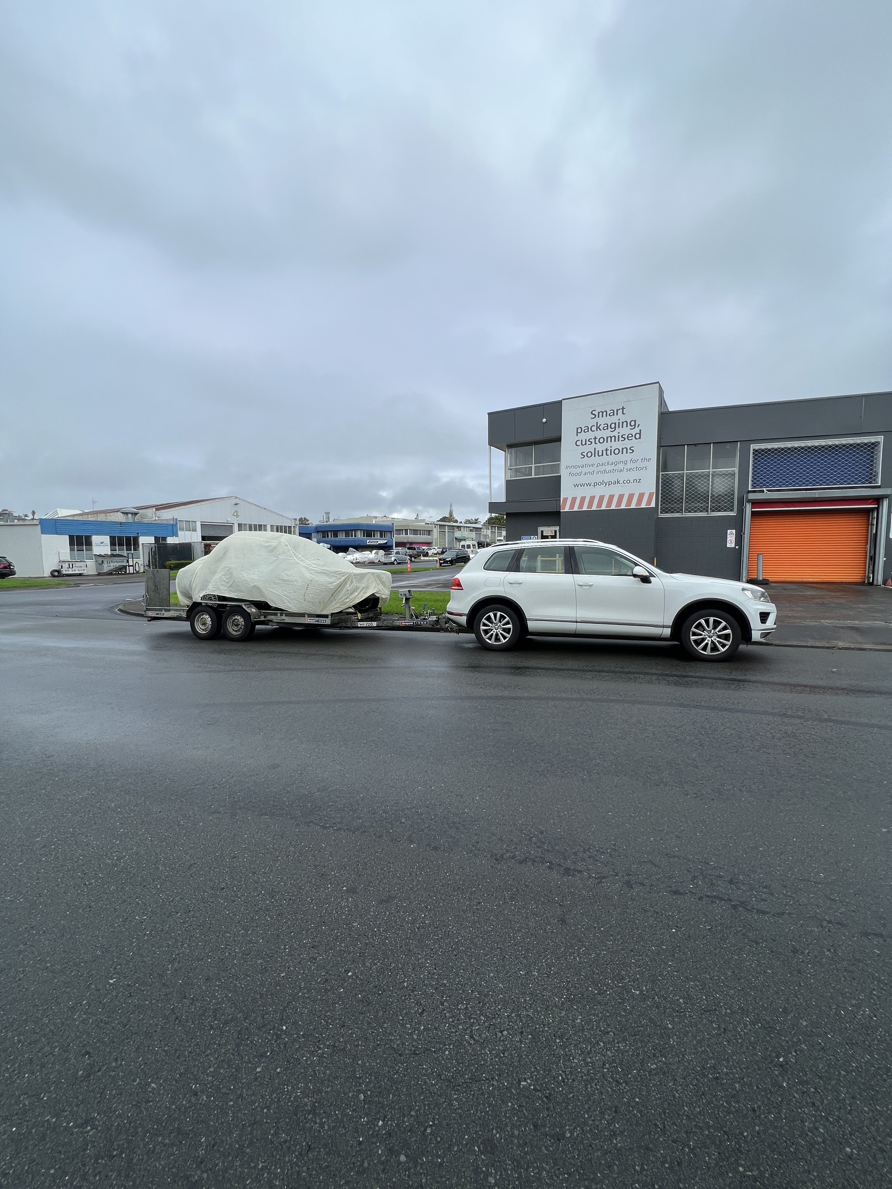

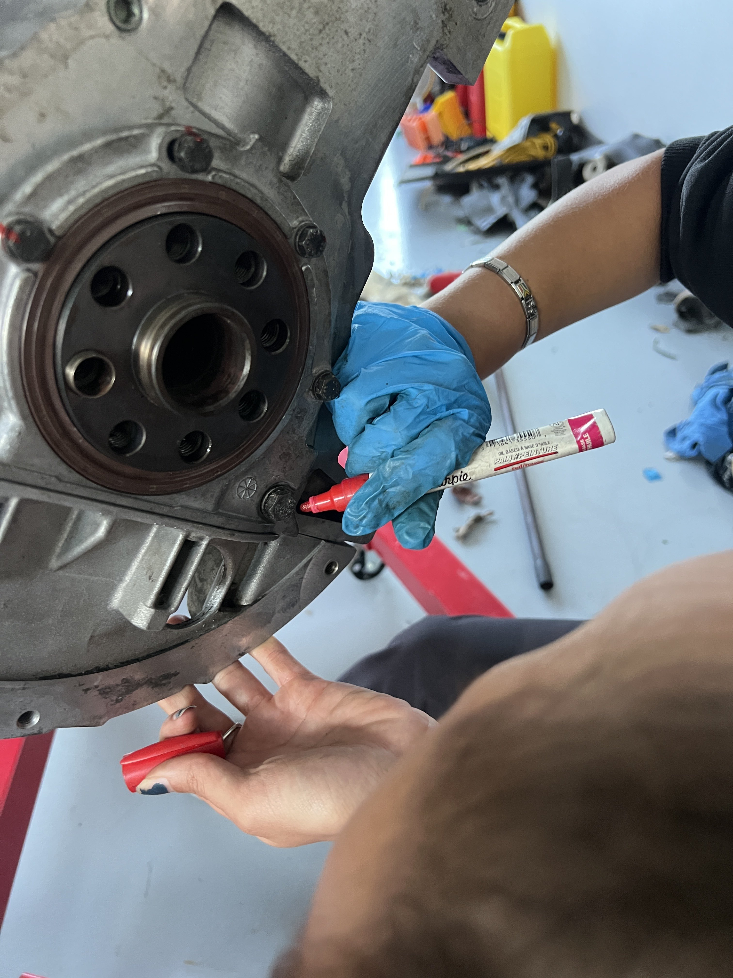

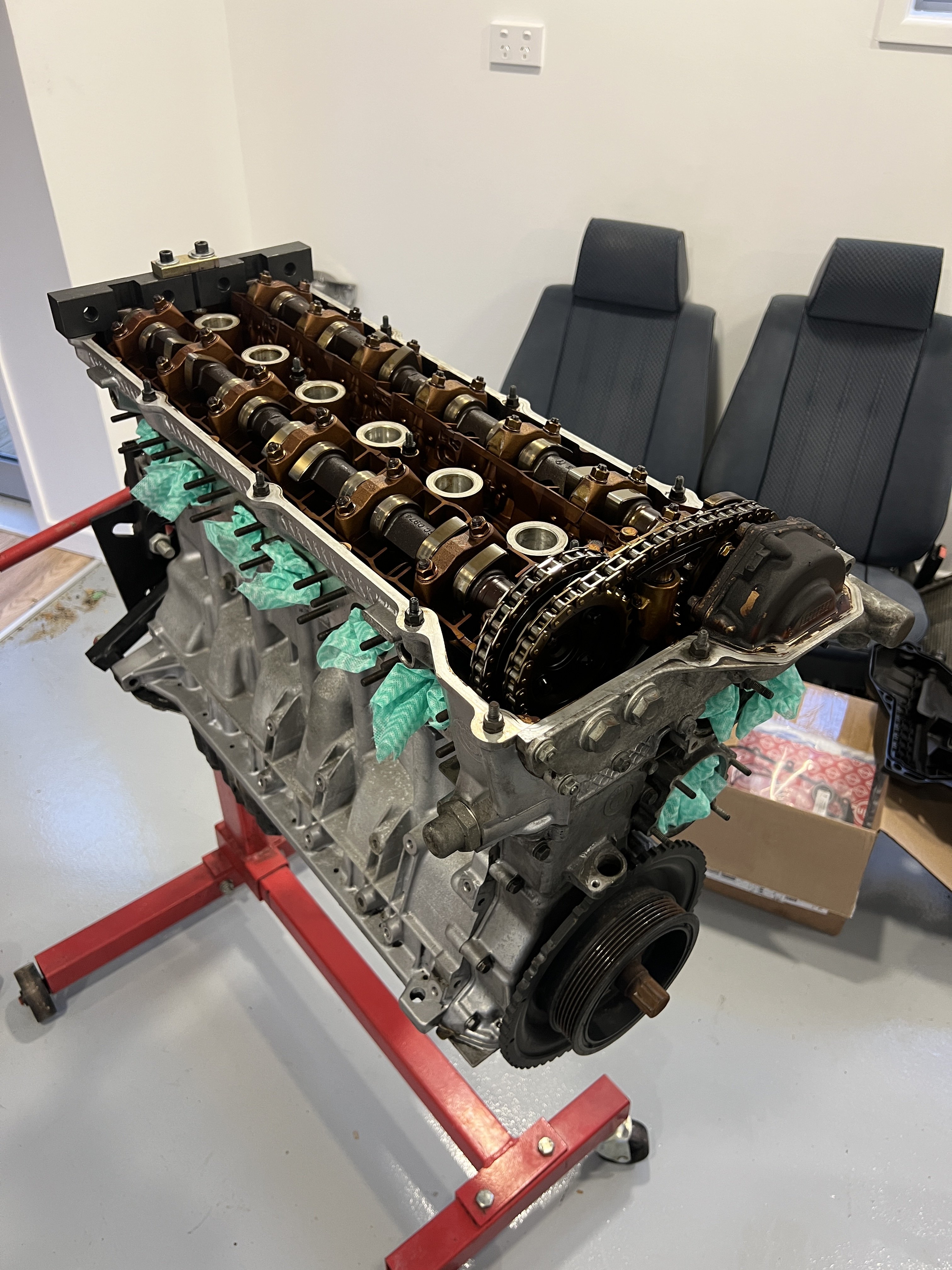

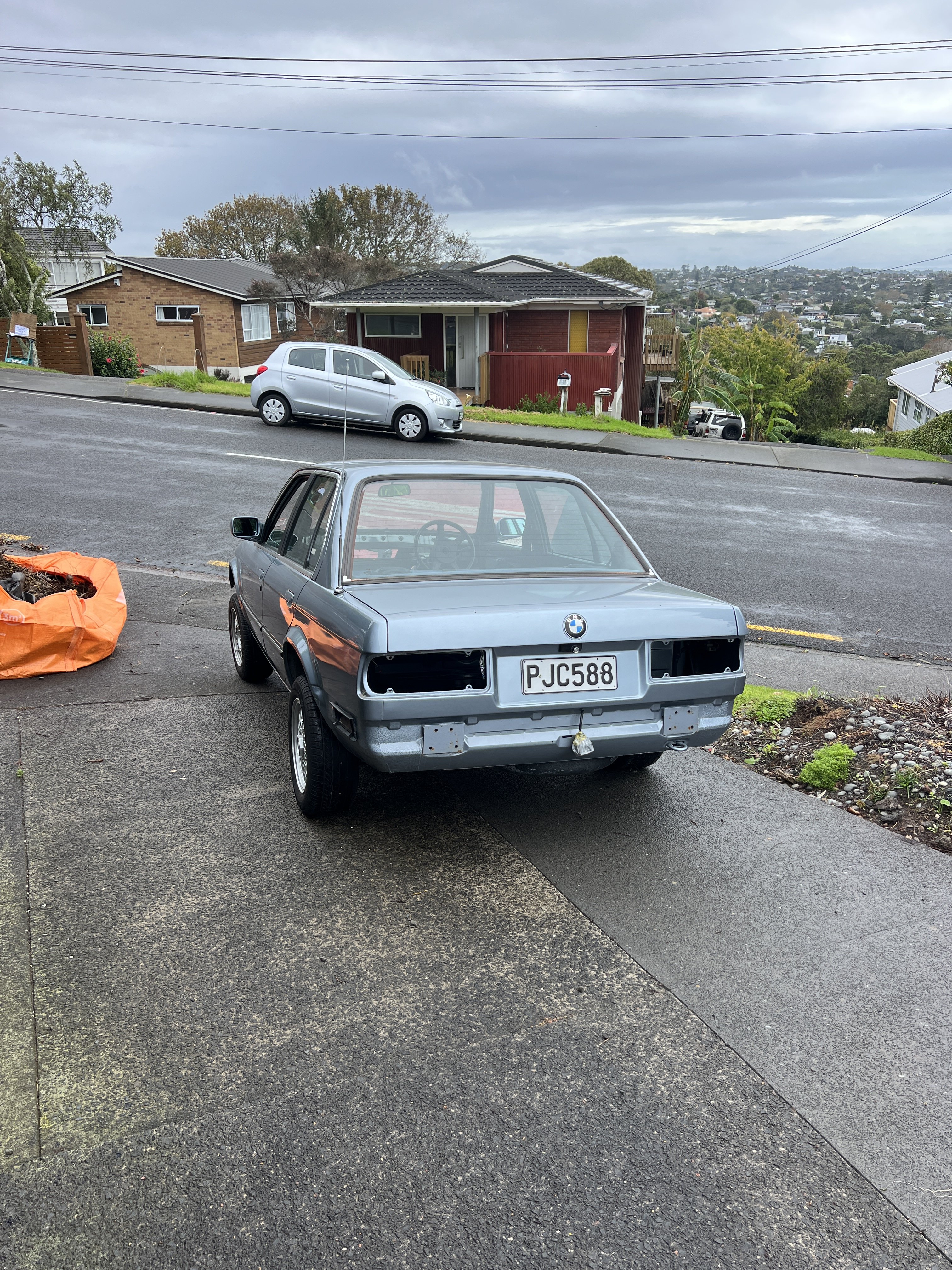

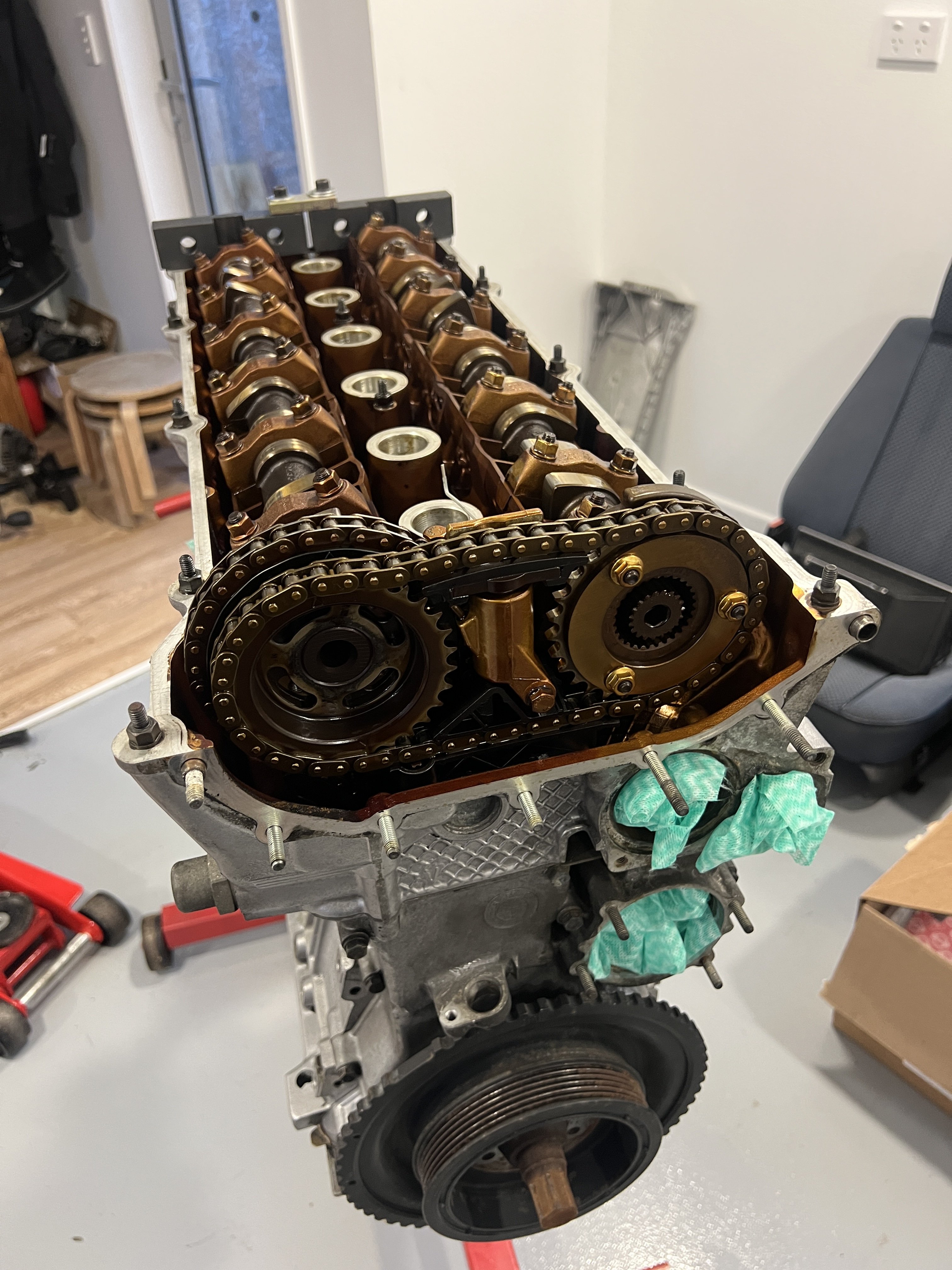

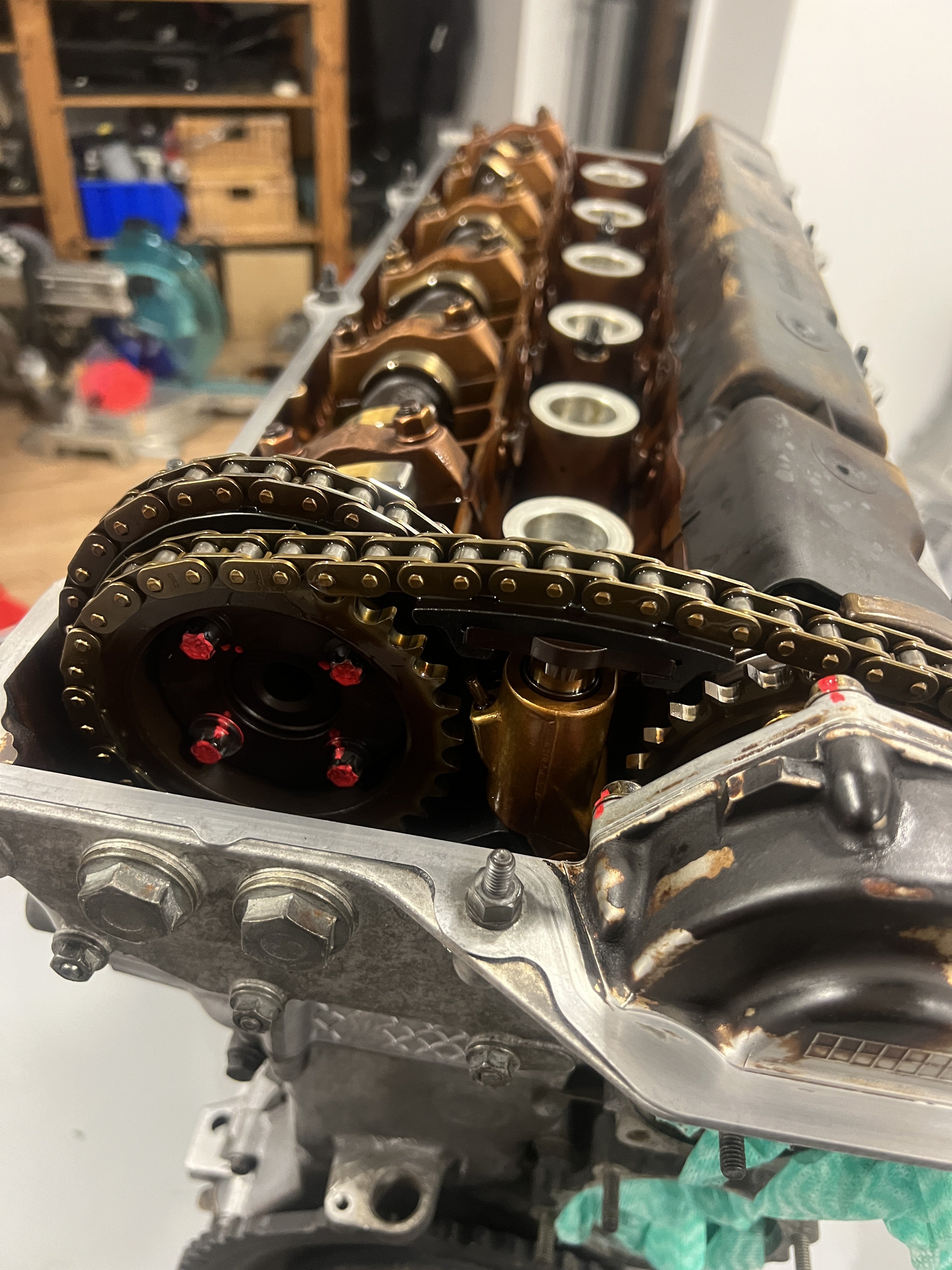

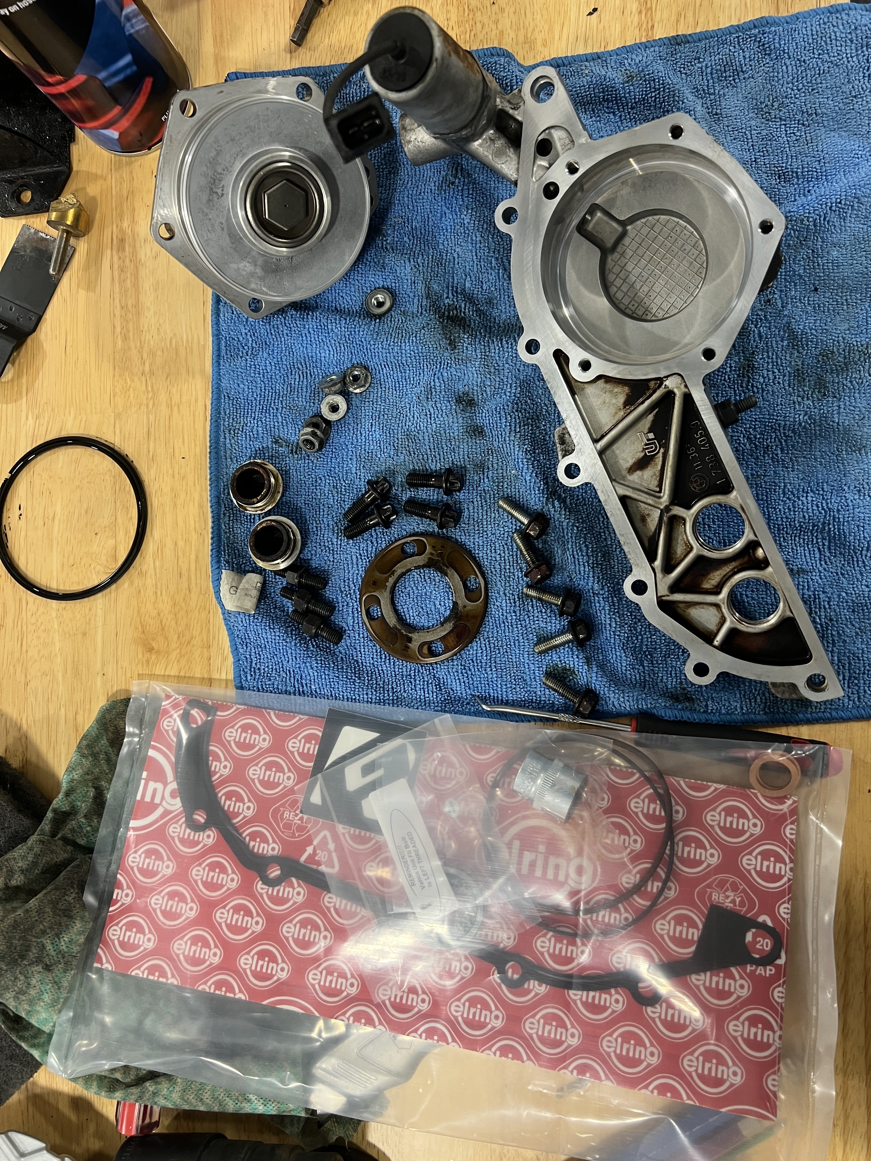

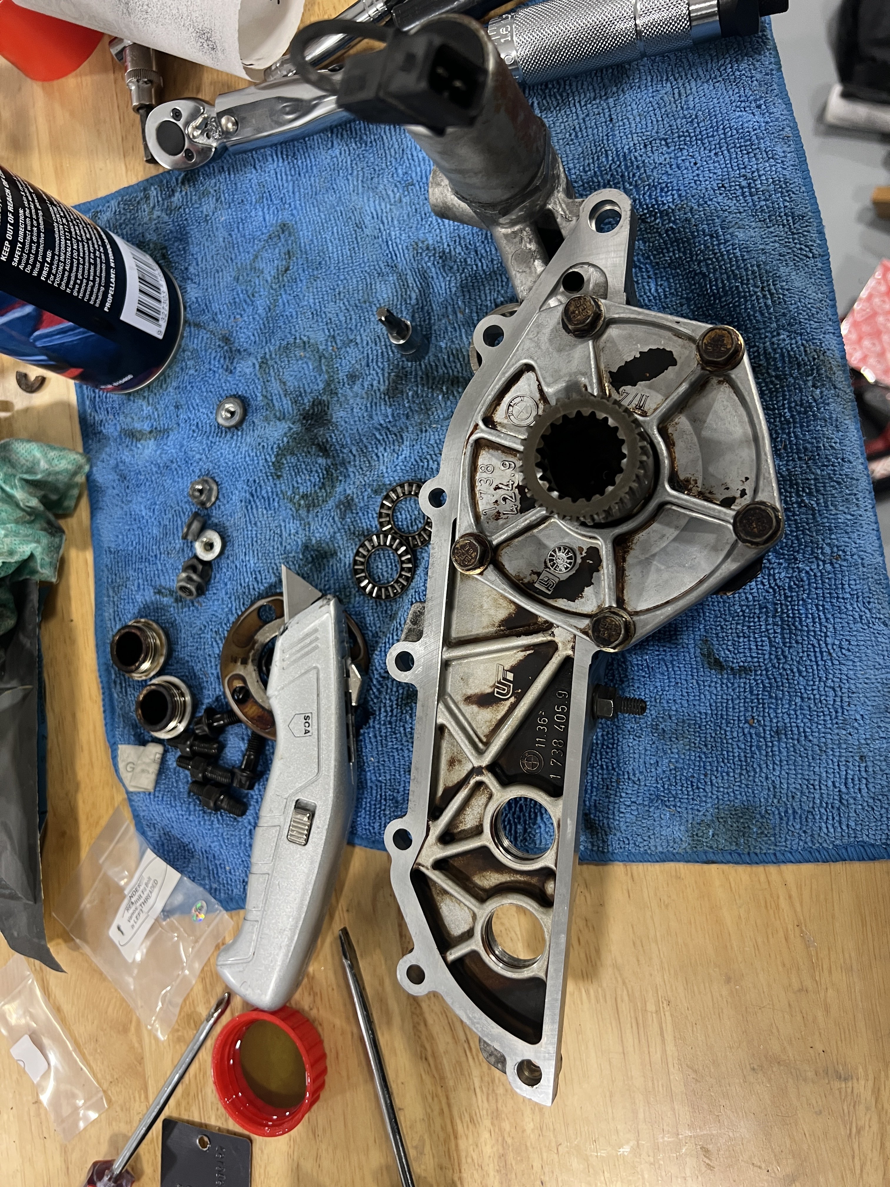

elias 405 Report post Posted April 26 Finally got things moving with the e30. Fixed the touareg last week, so hired a trailer, rolled the e30 out the garage and down the driveway, loaded it up and took it to the panelbeater. It’ll be there for 2-3 weeks getting the rust hole fixed, the engine bay resprayed and the boot lip area rust will be sorted as well. picked up an engine crane off my mate, and made a start on the m52 refresh. Did the vanos rebuild last night, took a couple attempts to get the bearing preload right but not too bad. Reinstalled that hopefully it all works nicely. so far plan is to replace rear main and it’s housing gasket, sump gasket, valve cover gasket, oil filter housing gasket. Wire tie oil pump nut, delete the oil level sensor from the e34 oil pan, and do fresh oem pcv System. Anything else that’s work doing? Do the front timing covers ever leak? Seems like a bit of a pain to do with it being jammed up under the head gasket. 3 Quote Share this post Link to post Share on other sites

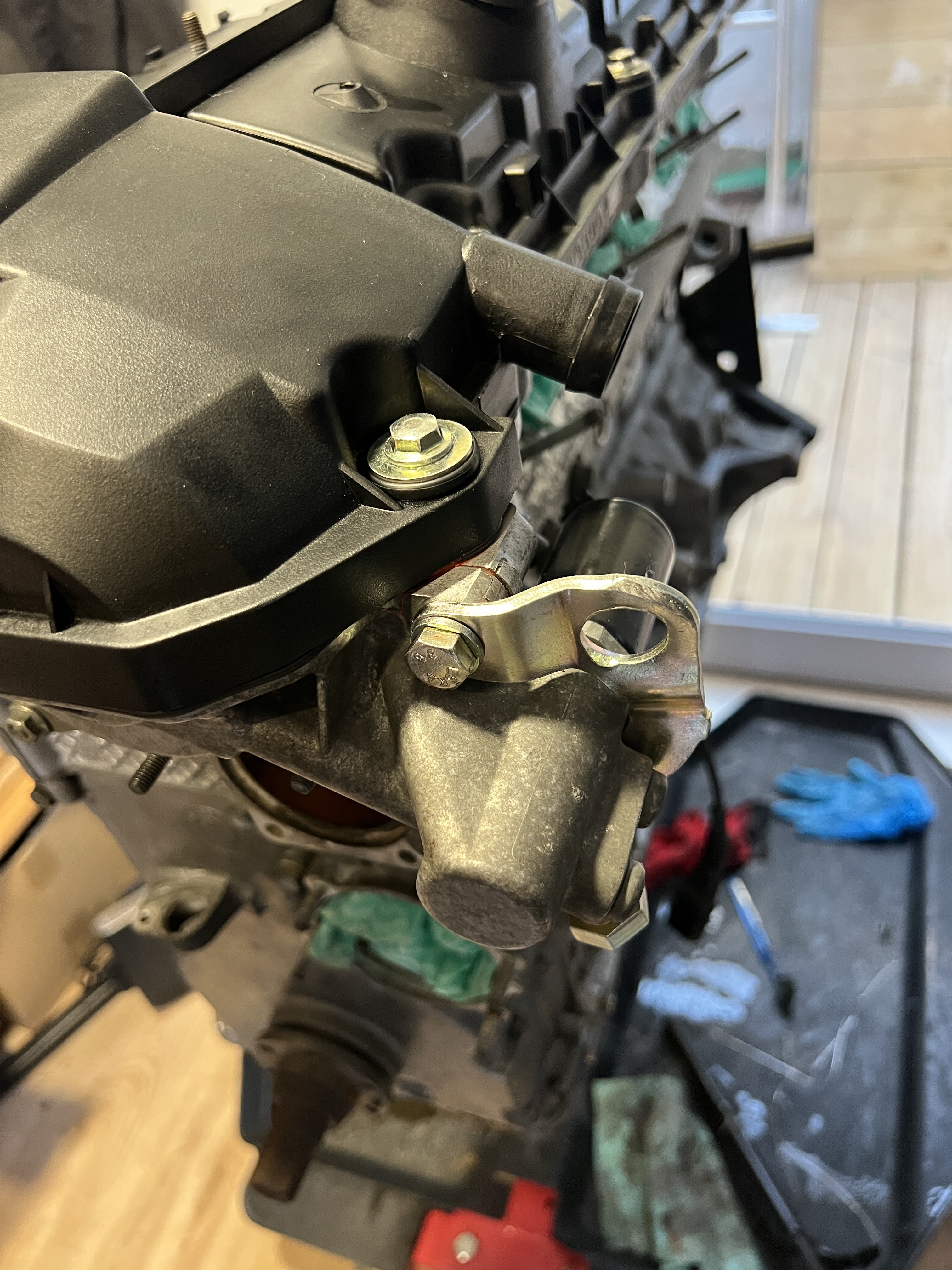

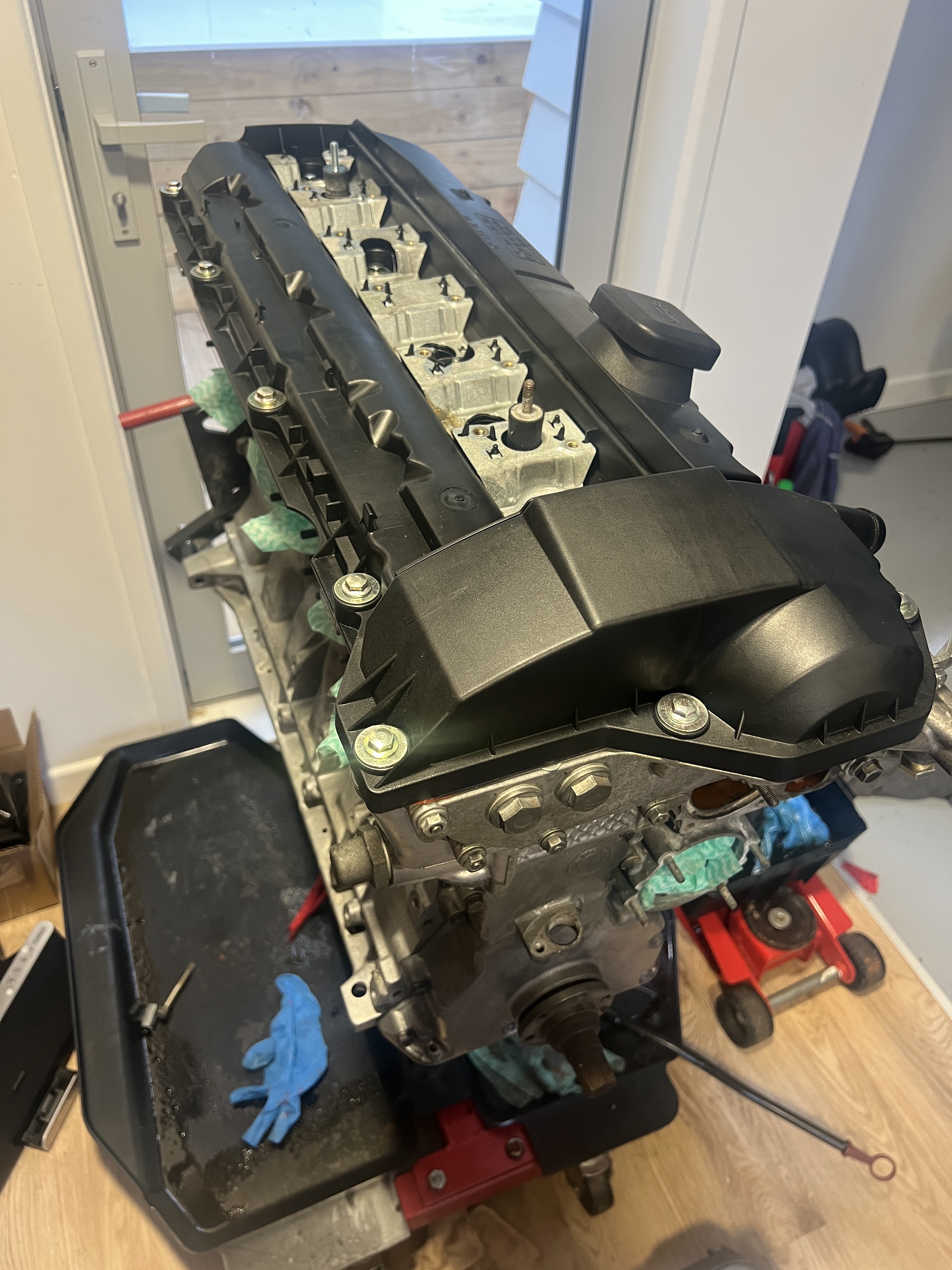

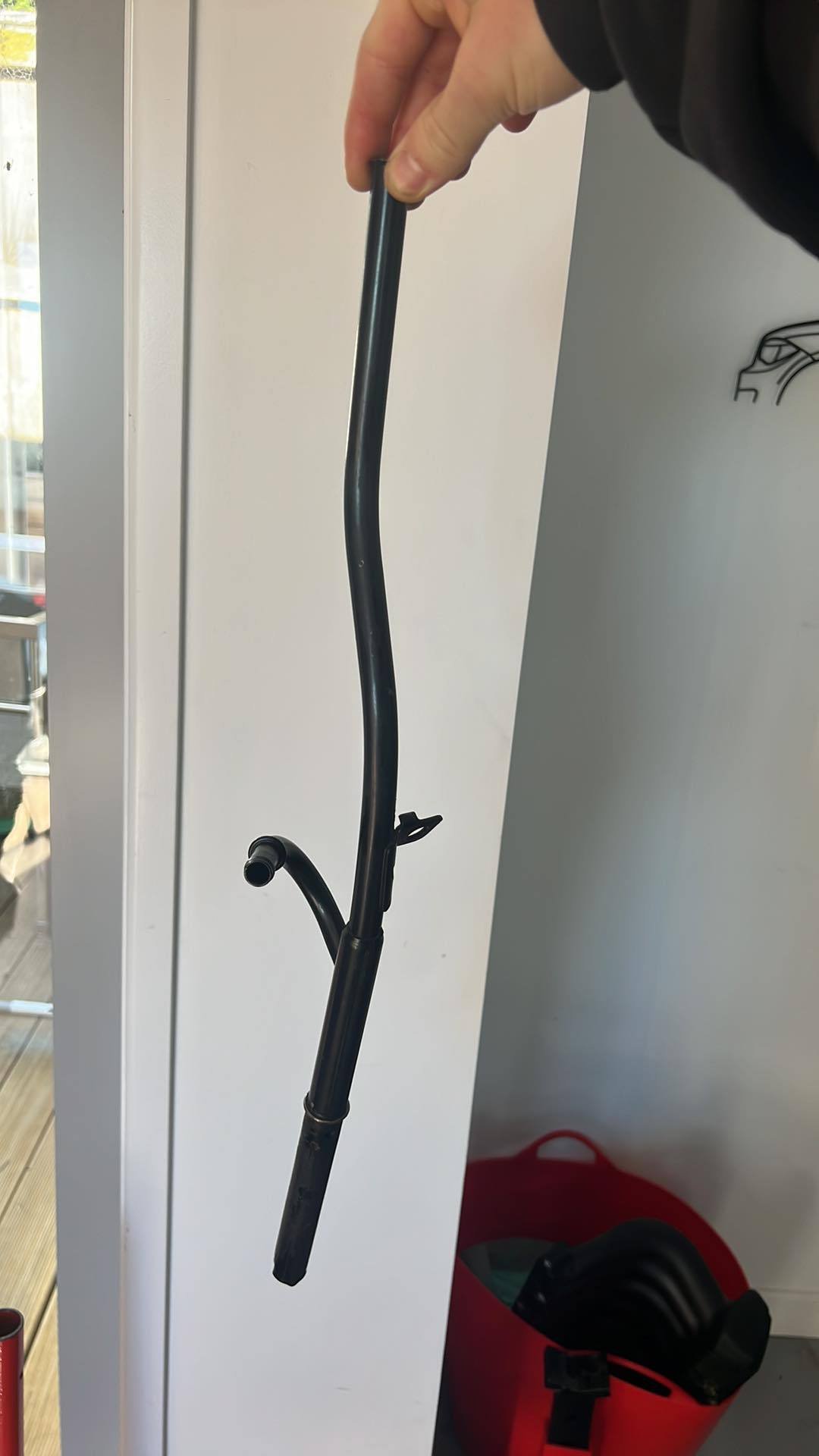

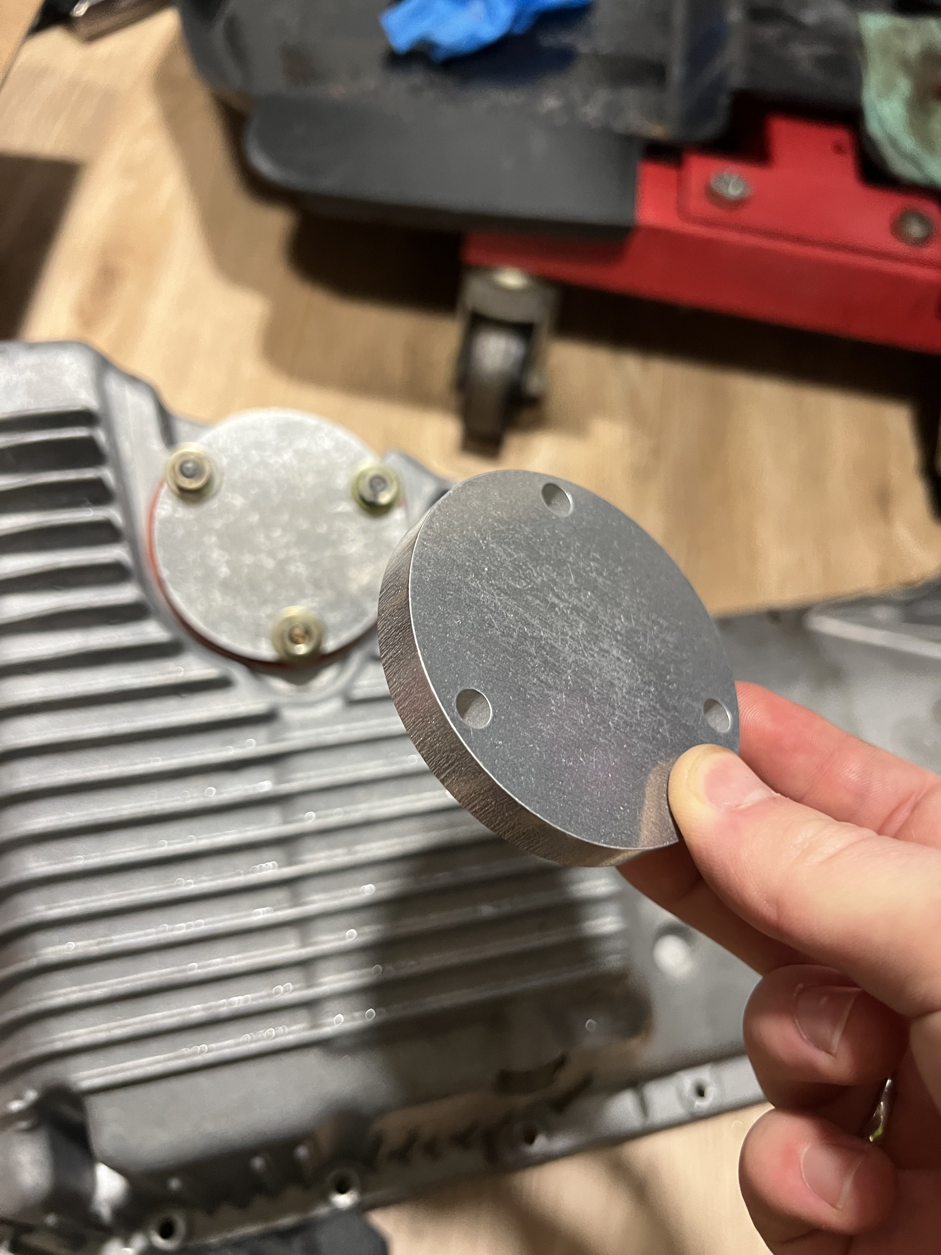

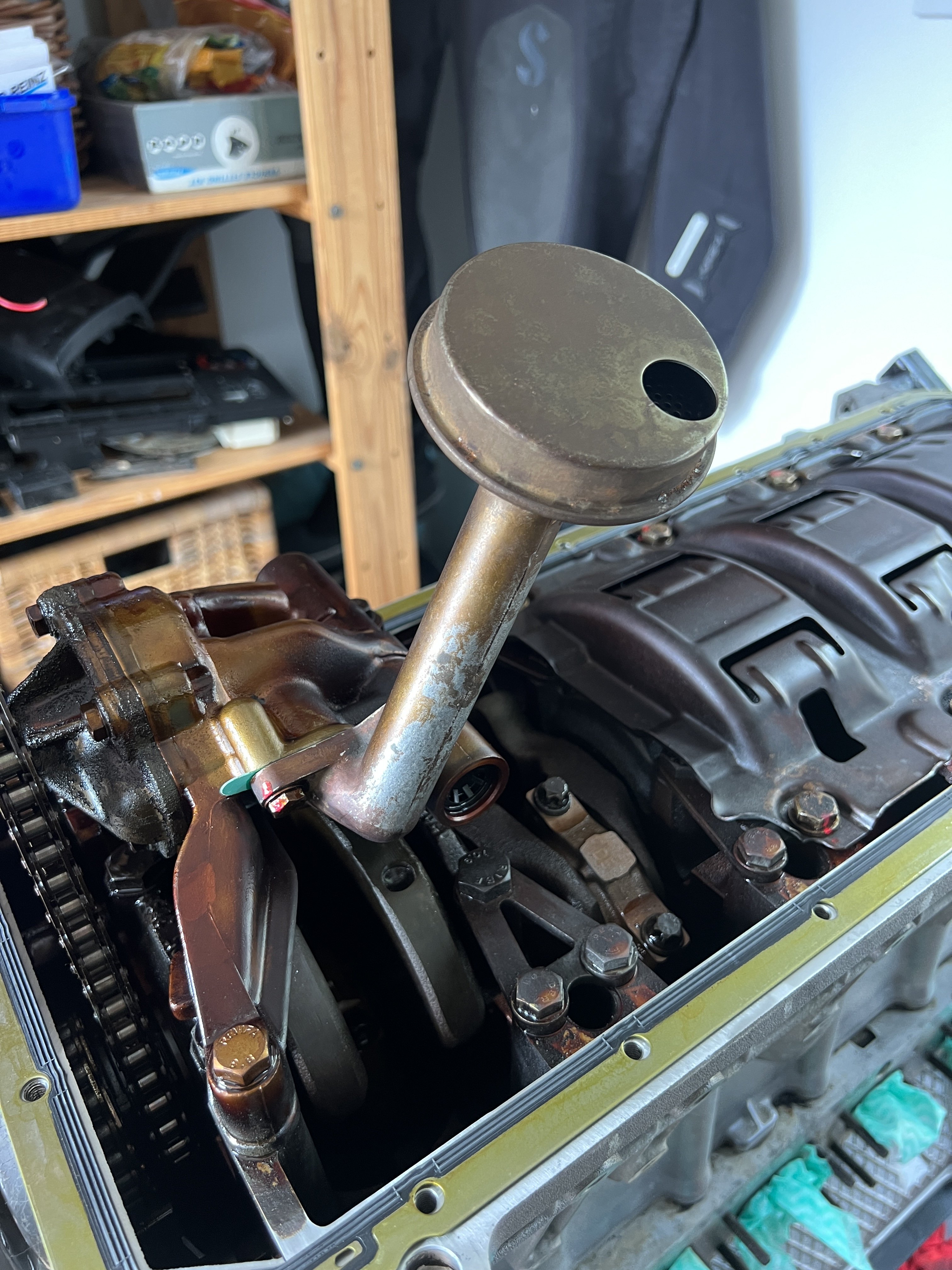

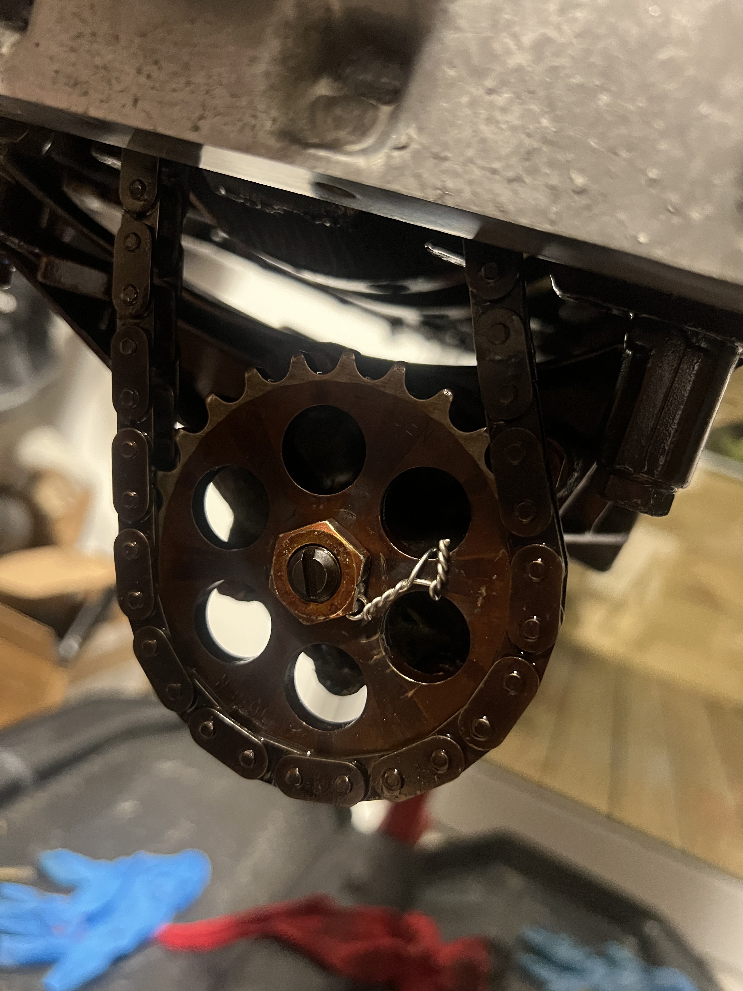

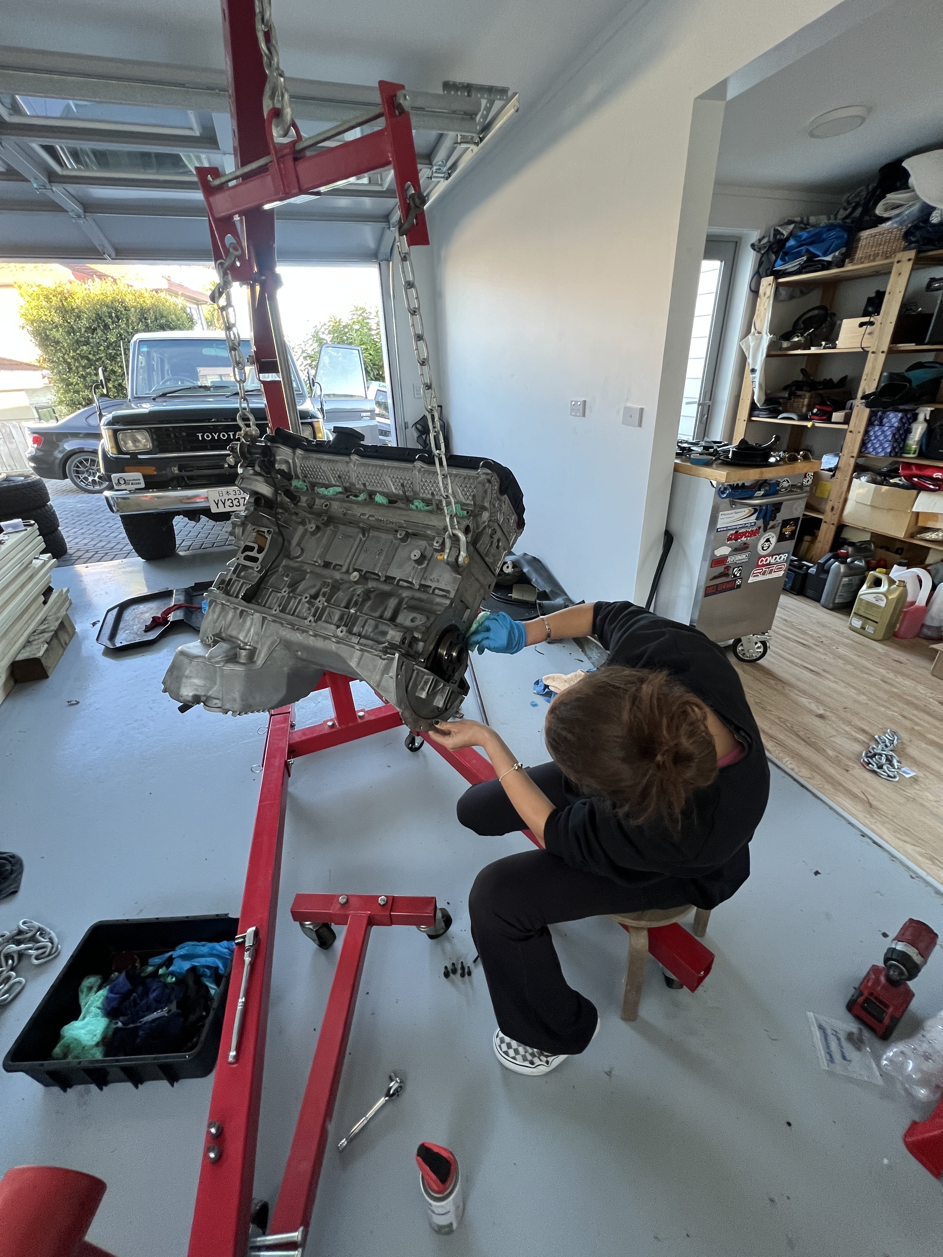

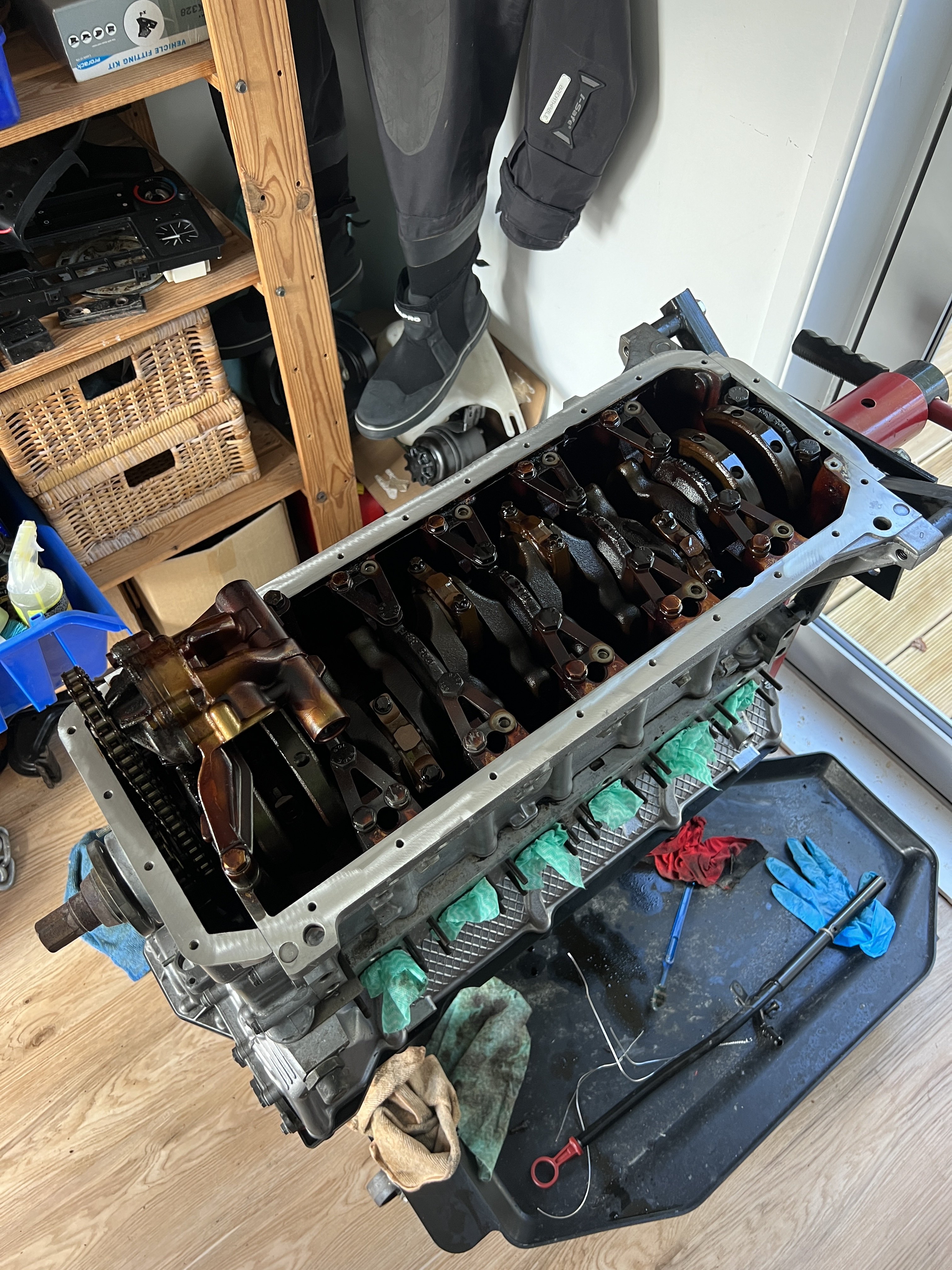

elias 405 Report post Posted May 6 Keeping busy working on the m52 while the car is at the panelbeaters. Even managed to get some free labour, my girlfriend helped me over the weekend and we got the valve cover back on with a fresh gasket a couple dots of rtv and some freshly zinc coated oem hardware. Pulled the sump off, wire tied the oil pump nut. Realised I’ve got the wrong oil pick up, traded it for the one I’m after which should be here Friday. Chopped the rear sump oil pickup support bracket off the windage tray to make the front sump fit. Picked up the engine with the crane to get access to the rear of it and replaced the rear main seal. Back on the stand now, ready to sort out the sump situation. Just need to figure out what to do about the dipstick tube, the one I’ve got doesn’t look quite right. Also drew up and waterjet cut a little oil lever sensor delete plate out of some 10mm aluminium. Sealed on with some rtv, was too lazy to mill an oring groove. i do have a spare one of these as well if anyone is looking for a solution to the hole in their oil pan, oem version is NLA. Hopefully get some more work on the engine done this weekend. If anyone has the correct dipstick tube + dipstick for a front sump for an m52 let me know. 2 Quote Share this post Link to post Share on other sites
nick496 271 Report post Posted May 8 Dipstick tube should work. Mine looks similar and came off a 728i, so they are different to the typical e34 ones. 1 Quote Share this post Link to post Share on other sites
elias 405 Report post Posted May 10 On 5/8/2025 at 11:09 PM, nick496 said: Dipstick tube should work. Mine looks similar and came off a 728i, so they are different to the typical e34 ones. Right Sweet as will try make it work, although I do have an e34 one on the way now. Quote Share this post Link to post Share on other sites

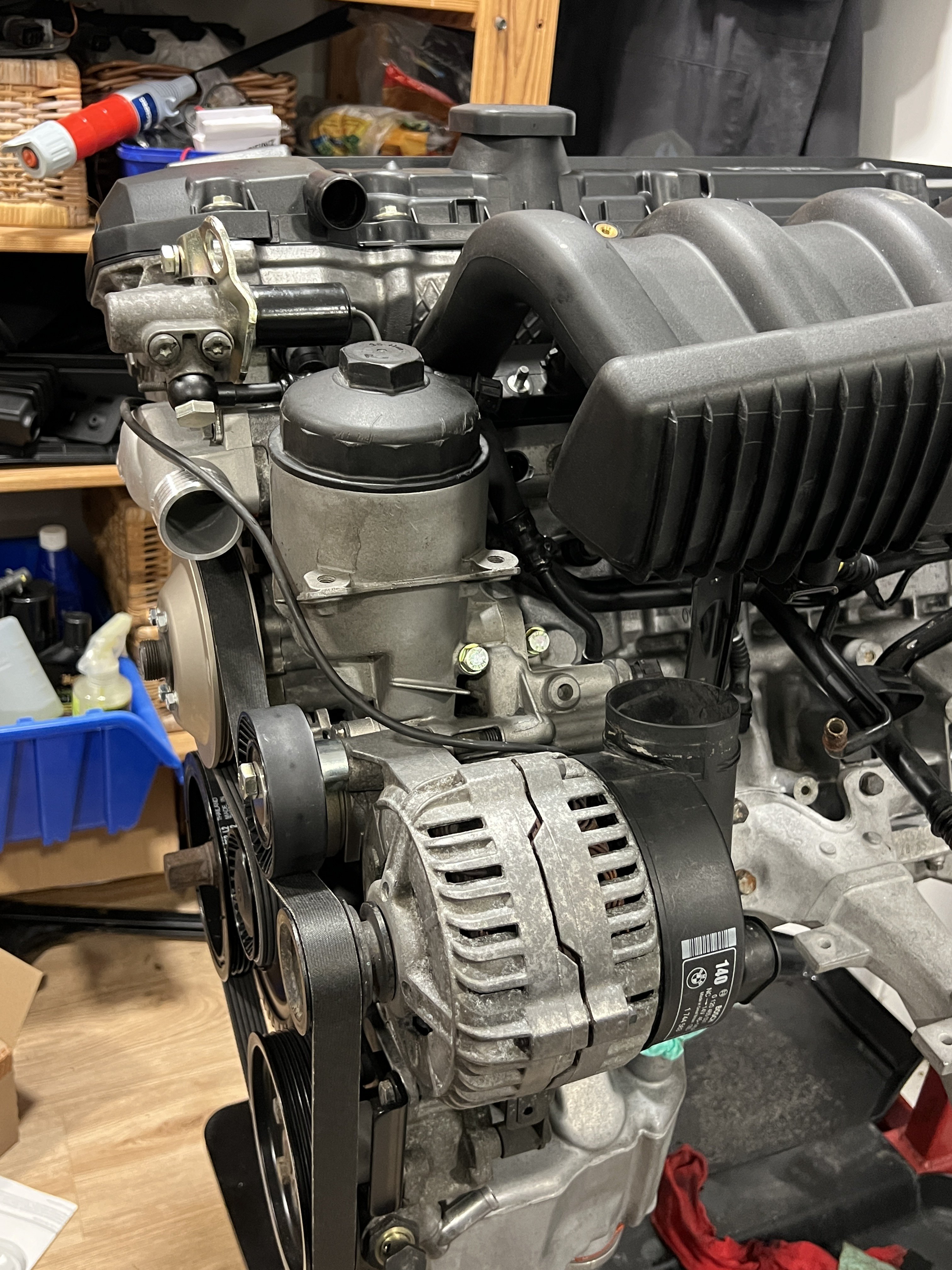

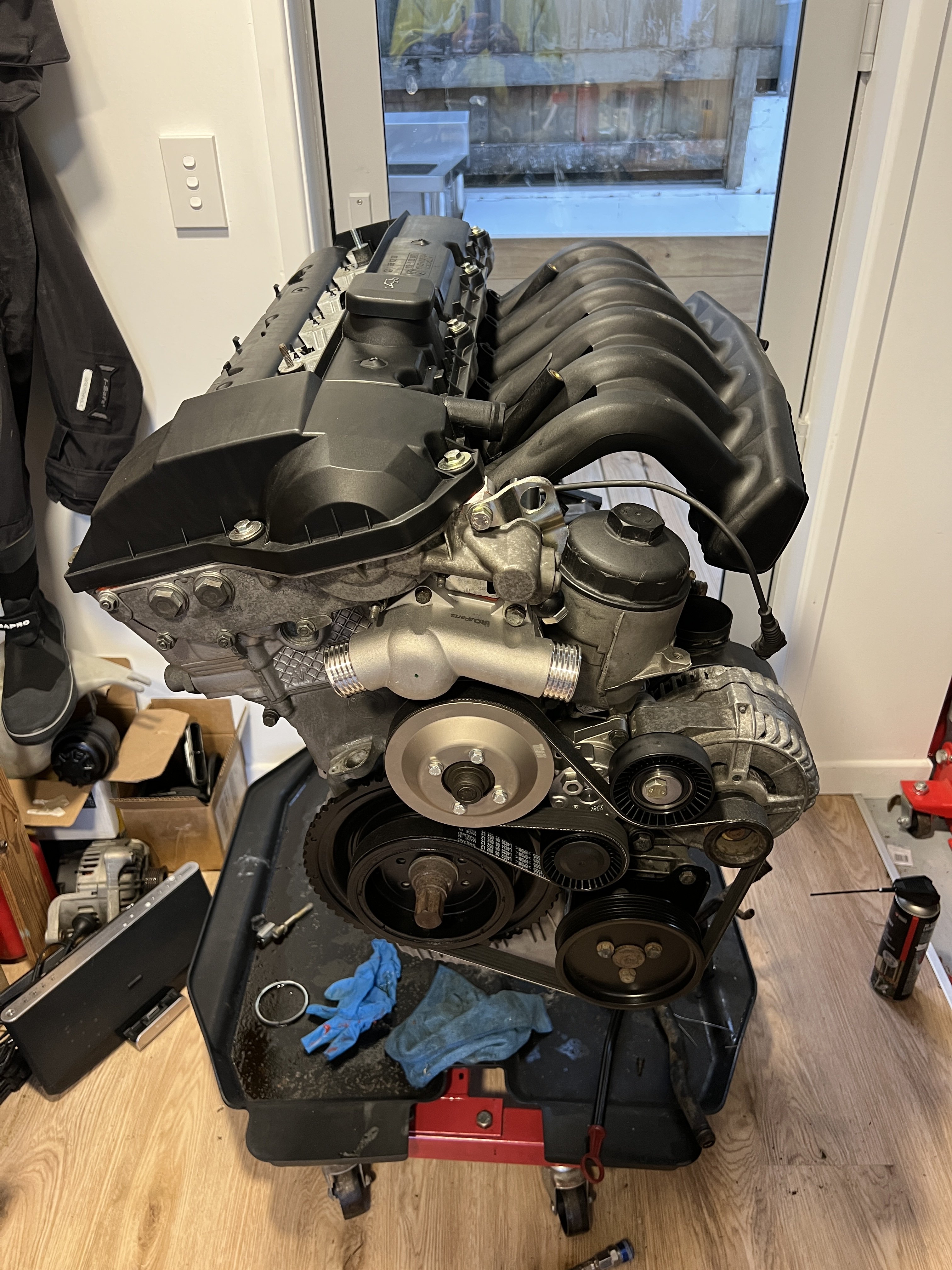

elias 405 Report post Posted May 10 Made some more progress, engine is starting to look like an engine lots of bits back on now. Front sump swap done, new lower temp thermostat, waterpump, waterpump pulley, thermostat housing, tensioner, idler, belt. Power steering pump and oil filter housing back on too, as well as knock sensors etc. Will be deleting throttle heater and using the feed port from the head for the e30 dash temp sensor, have one with the correct e30 plug and m52 thread pitch. Just need to find some shorter bolts for the crank pulley now that I’m not using the AC pulley. car is still at the panelbeaters for a week or two but they’ve made some progress which is good. Next up to figure out the whole intake manifold assembly with icv, pcv, Evap etc. 1 Quote Share this post Link to post Share on other sites
