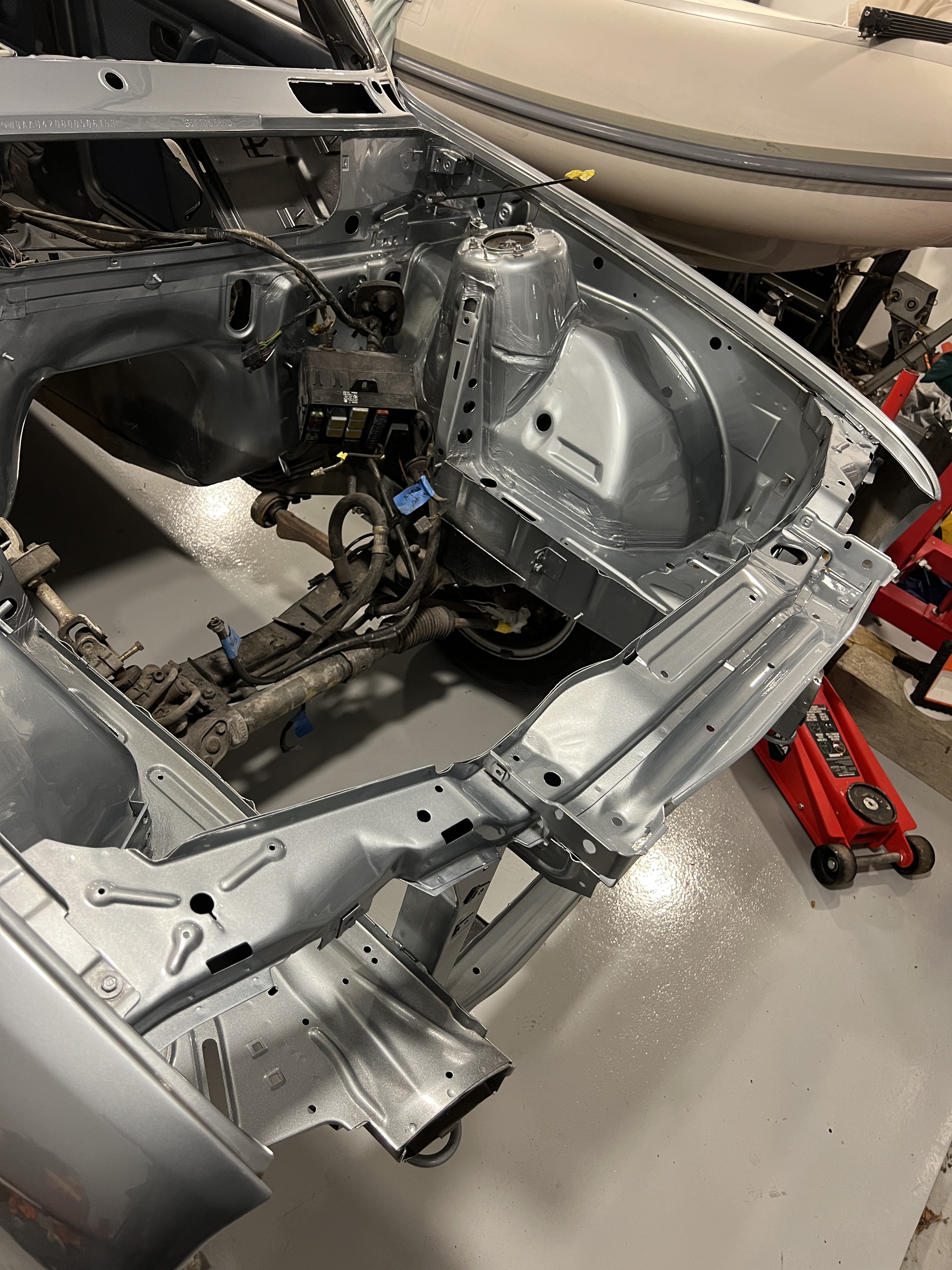

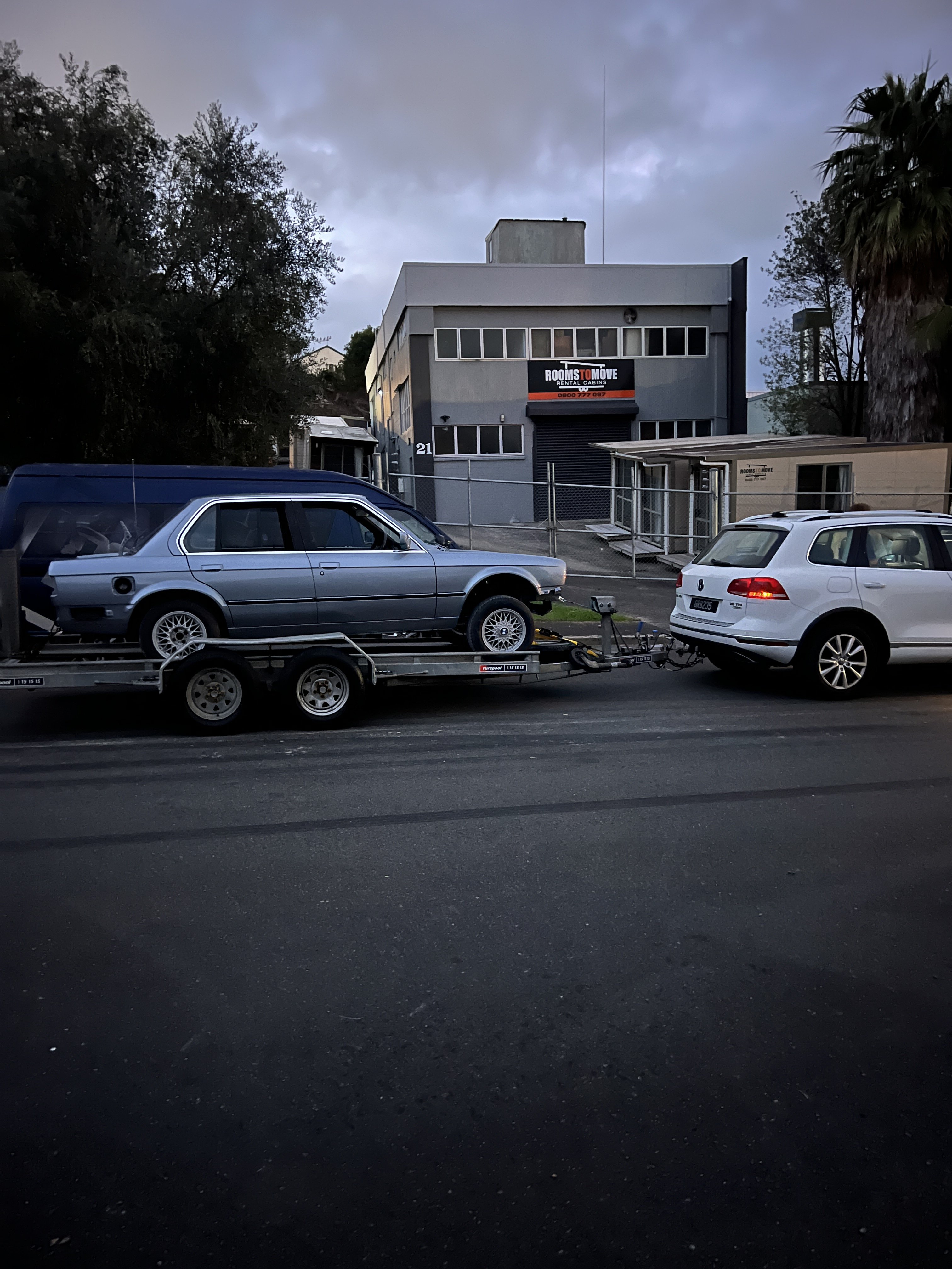

elias 454 Report post Posted May 13 Got a message from the panelbeater tonight that the cad was done. Went and fetched it after work, wasted no time as I was quite excited to have it back. Hired a trailer and jumped in the touareg to collect it. overall very happy with how it looks, yes there are some minor imperfections if you’re being very picky but for the money I paid you absolutely cannot complain. Rust hole is fixed (they chopped a piece of the cowl out to access it, then welded it back in and painted it blending up the a pillar), rust holes in firewall fixed, rust around boot seal lip fixed and painted, as well as entire engine bay/front structure painted. All of that cost half of what another shop had quoted for just the engine bay paintwork. next up I need to waterblast the underside of the car, strip out all the suspension and under seal the whole underside. If anyone has any reccomendations for a good underseal product that can be applied via brush/roller that would be much appreciated, unfortunately don’t have anywhere where I can spray. 10 Quote Share this post Link to post Share on other sites

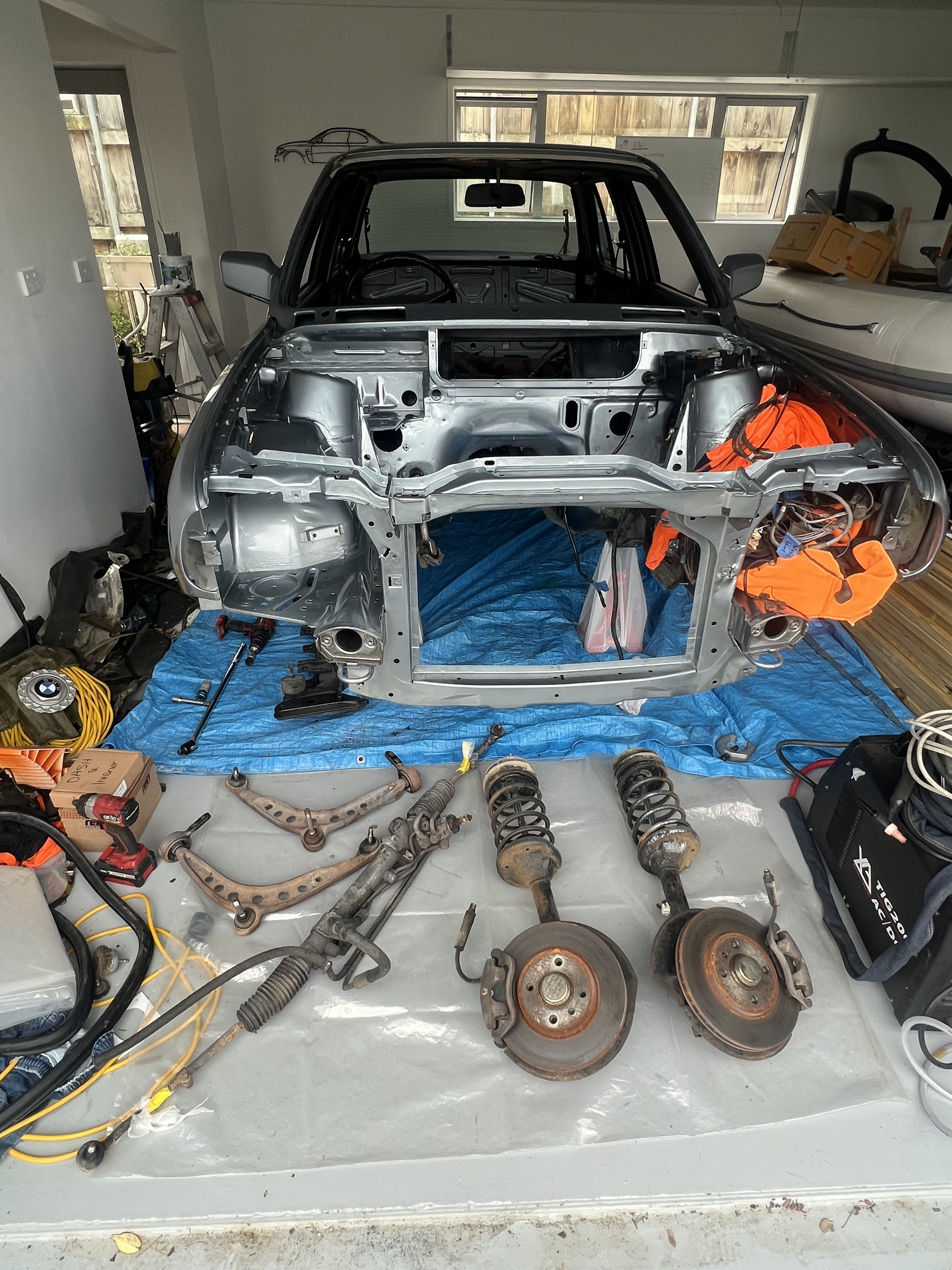

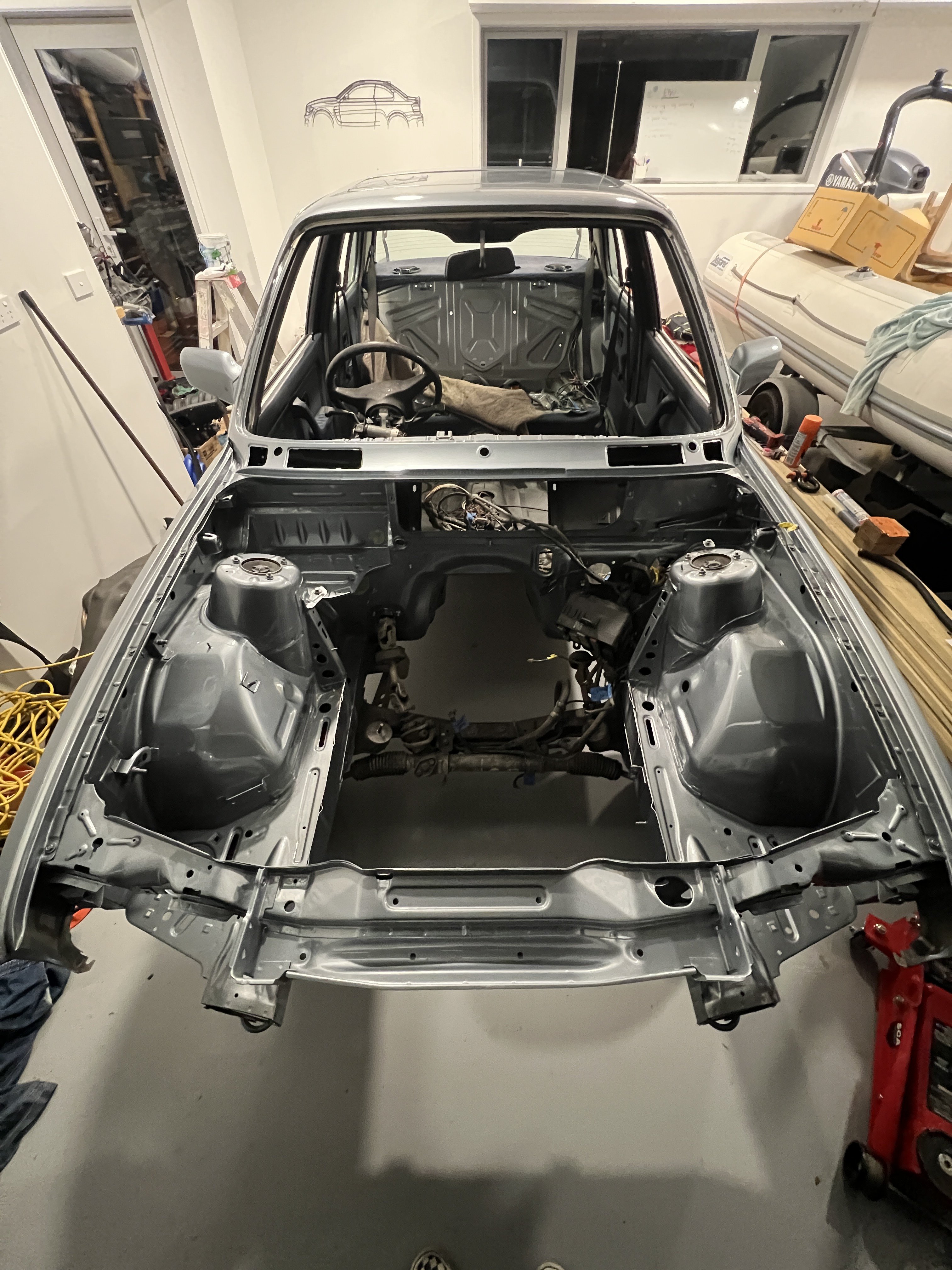

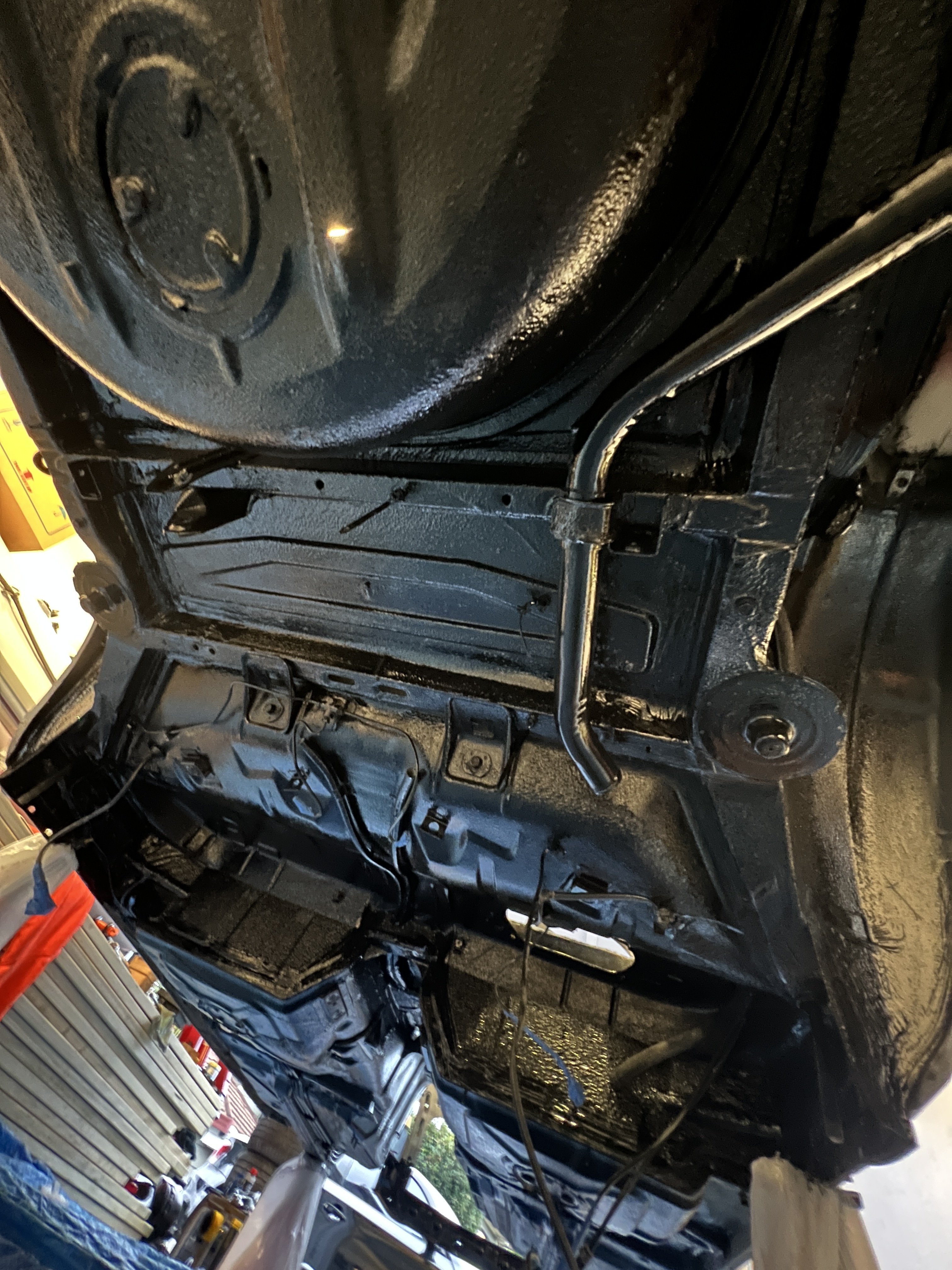

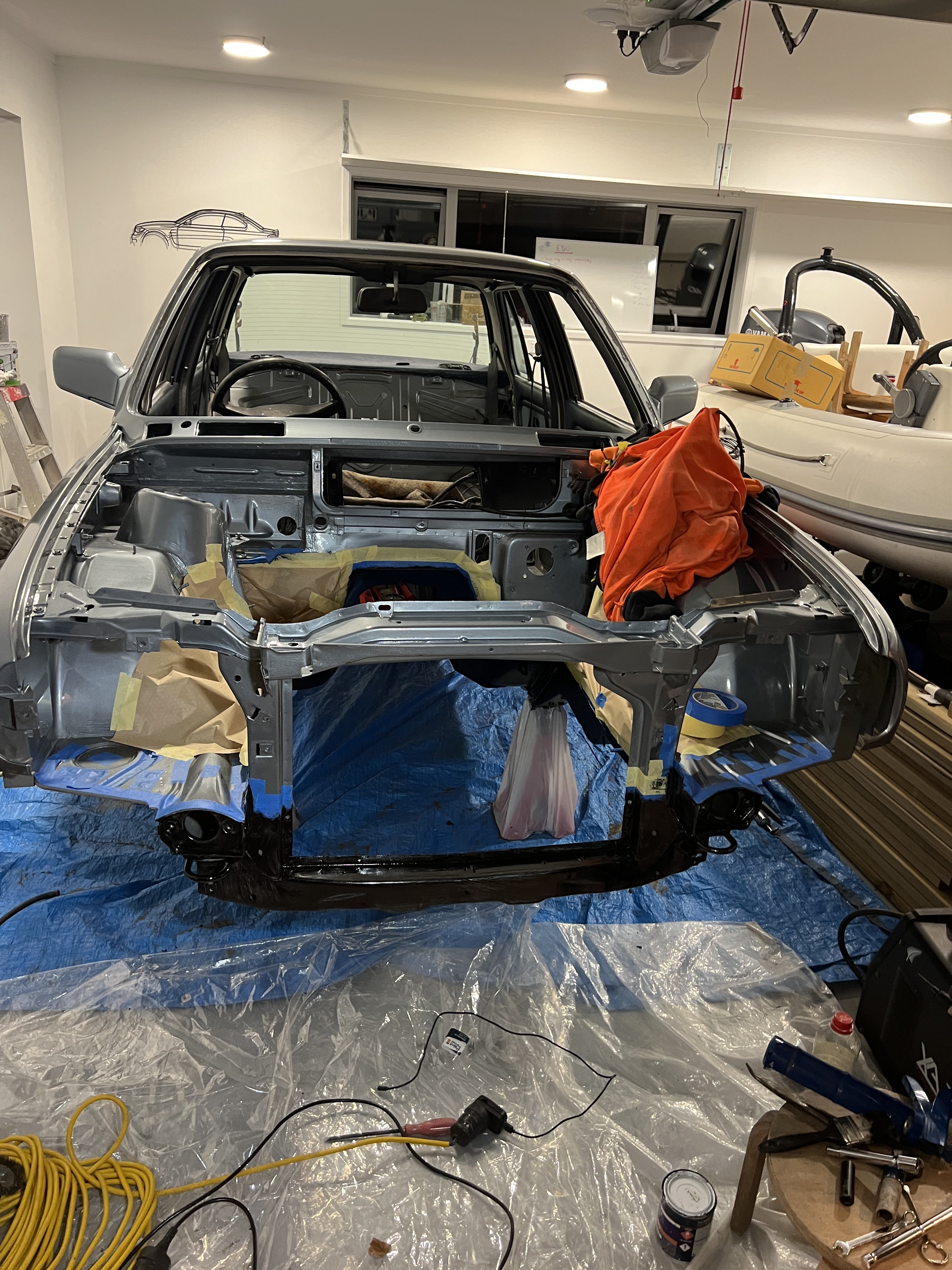

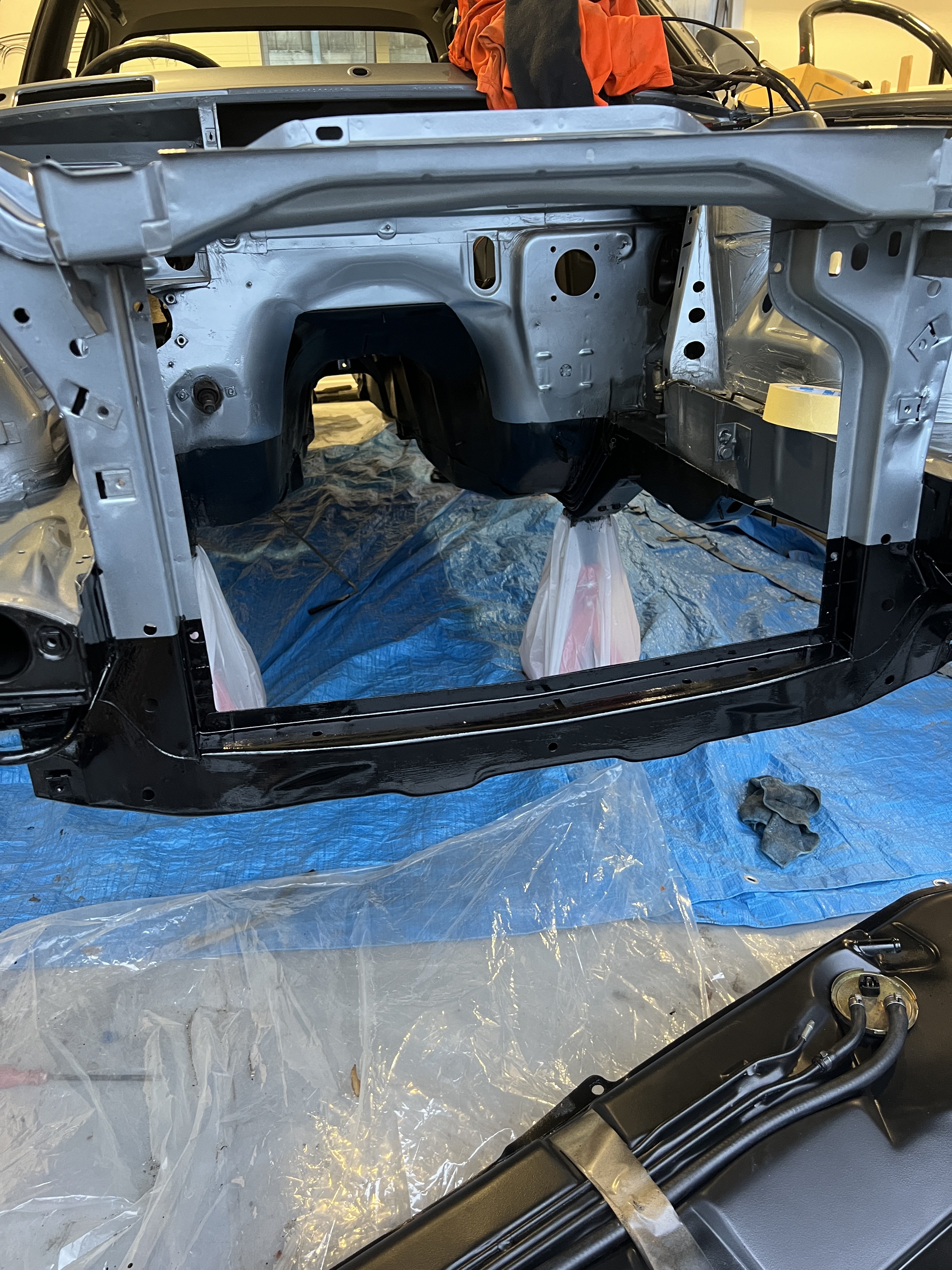

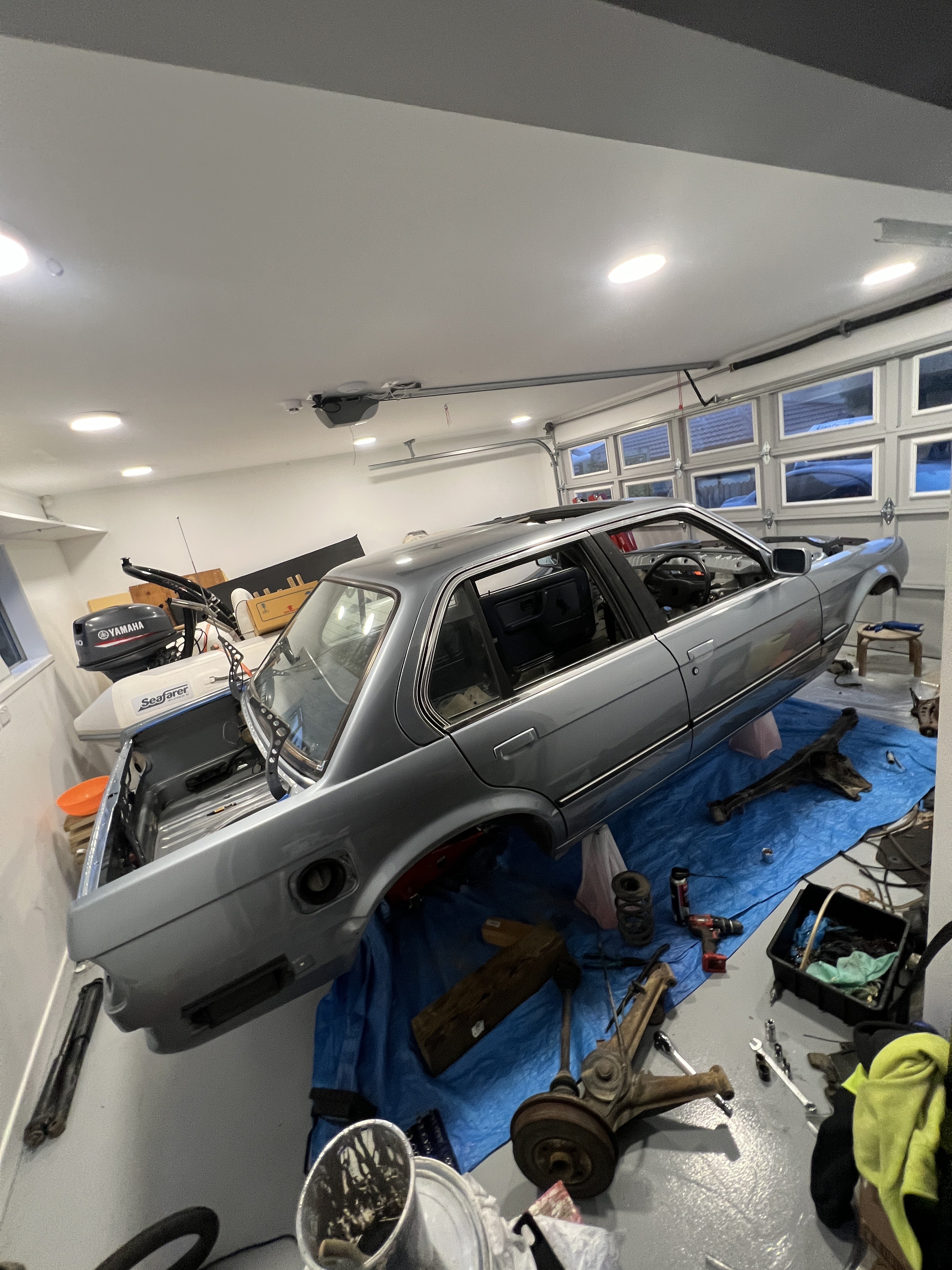

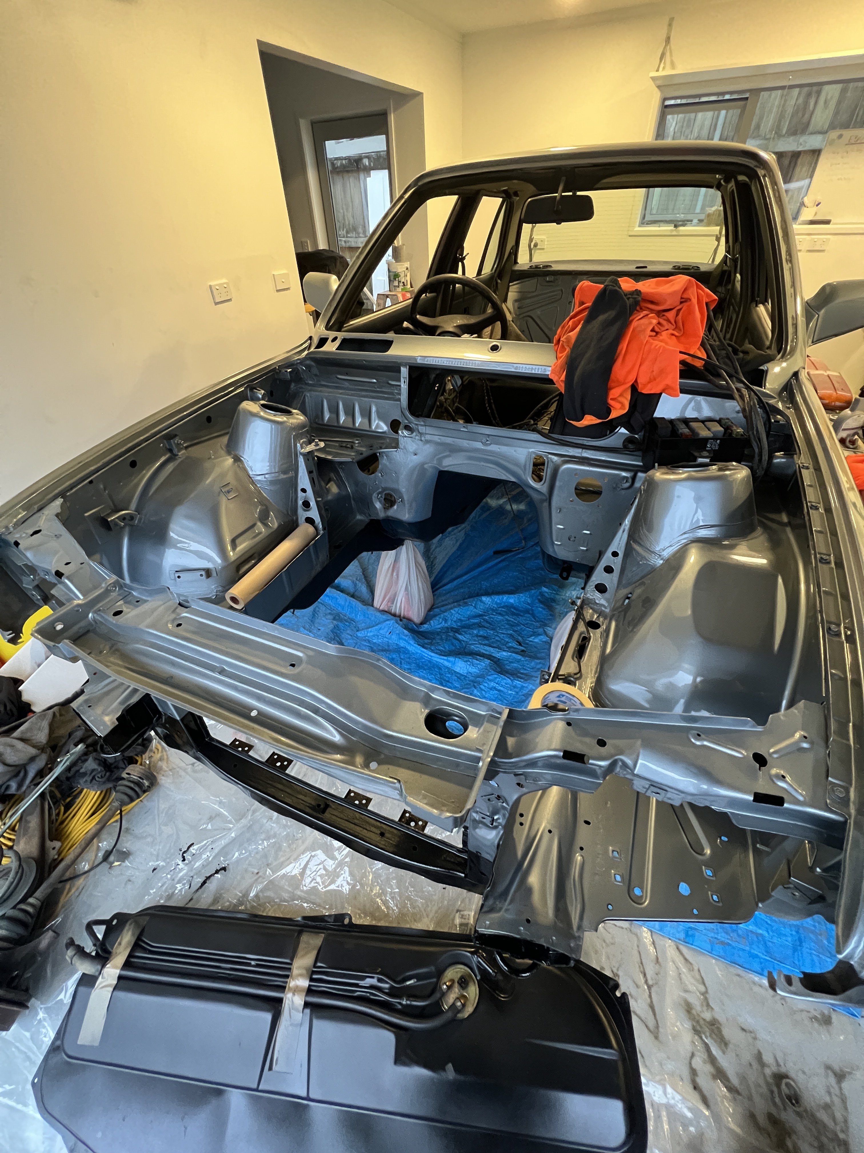

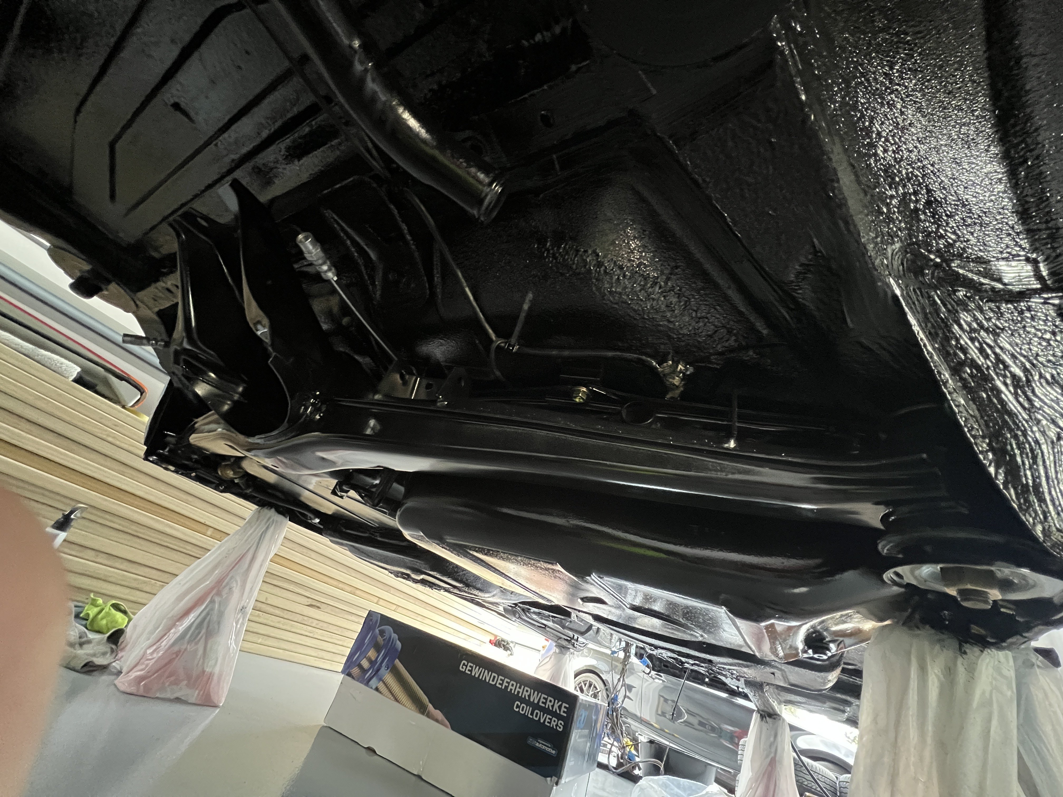

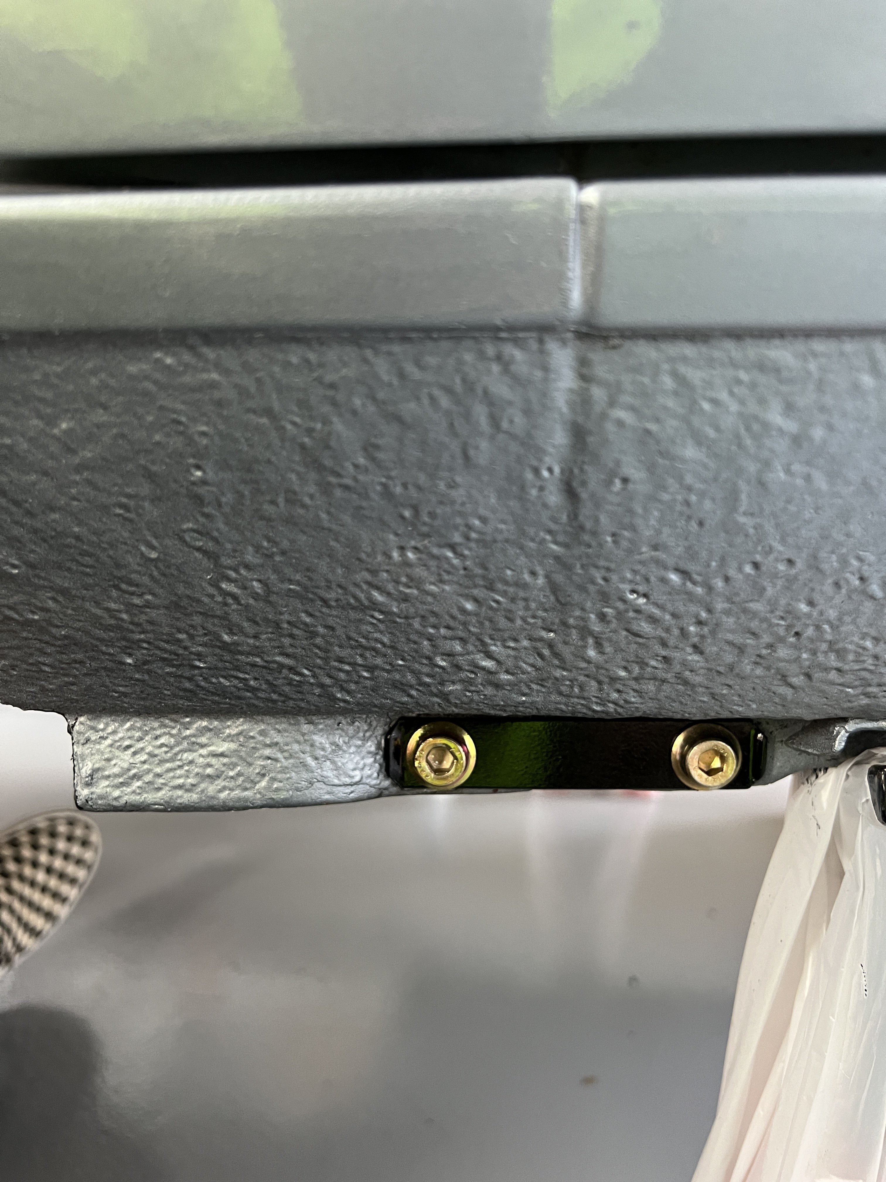

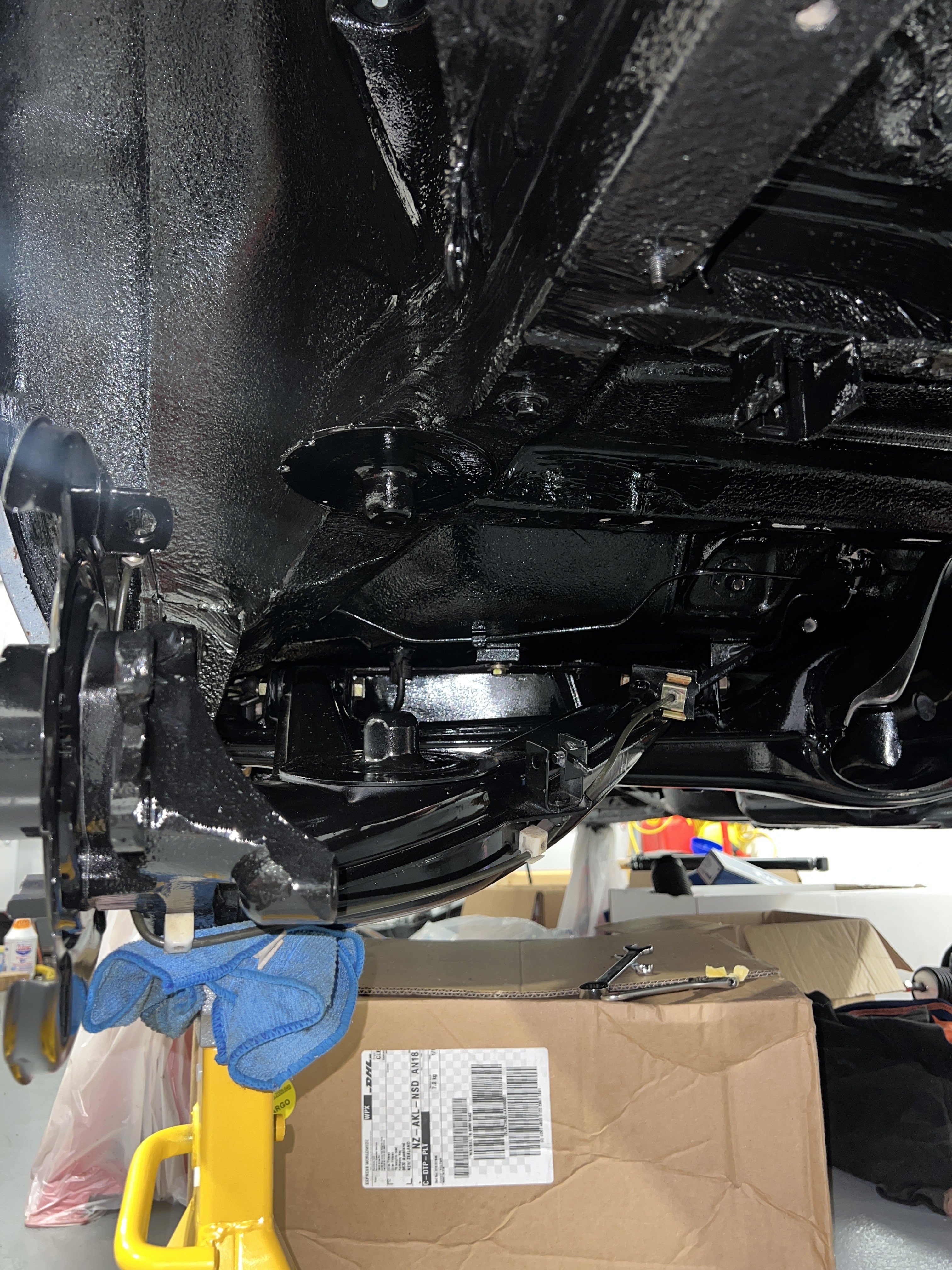

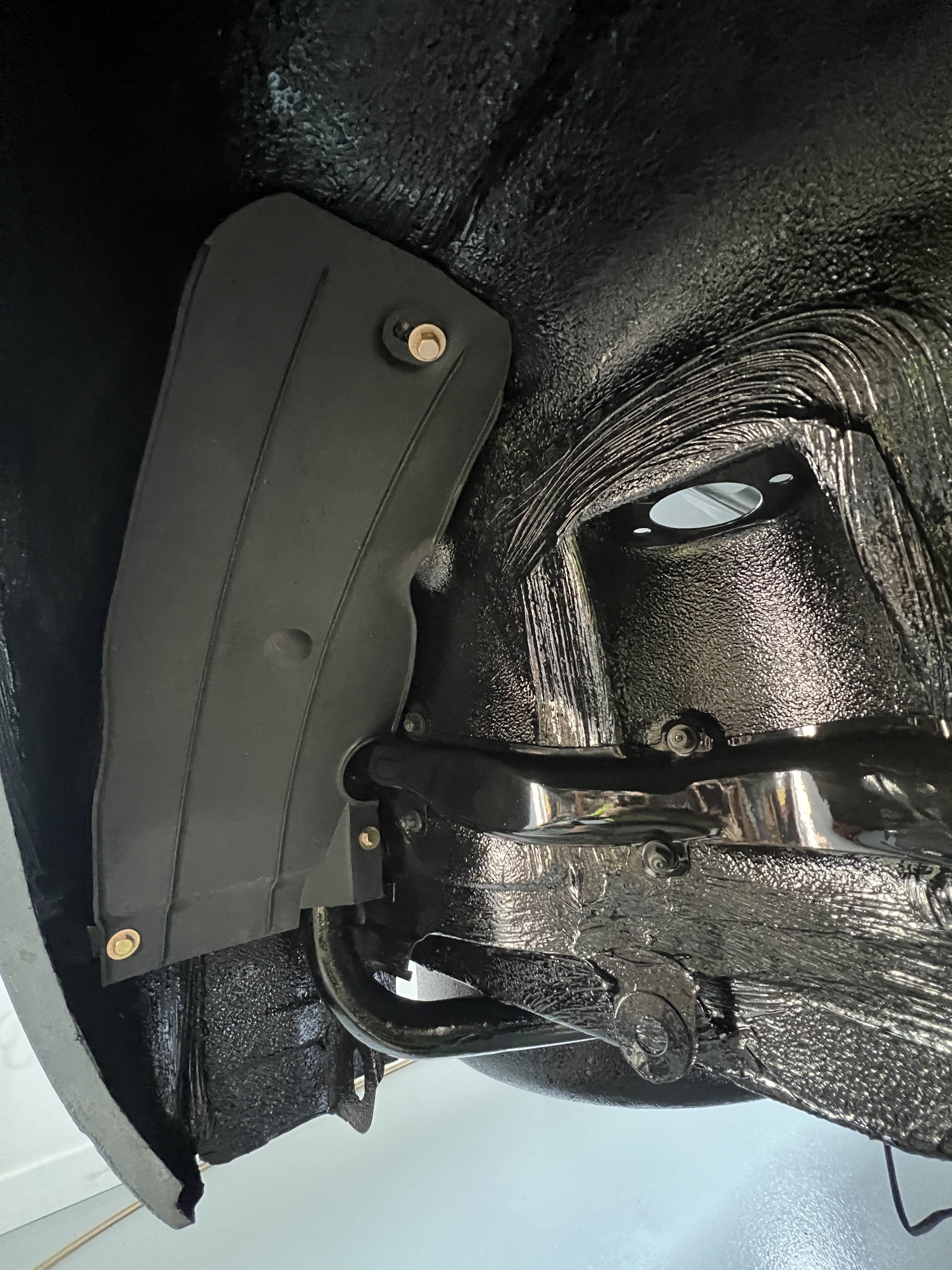

elias 454 Report post Posted May 21 Some more progress over the last week or so. Stripped all the suspension out, arms, struts, steering rack, front and rear subframe a, diff handbrake cables etc have all been removed. Masked up the engine bay and have begun painting the underside. Just using black Epoxy paint, any spots where there was minor surface rust wire wheeled back to clean metal. Will go over any seams with seam sealer and then do another coat of black epoxy. Very time consuming and messy process but will be worthwhile. Have done the first coat on the front wheel arches and underside of engine bay so far, lots more painting to do. also made up a new Clevis pin to adapt the e30 brake booster bracket thing that the pedal pull rod actuates to the e90 booster. 4 Quote Share this post Link to post Share on other sites

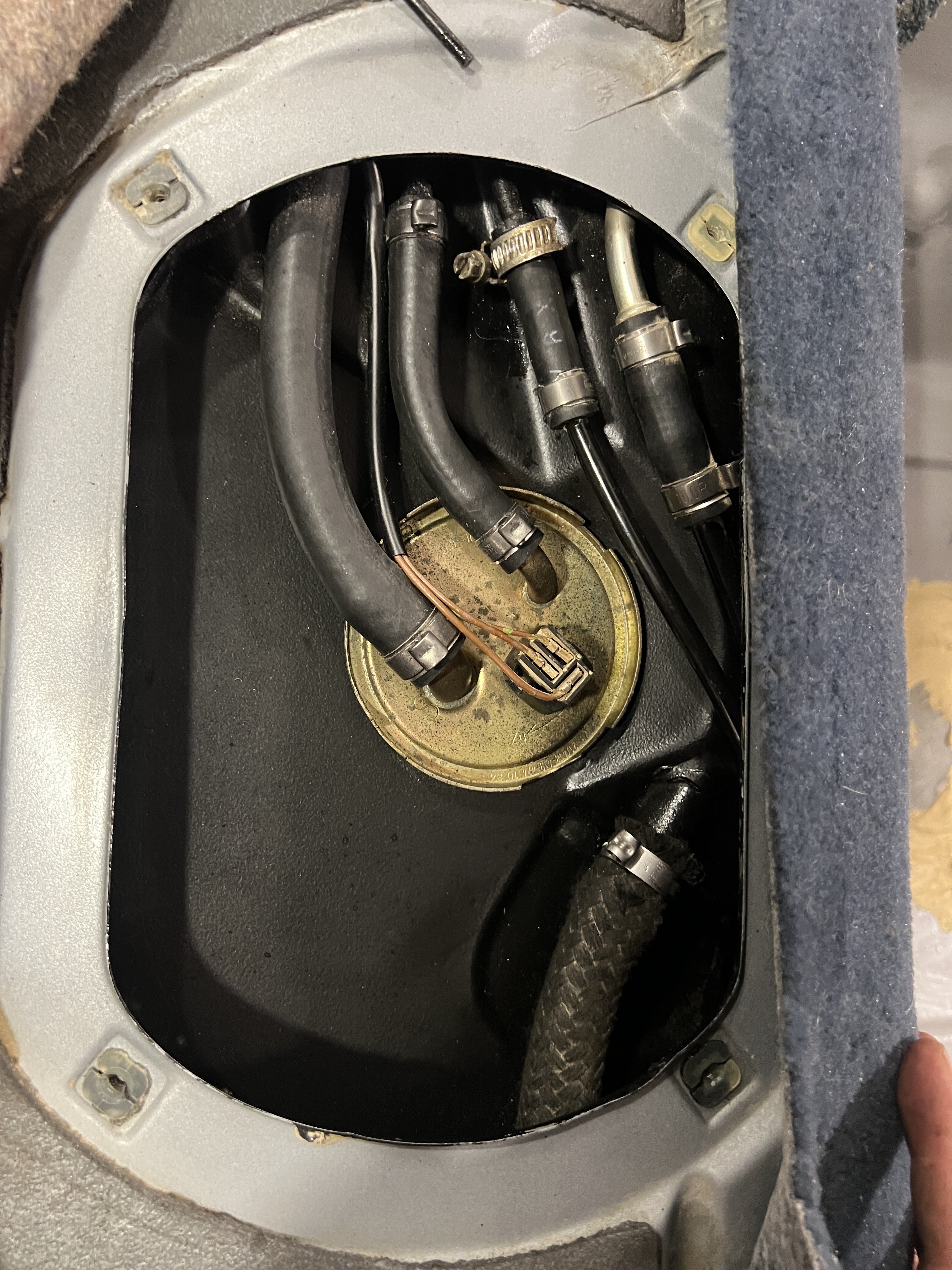

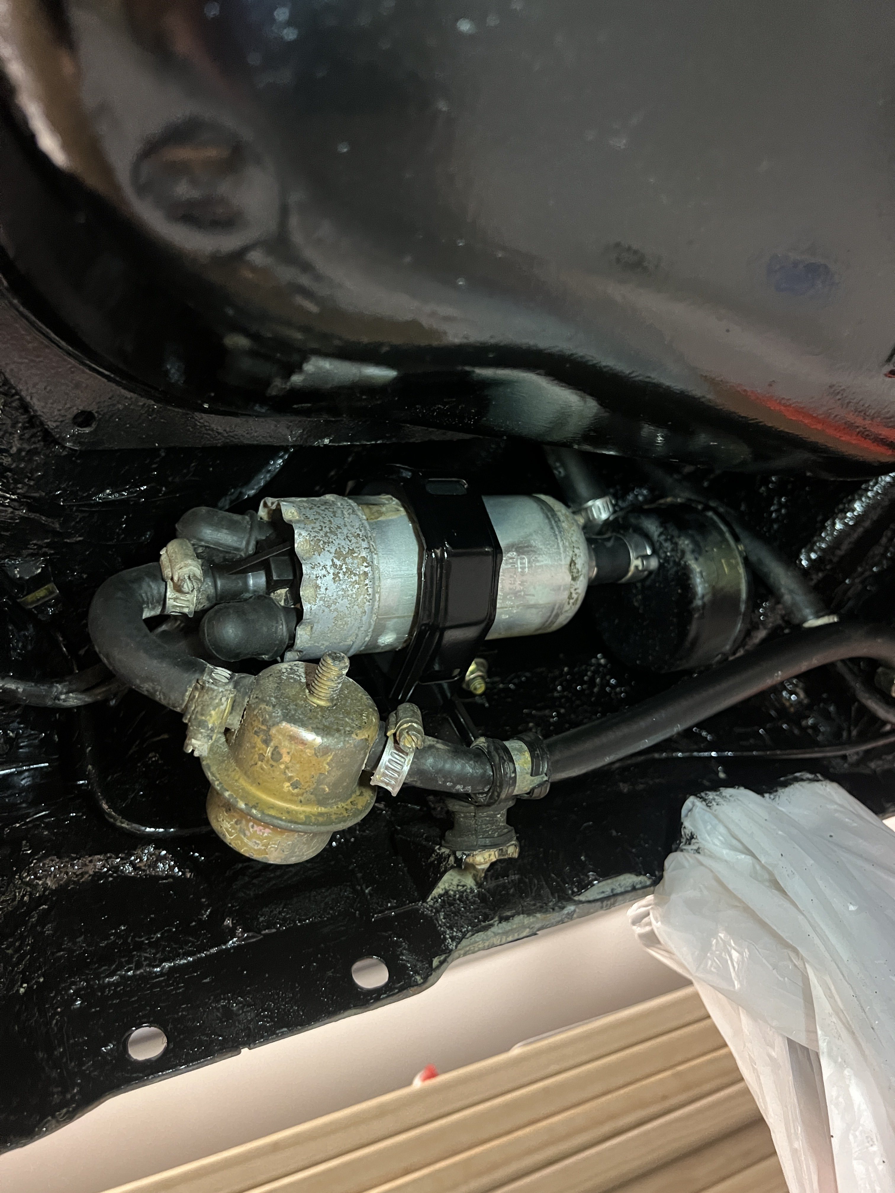

elias 454 Report post Posted May 25 Busy weekend lying on the garage floor covered in dirt. Dropped the fuel tank out, and cleaned the whole underside with a drill brush, degreaser etc. Then painted the whole underside. Long day of painting the entire underside with a paintbrush. Looks much better now though. Just need to seam seal a few spots and go over them with the black paint again. Then the fuel tank can go back in. Next up will be subframes, arms, hubs knuckles etc will all need a good clean (sandblast maybe?) and paint or powdercoat, yet to decide what I want to do. 4 Quote Share this post Link to post Share on other sites

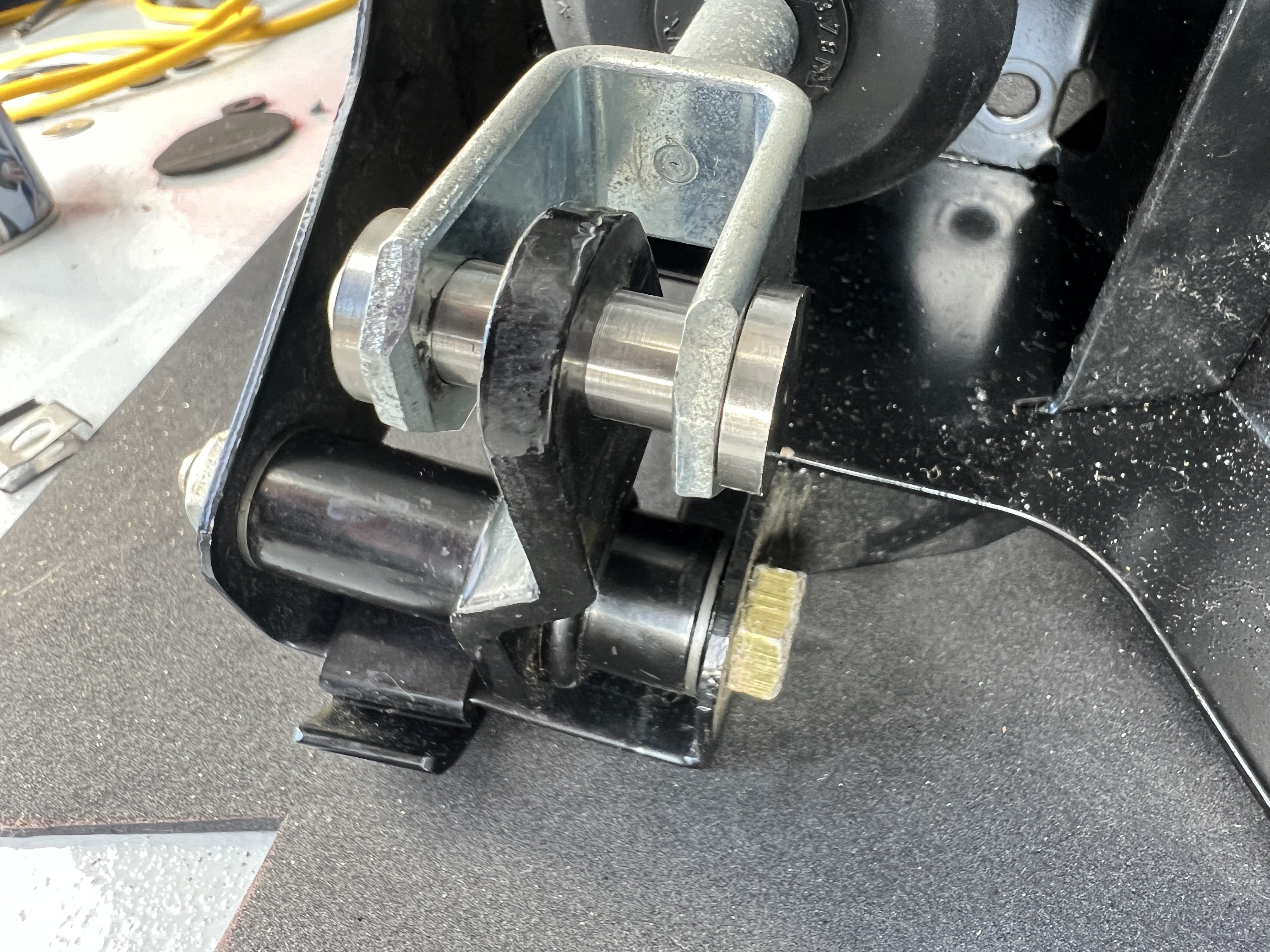

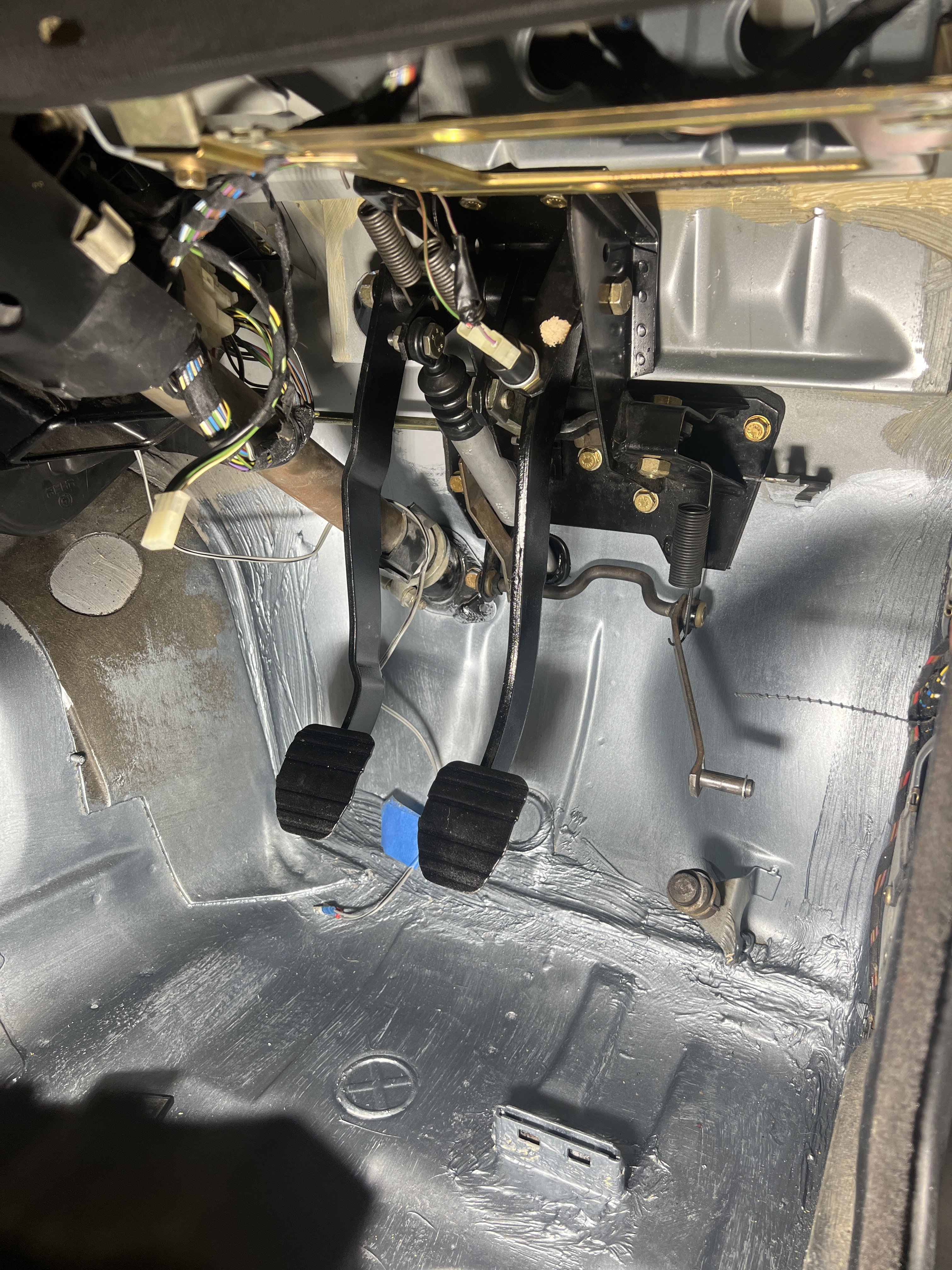

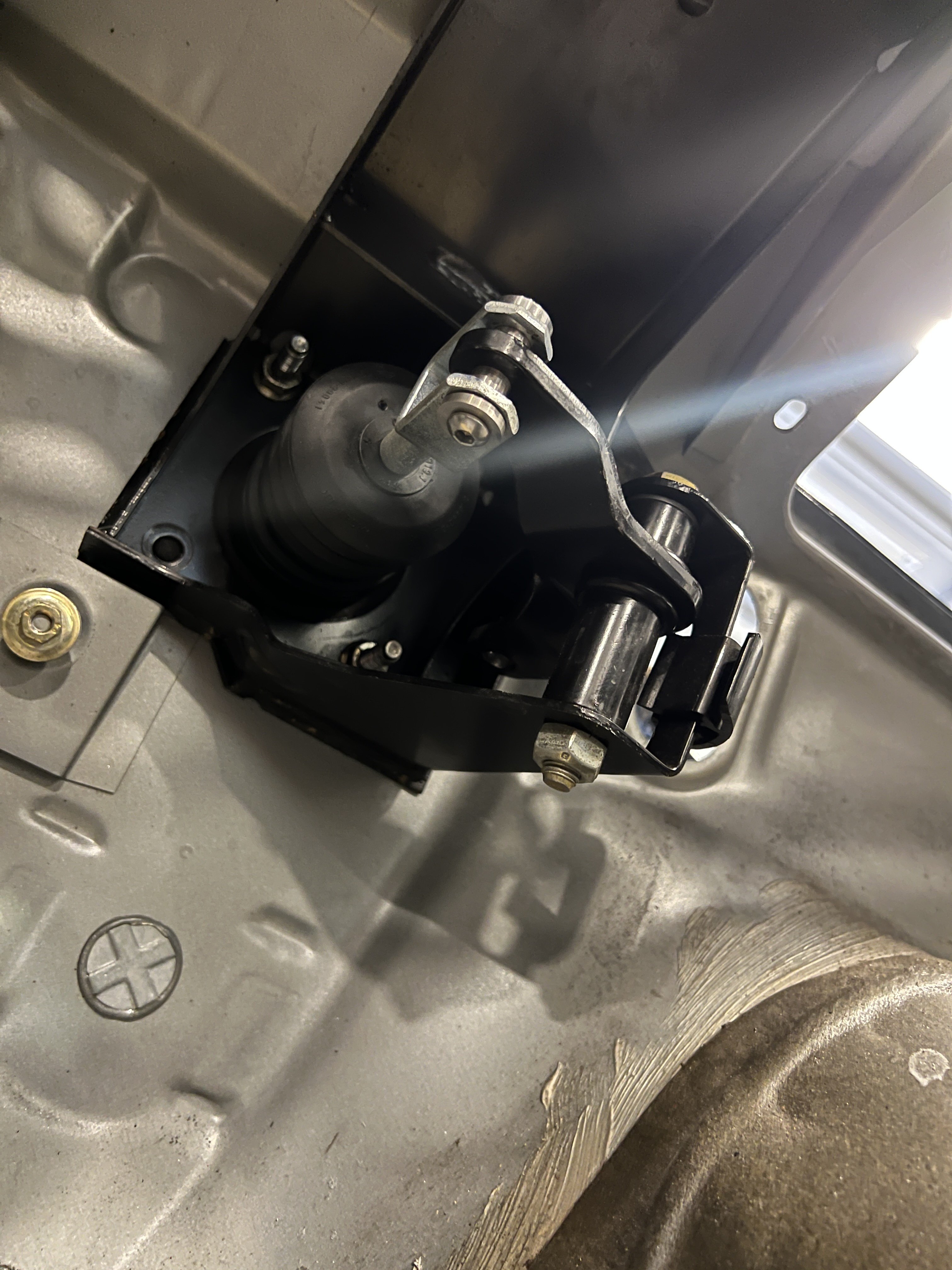

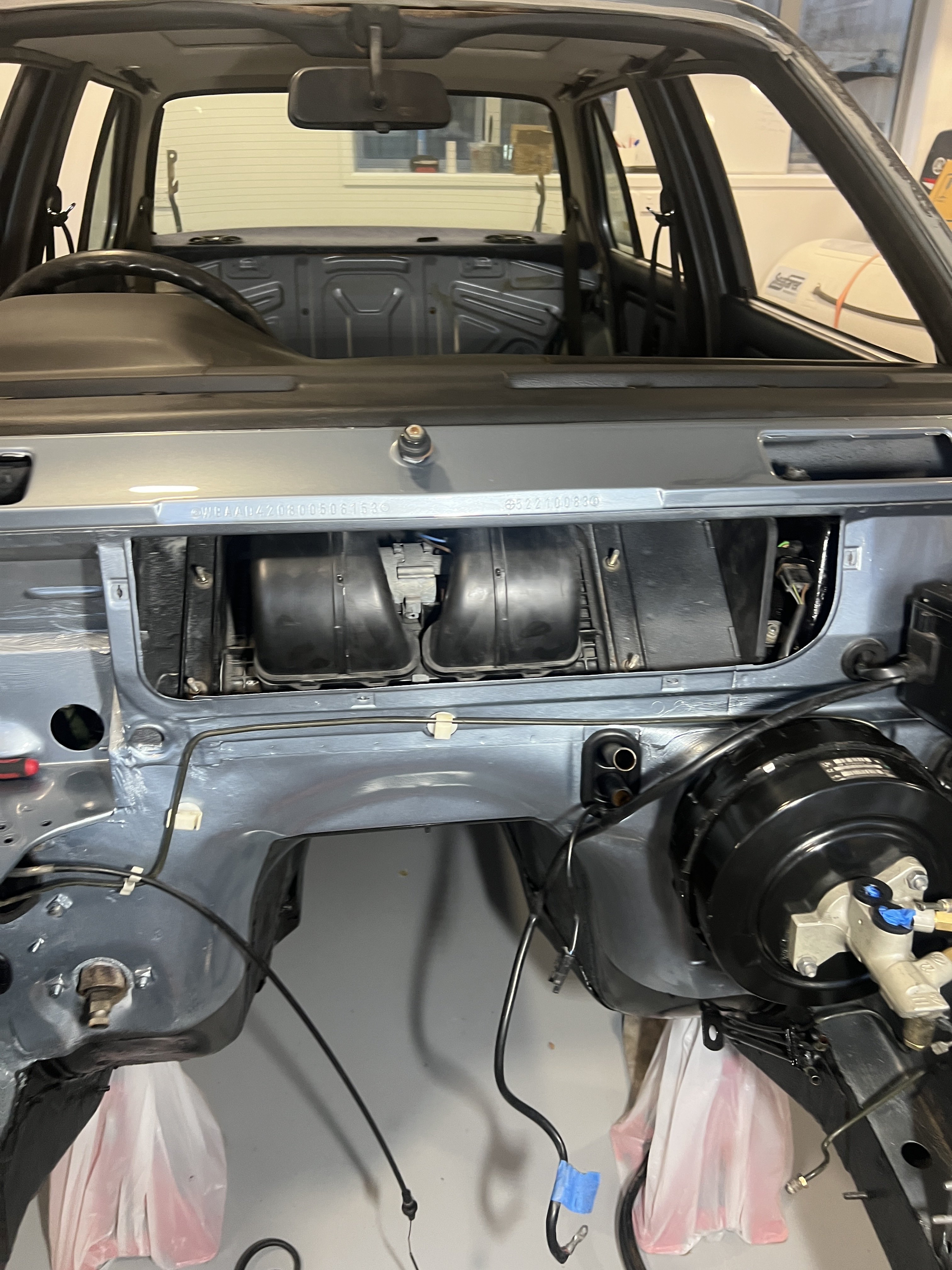

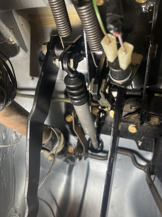

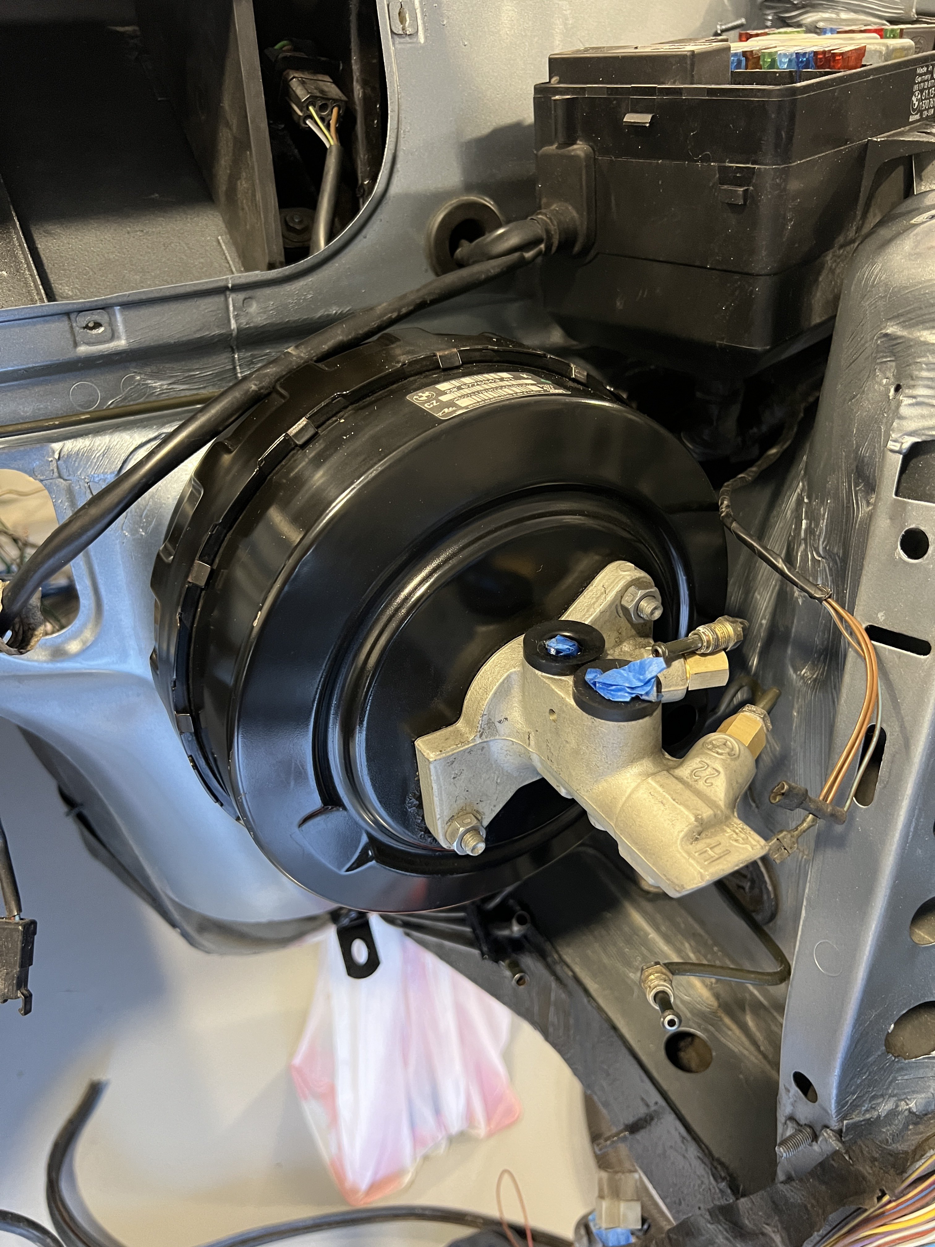

elias 454 Report post Posted June 2 Made a bit more progress, making the most of the long weekend. Sandblasted and painted clutch and brake pedals, painted the firewall side of the pedal box, installed the pedals and a new Sachs Master into the pedal box. Got the e90 brake booster fitted as well, still need to make a plan for teeing the front brake lines into the e90 master. Pedal box hooked up to the booster with the linkage too, works smoothly with the stainless clevis pin I made. Painted the fuel tank and put that back in the car also. installed the heater box with a new genuine gasket to make sure there’s no leaks, hooked up the cables for the controls. painted the floor inside the car as well, put the dash back in and started plugging a few things back in, fingers crossed at least the important stuff works. Still need to put a whole bunch of trims and bits and pieces in to complete the dash but it’s a start. Also some wiring to sort out. Some photos below. 8 Quote Share this post Link to post Share on other sites

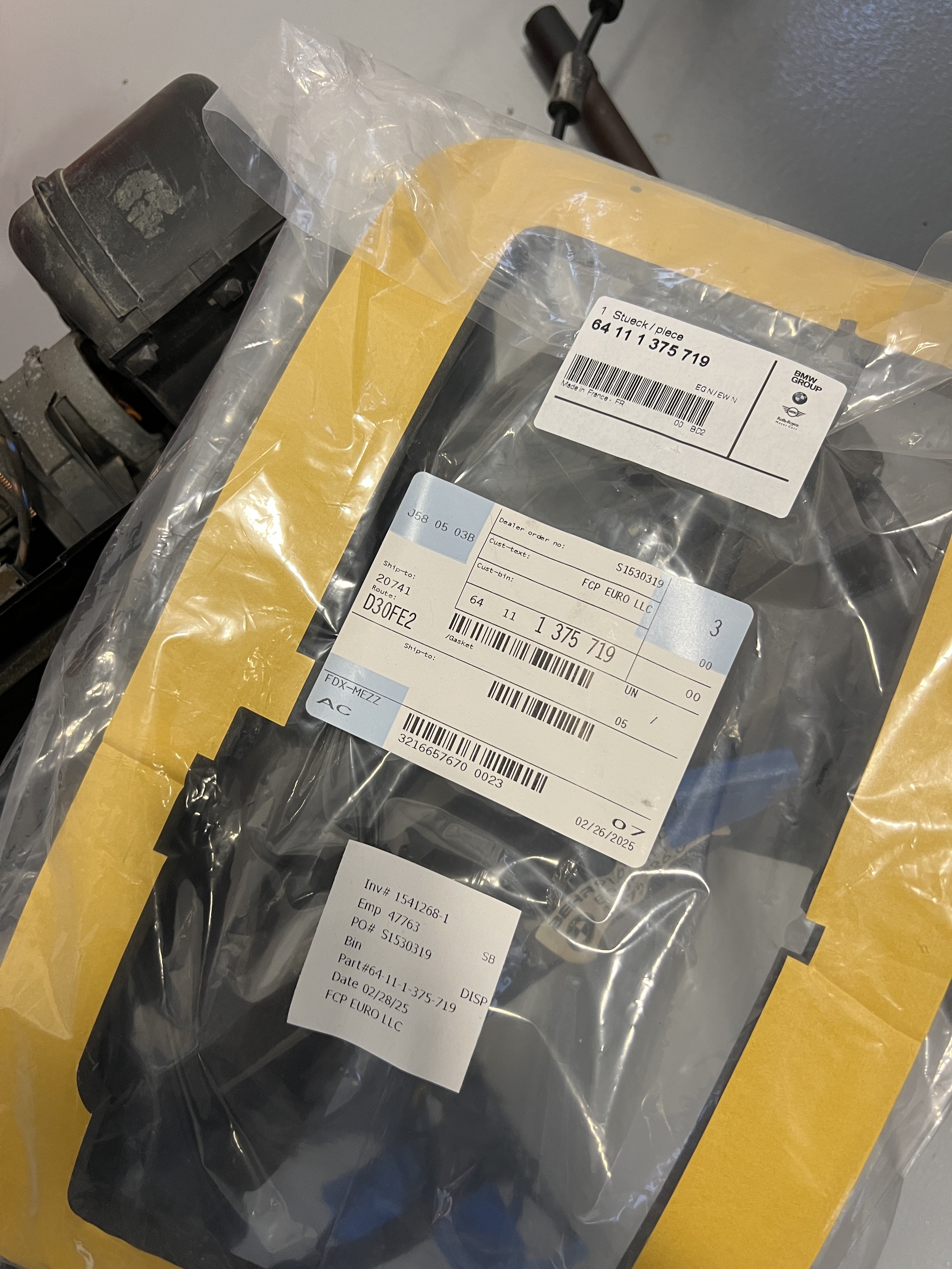

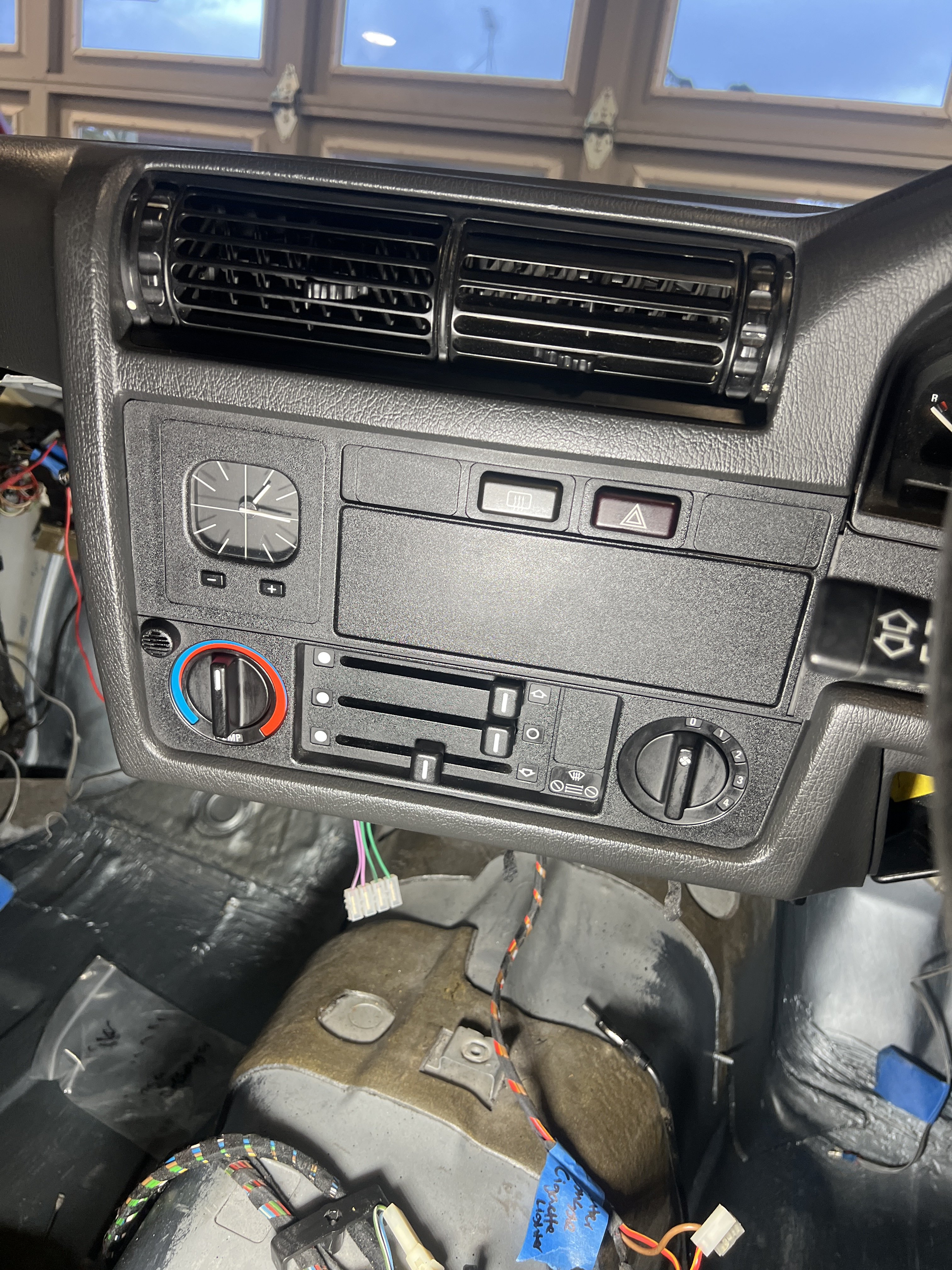

325iRod 144 Report post Posted June 3 @elias where did you get the stereo blanking plate? Quote Share this post Link to post Share on other sites
elias 454 Report post Posted June 3 4 minutes ago, 325iRod said: @elias where did you get the stereo blanking plate? I actually found it in the glovebox of the car when I finally managed to open it. The latch was broken, had to drill it out and found all sorts in there. It’s only in the dash temporarily until I find a nice oem looking headunit and sort the wiring out. Quote Share this post Link to post Share on other sites
325iRod 144 Report post Posted June 3 @elias Nice find, if you ever want to sell it ill take it off your hands Quote Share this post Link to post Share on other sites
deedub 142 Report post Posted June 3 (edited) 2 hours ago, 325iRod said: @elias Nice find, if you ever want to sell it ill take it off your hands Came across this in the past on FCP euro. Considered getting one for my E30 until I could get OEM for it. https://www.fcpeuro.com/products/bmw-radio-frame-64111368515 Expensive for what it is though. Must be some cheaper after market ones out there. Edited June 3 by deedub 1 Quote Share this post Link to post Share on other sites
elias 454 Report post Posted June 3 3 hours ago, 325iRod said: @elias Nice find, if you ever want to sell it ill take it off your hands I will keep you in mind, once I find a radio I like and remove it, I shall offer it to you first. 1 Quote Share this post Link to post Share on other sites

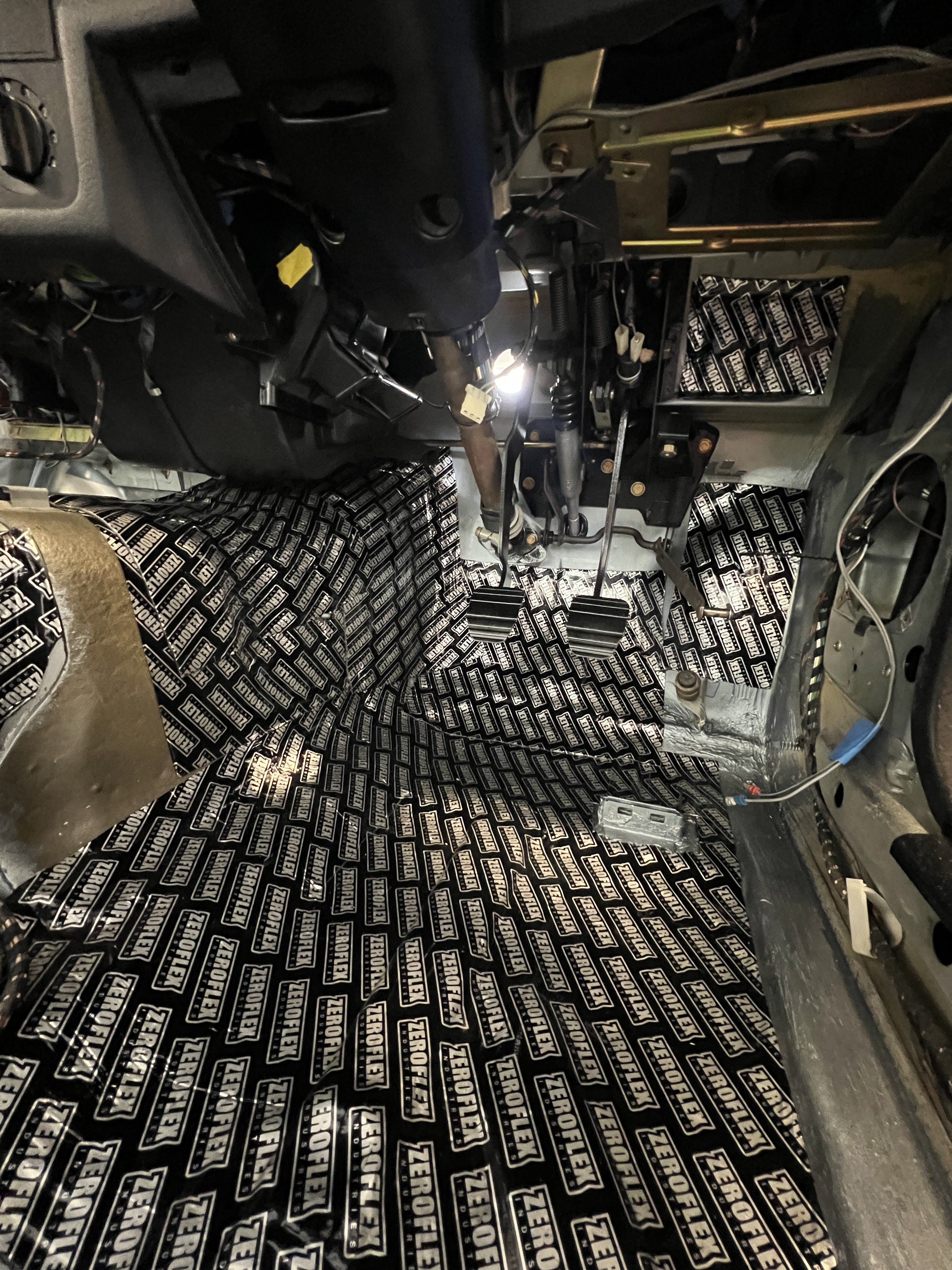

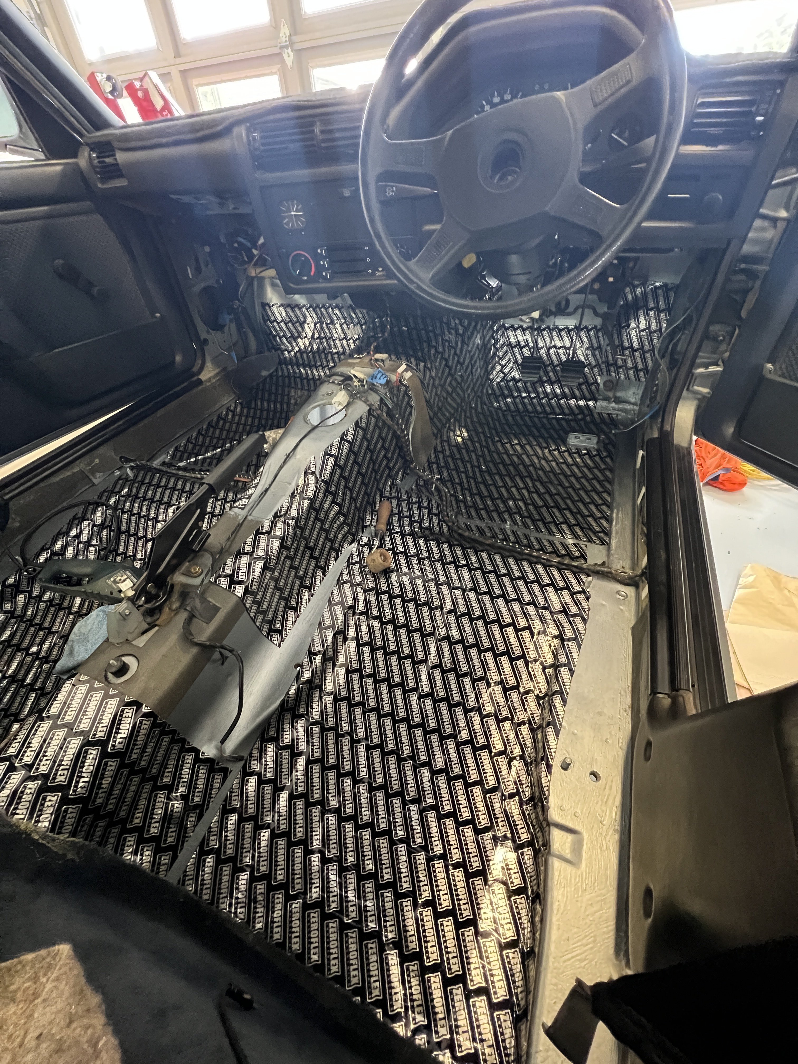

elias 454 Report post Posted June 11 Installed a bunch of sound deadening in the floor of the car in an effort to keep this one more comfortable and street friendly than the 135i… installed the clutch master as well, now that I have the feed line, only to find that it runs the brake linkage. Turns out there’s meant to be an elbow fitting in the master not a straight fitting that my pedal box came with, luckily Peter from P&S auto has an elbow in stock so off to there after work then to give it another go 3 Quote Share this post Link to post Share on other sites

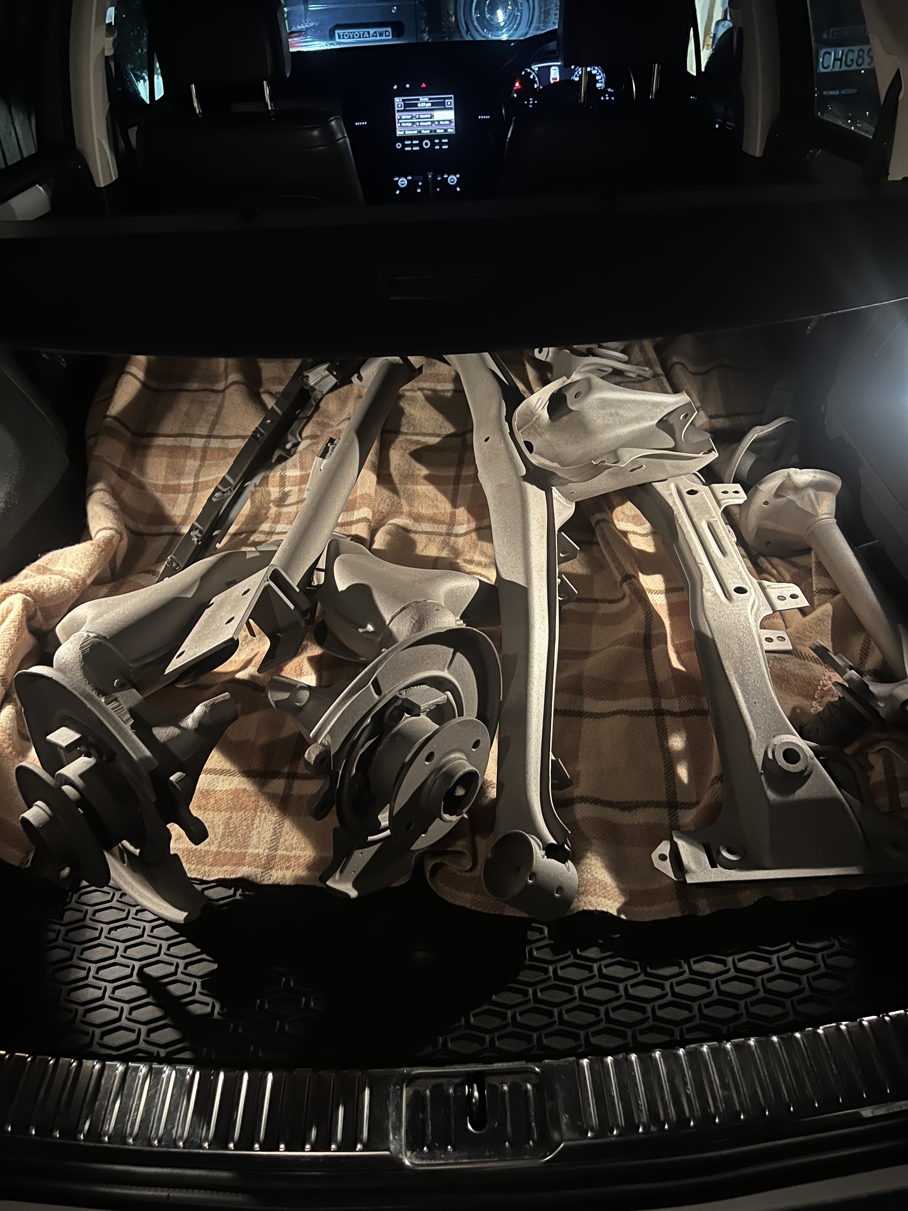

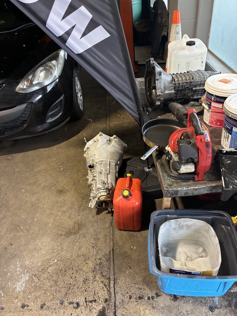

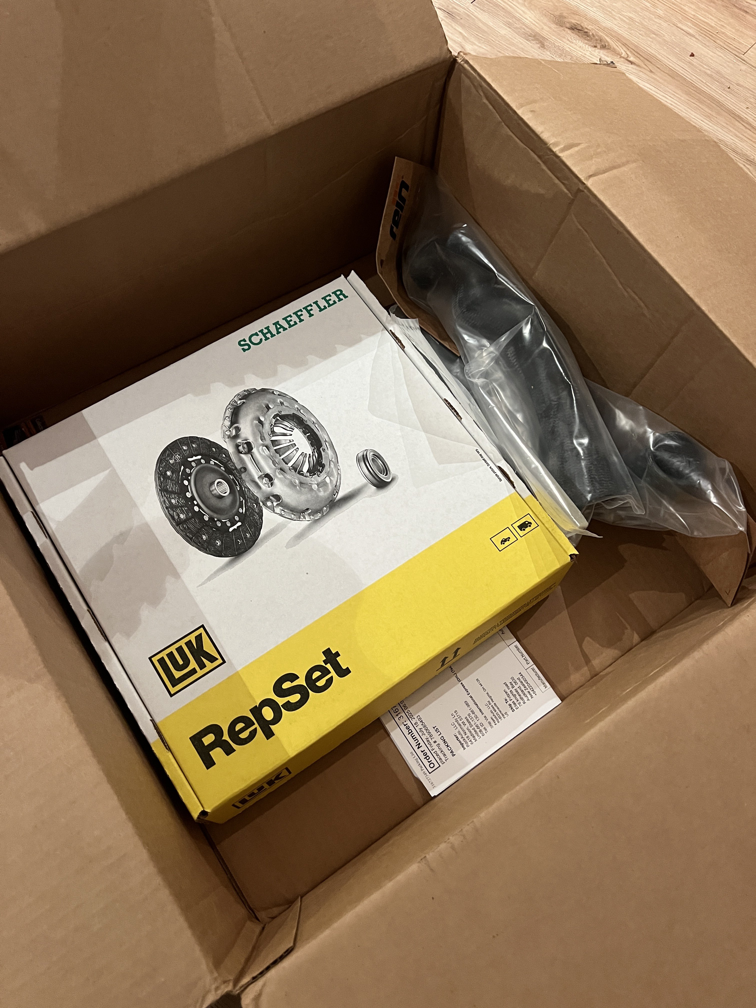

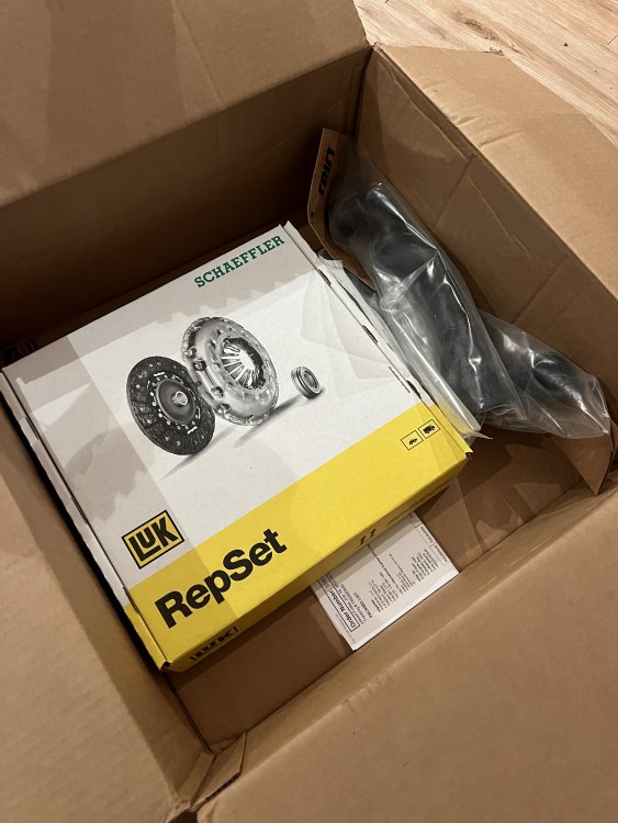

elias 454 Report post Posted July 1 Got a little bit more work done recently, been busy making a plan for all the suspension stuff and figuring out which direction to go for the clutch/flywheel. Decided to keep it oem and stick with a dual mass flywheel and oem 240mm luk clutch kit. Got all the underside parts taken apart and sandblasted, in the process of getting painted at the moment. gearbox is back from kayne Barrie now with fresh detents. More or less just need to order the clutch kit now and then can put the engine and gearbox into the car. picked up a e90 325i auto front half driveshaft and a e36 medium case rear half from @Toast which so far seem to work together, will see if they end up the right length. Paid $80 for the front half instead of the $700 people charge for zf 5 Speed Front halves nowadays. will need to swap the carrier bearing over to an e30 one as well. Fuel pump is back in the car too now ready to start replacing subframe, trailing arm bushings etc now and reassembling the rear end. 5 Quote Share this post Link to post Share on other sites
Tobias01 91 Report post Posted July 3 who did you get to do the sandblasting? Quote Share this post Link to post Share on other sites

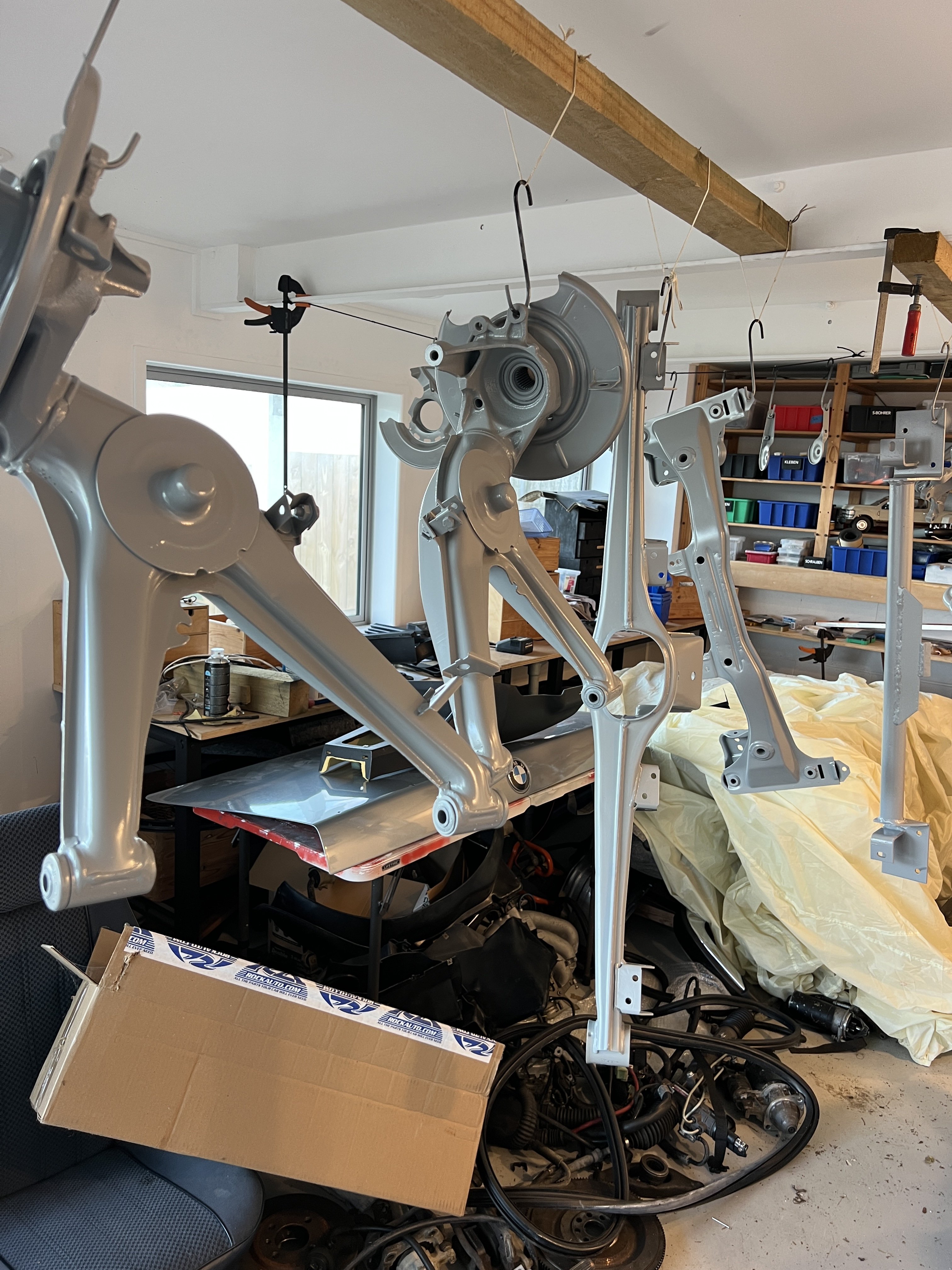

elias 454 Report post Posted July 3 4 hours ago, Tobias01 said: who did you get to do the sandblasting? Sharp sandblasting up in dairy flat. Not the cheapest but good to deal with and did a thorough job. The photo of the parts hanging up is not bare metal just for reference that is after 2 coats of epoxy primer. Quote Share this post Link to post Share on other sites

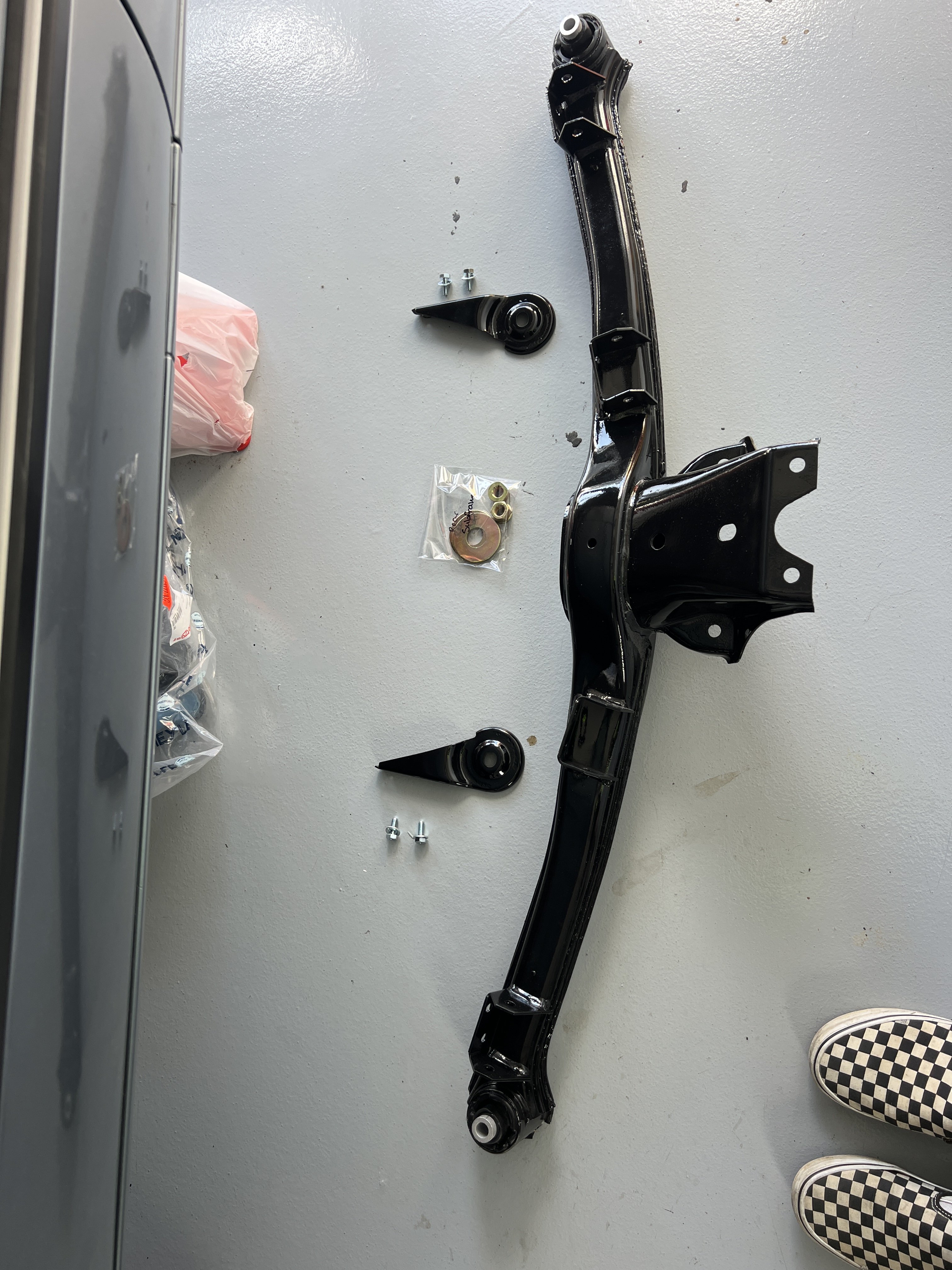

elias 454 Report post Posted July 12 Been a bit slack but have got suspension parts on the way now. Underbody parts all painted black now, new subframe bushings and trailing arm bushings installed as well. also aquired some engine vanity covers for the m52 thanks to Luke from Skunkworks, he’s been a huge help with sourcing parts, all the suspension parts, bushings, swaybar links, struts, springs, wheel bearings etc that I’ve ordered I’ve ordered through him, very helpful guy. then got into the brakes, stripped them down, sandblasted, painted a coat of preventative rust converter, then painted a nice shade of blue, reassembled with new seals and bits all round, pistons came up great with a quick polish. ready now to send a bunch of bolts off for zinc coating and then once all the other bits arrive the suspension parts can start being put back in the car. 8 Quote Share this post Link to post Share on other sites

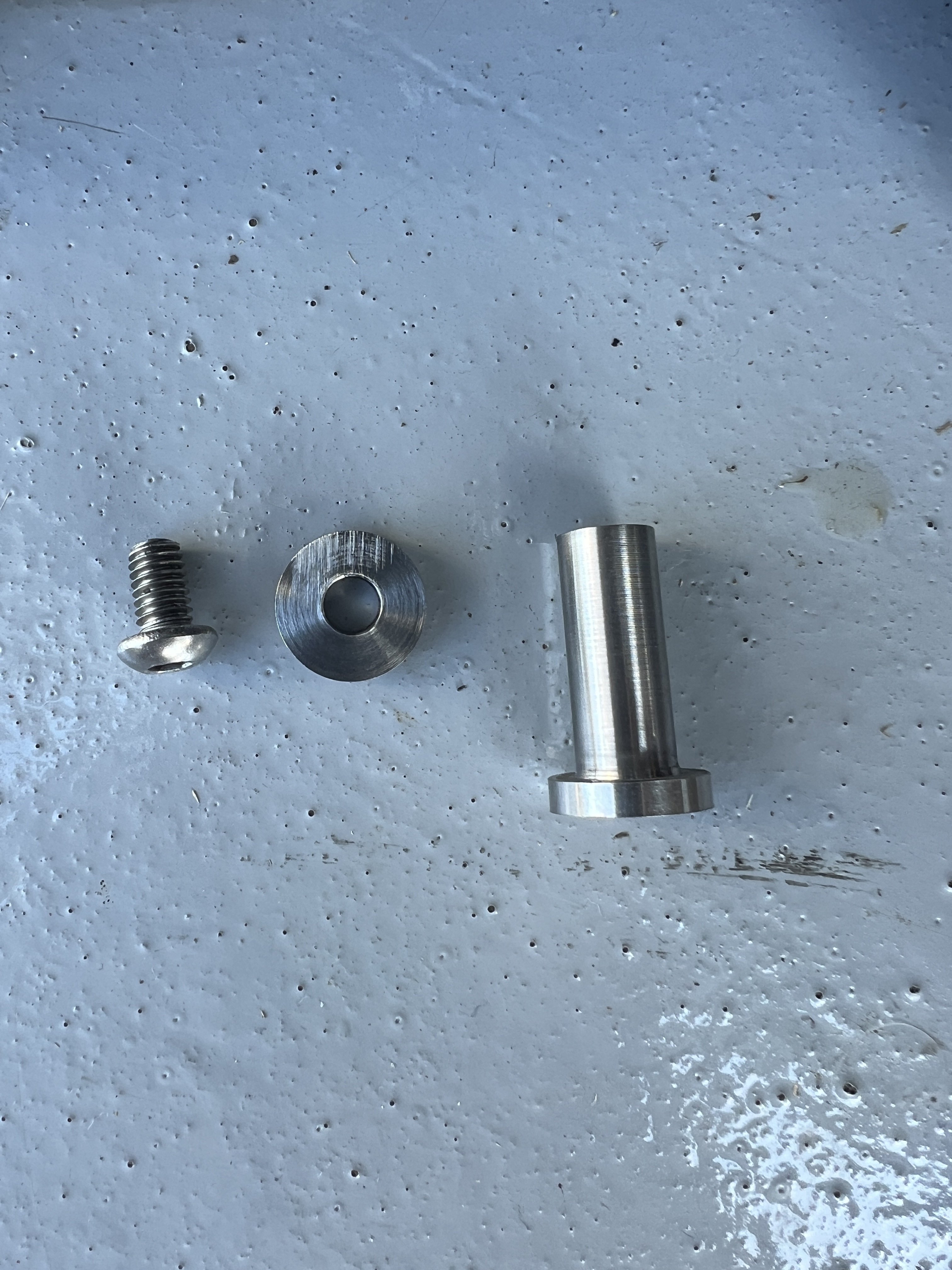

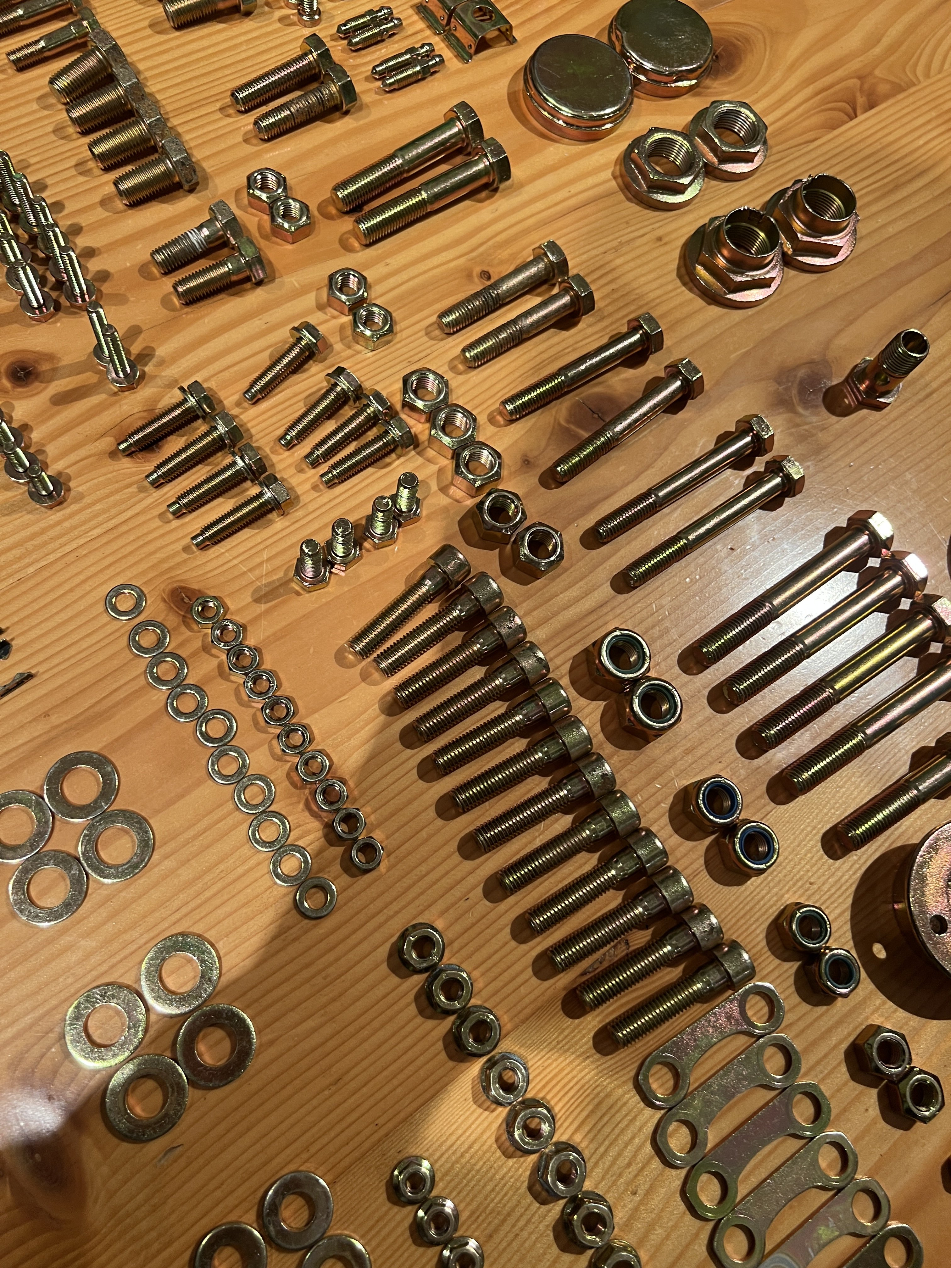

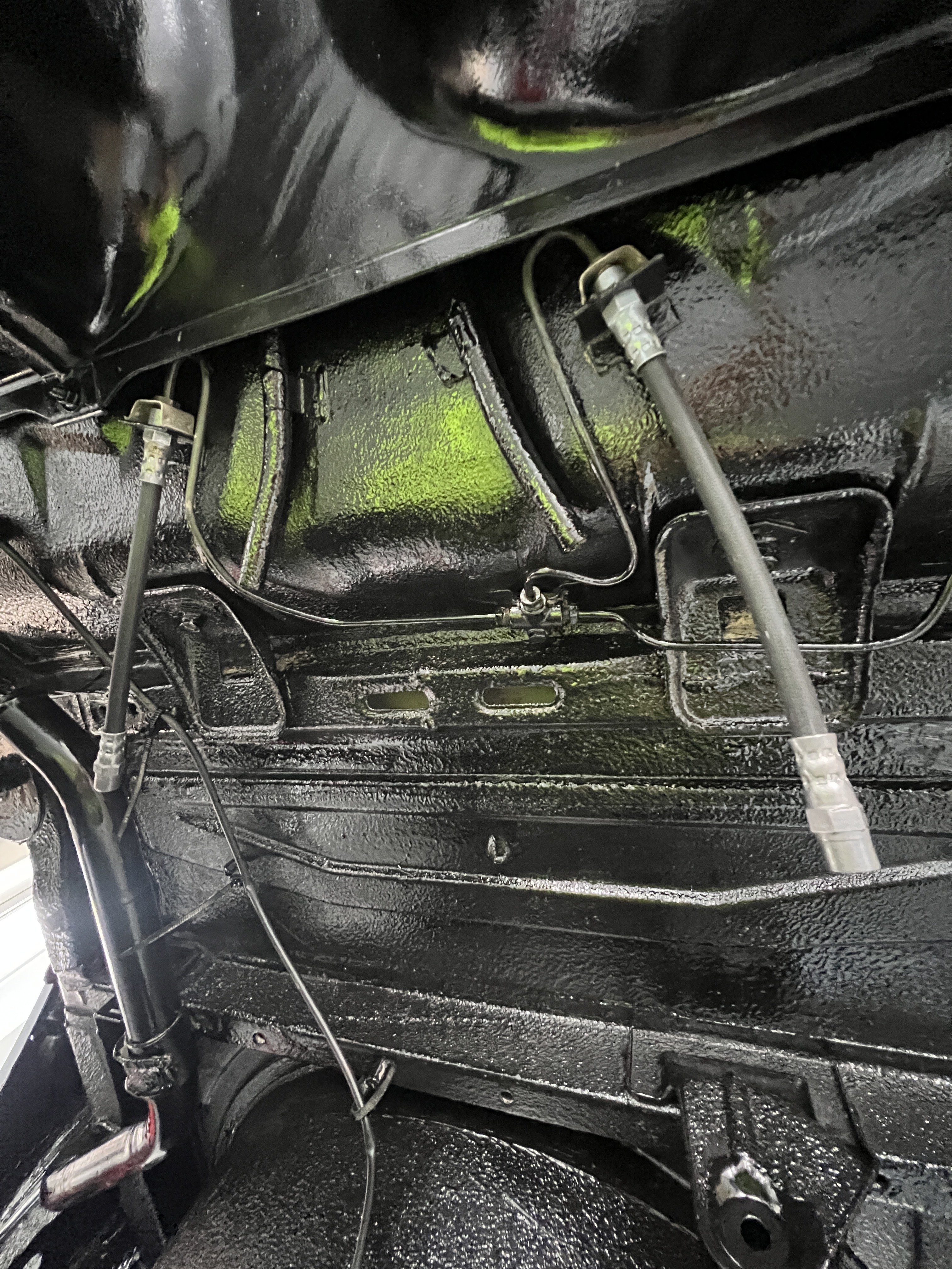

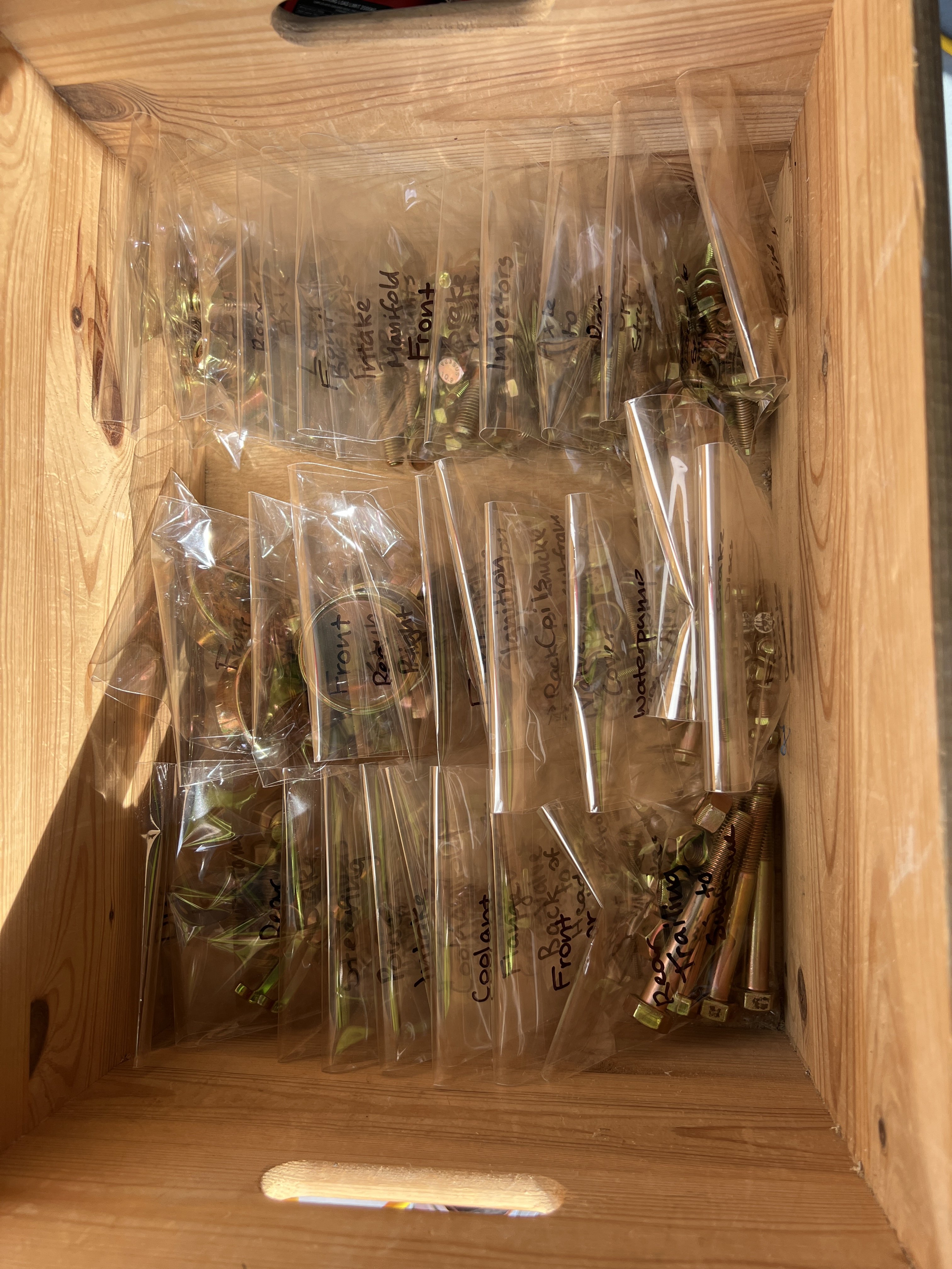

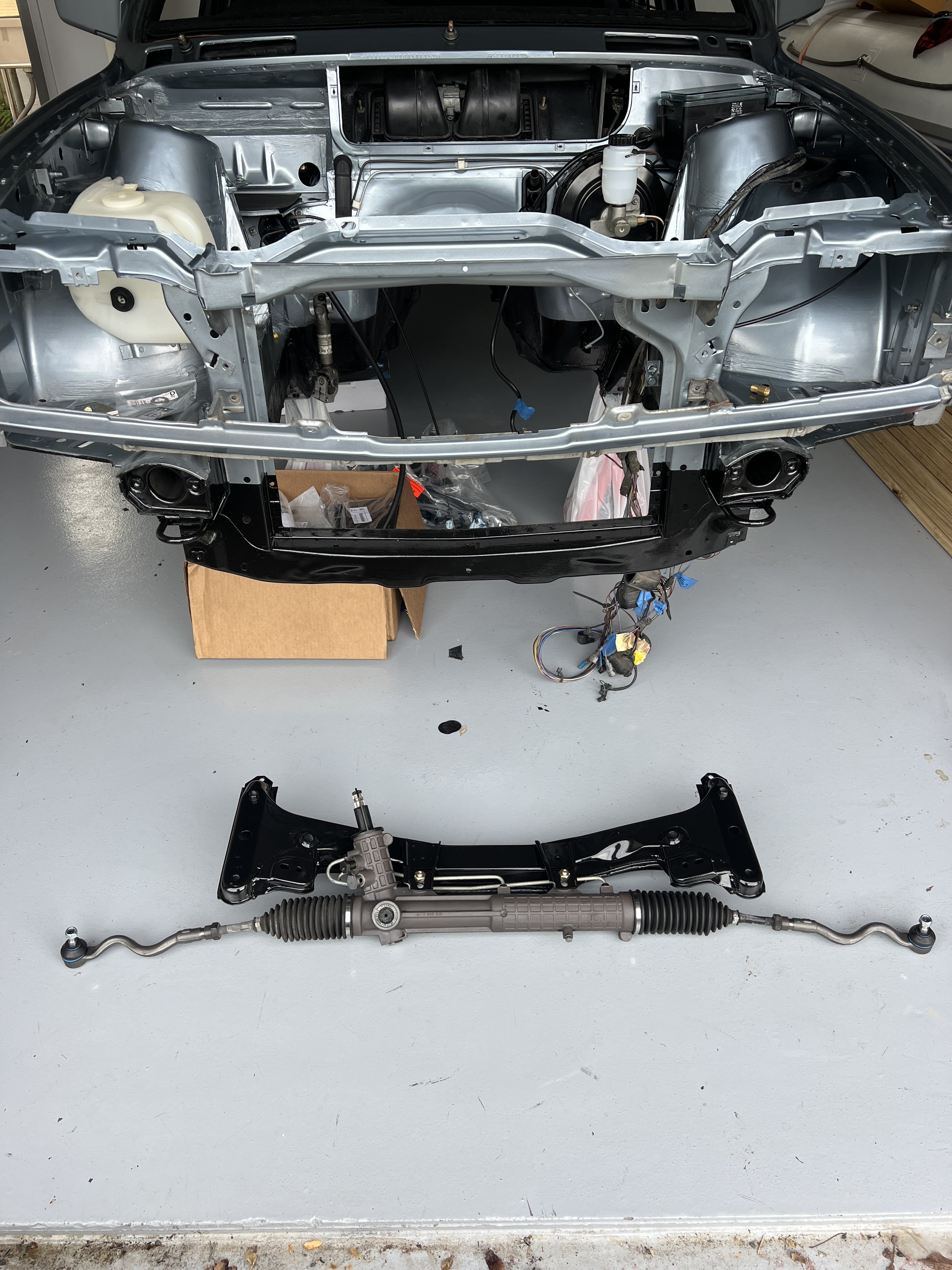

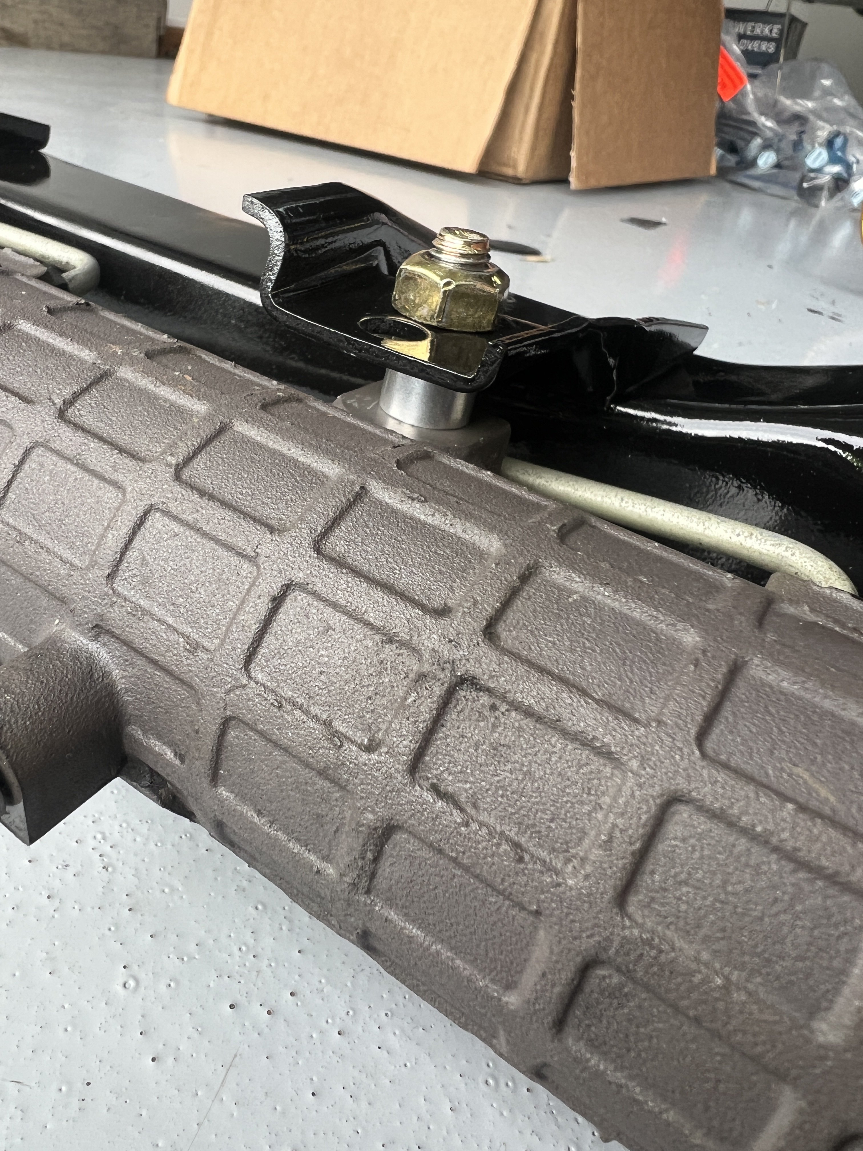

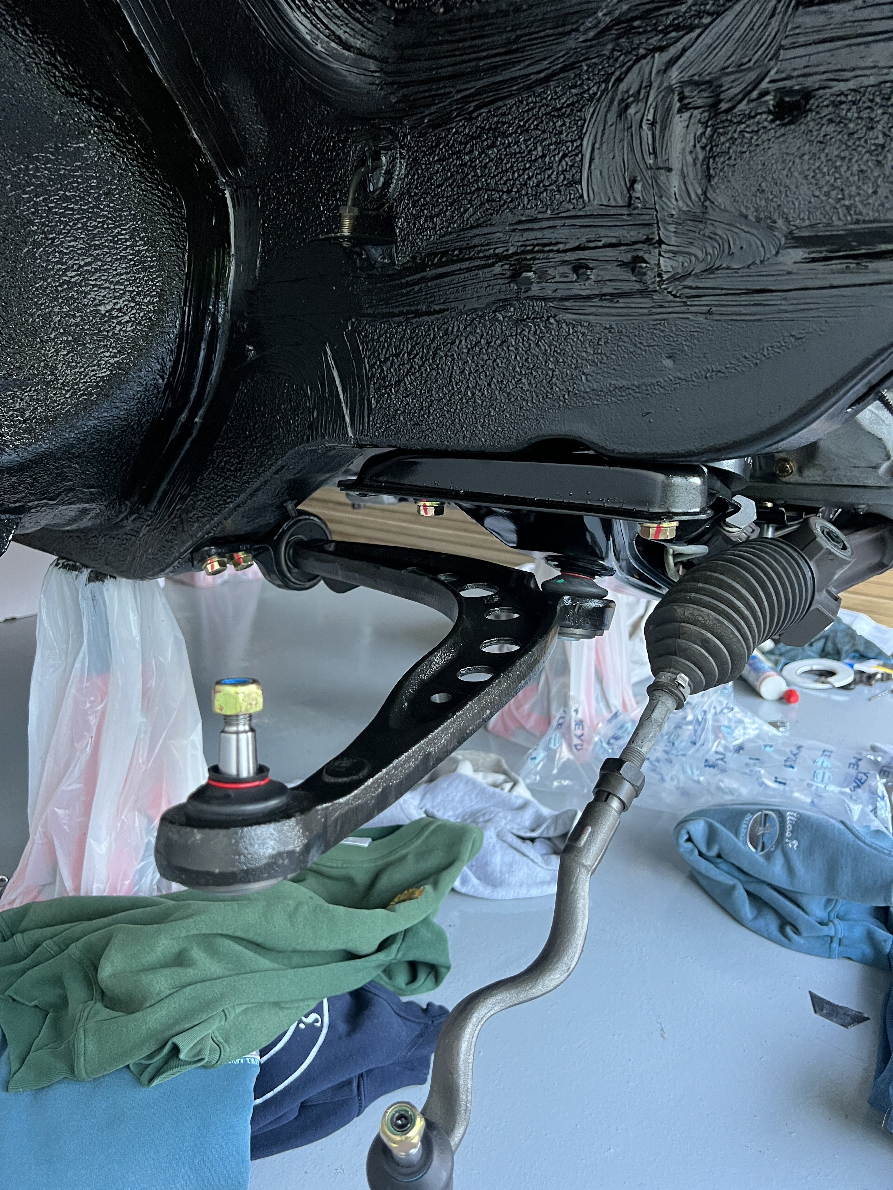

elias 454 Report post Posted July 19 Some more progress. Got my hardware back from zinc coating, all Organized again now. Got the rear subframe back in. Along with new rear inner brake lines. got the steering rack fitted up into the front subframe with some spacers I machines. Also swapped on some new e36 outer tie rod ends. just waiting on rear wheel bearings to show up and I can start putting trialing arms back in. 10 Quote Share this post Link to post Share on other sites

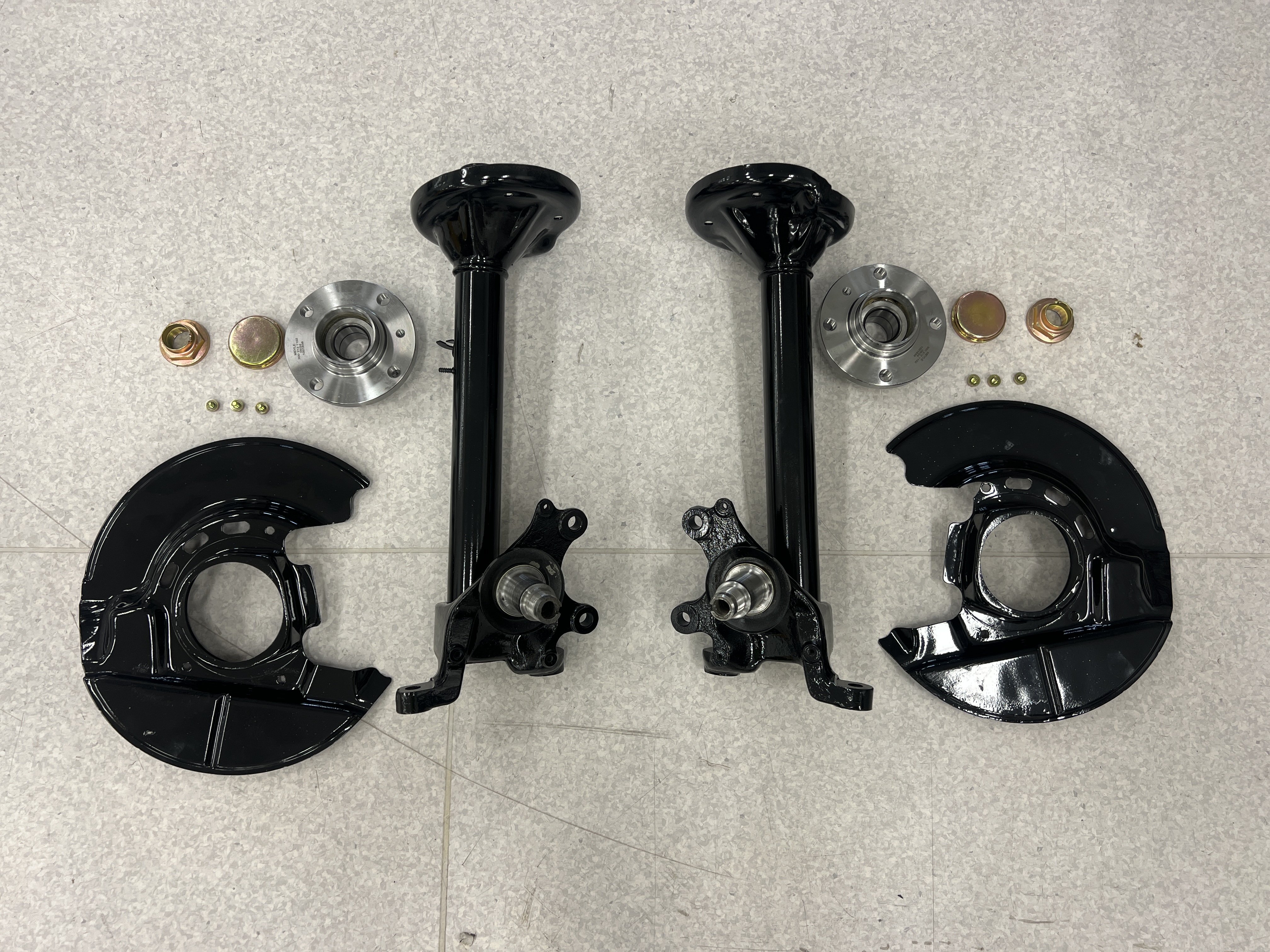

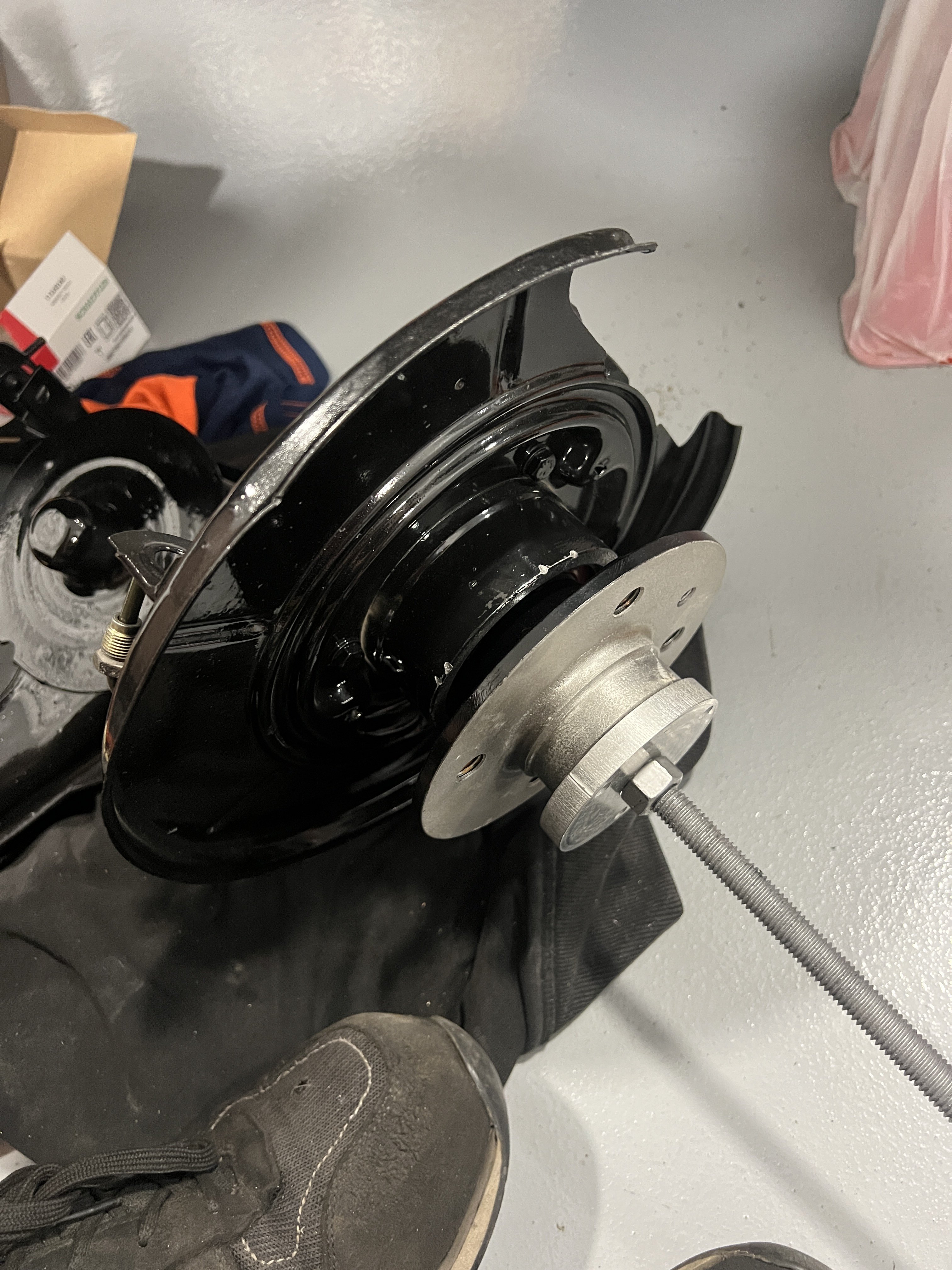

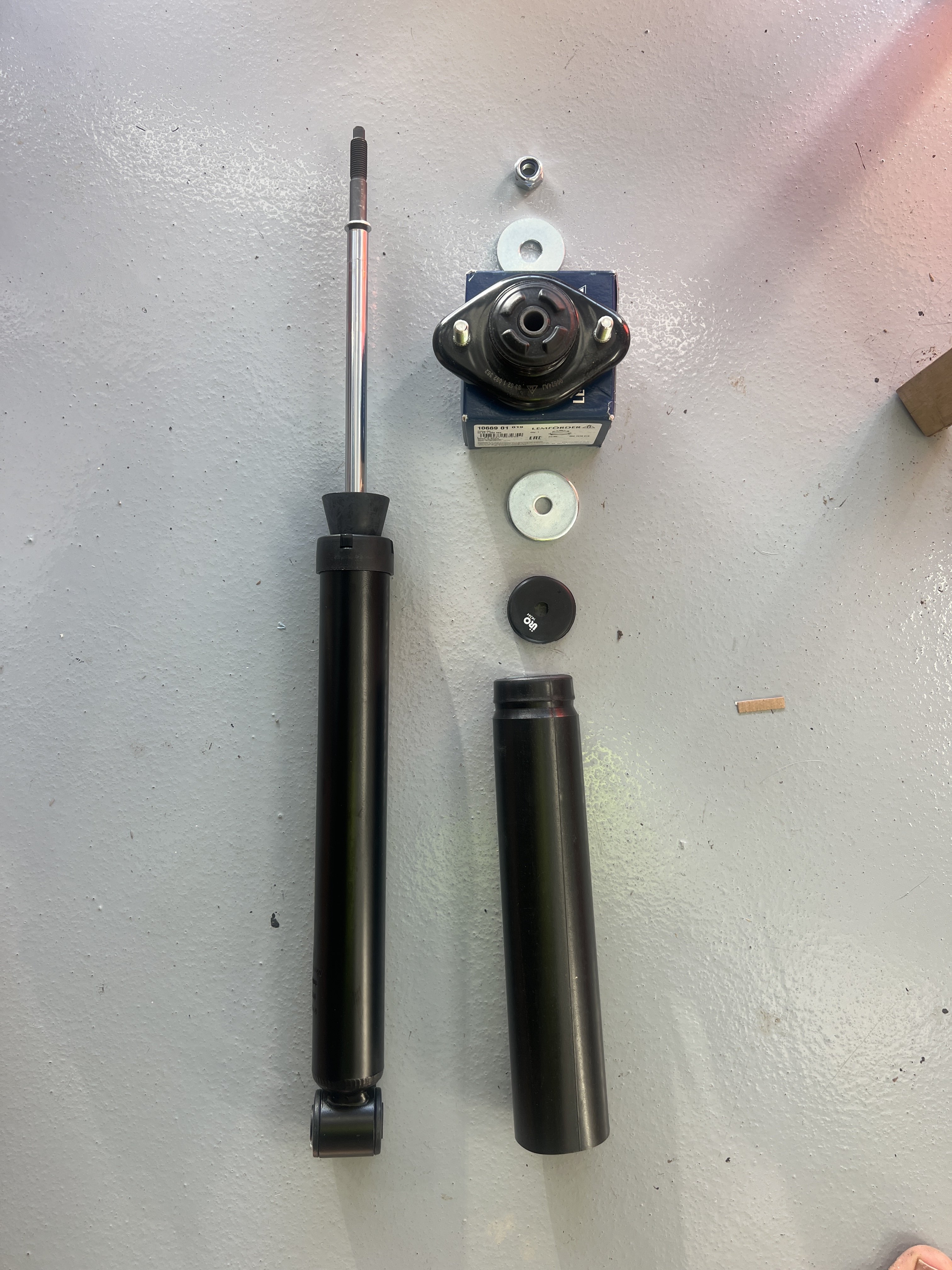

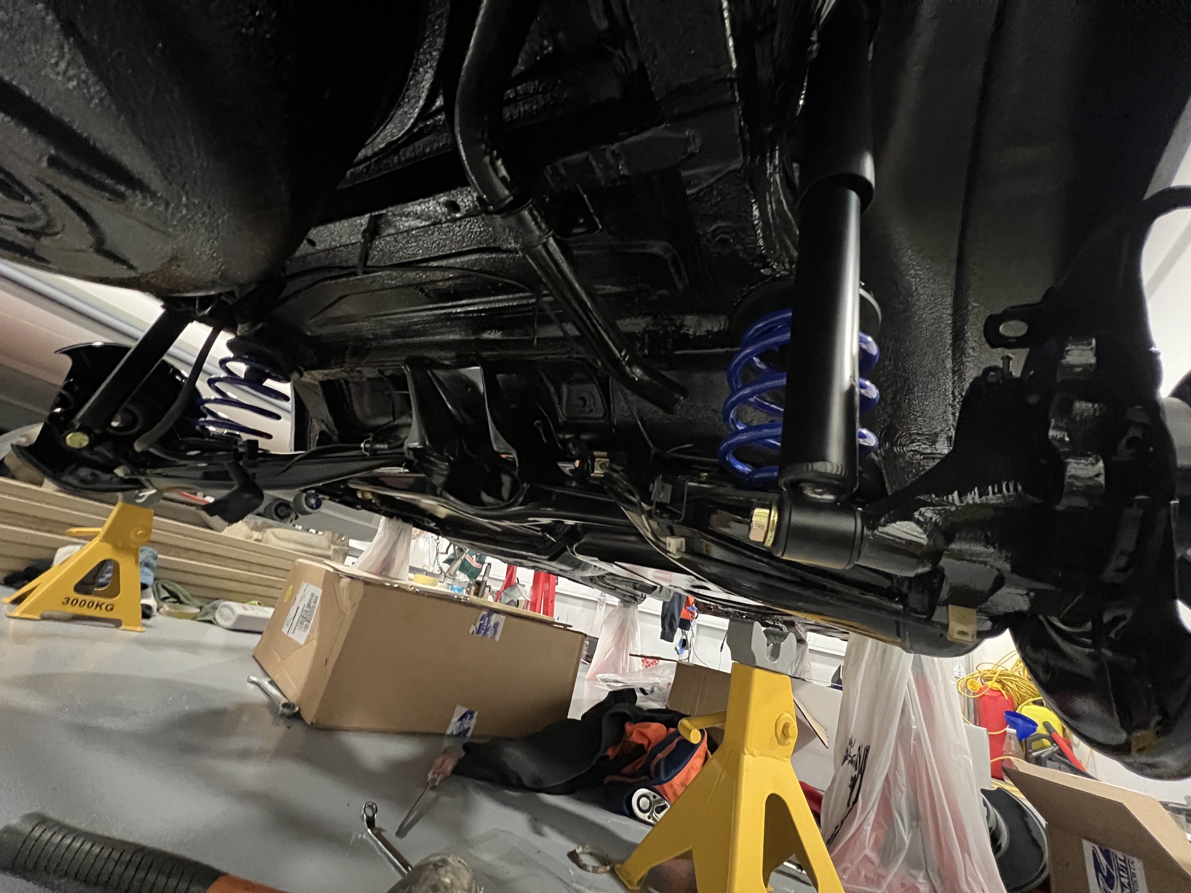

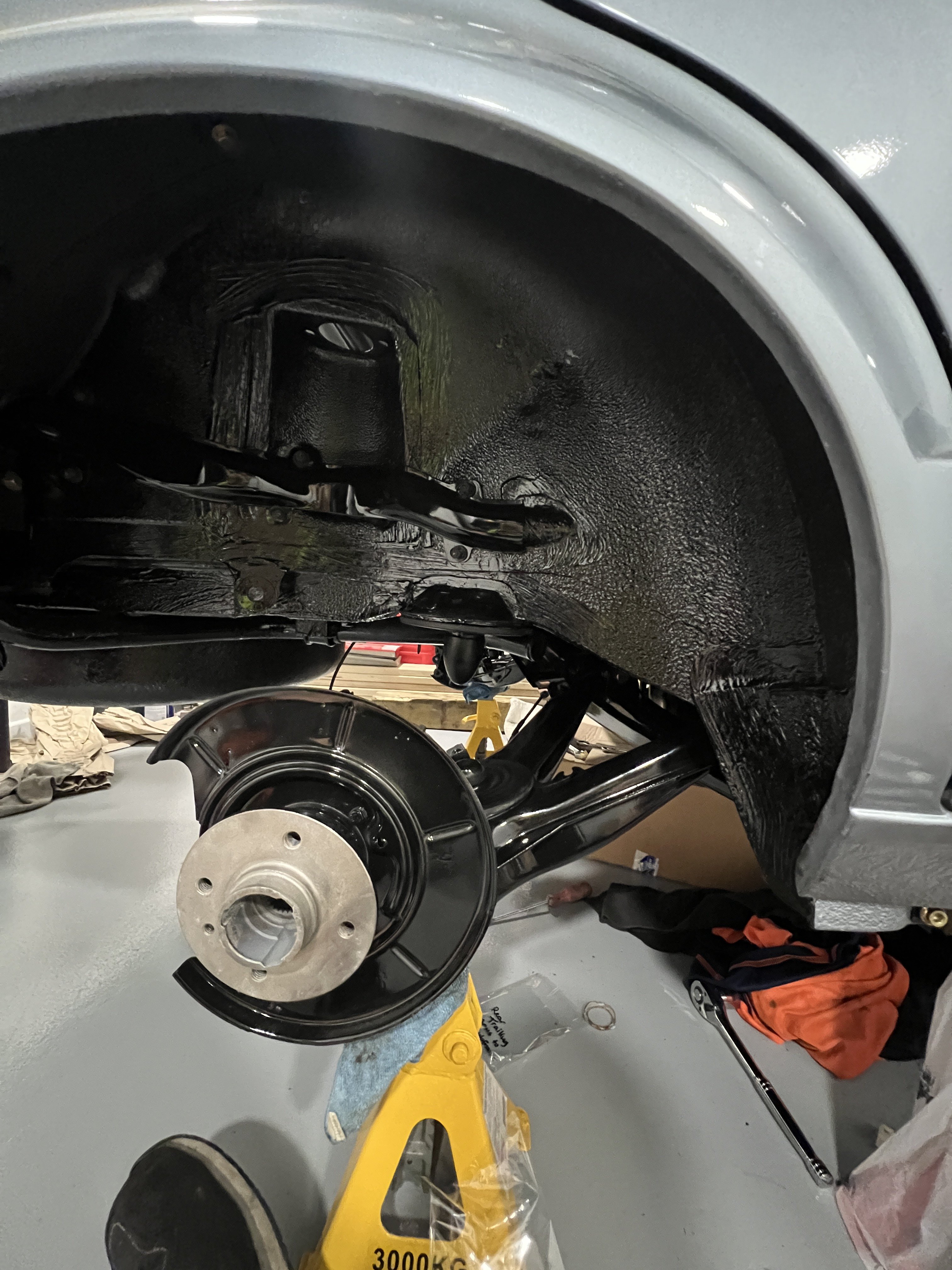

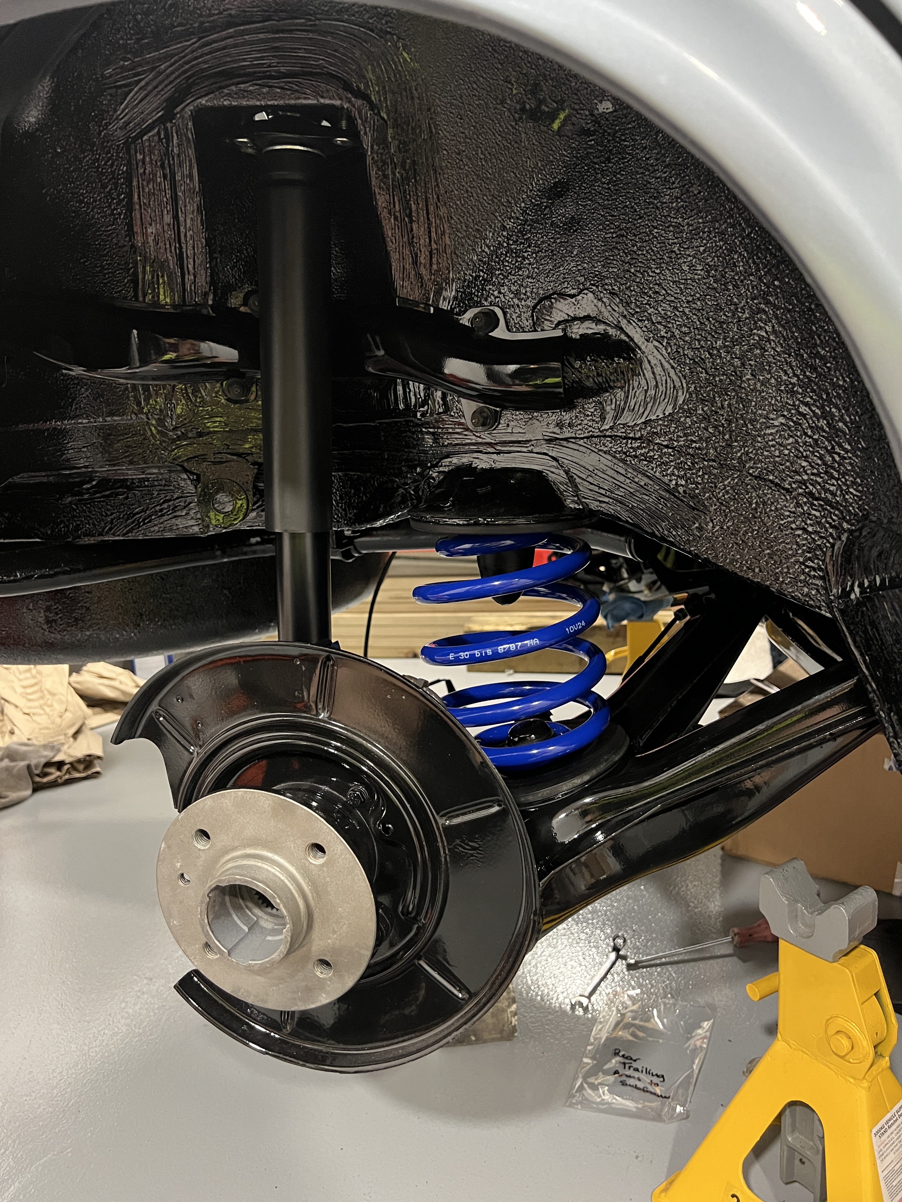

elias 454 Report post Posted July 29 Recent progress. Got the front Wheel bearings installed on to the strut tubes, along with the dust shields. Rear wheel bearings pressed out and new ones installed, hub flanges pressed in as well. Trailing arms back in the car, brake lines hooked up. Assembled the rear struts with new top mounts, and installed them along with the new springs. Haven’t torqued bolts down yet as that will need to be done at ride height. next up is handbrake assembly and handbrake cables, then need to order some new discs and pads. Haven’t done much else on the front suspension as I’m hoping to install the engine and gearbox from underneath, so subframe will only go into the car with the engine. Have all new arms m3 offset bushings etc all ready to go for when that happens. clutch kit arrived as well now so just need to sort a starter motor and some bellhousing bolts and engine and box can be bolted up and put in the car, have the engine and gearbox mounts sitting on the shelf ready to go. 5 Quote Share this post Link to post Share on other sites

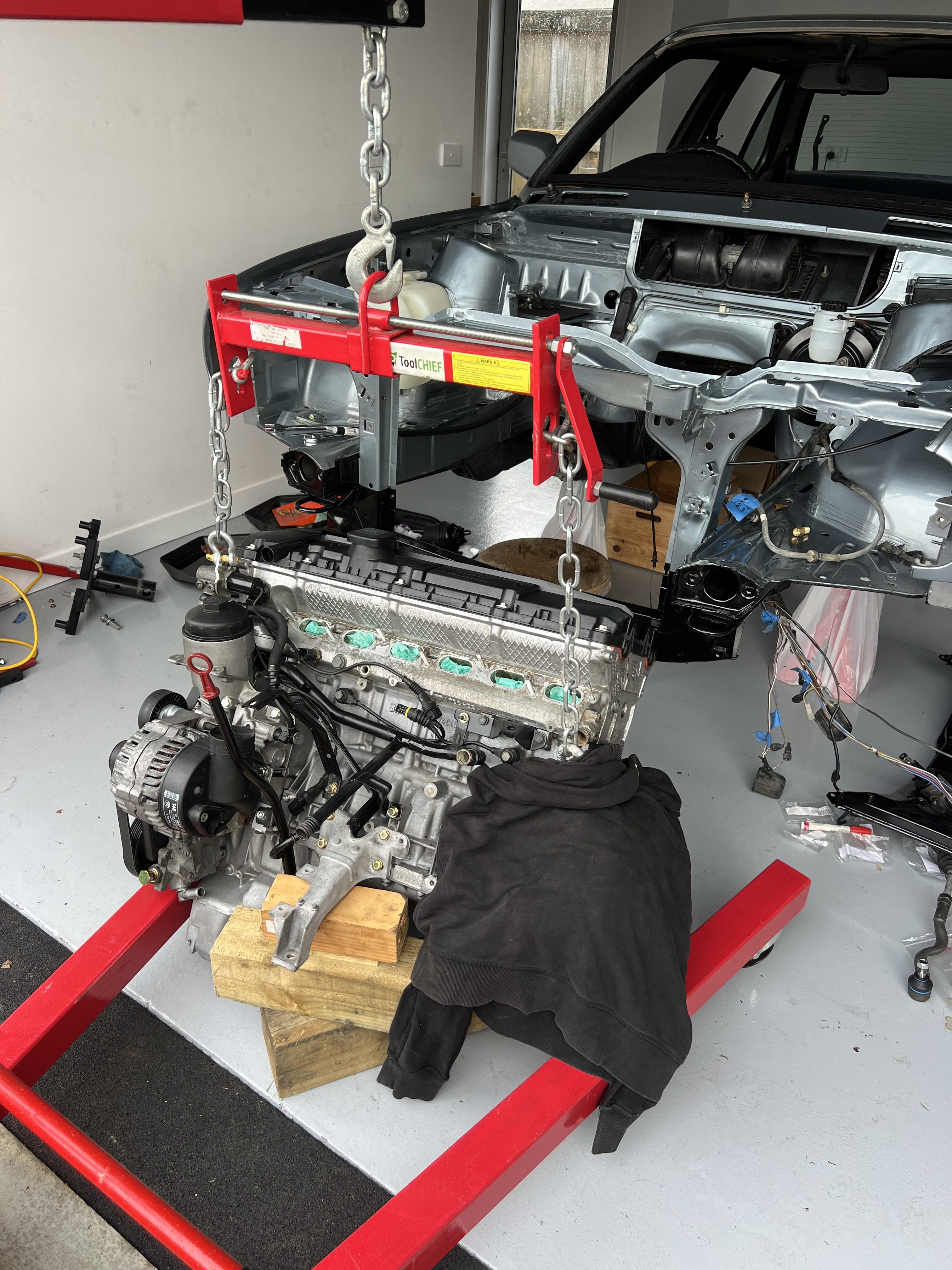

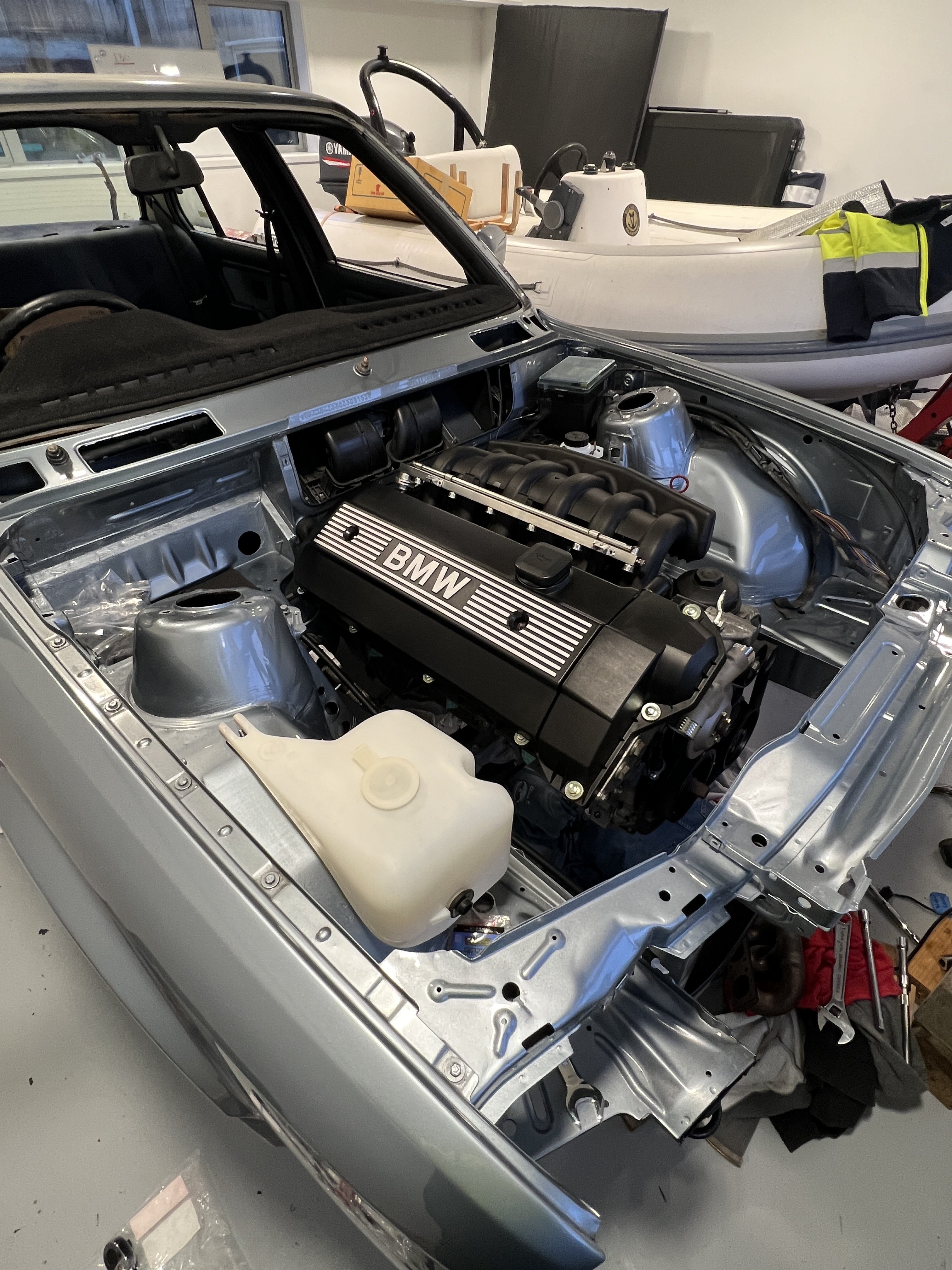

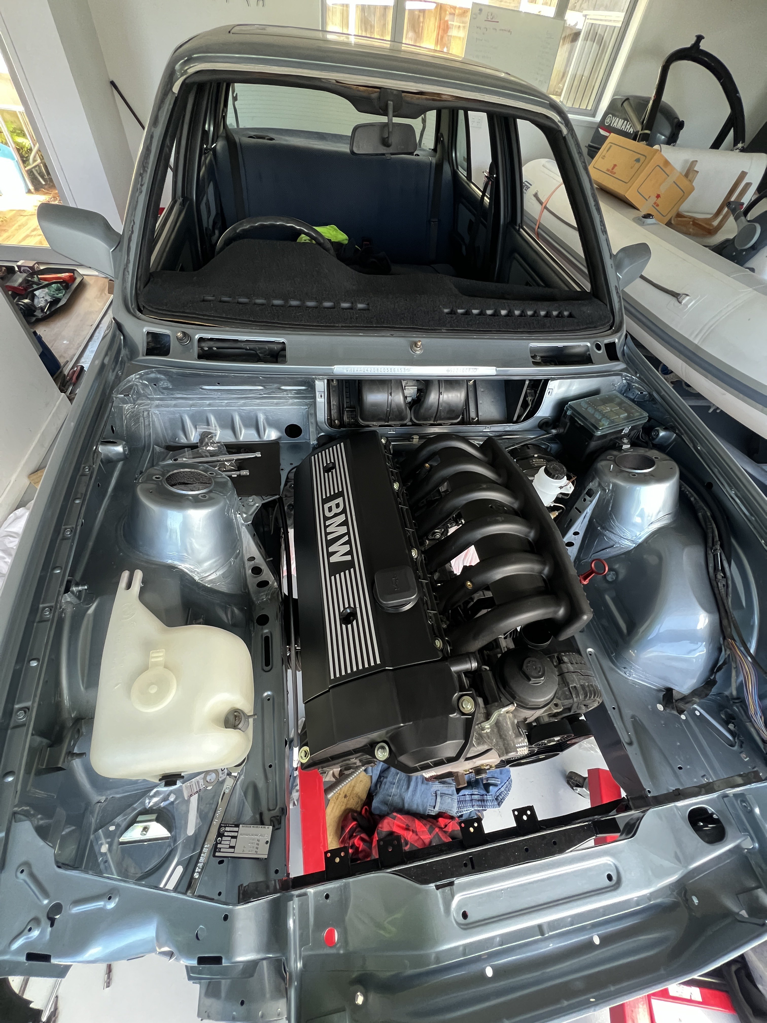

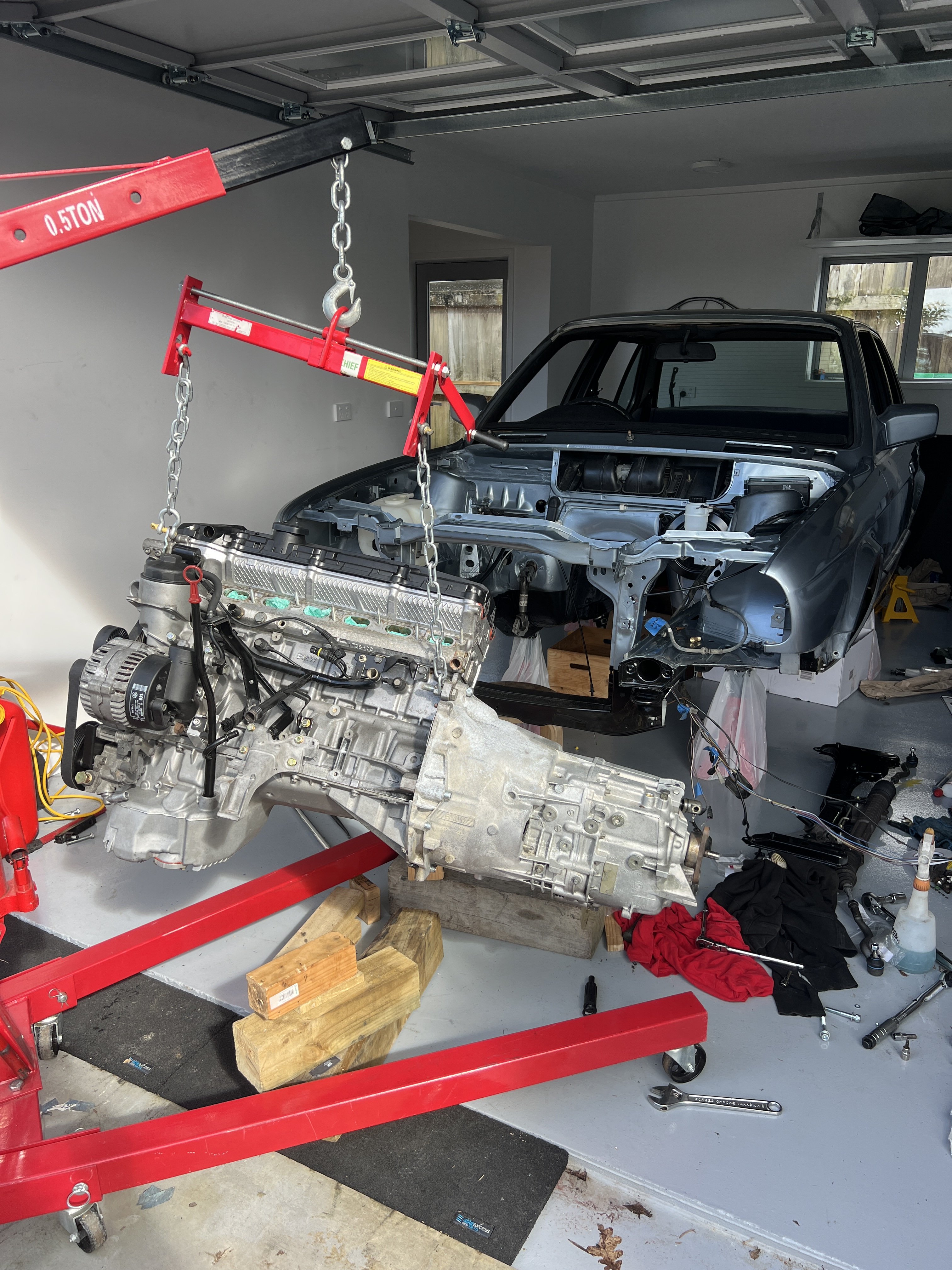

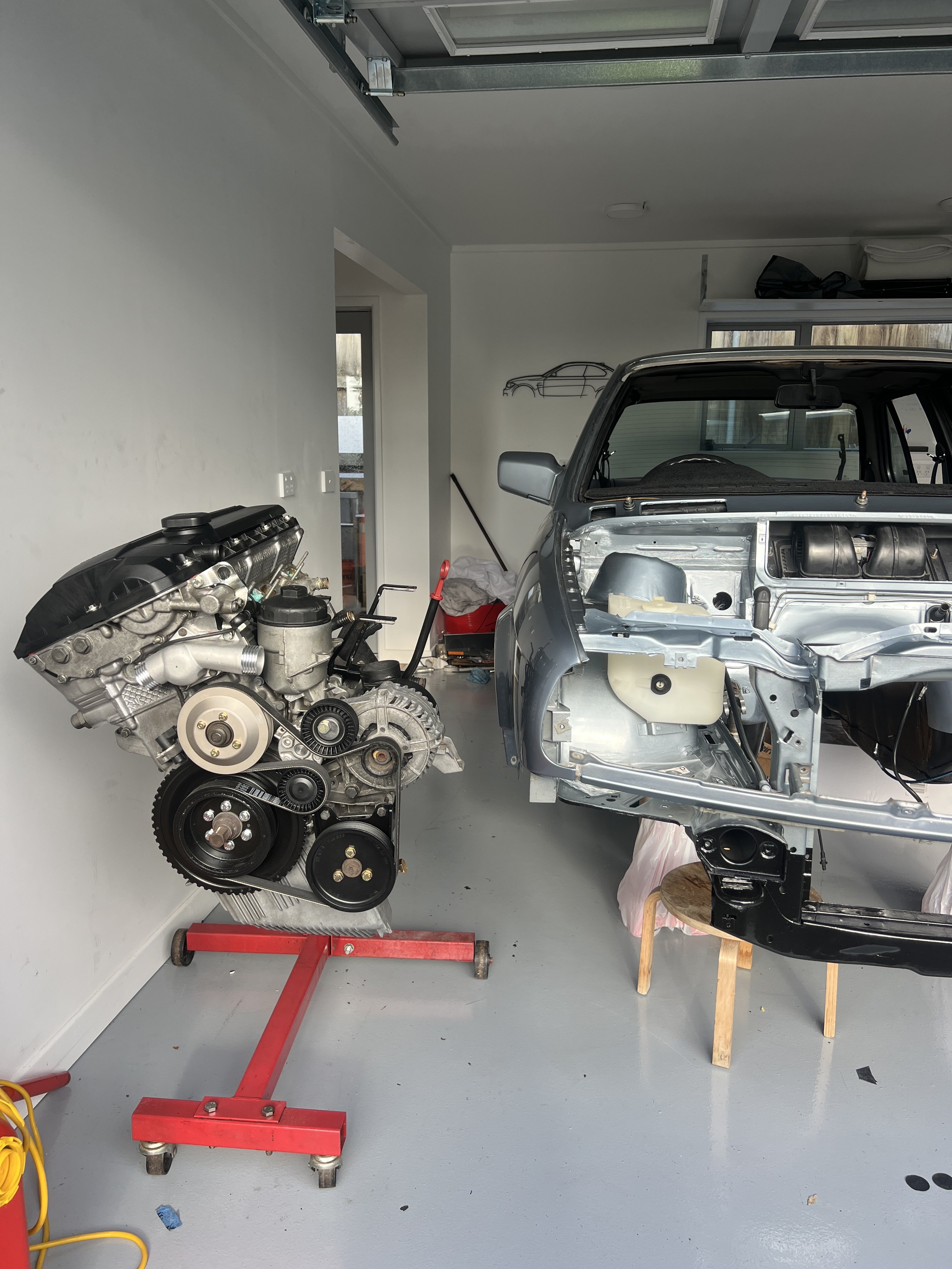

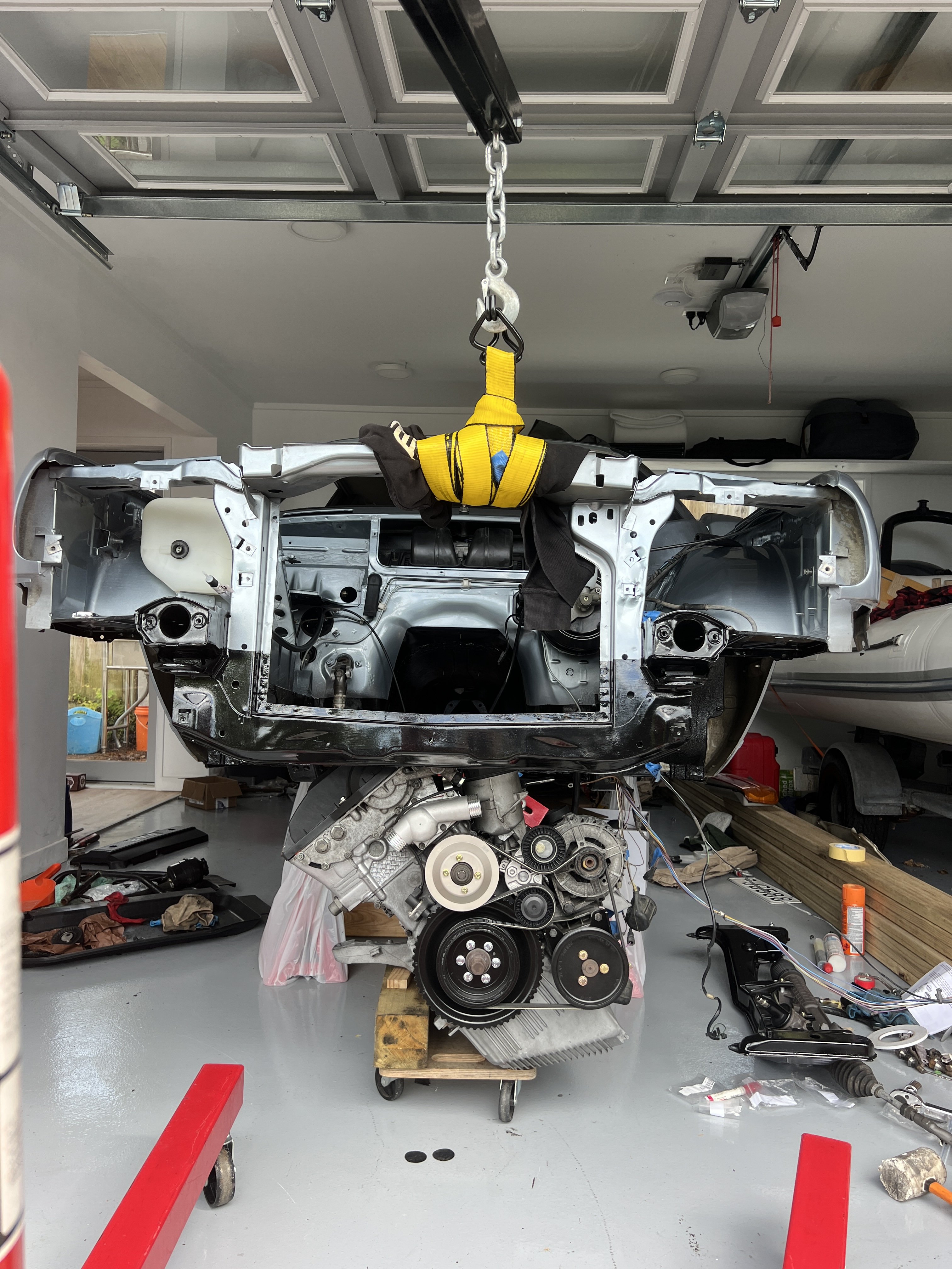

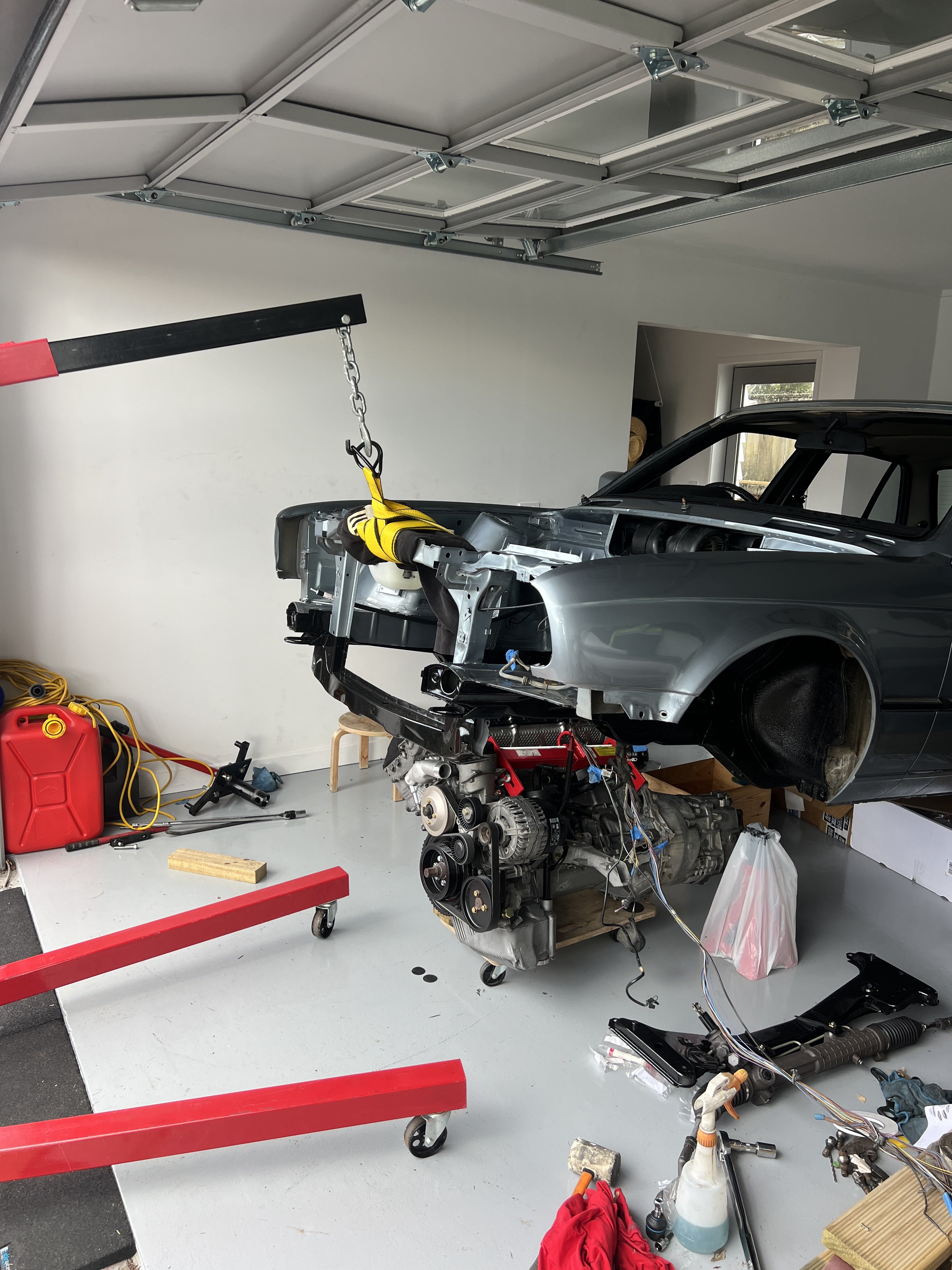

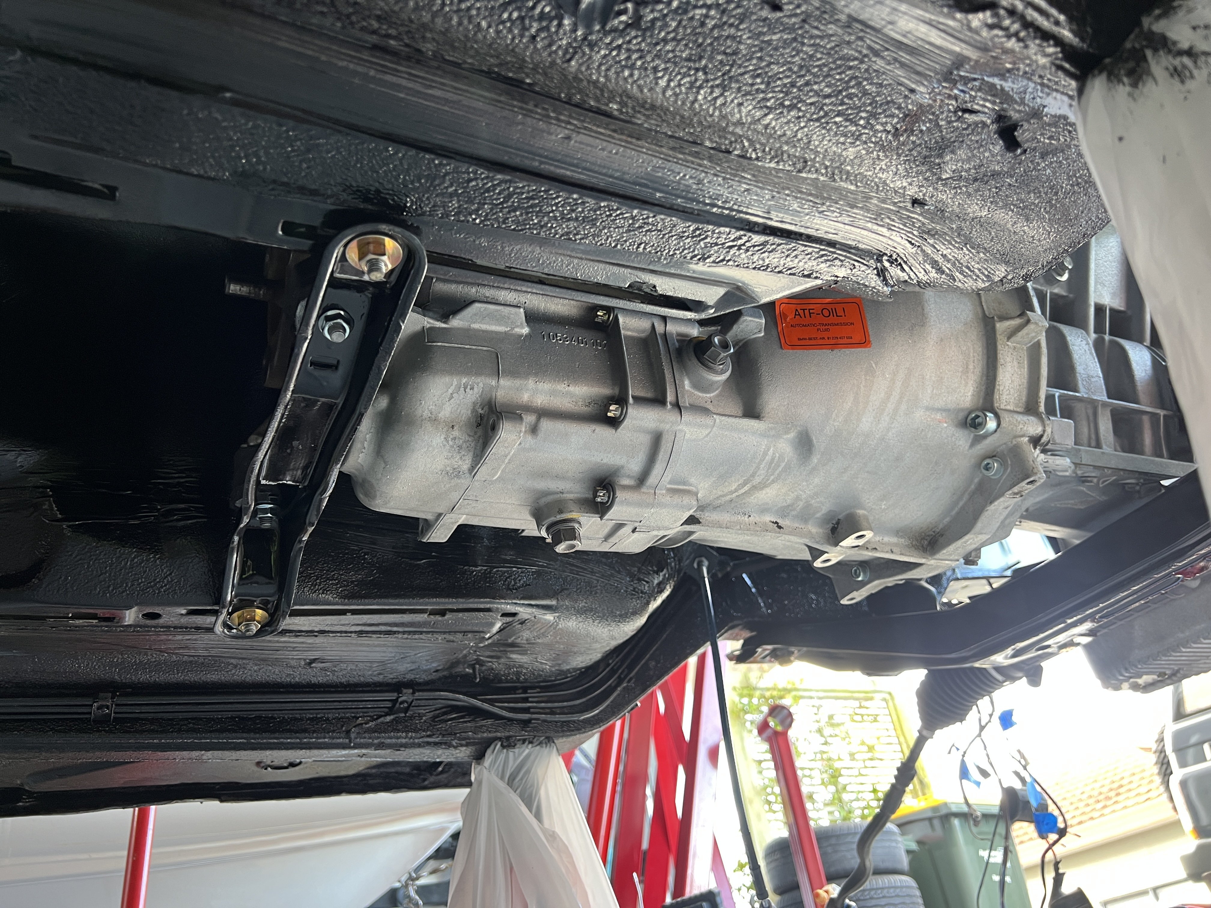

elias 454 Report post Posted Saturday at 07:05 AM Big progress today, got the engine and gearbox in. Fresh oem LUK clutch. Put the engine in from underneath, that way I could install it in one go with the gearbox without risking scratching the painted engine bay. easy enough to lift the car up with the crane, slide the engine and gearbox underneath, then lower the car back down, lift the engine and box up through the bay with the crane again. Subframe and steering rack bolted on from underneath, some fresh control arms and m3 offset bushings to finish it off. 8 Quote Share this post Link to post Share on other sites
