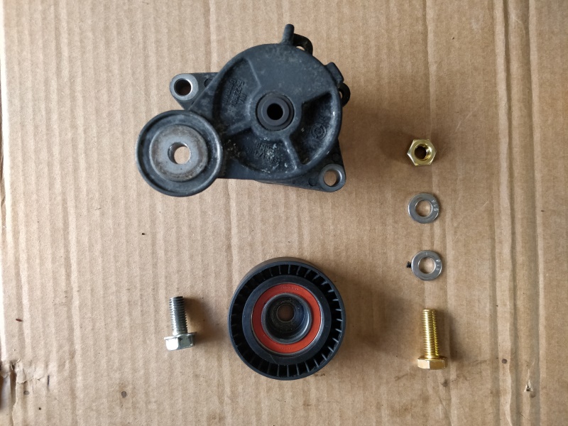

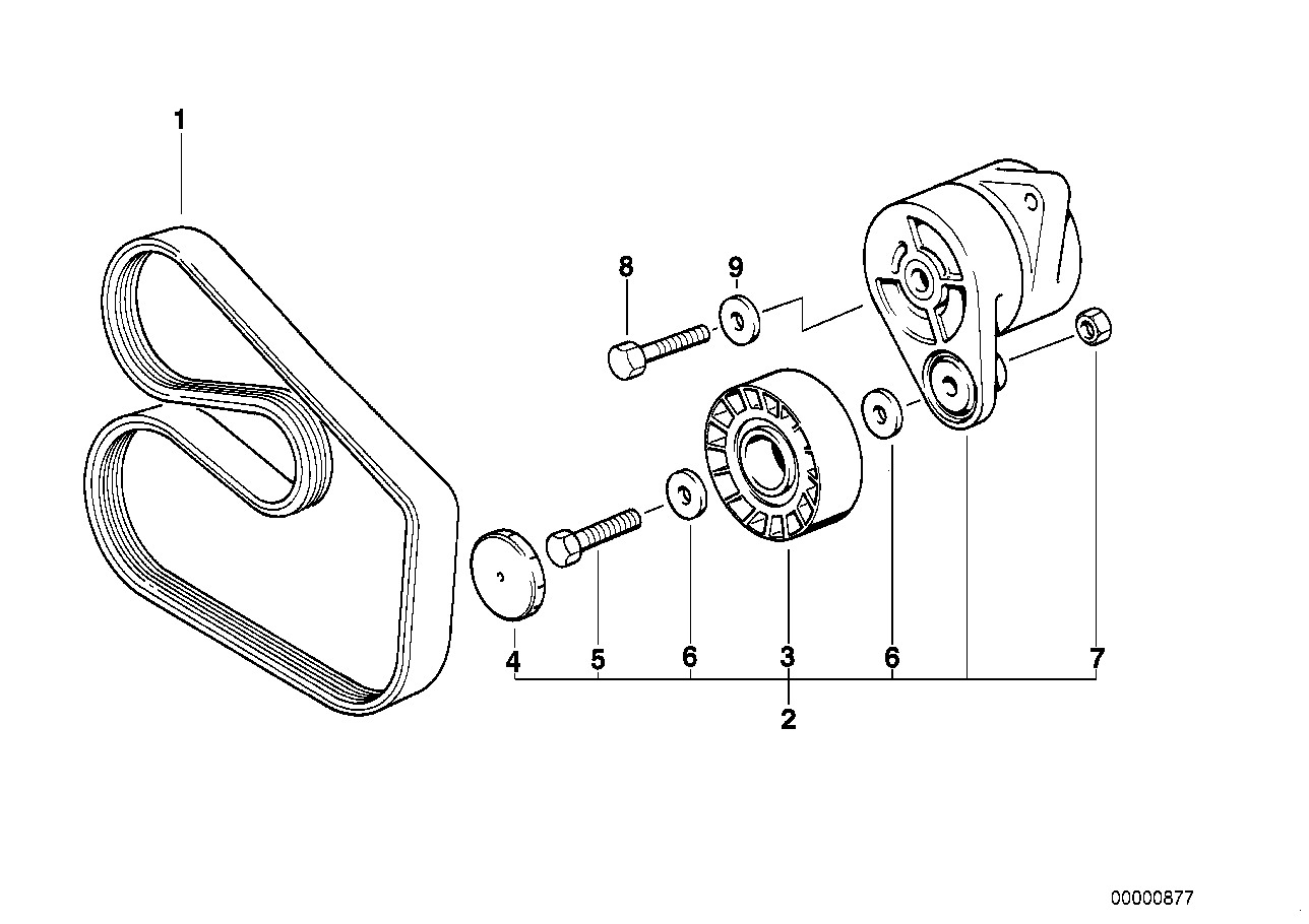

M3AN 4183 Report post Posted June 15, 2018 What's the recommended way to loosen belts with these types of mechanical tensioner? Mine doesn't have a hex molded into the housing (not shown in this picture) so the only thing to "grab" is bolt #5 in the diagram... except that just spins. I can remove the whole unit and get the pulley (#3) off by undoing #5 and #7 but ultimately that's no help. I realise I'd be better off upgrading to a hydraulic unit but I see no need to go to that expense since this one is holding tension just fine. I just can't loosen it to get a belt on. TIA. Quote Share this post Link to post Share on other sites
zero 1162 Report post Posted June 15, 2018 Can you get a spanner onto #7? 1 Quote Share this post Link to post Share on other sites
Gabe79 410 Report post Posted June 15, 2018 (edited) 15 minutes ago, M3AN said: What's the recommended way to loosen belts with these types of mechanical tensioner? Mine doesn't have a hex molded into the housing (not shown in this picture) so the only thing to "grab" is bolt #5 in the diagram... except that just spins. I can remove the whole unit and get the pulley (#3) off by undoing #5 and #7 but ultimately that's no help. I realise I'd be better off upgrading to a hydraulic unit but I see no need to go to that expense since this one is holding tension just fine. I just can't loosen it to get a belt on. TIA. Stick a shallow socket onto the 'bolt' built into the tensioner in the picture attached and turn. I forget what it is, but it's a regular size, maybe 16mm? EDIT: Oh, yours don't look like these eh. Yeah, you be screwed. Edited June 15, 2018 by Gabe79 1 Quote Share this post Link to post Share on other sites
M3AN 4183 Report post Posted June 15, 2018 Thanks guys. 4 minutes ago, zero said: Can you get a spanner onto #7? Yes, when it's off the car... I doubt it when it's on the car without removing the alternator and then I wouldn't be able to install the belt. What did you have in mind? 2 minutes ago, Gabe79 said: Stick a shallow socket onto the 'bolt' built into the tensioner in the picture attached and turn. I forget what it is, but it's a regular size, maybe 16mm? Yes, that's what I was hoping (and expecting) to find but my housing doesn't have that hex... mine looks identical to the diagram. so slightly different to yours... Quote Share this post Link to post Share on other sites

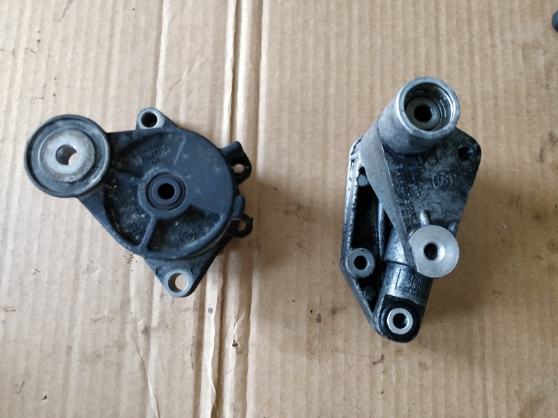

Gabe79 410 Report post Posted June 15, 2018 2 minutes ago, M3AN said: Thanks guys. Yes, when it's off the car... I doubt it when it's on the car without removing the alternator and then I wouldn't be able to install the belt. What did you have in mind? Yes, that's what I was hoping (and expecting) to find but my housing doesn't have that hex... mine looks identical to the diagram. so slightly different to yours... Mine is the original on the left, and the OEM replacement on the right. Can you post a picture of yours? I have seem a technique on youtube where you stick a star socket onto the pulley and turn. If you have no bolt... maybe that? 1 Quote Share this post Link to post Share on other sites
zero 1162 Report post Posted June 15, 2018 16 minutes ago, M3AN said: Thanks guys. Yes, when it's off the car... I doubt it when it's on the car without removing the alternator and then I wouldn't be able to install the belt. What did you have in mind? If you can tighten the bolt tight enough it might be able to be used to release the tension on the tensioner. If not, your tensioner might be faulty? 2 Quote Share this post Link to post Share on other sites
M3AN 4183 Report post Posted June 15, 2018 I don't think I can tighten it that much, no... looks like this... Quote Share this post Link to post Share on other sites
M3AN 4183 Report post Posted June 16, 2018 (edited) Okay, I worked out how to fix that ^ mechanical tensioner. 1. Drive 12 mins to Zebra Pick-A-Part 2. Spend 3 mins finding the only 6 cylinder BMW that's there 4. Take 5 mins to test and remove hydraulic tensioner 5. Pay $15 6. Drive 12 mins home 7. Spend 10 mins installing new tensioner and belts 8. Victory dance The problem with Pick-A-Part is coming home with more than you intended... practically mint. Edited June 16, 2018 by M3AN 3 3 Quote Share this post Link to post Share on other sites
allan 295 Report post Posted June 16, 2018 Have you tried using a set of multi grip pliers and get a grip of the lug on the tensioner then move it in the direction which loosens the belt .This should put the lug on the other side of the hole on the mounting plate put a suitable sized allen key in the hole this will lock the unit up. It is easier to do with the type that has the hex nut hope that helps. Quote Share this post Link to post Share on other sites
