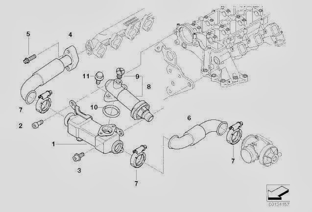

gjm 3300 Report post Posted December 8, 2013 It stopped raining this afternoon. And I deferred a look at an M-Sport E36 to stay home and sort dinner, and look at my car. (The jury is out on whether this was a good idea.) I pulled all the plastic cover stuff off the engine and decided to try cleaning the EGR (Exhaust Gas Recirculation) valve. Simple enough - it's at the right front of the engine, easily visible. However, the clamp/band around the pipe to the left as viewed from the front (I'll work out what it connects to later) refused to release. It's not so much a Jubilee clip, as a welded-in-place clamp belt. Yup, it is actually spot-welded to whatever is underneath. Removing it isn't a quick option. There was wet, dirty oil in the EGR housing, which I suspect can't be good. However, in the absence of any really good ideas, I chose the easy option and stuffed a plastic golf tee into the vacuum line connecting to the EGR housing. (Collected from the works 'do', last week. ) Initial impressions are that the engine is more responsive. Hmm. Maybe. I'm sceptical, but corroboration from other forums suggests it may be true. Reports are that cleaning the EGR valve (not really possible, unless you can remove it) can improve economy by up to 10%. Still, performance ain't the aim. Reliability and economy, while retaining existing performance, is. I'll give it a (careful) week and see how it goes. Quote Share this post Link to post Share on other sites

E30 325i Rag-Top 3043 Report post Posted December 9, 2013 With the clamp on the EGR pipe, are you prying the two halves apart after you have un-done the screw? It's not like a normal pipe clamp / Jubilee Clip, The clamp is in two C shaped halves, which do tend to stick on to the pipe. Use lots of WD40 or freeing oil and get a small screwdriver in the join and gently prise them apart - only then can you get the flanged end of the pipe out from the clamp. (Hope that makes sense - not easy to describe) Just a quick search on eBay UK, these are not the ones I have, but similar. Why do you want to go 17"s? I have the MSport suspension and the 18s are still ok, even on the rough kiwi roads. http://www.ebay.co.uk/itm/18-CSL-style-wheels-BMW-3-Series-E36-E46-E90-E91-E92-E93-Touring-Compact-/221209716175?pt=UK_CarParts_Acc_Wheels_tyres_Trims_Car_Rims_ET&fits=Car+Make%3ABMW&hash=item33812065cf#ht_2314wt_3974 Quote Share this post Link to post Share on other sites
gjm 3300 Report post Posted December 9, 2013 (edited) I couldn't (*) see that the clamp was in two halves?!? There seemed to be a continuous metal band around the outside, which appears to pull down on something which compresses and clamps on to the join between the two pipes. I was very wary about attacking this as I had no replacement clip, and I really didn't want to end up with a dead car in the drive! The 17s are as much for retaining as much ride comfort as anything else. Putting 18s on my car now wouldn't look right and would require suspension work to suit, something I don't have time or money for at present. I can get a set of 4 used 17x7.5s for no more than $500, probably less. The (single) 17x8.5 (but wrong pcd) was new and offered in Germany for €59. Useful only as a guide price. Edit: (*) - somehow I missed the n't from couldn't - completely changes the meaning and tone of the post. Sorry! Edited December 11, 2013 by gjm Quote Share this post Link to post Share on other sites
