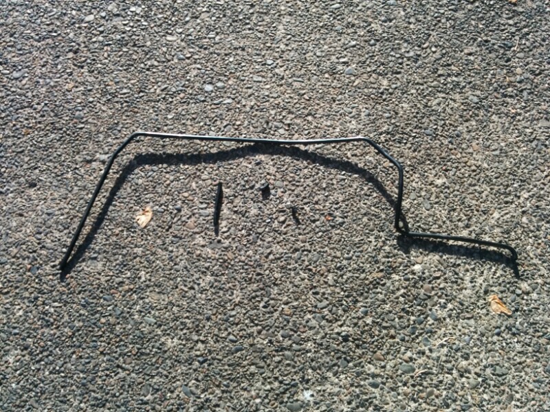

M3AN 4182 Report post Posted May 11, 2015 (edited) PSA: Expansion Tank Return Line An interesting one this - part number 17112227483 and less than $30 from BMW NZ - although I have no idea of the failure parameters and I've never heard of one failing I'd recommend replacing yours anyway. Mine basically perished in my hands when I removed it. Difficult picture but here are 4 of the 5 or more bits it fell into. I don't think you can test this pipe without breaking it and yours may be fine but for $30 I'd consider a preventative replacement because if that line blows you're out of action. Bonus Update: No coolant leaks so far! Edited May 18, 2018 by M3AN 1 Quote Share this post Link to post Share on other sites

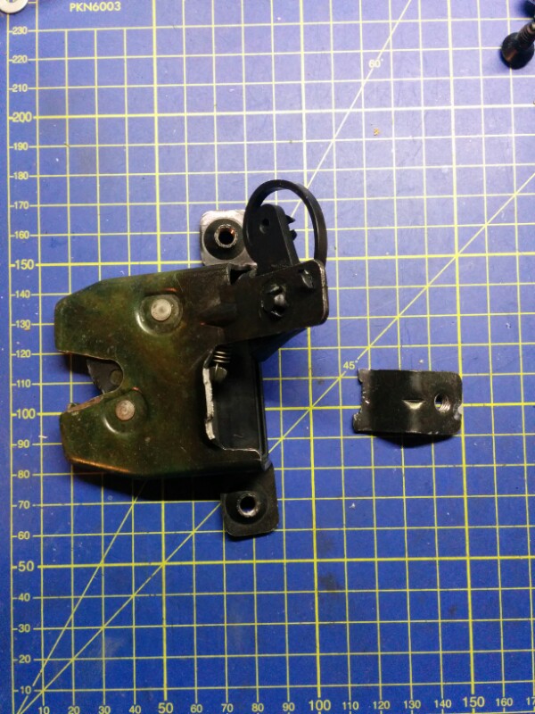

M3AN 4182 Report post Posted May 25, 2015 (edited) I recommend everybody with an E36 coupé should check their boot latch and surrounding area for damage right now... It's apparently a common problem (see here) and can lead to total failure. There's a reinforcement discussed in this thread but I made one and it prevented the boot from closing. So I've replaced the latch with an undamaged one but I imagine that too will fail over time (especially now that this area is weaker). I'll have to just keep an eye on it for the time being. Edited May 18, 2018 by M3AN 1 Quote Share this post Link to post Share on other sites

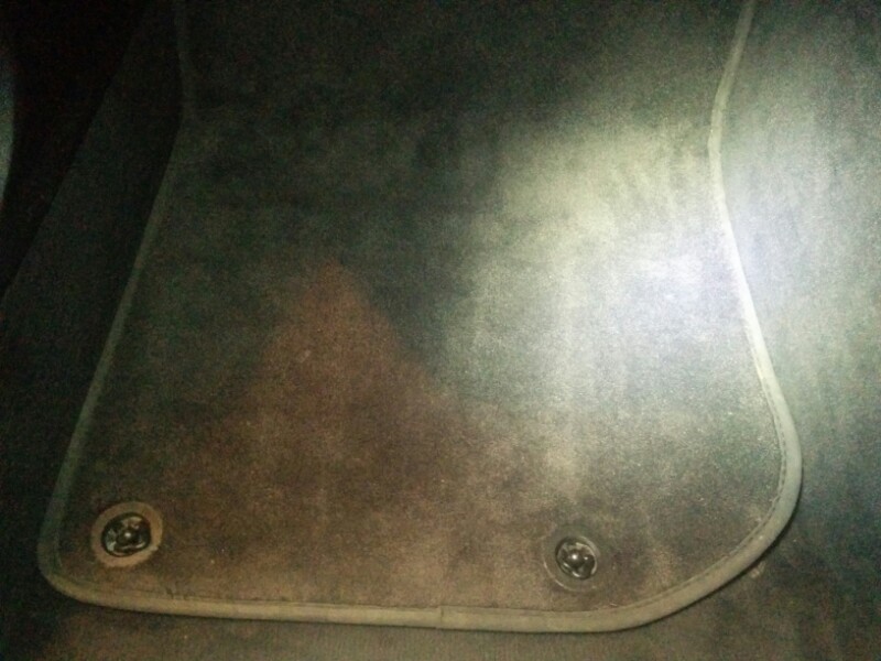

M3AN 4182 Report post Posted May 25, 2015 (edited) I finally got around to replacing my old floor mats too and I have to say the new (to me) ones look fantastic. Finally I have floor mats that match my carpet perfectly and are all clipped down properly. I'll keep my old mats because whilst they're OEM they're some type of super heavy duty ones that I've never seen before. Could come in handy if I'm hauling around dirty crap. Thanks to Brent at BM World: Edited May 18, 2018 by M3AN 1 Quote Share this post Link to post Share on other sites
euroriffic 630 Report post Posted May 25, 2015 (edited) Had the same issue with boot latch in the m3 and the 328 sedan I used to have. I just got the latch rear mount welded up with a new, stronger piece and had to get boot welded up aswel from cracking . Also broke my rad expansion line too at the 180' bend, just put hose and clamp on it for now. Might get a stainless/ copper one bent up to look classy. Also what's the idea behind the slots in the tie rods? Edited May 25, 2015 by euroriffic Quote Share this post Link to post Share on other sites
M3AN 4182 Report post Posted May 25, 2015 Had the same issue with boot latch in the m3 and the 328 sedan I used to have. I just got the latch rear mount welded up with a new, stronger piece and had to get boot welded up aswel from cracking . Also broke my rad expansion line too at the 180' bend, just put hose and clamp on it for now. lol - standard e36 problems then! :-/ Also what's the idea behind the slots in the tie rods? Long story, see here. Quote Share this post Link to post Share on other sites
