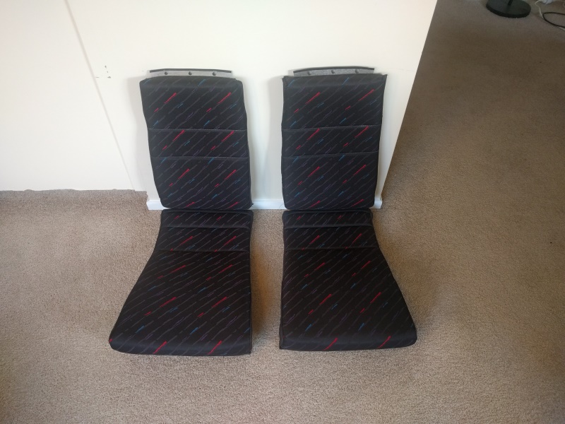

Southerner 153 Report post Posted June 23, 2020 Its begun E30 in shed last night, rear lights bumper trim etc off for rust inspections. Not as bad as thought. Motor wiring disconnected, will drain fluids and disconnect exhaust and driveshaft tomorrow night. Motor out by weekend. Purchased these a couple weeks back, also have the rear seat to unstitch for cloth repairs Rolling chassis by next week, better start doing the detent refresh on the ZF and get the rust repaired. 5 Quote Share this post Link to post Share on other sites
