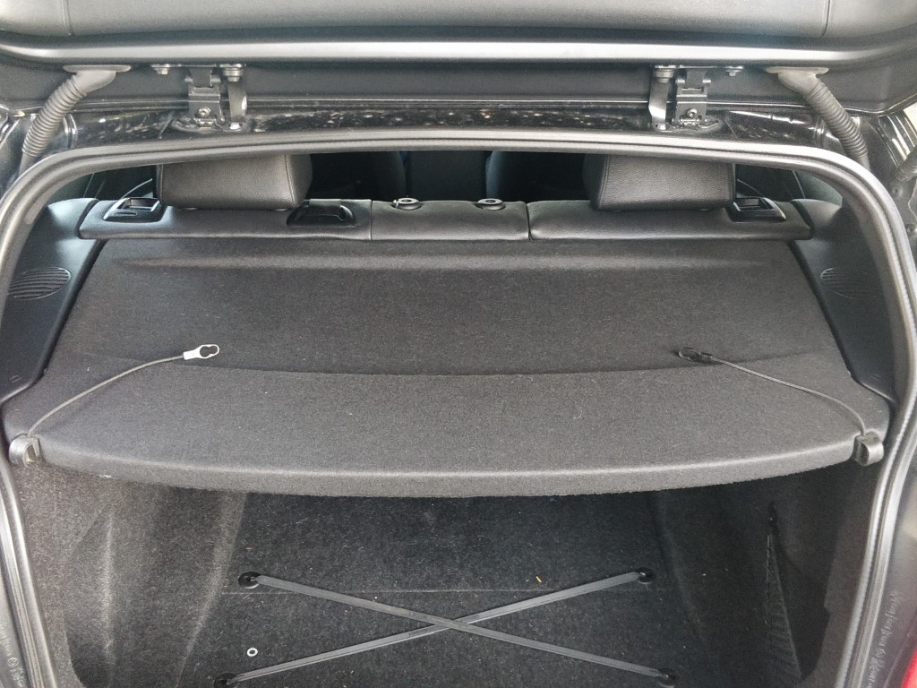

M3AN 4199 Report post Posted June 2, 2020 (edited) Finally got a rear parcel tray, that being absent was annoying me disproportionately. Everyone I called wanted $120-140 for one, picked up this mint one for $70 (which I still consider expensive but they seem to be like hens' teeth). Edited May 2 by M3AN 1 Quote Share this post Link to post Share on other sites
B.M.W Ltd 951 Report post Posted June 2, 2020 The hens teeth I picked up last week were expensive too ? 1 Quote Share this post Link to post Share on other sites
M3AN 4199 Report post Posted June 2, 2020 6 minutes ago, B.M.W Ltd said: The hens teeth I picked up last week were expensive too ? I chased a f'ing chicken for 20 mins, couldn't catch it! No teeth acquired. ? Quote Share this post Link to post Share on other sites
Gaz 1077 Report post Posted June 2, 2020 Had the same problem with the Mrs mondeo and my e36, couldn't find one in Christchurch let alone for a decent price. Then in lockdown one popped up on trademe for $60. Got a damaged one for the e36 for nothing but still a pain Quote Share this post Link to post Share on other sites
M3AN 4199 Report post Posted June 2, 2020 (edited) 28 minutes ago, Gaz said: Had the same problem with the Mrs mondeo and my e36, couldn't find one in Christchurch let alone for a decent price. Then in lockdown one popped up on trademe for $60. Got a damaged one for the e36 for nothing but still a pain Have no idea what the story is, the guys at the parts place said so many cars come form Japan with them missing that they wondered once if they could be optioned-out at purchase. Unlikely but it is a strange bit of kit to be largely made of unobtainium. I also found (one of) the parts place(s) that takes everything of value before cars get moved on to Zebra or Pick-a-Part... pay a little more but almost a guarantee of availability (they use that NZ wide parts database that us outsiders can't see). They had 3 parcel trays for me to choose from whereas Zebra et al. have had none in 9 North Island E87's in the last 6 months. They left a consignment slip under the rear seat of an E87 at Zebra with their contact details so I gave them a call, they said 'pop around, no problem'. Local too. Edited June 2, 2020 by M3AN Quote Share this post Link to post Share on other sites

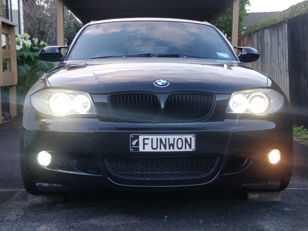

M3AN 4199 Report post Posted June 6, 2020 (edited) LED fog lights in, so much better aesthetically and these Philips lamps are high quality. One side done... Both done, matches the angel eyes well... Edited June 21, 2020 by M3AN 1 Quote Share this post Link to post Share on other sites
Jacko 2402 Report post Posted June 6, 2020 Funnily, I went totally the opposite way... pulled LED foglights out and put in some 3000k yellow halogens in as I think they looked better with yellowy light against the xenons 1 Quote Share this post Link to post Share on other sites
M3AN 4199 Report post Posted June 6, 2020 23 minutes ago, Jacko said: Funnily, I went totally the opposite way... pulled LED foglights out and put in some 3000k yellow halogens in as I think they looked better with yellowy light against the xenons My OCD got the better of me, I couldn't stand the difference between the halos and the fogs... I had to code out voltage checking but I expected as much, didn't want to stump up extra for the Philips CANBUS unit. Being LED's I can also run them as DRL''s if I like, undecided on that but it's not practical with halogens. All my white lights, inside and out, are now 5-5.5k so match quite nicely. Quote Share this post Link to post Share on other sites

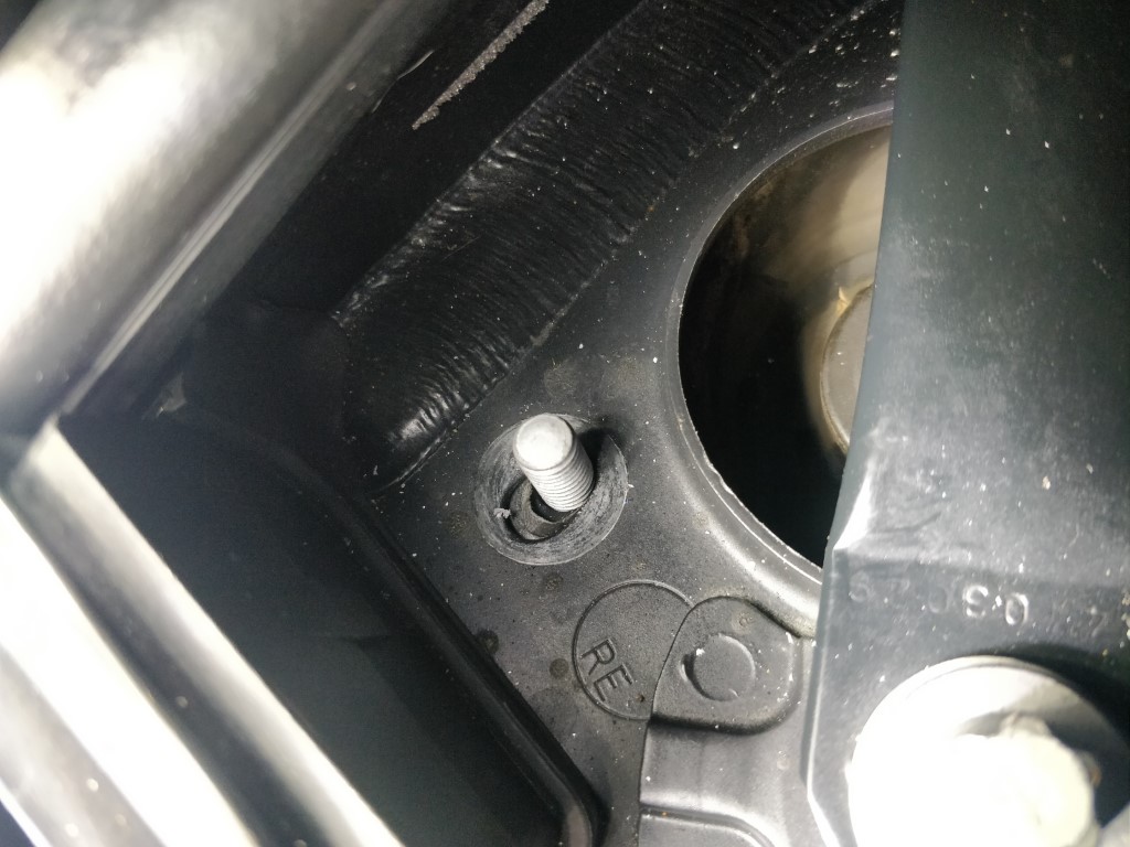

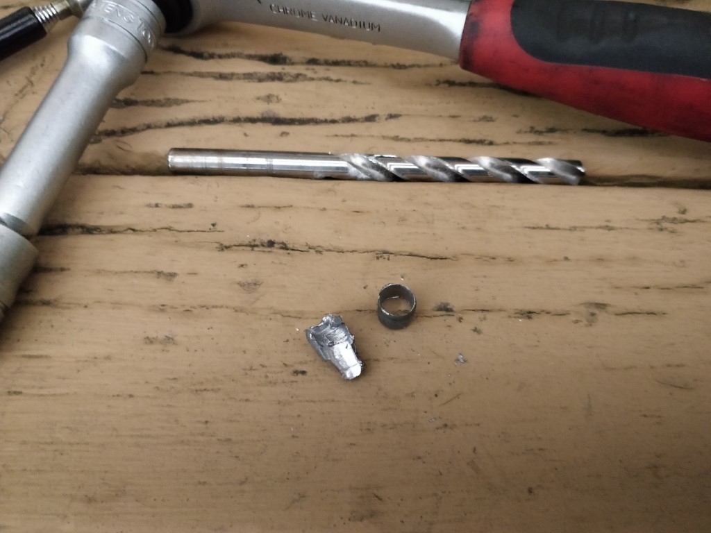

M3AN 4199 Report post Posted June 7, 2020 I completed the camber pin mod this afternoon. Had read that the pins were aluminium but mine certainly weren't and took ages to drill out (and one was easier because I did it properly, i.e. straight through the middle). Once they were out and the nuts loosened the hats moved over really easily. Apparently you get about 0.5 extra degrees, you can see the range of movement in the second pic, it's actually quite a lot. Once I've installed the M3 arms, hopefully next weekend, I'll get it aligned and am expecting about 1.5 degrees extra camber in total which is about perfect. 2 Quote Share this post Link to post Share on other sites
