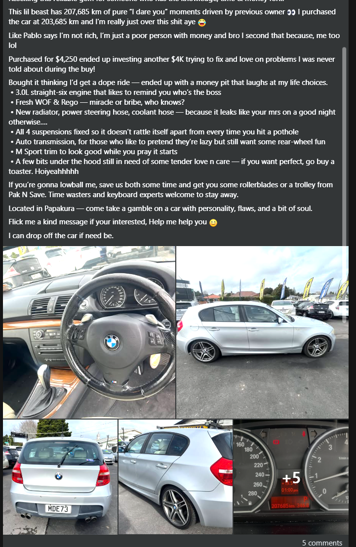

Jacko 2402 Report post Posted June 26 On facebook, looks pretty solid just needs some love and odd spec with boston lemon interior. Auto LCI, BMWP 313s, Arqay symetrical thrust exhaust and PS5s.... sounds like she wants less than 4k. 1 Quote Share this post Link to post Share on other sites
Neil McCauley 483 Report post Posted June 26 Colour combo and wood trim is amazing. Quote Share this post Link to post Share on other sites
Jacko 2402 Report post Posted June 27 Looks like as real ropey example, but... Quote Share this post Link to post Share on other sites

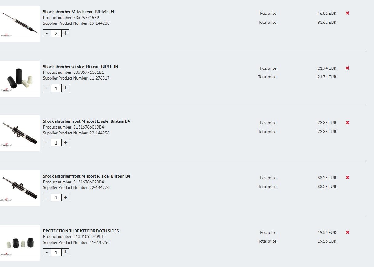

mmario 72 Report post Posted June 30 I am about to embark on this as well, going with B4s. @M3AN , do you have a part number or link for the M performance bump stops my search skills are failing me Quote Share this post Link to post Share on other sites
Driftit 2253 Report post Posted June 30 1 hour ago, mmario said: I am about to embark on this as well, going with B4s. @M3AN , do you have a part number or link for the M performance bump stops my search skills are failing me I'm just over the hill from you. We could look at combining orders to save on shipping. I am guessing each order would be over the $1K GST threshold anyway. I want to buy them asap. Quote Share this post Link to post Share on other sites
Danch 59 Report post Posted June 30 Where are you ordering them from? Keen to know the list of part numbers if you don't mind sharing. I'd be looking at ordering a set at some point. How much are you paying in total? Quote Share this post Link to post Share on other sites

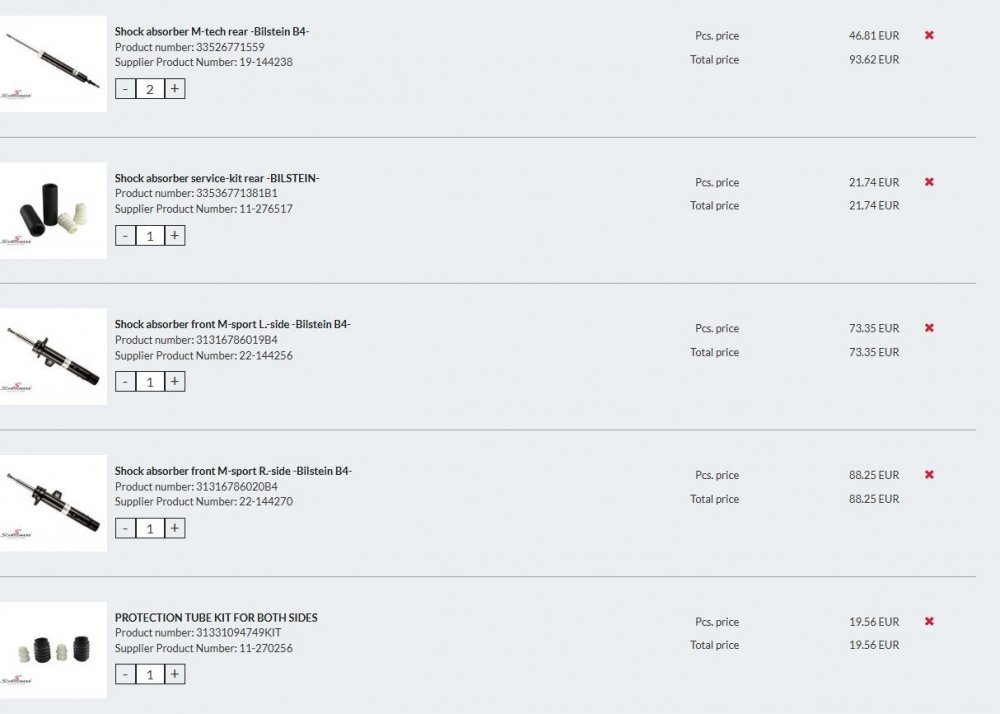

mmario 72 Report post Posted June 30 (edited) Not a bad idea but i'm not quite ready yet. Order in my cart from Schmiedman comes to 466 Euro including shipping 900 NZ Edited June 30 by mmario Quote Share this post Link to post Share on other sites
M3AN 4200 Report post Posted June 30 1 hour ago, mmario said: I am about to embark on this as well, going with B4s. @M3AN , do you have a part number or link for the M performance bump stops my search skills are failing me The rears are 33536788905, I don't think there were special front ones. 1 Quote Share this post Link to post Share on other sites
Driftit 2253 Report post Posted June 30 47 minutes ago, mmario said: Not a bad idea but i'm not quite ready yet. Order in my cart from Schmiedman comes to 466 Euro including shipping 900 NZ Not bad. Under the threshold too. Or does Schmiedman collect GST? Quote Share this post Link to post Share on other sites
mmario 72 Report post Posted June 30 Never had to pay anything extra and have purchased many parts from them Quote Share this post Link to post Share on other sites

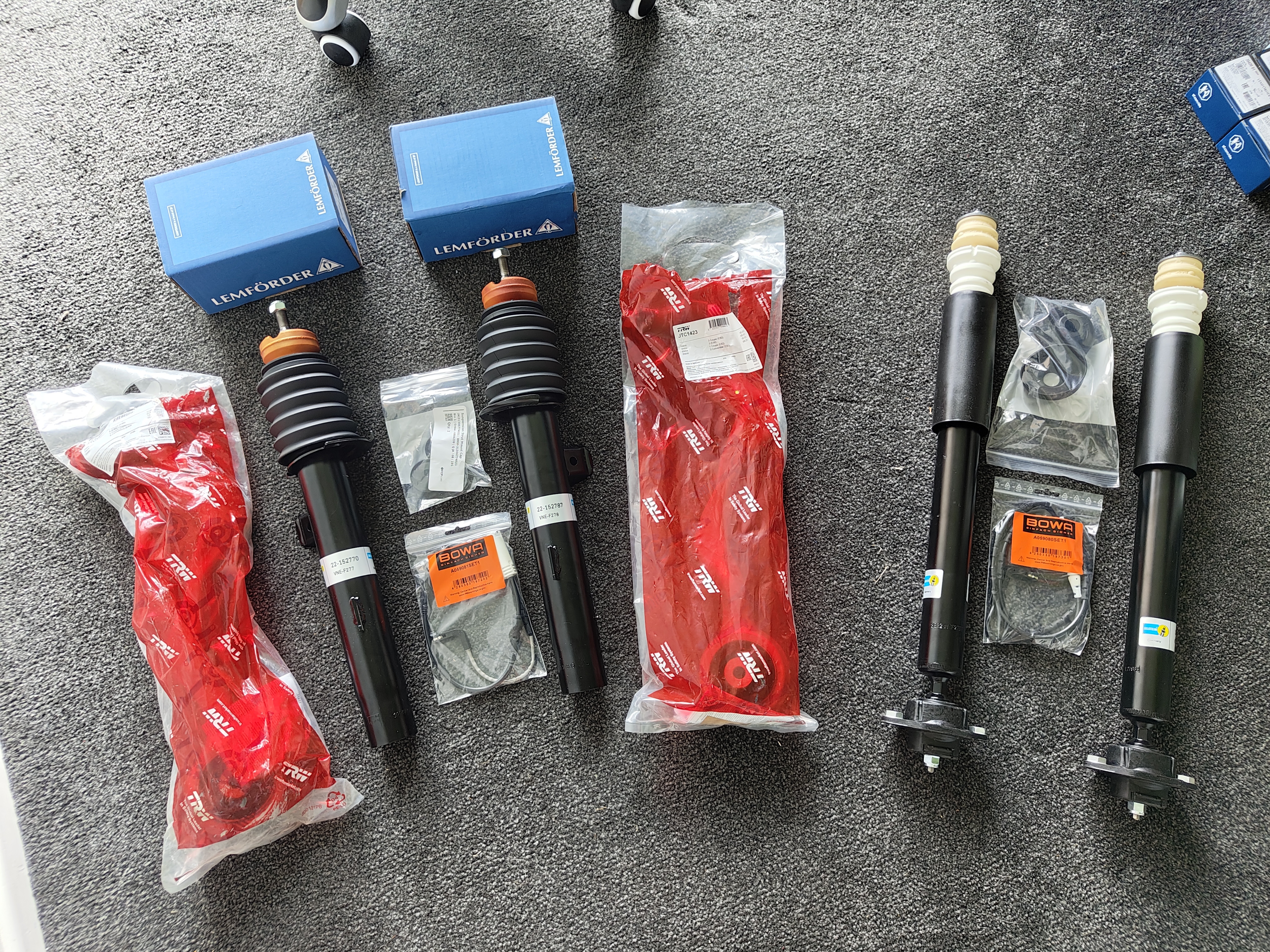

Hutty008 74 Report post Posted July 1 (edited) 13 hours ago, Driftit said: Not bad. Under the threshold too. Or does Schmiedman collect GST? I have a set of b4s on my car currently that will coming off as I'm doing an M3 rear end swap. They only have 10kms and where installed November last year. I wasn't planning on taking them off for another 2 months but I could take them off now as the car isn't being driven due to the current weather as it's on semi slicks. Let me know if you would be interested, they have the shorter Z8 front bumpstops and the now NLA BMW performance e90 euro rears, would include the new top mounts and the springs to save you having to swap your front springs on. Picture from November last year just before I installed them for reference, note the rear bumpstops in that picture aren't the BMWP ones as they didn't turn up until December. Edited July 1 by Hutty008 Quote Share this post Link to post Share on other sites

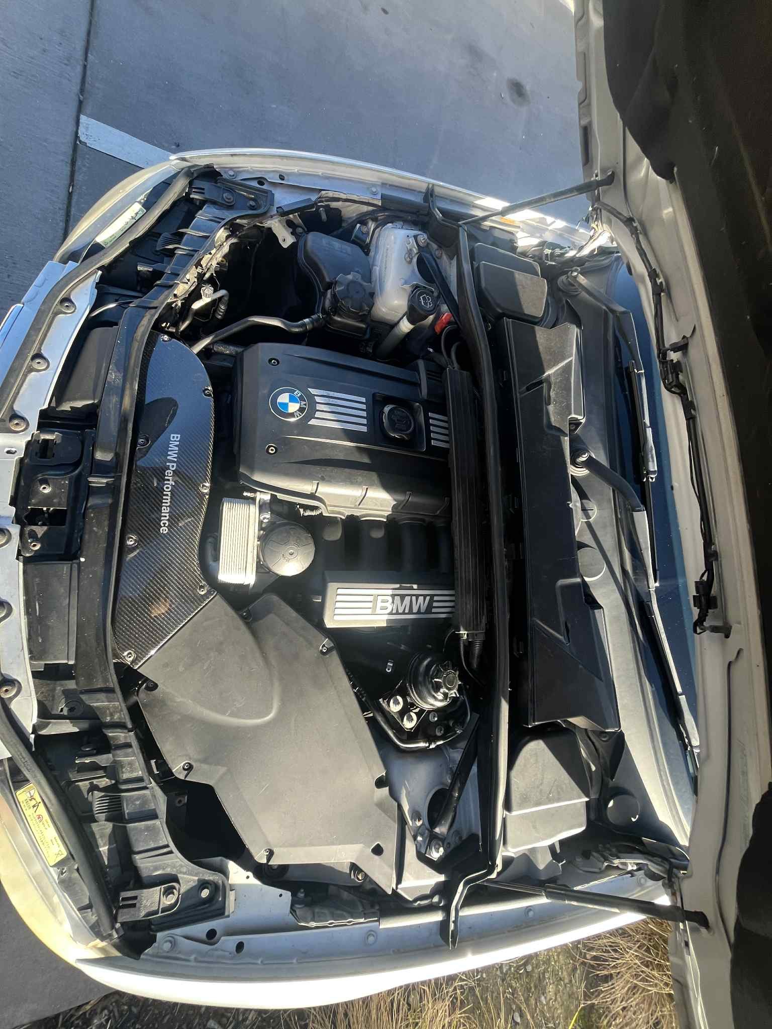

Jacko 2402 Report post Posted July 1 On 6/26/2025 at 5:31 PM, Jacko said: On facebook, looks pretty solid just needs some love and odd spec with boston lemon interior. Auto LCI, BMWP 313s, Arqay symetrical thrust exhaust and PS5s.... sounds like she wants less than 4k. I now have 2 130s.... Lots of oil leaks and the usual stuff, along with a bunch of electrical gremlins (most are likely result of few flat batteries), but its worth saving and probably robbing some parts off. 2 Quote Share this post Link to post Share on other sites
Neil McCauley 483 Report post Posted July 2 Great score! Definitely some nice fruit to peel off that - have always wondered if the 18" 313's would clear the BMWP 6 pistons as well. Quote Share this post Link to post Share on other sites
Jacko 2402 Report post Posted July 2 1 hour ago, Neil McCauley said: Great score! Definitely some nice fruit to peel off that - have always wondered if the 18" 313's would clear the BMWP 6 pistons as well. Will find out, dont actually have much of a plan other than "I need that intake".... It might get sold with the ACS 19s on it. Quote Share this post Link to post Share on other sites
M3AN 4200 Report post Posted July 2 Yep, that intake is a good score, looks purdy. 2 Quote Share this post Link to post Share on other sites

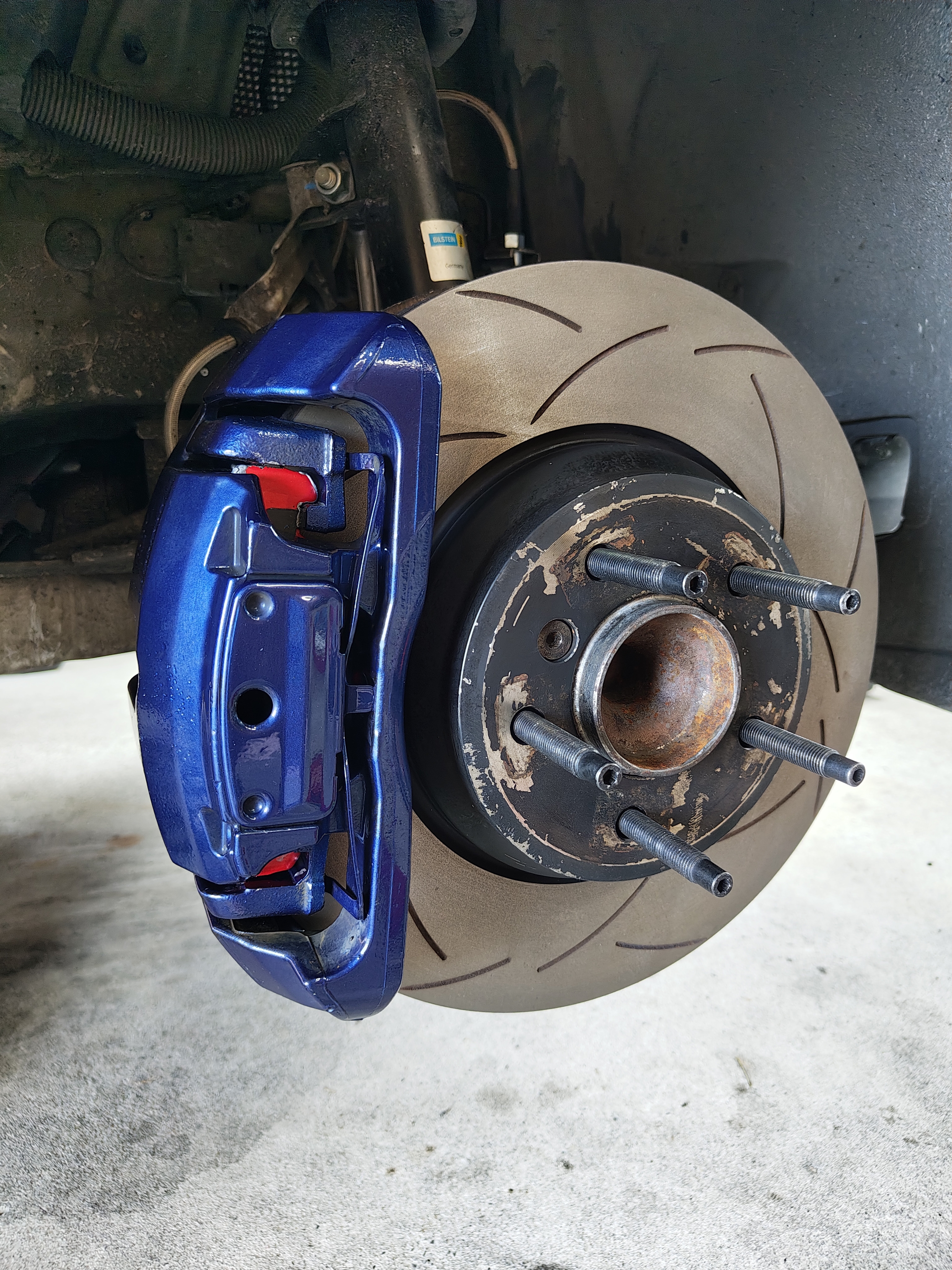

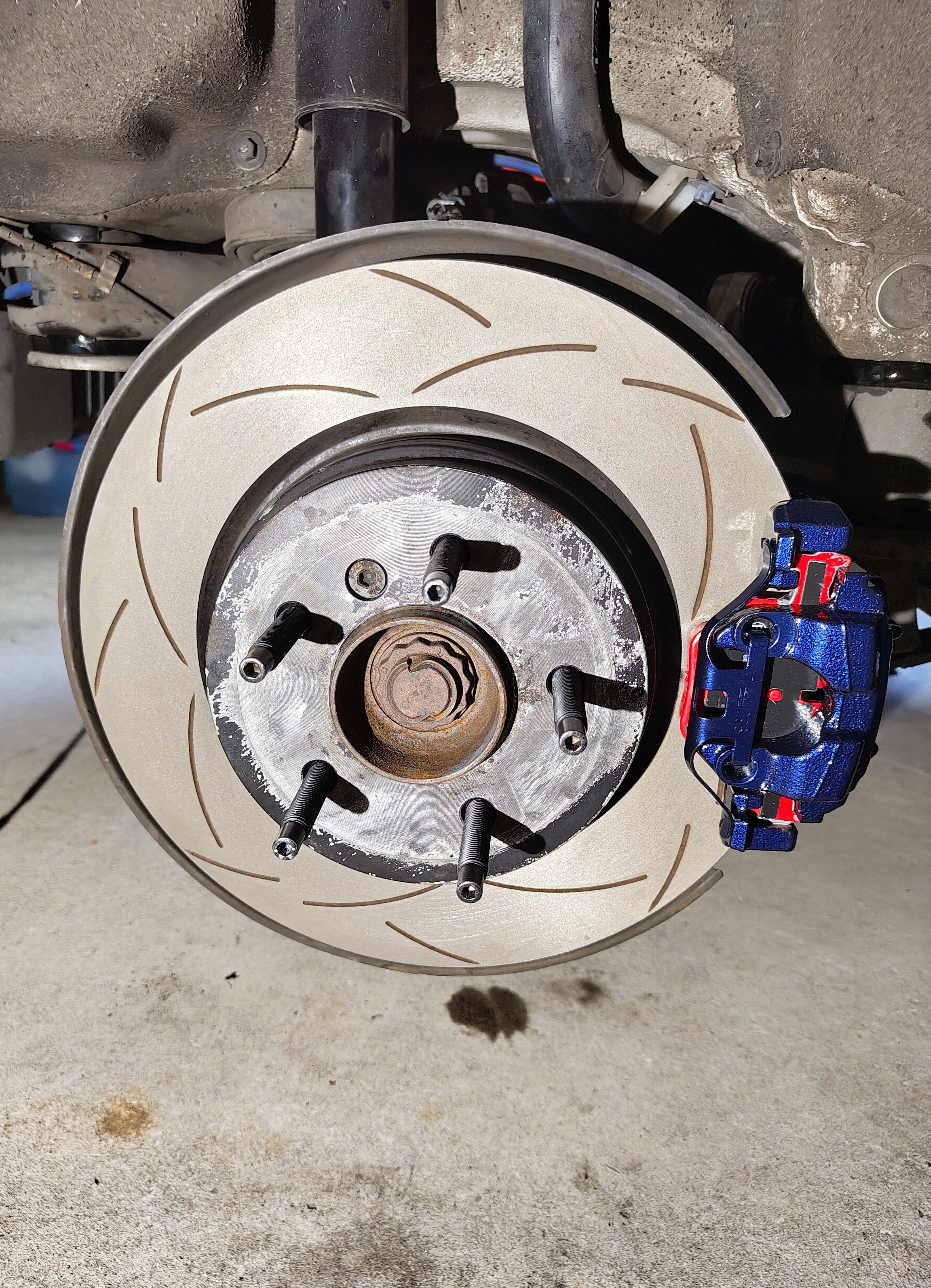

Hutty008 74 Report post Posted July 2 Since my shocks are coming off, my current brakes will be up for sale. They are e9x 335i fronts 348x30 and rears 336x24 ( Yes the rears just bolt up ) with DBA slotted rotors, EBC redstuff pads and condor speed shop brass caliper bushings. The pads where new 3000-4000 kms and the rotors were resurfaced at the same time. Only selling as I'm switching to m2 brakes as I got a good deal on a set and after test fitting they luckily fit under wheels. Photos from the 5th of March when I replaced the pads and resurfaced the rotors. Quote Share this post Link to post Share on other sites
elias 462 Report post Posted July 2 1 hour ago, Hutty008 said: Since my shocks are coming off, my current brakes will be up for sale. They are e9x 335i fronts 348x30 and rears 336x24 ( Yes the rears just bolt up ) with DBA slotted rotors, EBC redstuff pads and condor speed shop brass caliper bushings. The pads where new 3000-4000 kms and the rotors were resurfaced at the same time. Only selling as I'm switching to m2 brakes as I got a good deal on a set and after test fitting they luckily fit under wheels. Photos from the 5th of March when I replaced the pads and resurfaced the rotors. What wheels are you running that will clear m2 brakes, are you going to be running the 380f/370r discs or the smaller 340 Msport ones? i run f80 brakes (same as m2) and found the 380/370 f/r Discs only really fit under my apex ec-7s Quote Share this post Link to post Share on other sites
Neil McCauley 483 Report post Posted July 2 On 6/27/2025 at 7:05 PM, Jacko said: Looks like as real ropey example, but... That looks legit on style 24 LTW's. More tyre is always good. Quote Share this post Link to post Share on other sites
Hutty008 74 Report post Posted July 2 17 minutes ago, elias said: What wheels are you running that will clear m2 brakes, are you going to be running the 380f/370r discs or the smaller 340 Msport ones? i run f80 brakes (same as m2) and found the 380/370 f/r Discs only really fit under my apex ec-7s I'm running 18 inch OZ racing ultraleggeras, you can't use m2 brakes with 340mm rotors. I will be running 370f/345r rotors as the F series M performance set up. I have the 380f/370r rotors which came with the calipers but these no way to mount the 370mm rears to the 130i rear hubs and I'm not converting to e82 hubs as my OZ wheels already have a very aggressive offset. 1 Quote Share this post Link to post Share on other sites
