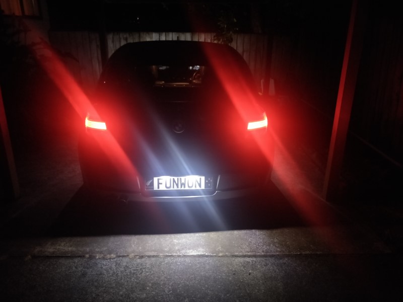

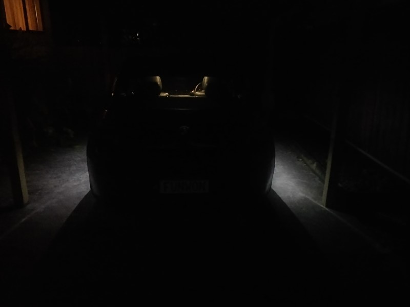

M3AN 4168 Report post Posted December 31, 2019 (edited) More observations; The rear plate and puddle lights (door handles) are LED's, I don't think they came like that (in 2008 anyway). Angel eyes have been upgraded to (very bright) white LED's also, looks heaps better than stock. Interior LED lighting set is on the way from eBay so everything matches. The stubby aerial is actually aftermarket and has a carbon fibre tube... looks naff up close, will replace with stock. A few hundred km's over the last few days and I'm still smitten, everyone should own one of these at least once. Some comments on the Avin once I've recovered from NYE... Edited December 31, 2019 by M3AN 3 Quote Share this post Link to post Share on other sites

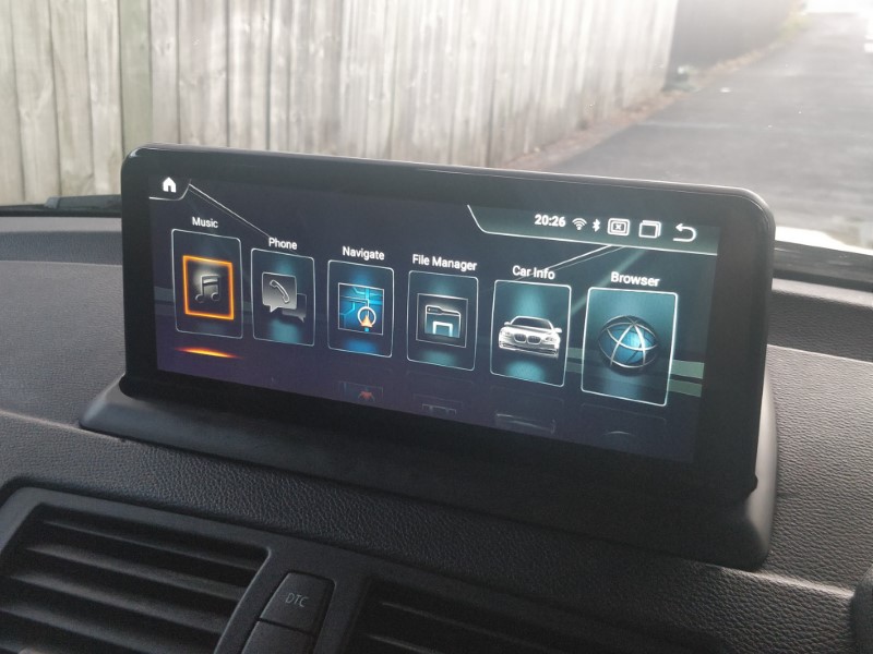

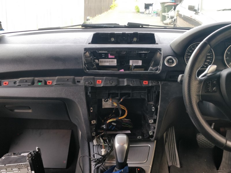

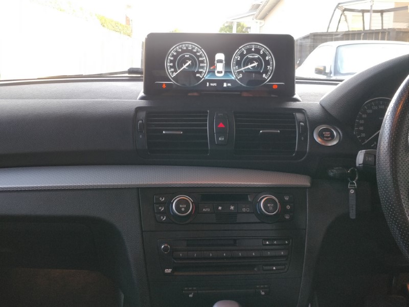

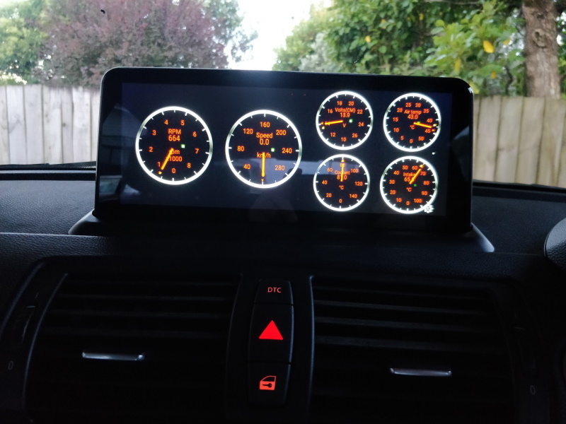

M3AN 4168 Report post Posted January 1, 2020 (edited) Avin USA 10.25" Android Display It's been an interesting experience, initially I was not really impressed, even disappointed however that impression is slowly improving. The install was simple enough after disassembling the dash. You'll need a cutting tool (e.g. Dremel) to do the dash, the knife they provided is entirely inadequate. I needed to cut out ~2 cm2 of hard plastic. It squeaks but I think I've isolated that to the actual screen/cradle interface (hard plastic on hard plastic) and have a potential fix in mind. There are no instructions and the supplied kit apparently changes/updates regularly so you might get bits and connections you don't expect, and you might also get parts you don't need to use. I got both. There are no instructions, expect to have to work it out yourself. Their support is (so far) exceptional. I've been in email communication since Christmas and have had all replies within 24h and some within minutes. Mostly the support has been helpful and accurate. I've needed to trim a plastic plug (easy enough) and they sent me a 2GB unit instead of a 4GB unit... they've offered to replace it, let's see how that goes. The screen is exceptional, really, really good. It's clear, bright and responsive, I'm impressed and I didn't think I would be. Startup is fast enough (<20s) and you can have it start instantly in 'original car mode' whilst Android loads in the background if you prefer. The OS/Launcher experience is fine, there are a few good skins and getting to Android apps is simple enough. It comes with the Play Store etc, you just need to log in. It has a default digital dashboard which is pretty but it adds no real value. I can connect to the home WiFi and download offline Google maps and with these, navigation is a dream on this widescreen. Mine came with an external speaker (not pictured/mentioned on their site) that outputs navigation instructions so the main speakers maintain their feed. Initially this didn't work for me but now it does... ? ...it creates terrible static on AM radio though (Radio Sport) when it speaks. You can choose your own navigation app. Bluetooth is less impressive... the connection seems flaky and there's an intolerable amount of lag - to the point where you believe the command hasn't gone through. This could be a firmware or memory problem so I'll reserve judgement but I certainly can't rely on it for calls atm so I don't connect it. The default apps are fine but with them alone I doubt I'd get enough value out of the screen and that's where the Android market comes in. I grabbed a terminal emulator first for reboots because for the life of me I couldn't/can't find a reboot option. I got the WiFi adaptor for the Torque app and set up a default set of gauges for that. I can see more potential in more market apps. Edited January 1, 2020 by M3AN 4 Quote Share this post Link to post Share on other sites

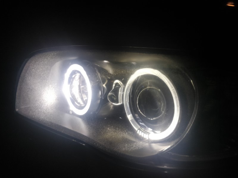

M3AN 4168 Report post Posted January 2, 2020 (edited) It appears as if the angel eyes have these in them based on bulb markings: https://www.luxangeleyes.com/products/lux-h8-189 Which is good, they're unlikely to start a fire. Cree panels to boot. They're very, very bright (edit: I can't take a pic from front on). When you unlock the car at night, with the lights on auto, it looks like a cruise ship at party stations on a dark ocean. How to address the crazing on the lenses? Is that on the inside or out? LED puddle lights alone are quite nice, lights on manual... Lights on auto ?... Crazy ? LED's... Edited January 2, 2020 by M3AN 1 1 Quote Share this post Link to post Share on other sites

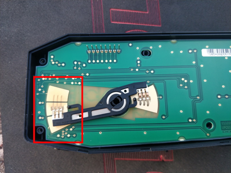

M3AN 4168 Report post Posted January 3, 2020 Sorted the electric tilt and lift on the driver's seat today, that was a bit of a mission. It didn't take me long to get the seat out but I spent about 2 hours trying to disassemble it until I worked out that I could use an e9x seat DIY (couldn't find a suitable one for the e8x). Then 30 mins later I was into it. Lucky I had cricket to listen to. It turns out that some tiny and weak contacts had folded back under themselves and weren't touching the required electrical contacts. I carefully bent them back out and down so they'd provide positive pressure... couldn't test until the seat was mostly reassembled and back in, so fingers crossed. It worked! I promptly set the seat and the memory so I don't need to dick around with that switch too often, I'm pretty sure they'll fold back under again if it's used much. If it does die again at least I know what module to replace. Quote Share this post Link to post Share on other sites

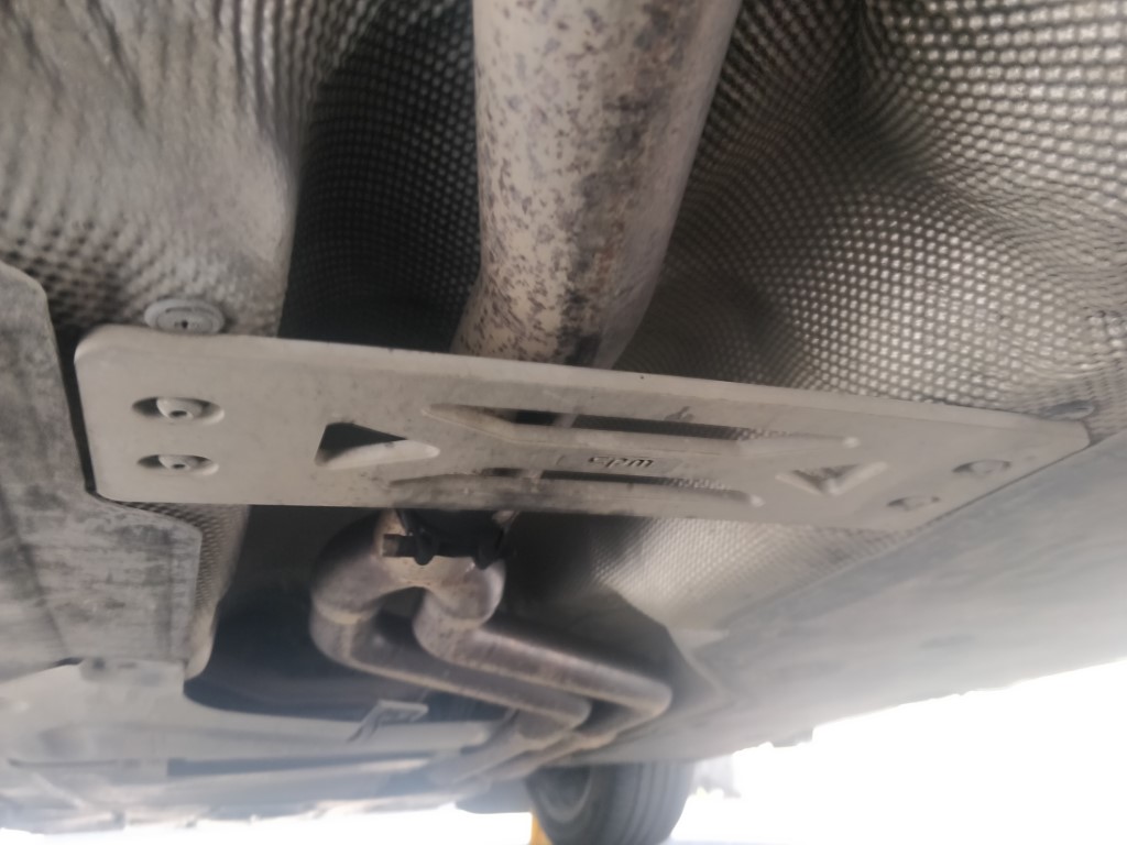

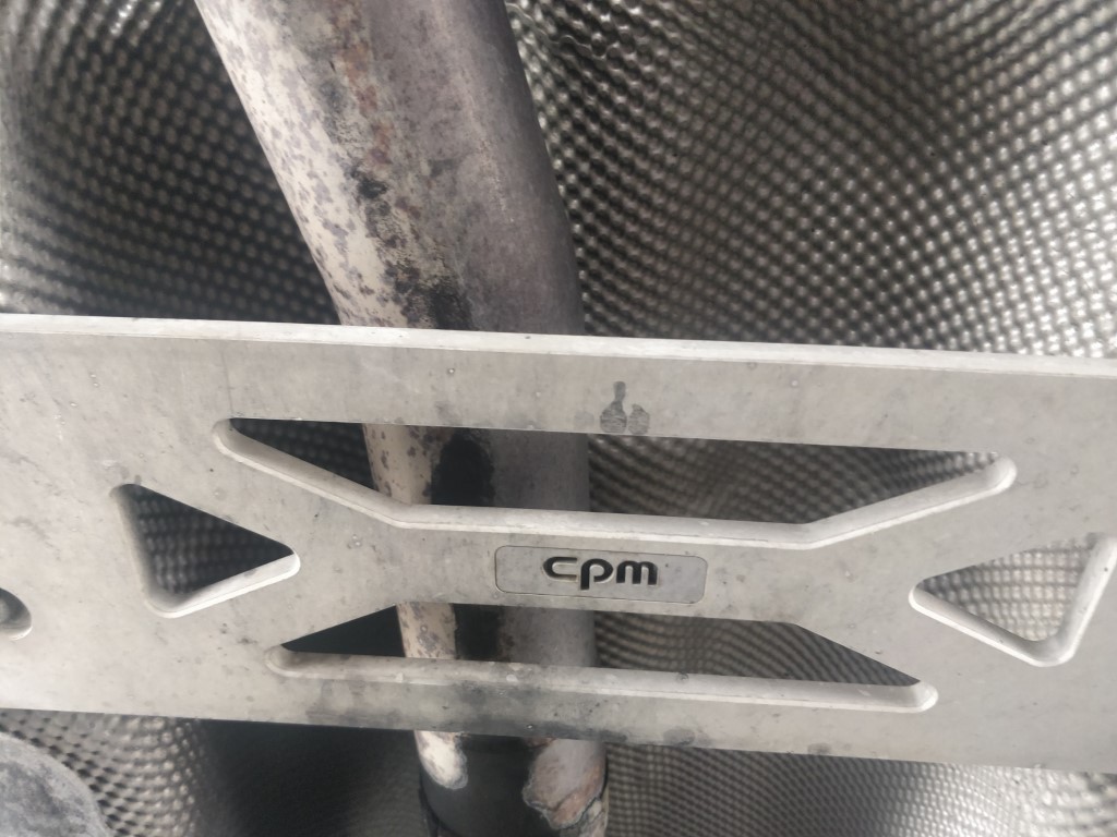

M3AN 4168 Report post Posted January 11, 2020 Chassis reinforcements... Quote Share this post Link to post Share on other sites
Jacko 2304 Report post Posted January 11, 2020 (edited) 53 minutes ago, M3AN said: Chassis reinforcements... LSD?? Or just tight open? Going to have to do a skid to check the 11's! There is normally an aluminium plate there stock for the chassis reinforcement, just doenst look like that. http://cpmtech.jp/ Someone get some free goodies?! Edited January 11, 2020 by Jacko 2 Quote Share this post Link to post Share on other sites
M3AN 4168 Report post Posted January 11, 2020 12 minutes ago, Jacko said: LSD?? Or just tight open? Going to have to do a skid to check the 11's! There is normally an aluminium plate there stock for the chassis reinforcement, just doenst look like that. http://cpmtech.jp/ Someone get some free goodies?! At this stage I'm suspecting an LSD because the diff housing is an E87 120d housing (based on part numbers) and there's no tag anywhere so it looks rebuilt. And an LSD seems consistent with the other mods. I don't know how to do 1/11's in an auto! ? Will have to YouTube it. ? Wow that CPM bit is an expensive bit of aluminium! Hey, is this picture of yours of the stock exhaust? I'm trying to work out which sections on mine are aftermarket... Quote Share this post Link to post Share on other sites
