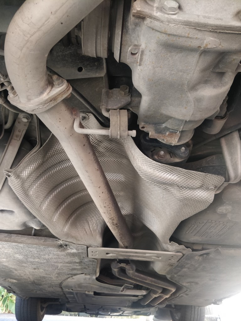

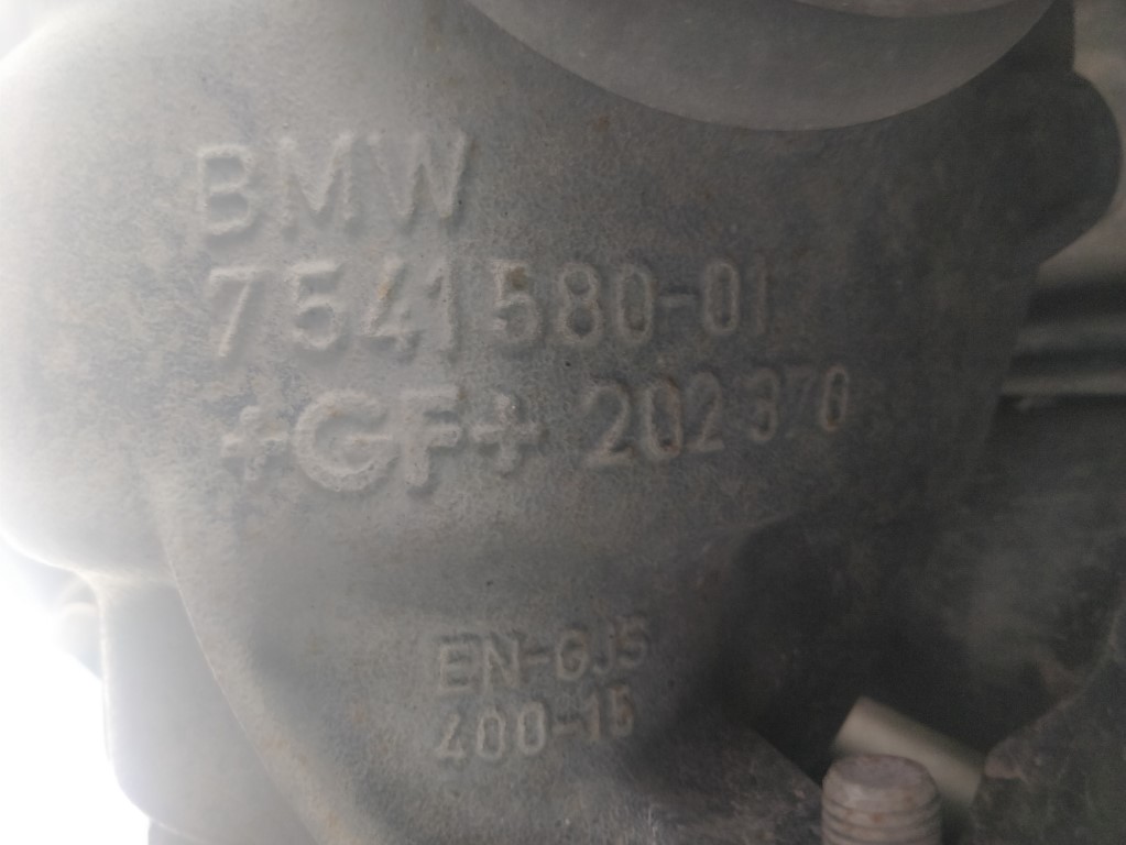

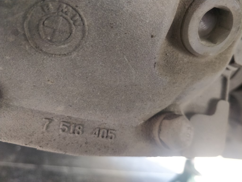

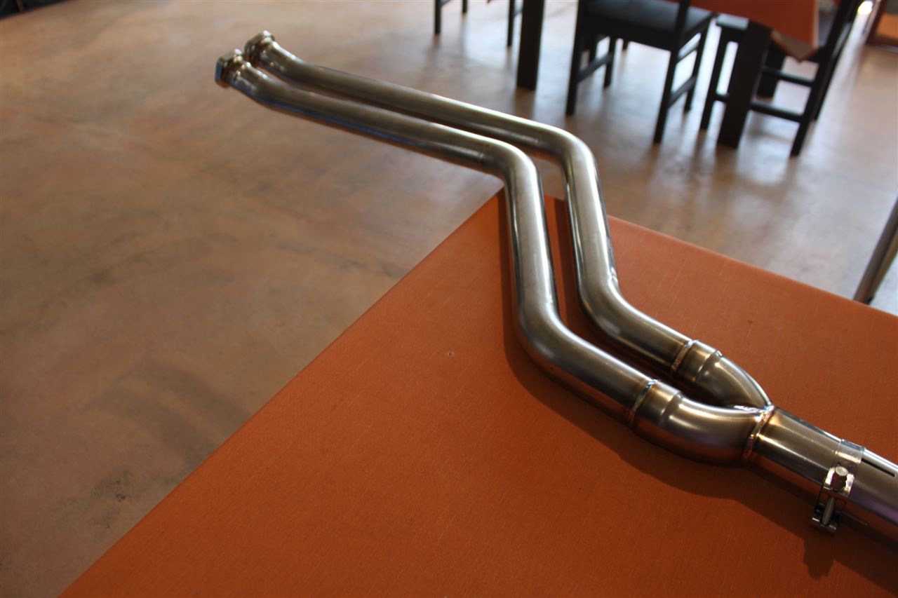

Jacko 2402 Report post Posted January 11, 2020 (edited) 57 minutes ago, M3AN said: At this stage I'm suspecting an LSD because the diff housing is an E87 120d housing (based on part numbers) and there's no tag anywhere so it looks rebuilt. And an LSD seems consistent with the other mods. I don't know how to do 1/11's in an auto! ? Will have to YouTube it. ? Wow that CPM bit is an expensive bit of aluminium! Hey, is this picture of yours of the stock exhaust? I'm trying to work out which sections on mine are aftermarket... Yup, its stock/stick. Yours looks stock up to the back box where the clamp sits? Normal mod is to hack out the resonator/Y pipe as it makes pops and crackles once gone. Whats the ratio of a 120d diff I wonder? Edited January 11, 2020 by Jacko 1 Quote Share this post Link to post Share on other sites

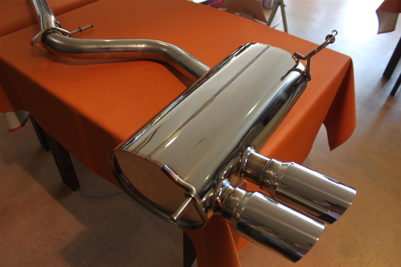

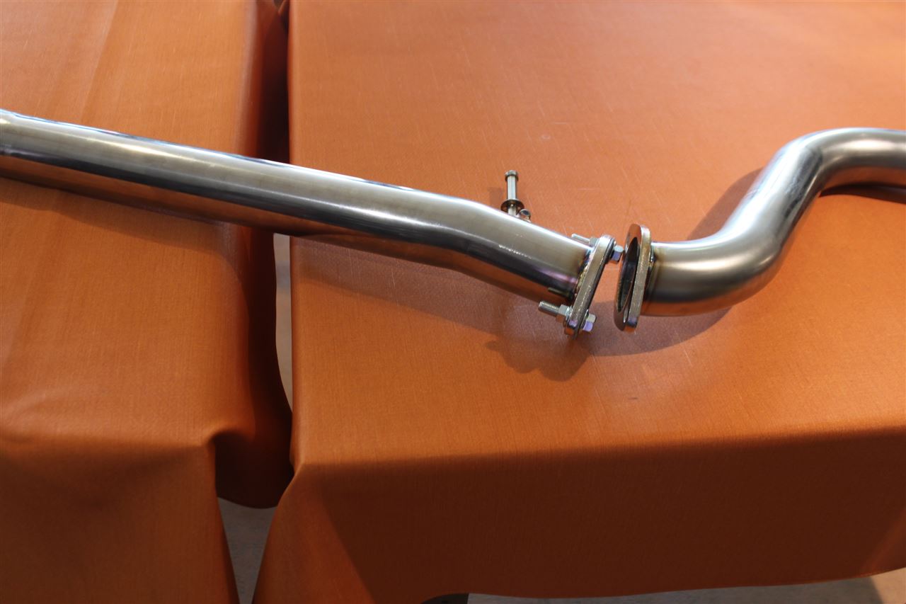

M3AN 4199 Report post Posted January 11, 2020 12 minutes ago, Jacko said: Yup, its stock/stick. Yours looks stock up to the back box where the clamp sits? Normal mod is to hack out the resonator/Y pipe as it makes pops and crackles once gone. Whats the ratio of a 120d diff I wonder? Cheers, it looks like mine is all three sections... better pics below. No resonator. As for the diff, I'm not sure about the 120 but I suspect it's only the casing (same size) because the 120 never came with a LSD either. I should be able to work it out? Revolutions of wheel to driveshaft? Maybe somebody smarter than I on these things can inform me - might be a project for another day to work it out. 1 Quote Share this post Link to post Share on other sites
Eagle 1788 Report post Posted January 11, 2020 Open diff can spin both wheels. The test ive used is have someone hold one wheel while you spin the other wheel, if its an lsd then the held wheel should want to overcome held resistance and want to turn in the same direction as the spinning wheel, it shouldn't be able to be moved in the opposite direction of the spinning wheel. Quote Share this post Link to post Share on other sites
Palazzo 533 Report post Posted January 11, 2020 (edited) 37 minutes ago, Eagle said: Open diff can spin both wheels. The test ive used is have someone hold one wheel while you spin the other wheel, if its an lsd then the held wheel should want to overcome held resistance and want to turn in the same direction as the spinning wheel, it shouldn't be able to be moved in the opposite direction of the spinning wheel. I did a 53m straight line (ish) twin wheel skid in the Falcon with an open diff. Gave up when I wasn’t sure I’d catch it Then bought new rears the following month. That was auto too @M3AN Edited January 11, 2020 by Palazzo Update 1 Quote Share this post Link to post Share on other sites
M3AN 4199 Report post Posted January 11, 2020 (edited) I'm not convinced either way but given the actual housing is not from a 130 we can assume something has been done... and the wheel spin doesn't rule out a LSD, that's all we know. If they'd spun the other way, as you'd expect them to, we'd have a conclusive answer. I didn't pay for nor expect an LSD so if it's there it's a win. FUN"WON" may end up being prophetic after all. I'm still (mildly) convinced it's had an ECU or trans flash... I'm not sure BMW would push it out the door as it drives, it's pretty aggressive. The perfect daily lol... ??? If anyone can provide more info on these numbers I'd be grateful, best I can do is an uncommon housing from a 120d? Edited January 11, 2020 by M3AN New pic Quote Share this post Link to post Share on other sites
M3AN 4199 Report post Posted January 11, 2020 47 minutes ago, Palazzo said: I did a 53m straight line (ish) twin wheel skid in the Falcon with an open diff. Gave up when I wasn’t sure I’d catch it Yeah, that's where that test fails. If traction is close enough to equal left and right then the circumstances may allow an 11 even with an open diff. Quote Share this post Link to post Share on other sites
KwS 2451 Report post Posted January 11, 2020 Easiest way i can see to tell if its an LSD is to pop the fill plug out and have a look in and see what the diff center looks like. IIRC most if not all aftermarket LSDs are enclosed, whilst the stock open diff should be open with the spider gears visible. 1 Quote Share this post Link to post Share on other sites
Jacko 2402 Report post Posted January 11, 2020 (edited) Its pretty easy to tell if you have an open diff to compare it to, if you hammer it around a corner in a stock car the DSC light on dash will come on very early, and often, where as with an LSD its WAY more playful as it doesnt have the delta in rear wheel speeds, so doesnt think its as crossed up as it is 120 diff, 33107566169 , is 3.07:1 130 auto diff is 3.46:1 (manual is 3.64) 3.73 is what all the cool kids hunt for. Pull it apart and have a looksee You'll need to figure what sort of fluid goes in it at some point. Edited January 11, 2020 by Jacko 1 1 Quote Share this post Link to post Share on other sites
M3AN 4199 Report post Posted January 11, 2020 (edited) 31 minutes ago, Jacko said: Its pretty easy to tell if you have an open diff to compare it to, if you hammer it around a corner in a stock car the DSC light on dash will come on very early, and often, where as with an LSD its WAY more playful as it doesnt have the delta in rear wheel speeds, so doesnt think its as crossed up as it is DSC light has never come on in my ownership... I'm not particularly merciful... good sign. 31 minutes ago, Jacko said: 120 diff, 33107566169 , is 3.07:1 / 130 auto diff is 3.46:1 (manual is 3.64) / 3.73 is what all the cool kids hunt for. Pull it apart and have a looksee You'll need to figure what sort of fluid goes in it at some point. Well it's certainly not a 3.07! If anything it's shorter than the other 130's I've driven but I wouldn't bet on it being different from stock. And no, I'm not going to take it apart lol. I still have a cw&p to put in the M3. Priorities. Edited January 11, 2020 by M3AN Quote Share this post Link to post Share on other sites

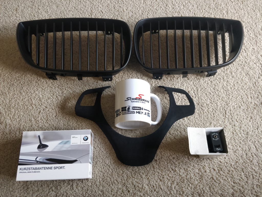

M3AN 4199 Report post Posted January 13, 2020 (edited) Schmiedmann Christmas order arrived (no GST). I added the free mug because it reduced the shipping cost by US$20. ? Matt black grills (replacing the tatty CF ones) BMW Performance Alcantara steering wheel cover (to match the shifter and boot) OEM stubby aerial to replace the naff carbon fibre one 3.5mm + USB aux 'switch' - requires quite a lot of wiring and coding I think, might never go in. I also received another package from the US that I'm a little bit excited about but I need to work out if it's a win or fail before I release the details (which I will do regardless of whether it's a win or fail). I want to install it all now but I'm on BBQ duty! ? Edited January 13, 2020 by M3AN 3 Quote Share this post Link to post Share on other sites

Jordy 0 Report post Posted January 15, 2020 That Orange Wolf exhaust is a beaut. Mind if I ask how much that cost with import / customs etc? @M3AN Quote Share this post Link to post Share on other sites
///M 23 Report post Posted January 15, 2020 (edited) 2 hours ago, M3AN said: I wasn't aware the rear shock mounts were an issue, what's the lowdown on them? Koni's will be fine, you'll need to dump the OEM springs and bumpstops though or you'll still pogo down the road. My preference is Bilstein + Eibach because the two companies work so closely together and their B12 kit's aren't just mix and match, they're made for the specific vehicle they're intended for. Not sure on price but if I ever need to replace my suspension it's likely to be with the B12 kit (I don't need coilovers). They’re not necessarily an issue per se, more of an incremental improvement one can make. The oem rear shock mounts are tall, soft (to reduce NVH) and deteriorate over time. Dinan rear shock mounts are made from a stiffer material which still has acceptable NVH properties but also allows the shock to operate efficiently. The biggest benefit is their reduced height. You can essentially run your stock progressive bump stops and have an additional 10mm of shock travel before the bumstops are engaged. This results in increased comfort, reduced pogoing effect and still maintains the sporty feel of the e87 (assuming the shocks are in good order). Whilst I like the B12 kit- especially at the price point, I’m not a huge fan of lowering the car any further; I reckon it’s low enough as is to be honest. If the Konis + rsm don't sort out the suspension I'll have to consider other options i.e. coilovers; but I'm reasonably confident (having had Konis on previous vehicles with good results). Edited January 15, 2020 by ///M 1 Quote Share this post Link to post Share on other sites
///M 23 Report post Posted January 15, 2020 15 minutes ago, Jordy said: That Orange Wolf exhaust is a beaut. Mind if I ask how much that cost with import / customs etc? @M3AN I think he said it came with the car 1 Quote Share this post Link to post Share on other sites
Jordy 0 Report post Posted January 15, 2020 2 minutes ago, ///M said: I think he said it came with the car Ah cheers, Makes me want to modify my exhaust ? Quote Share this post Link to post Share on other sites
M3AN 4199 Report post Posted January 15, 2020 (edited) Yes @Jordy - it seems I got some nice surprises with the car: exhaust (which you can see is beautiful) has the Y pipe mod and resonator delete so it's not just something thrown together, that's how it should be done coilovers - completely missed by the dealer selling the car but also has a LVV cert and Eibach ERS springs and all the hardware on the shocks looks top notch LSD - needs more investigation but I'm a believer If the dealer knew all that I wouldn't have walked away with it for what I did. ? Edited July 25, 2020 by M3AN Quote Share this post Link to post Share on other sites
