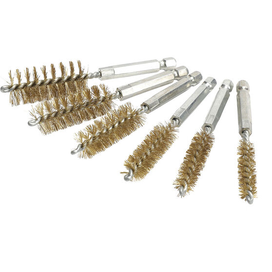

325_driver 422 Report post Posted December 31, 2019 yeah, going to soak in kero, then light scraping. got me a set of these also going to rangi me up a scotch brite-round-wire device and put it on the drill Quote Share this post Link to post Share on other sites
