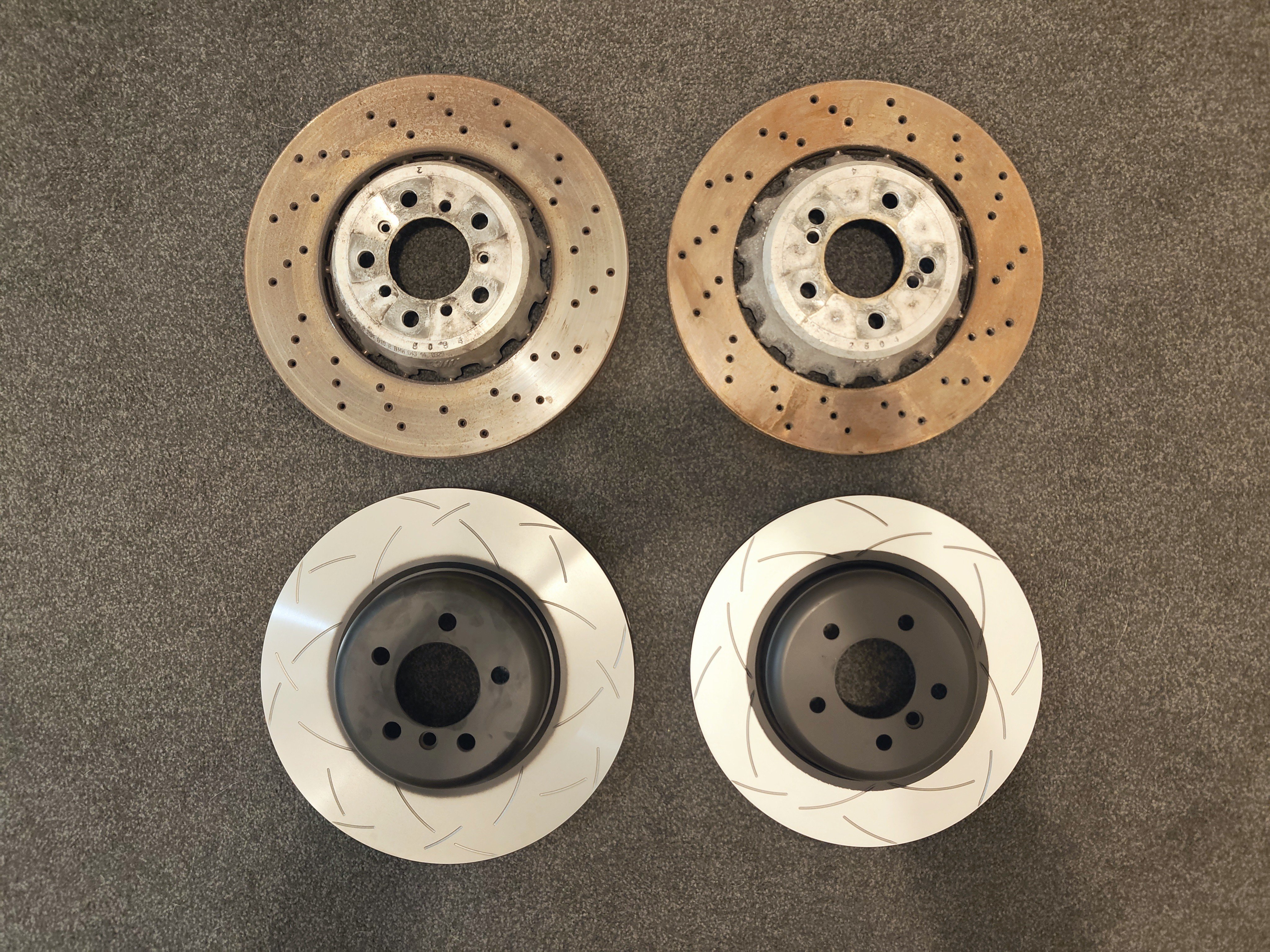

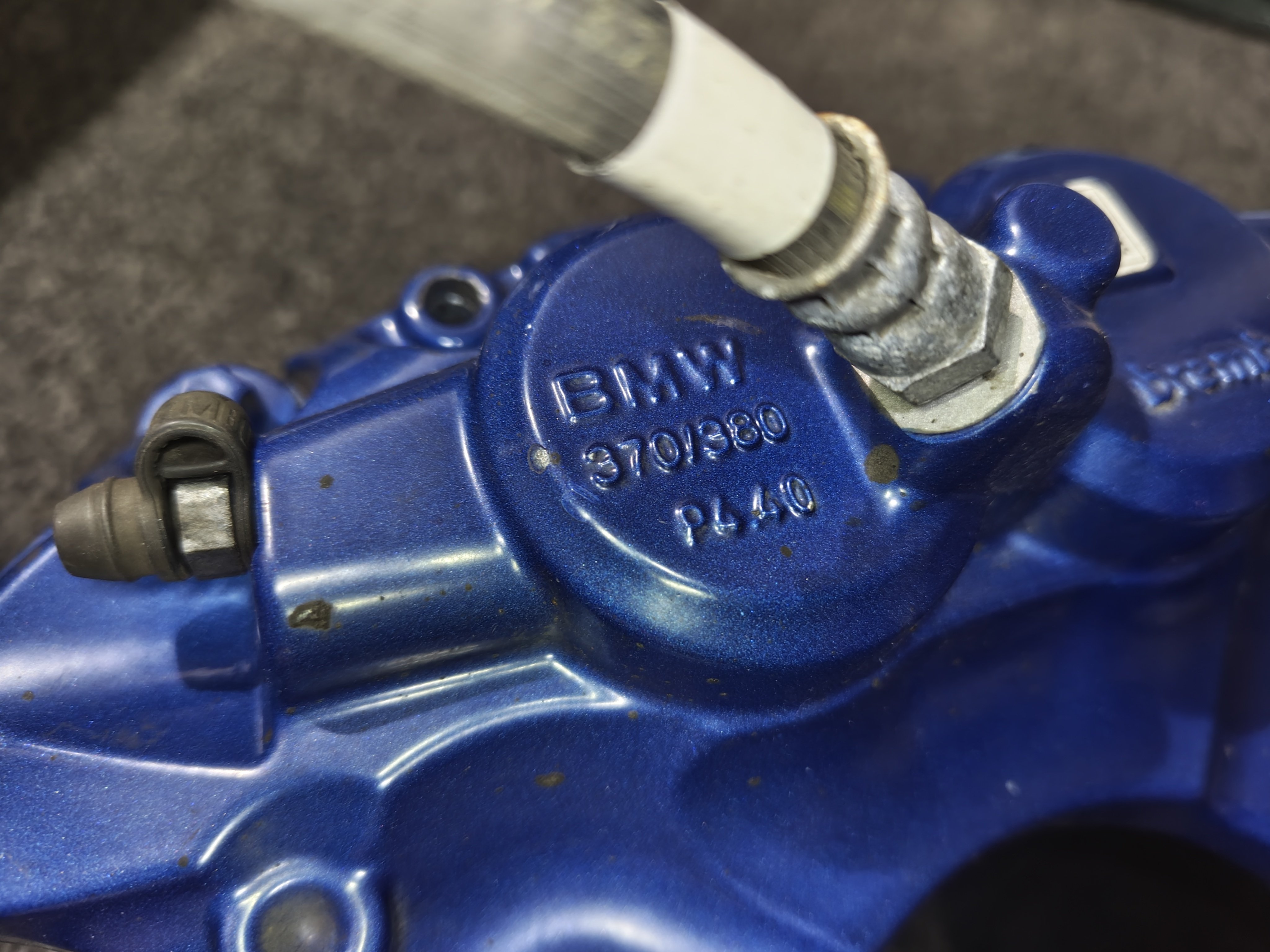

Hutty008 61 Report post Posted July 2 2 hours ago, elias said: What wheels are you running that will clear m2 brakes, are you going to be running the 380f/370r discs or the smaller 340 Msport ones? i run f80 brakes (same as m2) and found the 380/370 f/r Discs only really fit under my apex ec-7s Comparison of the f8x M2 380/370 rotors and the dba 370/345 F-series M-performance rotors. Both use the same pads and same calipers just different ways of mounting to hubs. 1 Quote Share this post Link to post Share on other sites

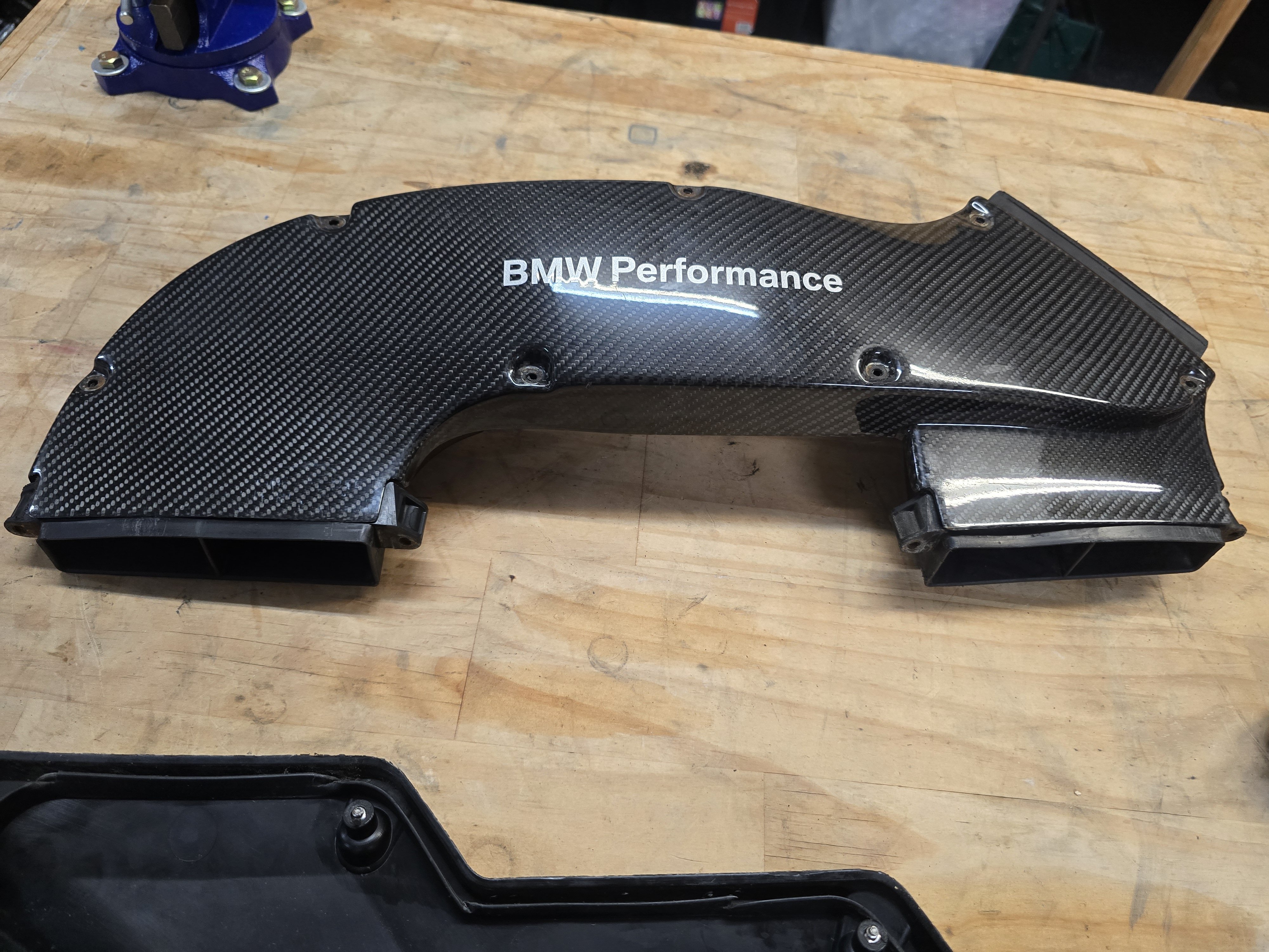

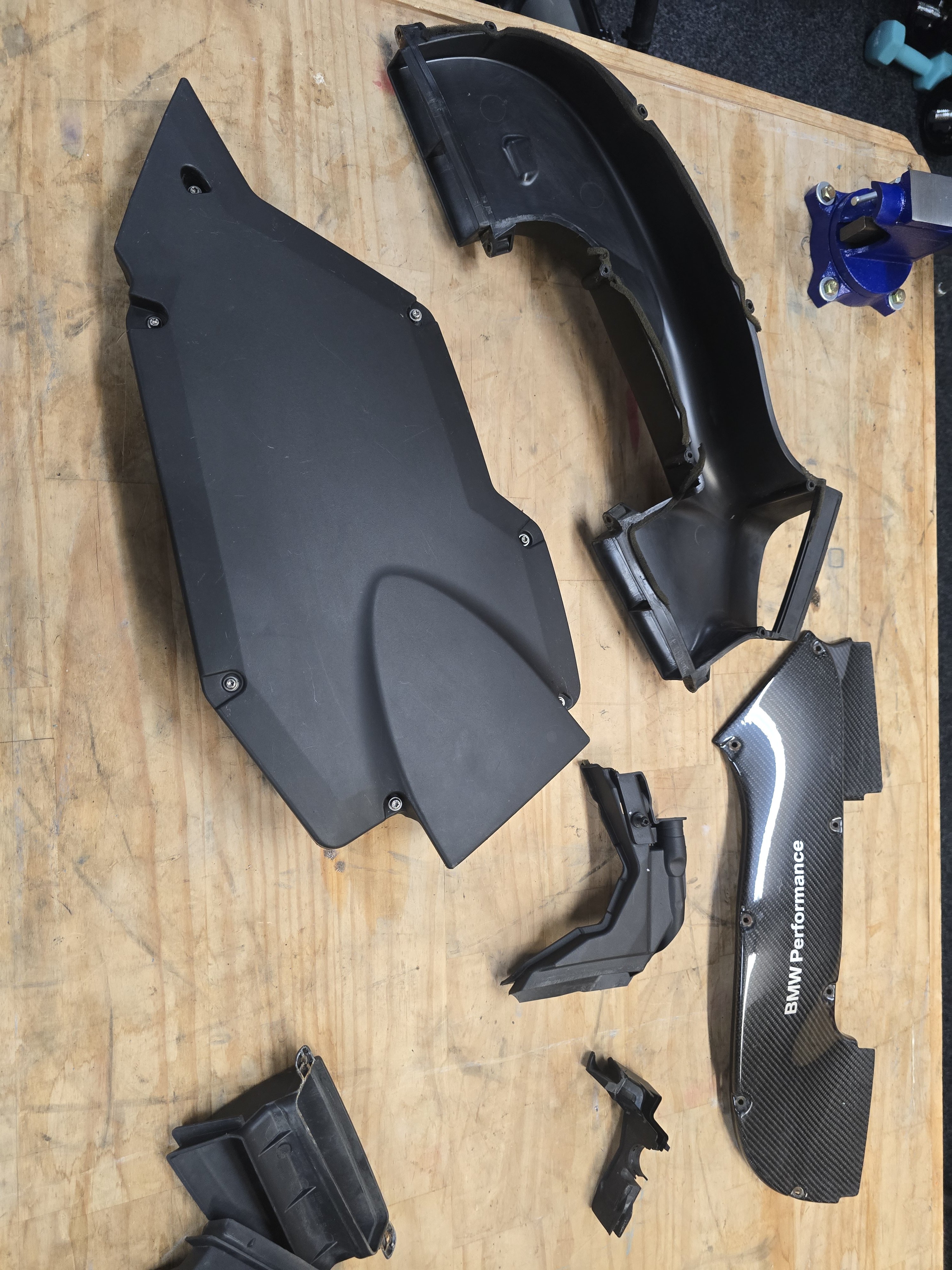

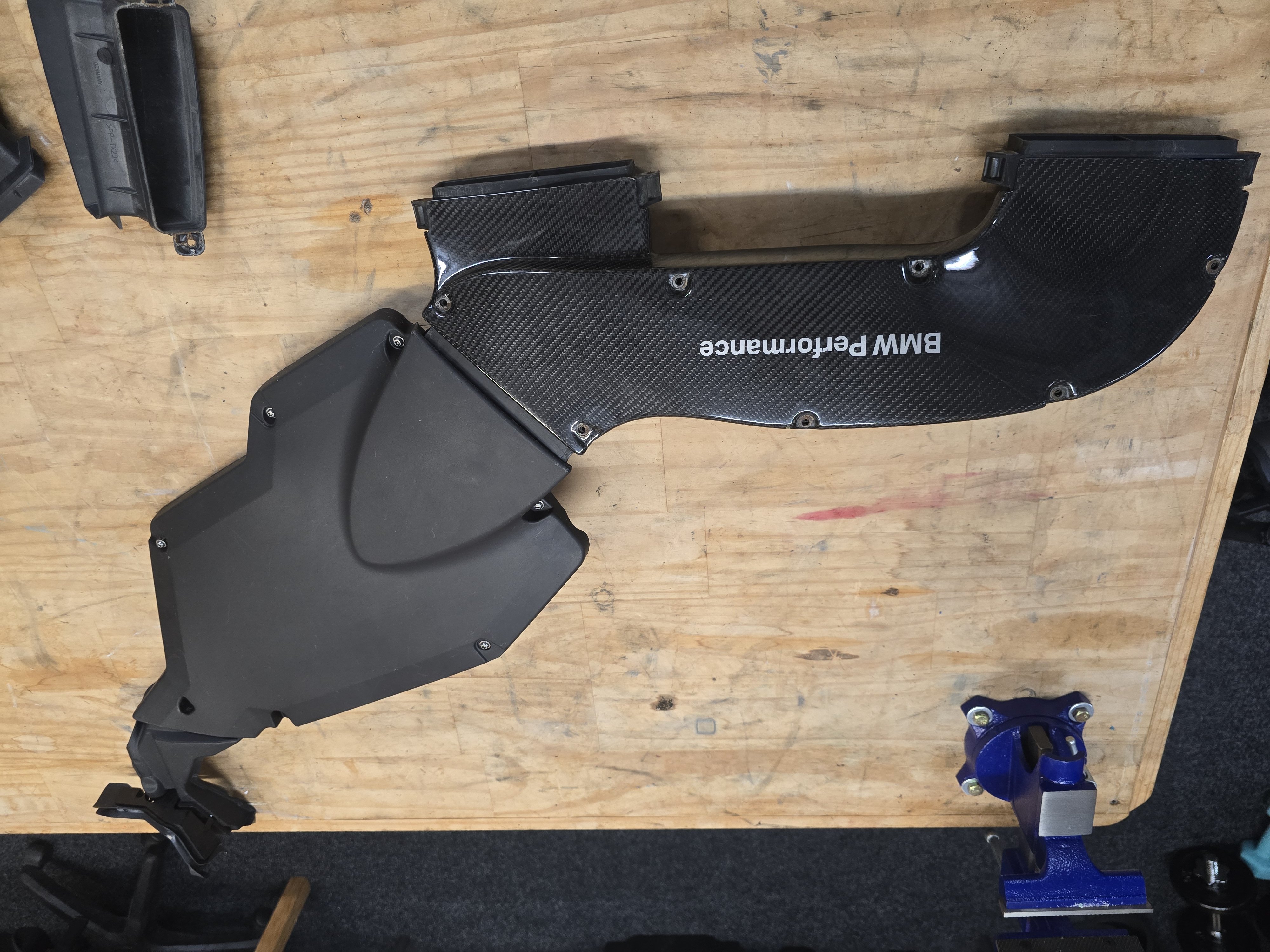

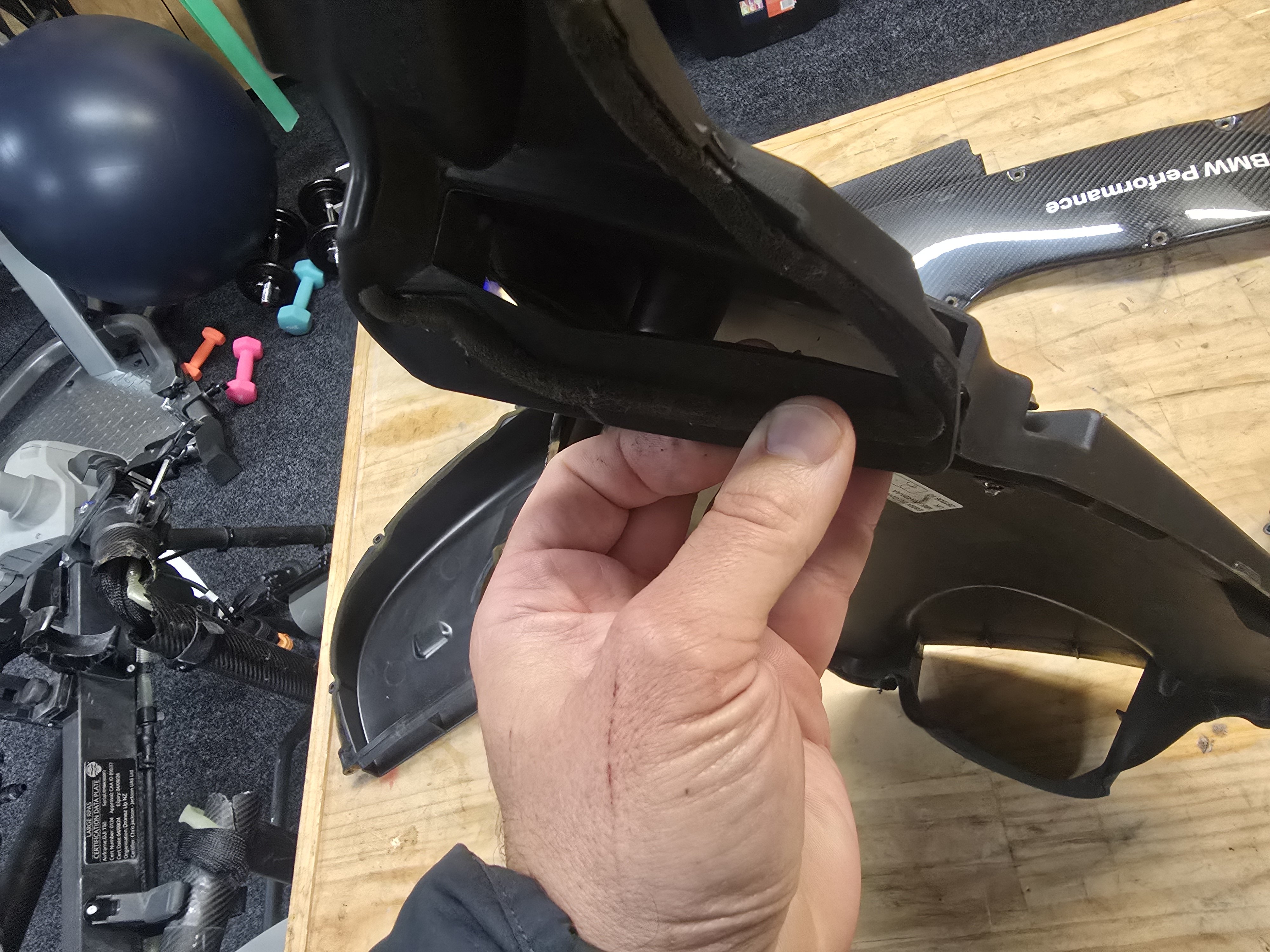

Jacko 2344 Report post Posted July 7 BMW Performance intake, no way this things makes more power than stock and a K&N filter It does however look and sounds cool. Primary difference is slightly large intake snorkel, the carbon bit, and airbox lid has a secondary intake facing backwards above the guard... which is probably where the cool noises come from. If it makes 5hp increase, taking the lid off makes 40hp 2 Quote Share this post Link to post Share on other sites
M3AN 4185 Report post Posted July 7 Indeed, the general consensus is how you've concluded, it's largely form over function. But, hey, it's great form! There's no question you should claim this for a car you're going to keep. Quote Share this post Link to post Share on other sites
