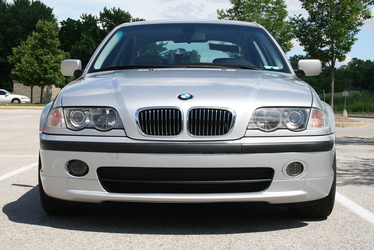

qube 3570 Report post Posted May 23, 2021 16 hours ago, Southerner said: Sorry, new to E46 as a whole. Is there a pfl msport? Or are all msport as such the same? Just need to know what to keep an eye out for There are a lot of different E46 front bumpers, but for simplicity sake, there are 3 "main" msport ones. M Tech 1 which come on the PFL sedans M Tech 2 for FL sedans (almost same as the below one but has the black moulding) and M Tech 2 for coupes (both PFL and FL) no black moulding but has a indent line across it 2 Quote Share this post Link to post Share on other sites
Southerner 155 Report post Posted May 23, 2021 (edited) Perfect, thanks for the clarifications. Had tried google but was proving difficult to easily distinguish, Will see what i can dig up locally and then look further north, freight be the thing as a large consignment and fragile! Edited July 30, 2021 by E30 325i Rag-Top Quote Share this post Link to post Share on other sites
qube 3570 Report post Posted May 23, 2021 all good. since your touring has the side mouldings in black, it would make sense to try find a Mtech2 for sedan/touring (2nd pic) to match the rest of the car. the other 2 bumpers would probably look a bit weird and obvious that its added on rather than looking "factory" 2 Quote Share this post Link to post Share on other sites
