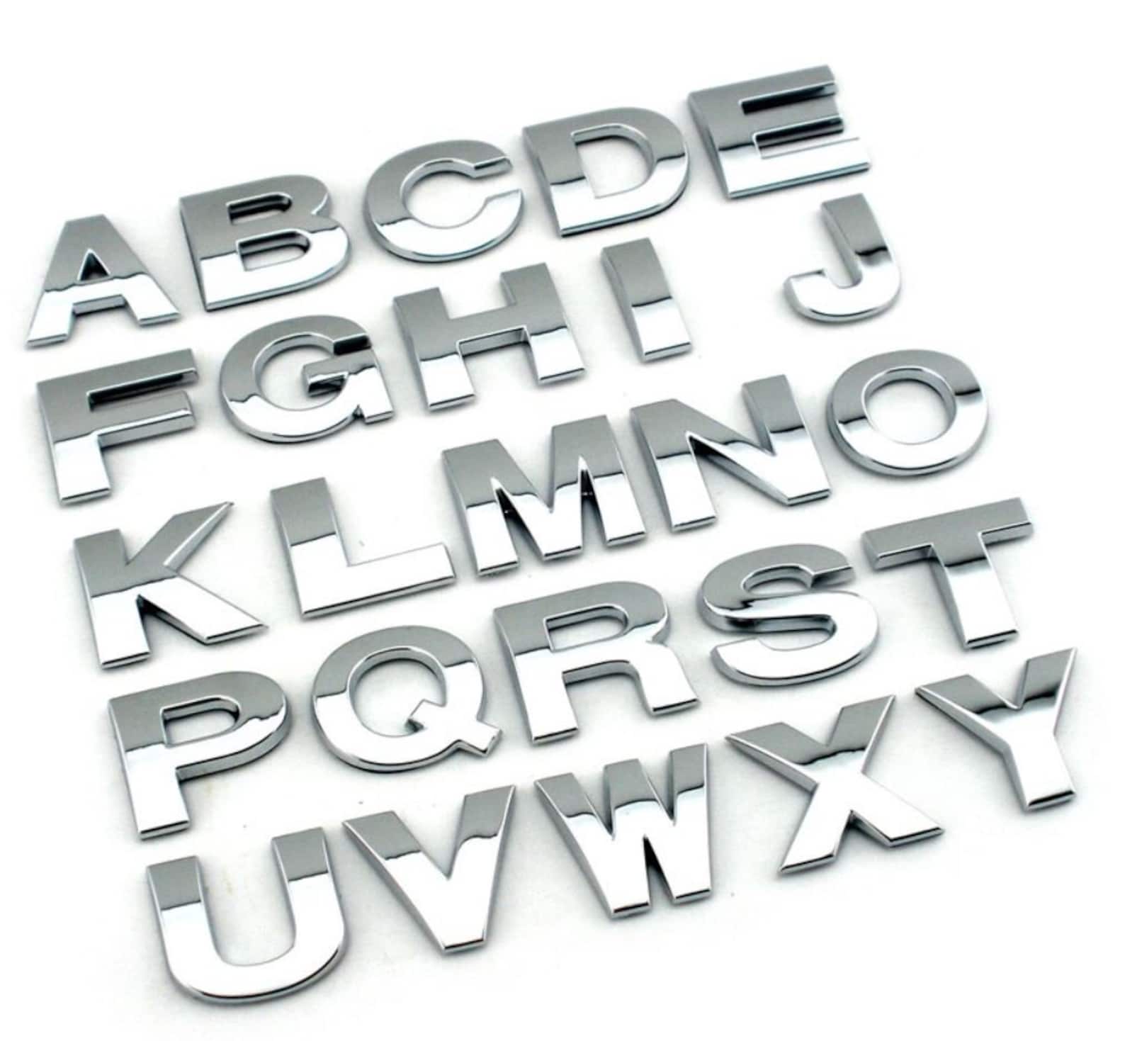

M3AN 4166 Report post Posted September 14, 2022 I would have gone for standard or Euro on the rear, the small one is a bit lost in the space but otherwise the black plates are a great look, and well done on "THE135". I agree with removing the silver 135i, or perhaps replacing it with matt black. 1 Quote Share this post Link to post Share on other sites
qube 3571 Report post Posted September 14, 2022 or add "THE" before the 135i 1 Quote Share this post Link to post Share on other sites
elias 435 Report post Posted September 14, 2022 Some good ideas, definitely something to consider, might leave it as is for now, easier to remove it than put it back on... Quote Share this post Link to post Share on other sites
