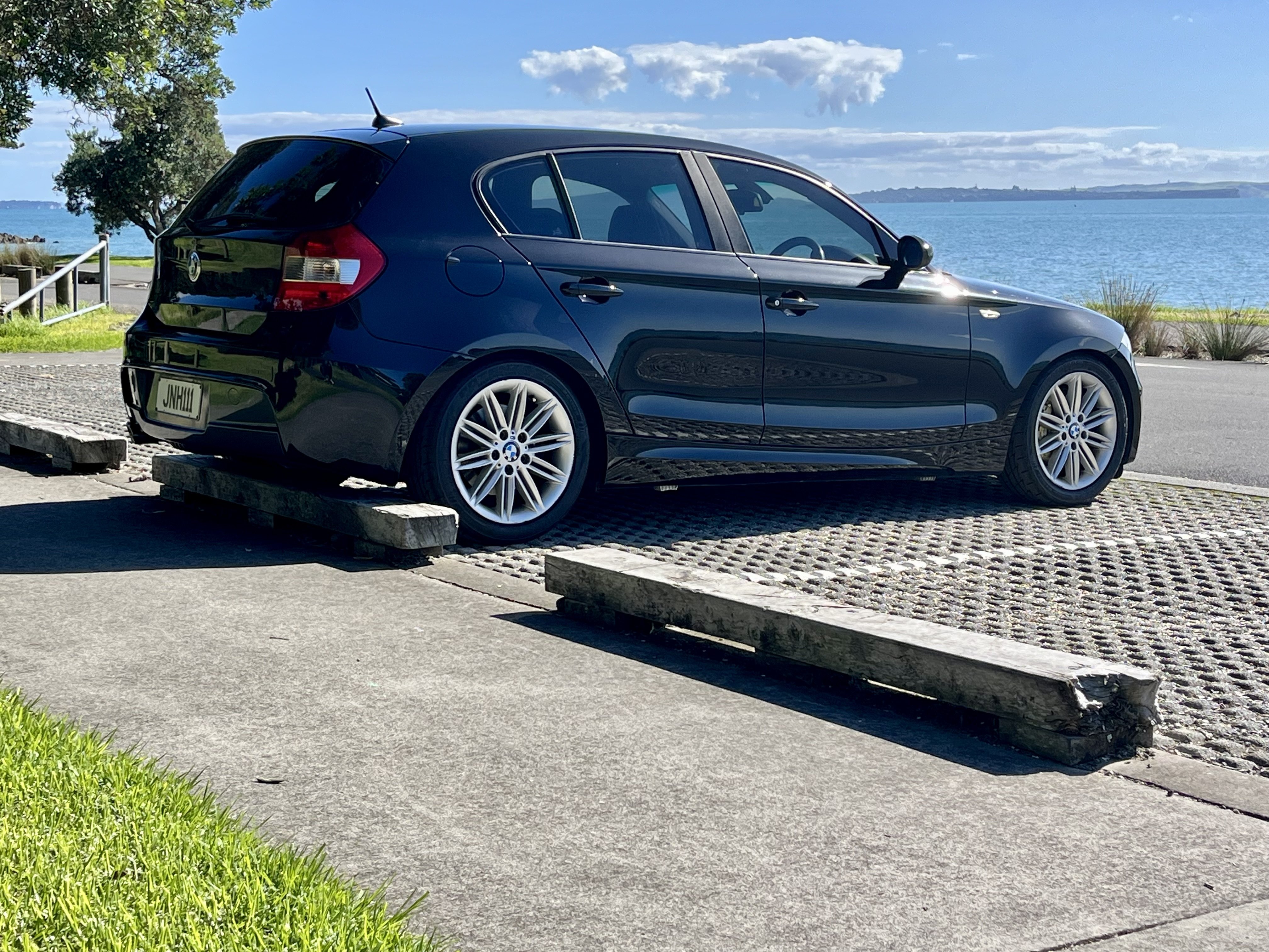

BreakMyWindow 1998 Report post Posted January 29 Bought this last Friday for a good price. Being a track addict these days I was keen to get in to something RWD. The Good… -All paint except rear bumper and hatch lid is original -New RE003’s 225/45/17 on all corners. I think the fronts should be 205/50/17 with these wheels? -BMWP 6 pot Front Callipers -Last owner had it 9 years. Presumably has had annual oil changes every 10-12k -Valve cover gasket recently done, waterpump and tstat look new. -Clutch feels bitey Not so good… -Oil pan gasket. No surprises. -Lifter tick seems persistent, even after bleeding procedure and open road driving -Usual old car wear and tear, the most annoying being the loose rearview mirror (previous installation error and loose retaining prong holding it to windshield) -Shocks feel tired -Needs new brakes all round No dme codes but I reset the adaptations and chucked some 98 in. Goes better now. Plan for now is to tidy it up, add some track focused mods and see how I go! 5 Quote Share this post Link to post Share on other sites

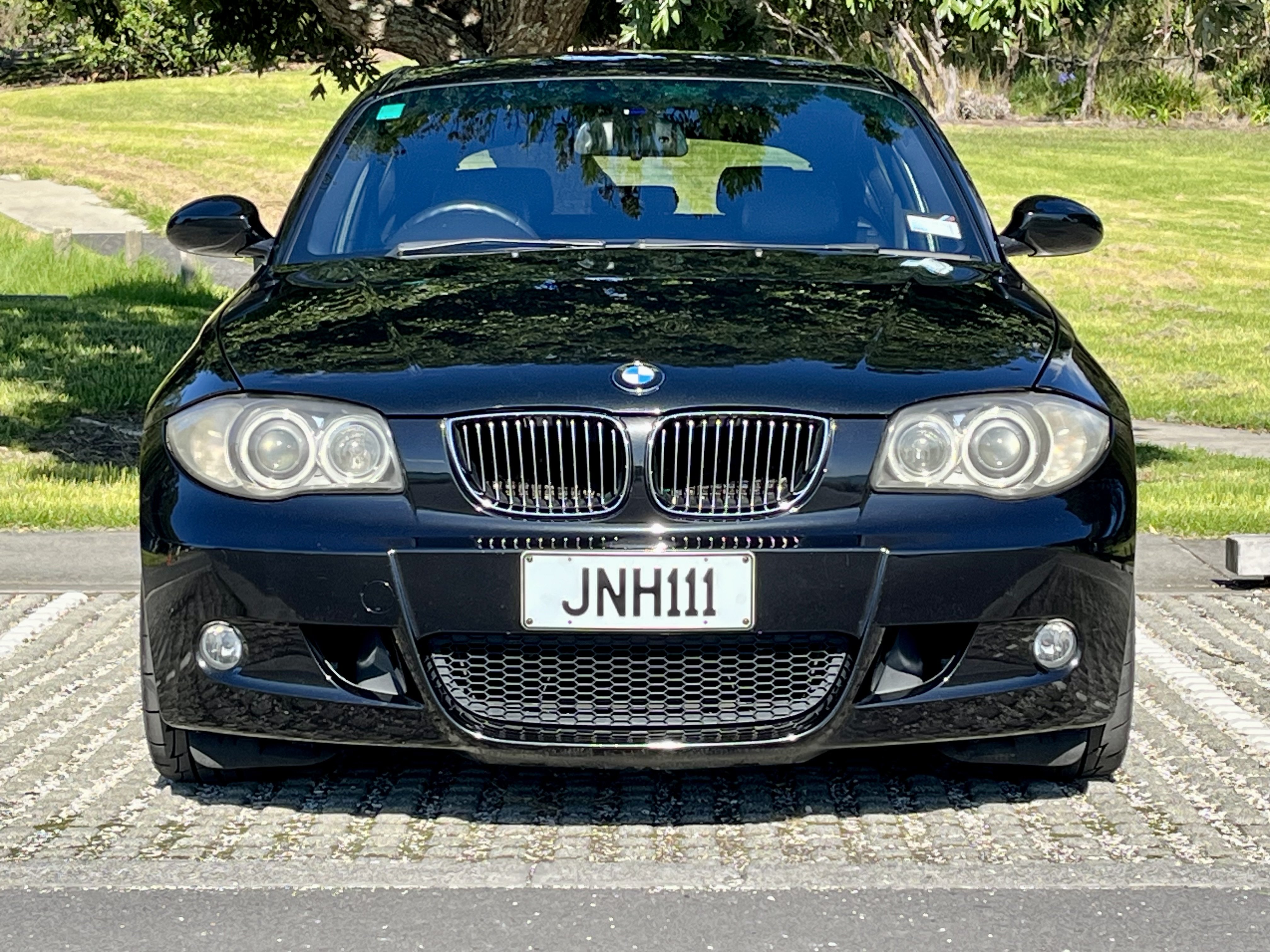

BreakMyWindow 1998 Report post Posted March 28 Had a decent go at cutting and polishing. Lots of trial and error along the way but getting the hang of it… Test area to see how hardy the paint is. On to cutting the fr guard. Then the sides and the roof, which I never thought would come up well, lots of deep scratches. Gave it a wet sand first. After cutting the sides and roof I expected this sh*t to appear under bright lighting.. Up until now i’d been using a rotary polisher so i switched to a DA and got rid of most of it. Happy how it turned out Got the hatch and bumpers to do. Won’t bother with the bonnet until i can find a straight one with saveable black sapphire metallic paint. 10 Quote Share this post Link to post Share on other sites

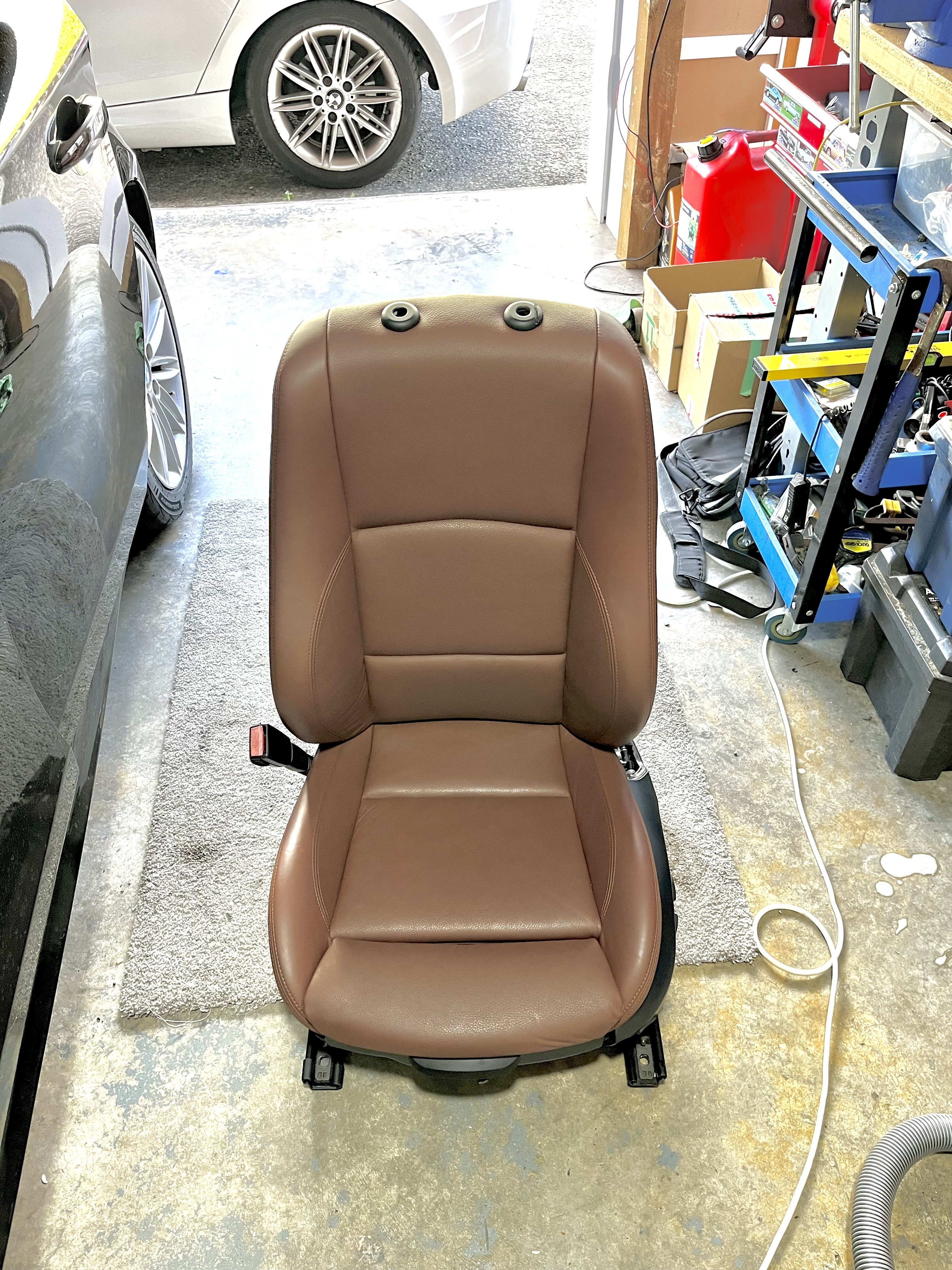

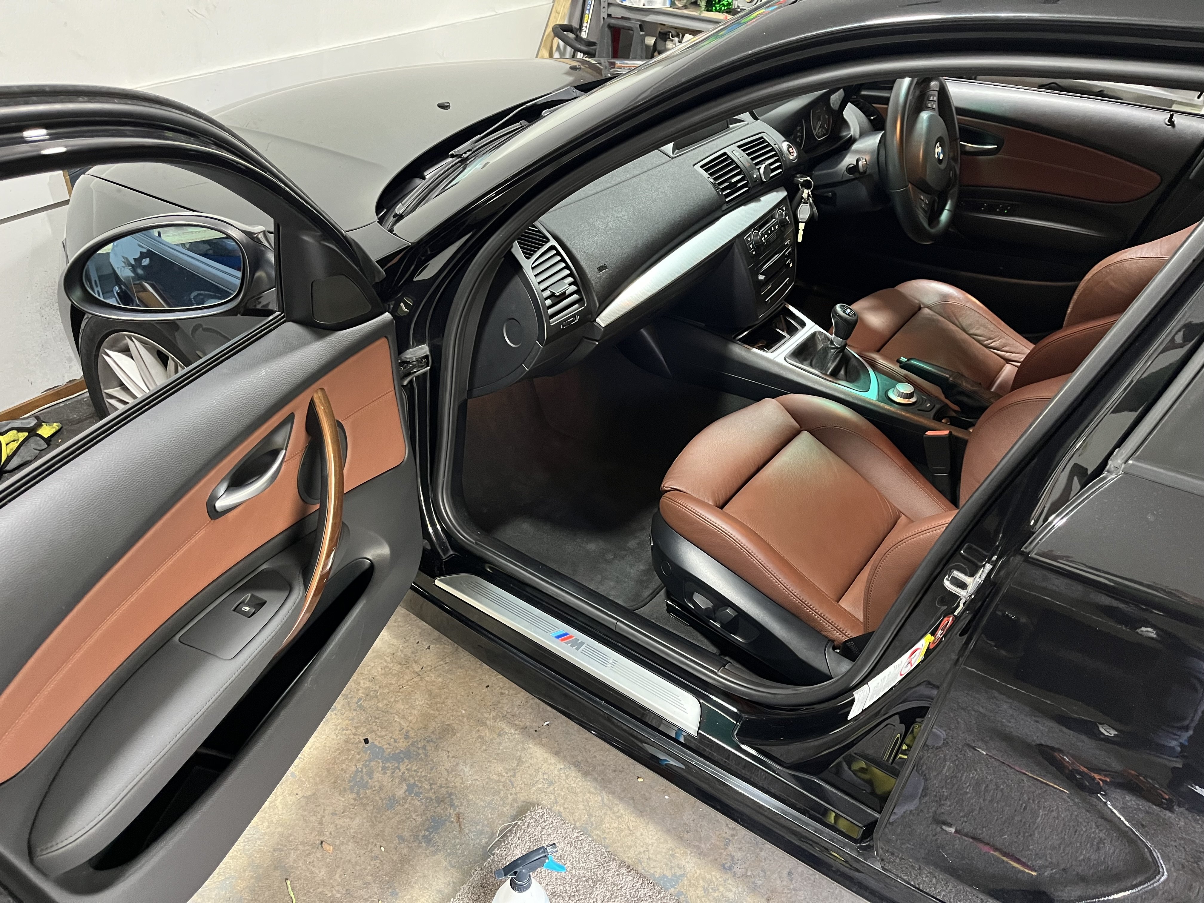

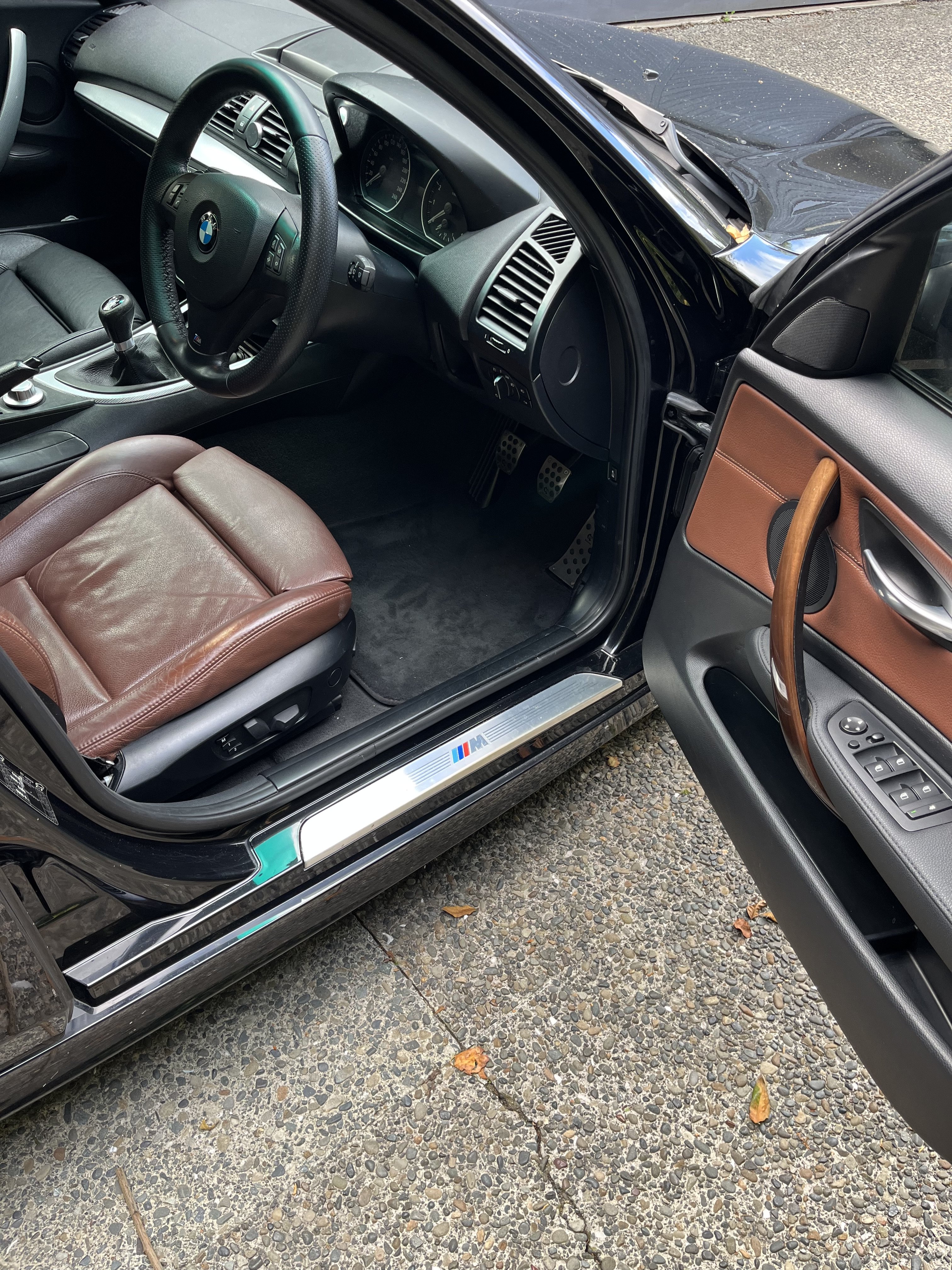

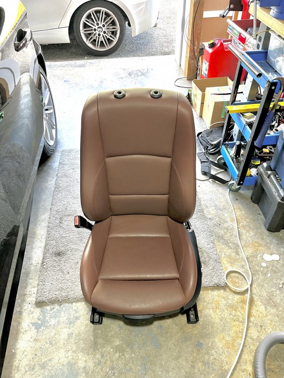

BreakMyWindow 1998 Report post Posted May 19 Been busy with the interior, full lci interior swap over a wip. Dashboard swap next… Between 06/06 and 01/08 cars exchanging fr seats are all happy bar the upper seat width adjusters. Looks easy to fix later on. 1 Quote Share this post Link to post Share on other sites
