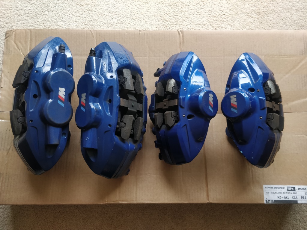

M3AN 4198 Report post Posted October 19, 2020 I hate how BMW put the the LHS decals on upside down... ? They should look "correct" on the calliper, regardless of how it's installed on the vehicle... like every other calliper on Earth. ? 1 1 Quote Share this post Link to post Share on other sites
Matt 125 Report post Posted October 19, 2020 Will you paint them or leave them blue? Quote Share this post Link to post Share on other sites
M3AN 4198 Report post Posted October 19, 2020 12 hours ago, Matt said: Will you paint them or leave them blue? I'm going to leave them as is, I quite like the blue. A guy in the UK did his in satin black with Brembo decals and they did look very good but I don't want to faff around. 2 Quote Share this post Link to post Share on other sites
qube 3570 Report post Posted October 19, 2020 leave it blue, looks good 1 Quote Share this post Link to post Share on other sites
E30 325i Rag-Top 3043 Report post Posted October 19, 2020 On 10/7/2020 at 5:31 PM, M3AN said: And that's about it! My principle reason for doing this is that I've always wanted a BBK, they look cool, I don't particularly care if they don't perform any better than stock on the street. Not the normal reason for doing a brake conversion, what are you looking at doing on the master cylinder and booster side? 1 Quote Share this post Link to post Share on other sites
M3AN 4198 Report post Posted October 19, 2020 (edited) 4 minutes ago, E30 325i Rag-Top said: Not the normal reason for doing a brake conversion, what are you looking at doing on the master cylinder and booster side? No, most people misguidedly do it because they think it's going to improve their day-to-day braking which it won't. edit: unless their day-to-day is on a track of course! No other changes, this is a combination proven many times over for the E8x in the US and UK which is a large part of the reason I went down this path, I wasn't willing to try an unproven setup. Edited October 19, 2020 by M3AN Quote Share this post Link to post Share on other sites

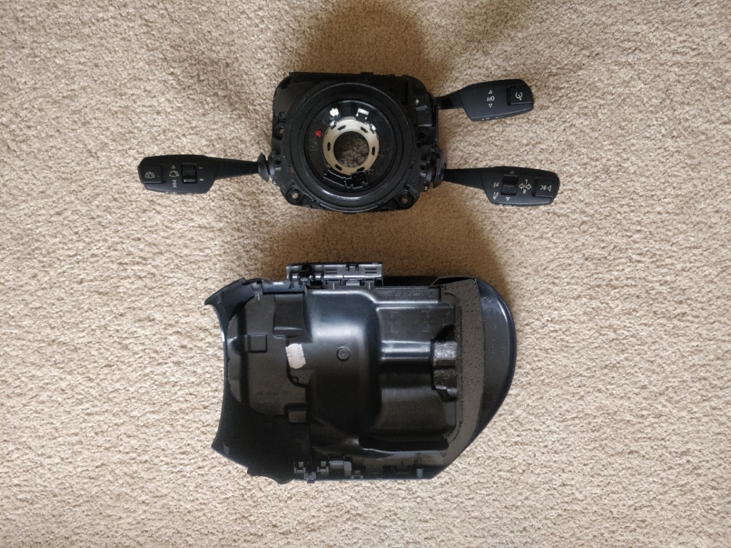

M3AN 4198 Report post Posted October 26, 2020 Much to my surprise, considering everything that could be an obstacle, was indeed an obstacle, I retrofitted cruise control today. I went in thinking I'd just double the 1 hour suggested time ... I ended up getting very little else done today! What could have gone wrong: Communications errors with modules Airbag took ~40 mins to unclip (the most retarded solution BMW could have imagined) All reinstalled and I'd failed to centre the slip ring, very lucky I was careful turning the wheel before I realised Take it all back off again to centre slip ring Coding instructions I had didn't match the software I had Unable to code to DSC module But in the end, after fighting with NCSExpert (mostly in German) and basically spamming every option I could find I brute-forced my way through. You need to code the vehicle option to the CAS module and then update the DCS module. The CAS completed successfully multiple times, the DSC not at all, Christmas tree dash (and 26 stored errors ?). Fortunately the calibration of the steering wheel angle sensor in ISTA was straight forward (I needed to do it twice, seems common) but still Christmas tree dash. After calibration I cleared the errors and only one left which was "DSC Module Coding Required" which I sort-of knew but the kick in that direction was motivating because I'd had so many failed updates to random modules earlier I assumed I'd royally screwed up a whole bunch of things. Back into NCSExpert and I just winged it really, selected DSC wherever I could and spammed CODIEREN on every screen possible. Once I'd exhausted my options I cleared the codes and started the car (with my eyes closed). Tada! Normal dash. I was still completely unconvinced it was working but took it for a drive and how about that, cruise control and no errors/codes/lights. It even comes up as an official retrofit in ISTA. It's a novelty for me really but it's done now (sorry @Driftit - but I did think of your request multiple times today when I was about to give up in despair). 3 Quote Share this post Link to post Share on other sites
NZ_InFerno 397 Report post Posted October 26, 2020 Wow, that sounds painful af. Not doing that to mine now ? Quote Share this post Link to post Share on other sites

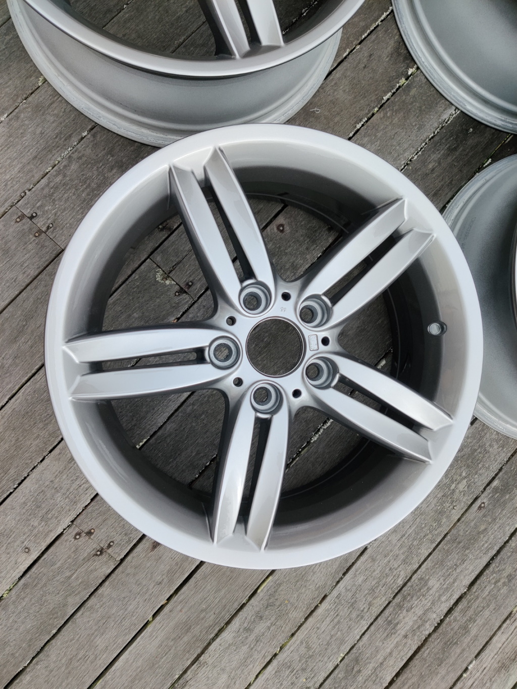

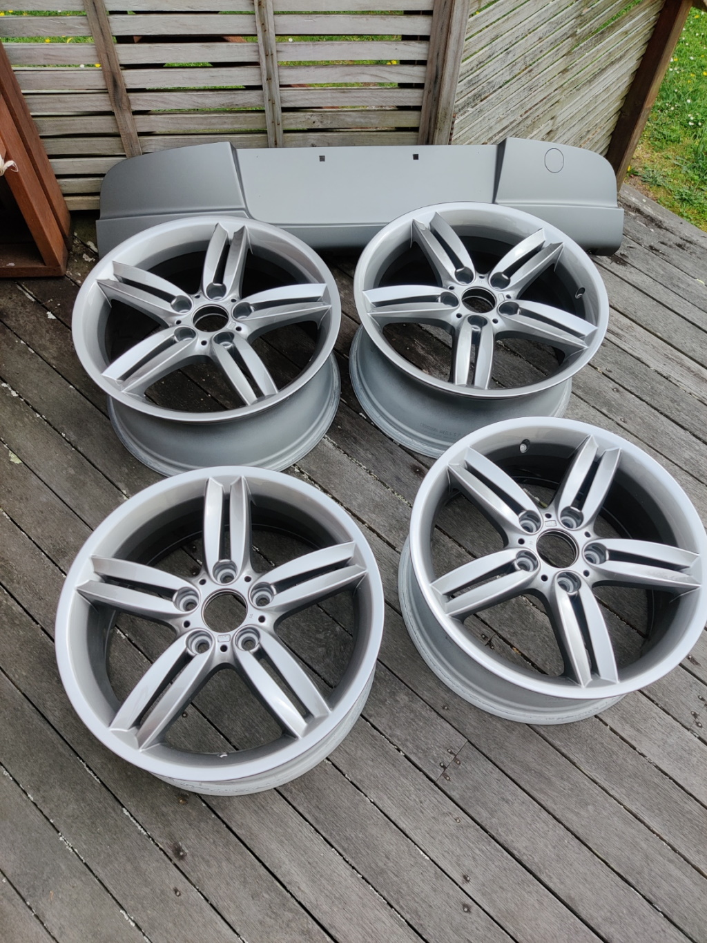

M3AN 4198 Report post Posted October 29, 2020 Wheels and rear diffuser freshly painted in Ferric Grey II by GT Refinishers, lovely. The diffuser change is very subtle, to the extent that it might not have been necessary, but it does 'pop' a lot more than the standard grey. Now on the hunt for tyres, I'm torn between sticking with what I know I like with Goodyear F1's or spending a little less on something different. Not a lot of natural light for the pics today. Oh, and I just realised I only have 3 of the little ///M badge stickers. ? 2 Quote Share this post Link to post Share on other sites
Jacko 2395 Report post Posted October 29, 2020 Re003s are sticky and cheap 2 Quote Share this post Link to post Share on other sites
NZ_InFerno 397 Report post Posted October 29, 2020 (edited) 21 minutes ago, Jacko said: Re003s are sticky and cheap +1 Didn't realise the diffuser popped out like that, makes it way easier to paint. Edited October 29, 2020 by NZ_InFerno Quote Share this post Link to post Share on other sites
M3AN 4198 Report post Posted October 30, 2020 2 hours ago, Jacko said: Re003s are sticky and cheap And buy one get one half price up until midnight tomorrow which makes them pretty sharp, better than anything quality Hyper has with their "40% off" BS. But Bridgestone's online store can't calculate correctly and it is quoting me $57 more than the sum of the costs. How hard is it to get a computer to add stuff up correctly? ? I see I can get F1's from Discount Tyres for the same price as the Bridgestones, and in my preferred directional(f)+asym(r) configuration. Decisions, decisions. Quote Share this post Link to post Share on other sites
qube 3570 Report post Posted October 30, 2020 the colour doesnt look right to me, is it due to the sunlight? definitely looks bright silver more than ferric grey? Quote Share this post Link to post Share on other sites
