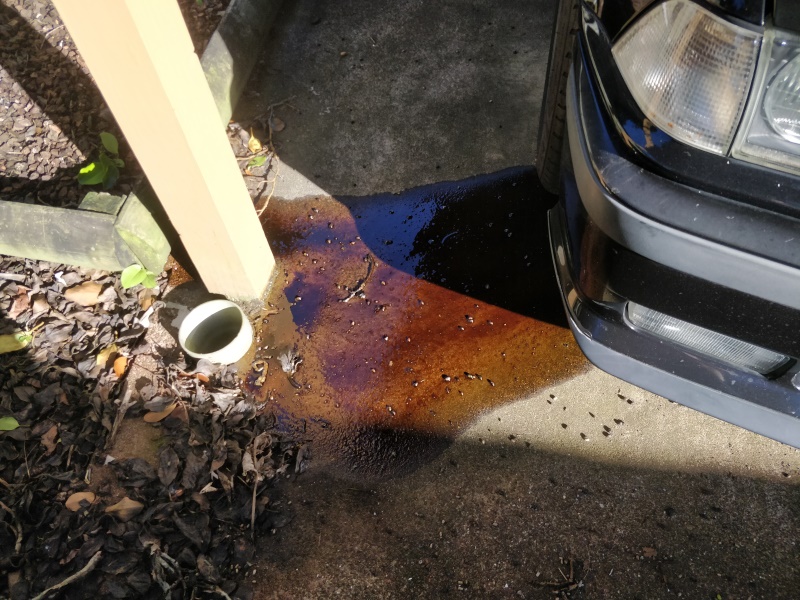

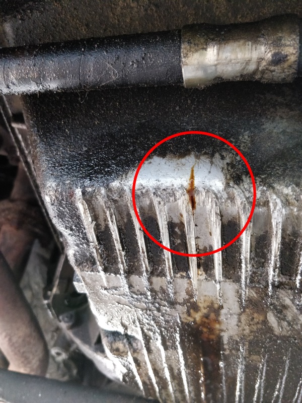

M3AN 4154 Report post Posted May 20, 2018 (edited) Discovered that the massive rock or brick I hit on the motorway in the dead of the night in the 328 did indeed do some damage... Sump is split... any tips? Replacement seems like a bitch. Edited May 20, 2018 by M3AN 1 Quote Share this post Link to post Share on other sites
Drea//Mer 30 Report post Posted May 20, 2018 1 hour ago, M3AN said: Sump is split... any tips? Replacement seems like a bitch How bad? i've had moderate success using permatex cold weld epoxy to temporarily patch a small sump crack (overtightened sump plug cracked along the bottom of the sump) Quote Share this post Link to post Share on other sites
B.M.W Ltd 951 Report post Posted May 20, 2018 (edited) Sump replacement on the E36 is only easy on a hoist with the right gear. Engine support and drop the cross member. Claim on your insurance and get a professional to do it. Edited May 20, 2018 by B.M.W Ltd 1 Quote Share this post Link to post Share on other sites

M3AN 4154 Report post Posted May 20, 2018 1 hour ago, Drea//Mer said: How bad? i've had moderate success using permatex cold weld epoxy to temporarily patch a small sump crack (overtightened sump plug cracked along the bottom of the sump) Not bad enough to dump all of the oil. I wasn't able to get get it up today so will do so tomorrow and have a closer look. I do have a stick of JB Weld... 1 hour ago, B.M.W Ltd said: Sump replacement on the E36 is only easy on a hoist with the right gear. Engine support and drop the cross member. Claim on your insurance and get a professional to do it. I'll call insurance tomorrow, IIRC I have a $500 excess and if that's the case I'm likely to attempt it myself, I do have access to an engine brace/support though. Quote Share this post Link to post Share on other sites
M3AN 4154 Report post Posted May 21, 2018 21 hours ago, Drea//Mer said: How bad? i've had moderate success using permatex cold weld epoxy to temporarily patch a small sump crack (overtightened sump plug cracked along the bottom of the sump) It's really small actually... I wonder what my options are? Quote Share this post Link to post Share on other sites
Drea//Mer 30 Report post Posted May 21, 2018 5 hours ago, M3AN said: It's really small actually... I wonder what my options are? Looks about the same size as the one i patched. First drain oil, i used an air compressor to blow all the oil out of the sump. Then i hit the area with a dremel to score the surface and give the epoxy something to adhere to, i grooved the crack line very slightly so it would fill and hold. Mix and apply epoxy; then to be extra sure it would hold i repeated the dremel step around and over the dry epoxy and put another layer of epoxy over it. Mine has held out for over 6 years now, no oil drips. 2 Quote Share this post Link to post Share on other sites

M3AN 4154 Report post Posted May 24, 2018 Got under the 328 today to start taking it apart to replace the sump. What a PITA job getting access, lots has to come out to drop the subframe and even then access to some of the oil pan bolts is difficult. Really very messy too! Got as far as I could without an engine support brace which I'm hoping to pick up on the weekend. Still can't work out if I need to re/move the power steering pump, there are conflicting opinions and some even go so far as to drain the fluid and disconnect the lines. The BMW official procedure doesn't require this but they lift the engine a couple of inches which I can't do. Let me know if you know for a fact what's required. 1 Quote Share this post Link to post Share on other sites

BMRBOI 8 Report post Posted May 24, 2018 12 hours ago, M3AN said: Got under the 328 today to start taking it apart to replace the sump. What a PITA job getting access, lots has to come out to drop the subframe and even then access to some of the oil pan bolts is difficult. Really very messy too! Got as far as I could without an engine support brace which I'm hoping to pick up on the weekend. Still can't work out if I need to re/move the power steering pump, there are conflicting opinions and some even go so far as to drain the fluid and disconnect the lines. The BMW official procedure doesn't require this but they lift the engine a couple of inches which I can't do. Let me know if you know for a fact what's required. Hi Dave, Ive done this on an M50 before, from memory: I used an engine crane. A combination of support brace and trolley jack may do it, Undo steering shaft coupler at rack end, There's a bracket on the power steering pump to sump which needs to be unbolted, Undo engine mount bolts into sub frame then sub frame bolts and lower down for clearance, Work your way around oil pan bolts (don't forget the two into the rear main seal cover), Not sure about the dipstick tube, believe there's a bolt half way up on the M50 but M52 uses a different dipstick tube (one bolt, some breather tubes and its pressed in with an o-ring). I didn't disconnect any lines for the power steering, however taking the power steering reservoir out of the bracket does help in getting the sub frame lower. Hopefully that's some help! 1 Quote Share this post Link to post Share on other sites
