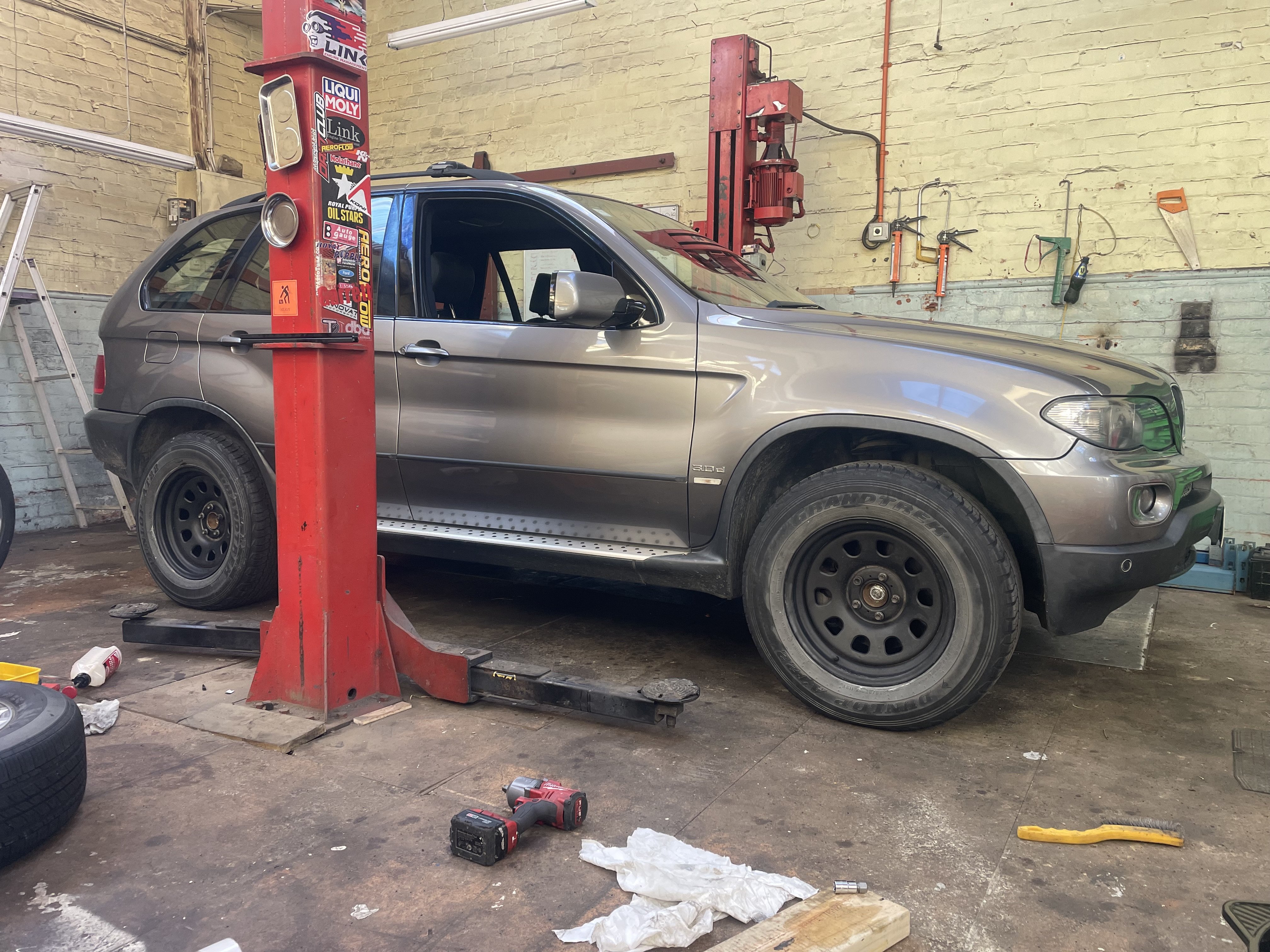

euroriffic 630 Report post Posted April 9 moved into a new “work” yard, so can now actually work on cars. Also has a hoist to top it off! Blew a radiator hose in the compact while helping to pick up cones after an autocross took m3 to have the computer looked at/studied on how to tune it for Alpha-N tune. Gathered more parts for e30 to one day start on Dropped trans pan on X5 to see what zip kit and seperator plate I need, have ordered those so can refresh valve body to stop the rough shifting, and cleaned out rear seatbelt collector that was jammed up for a wof and adjusted handbrake. 1 Quote Share this post Link to post Share on other sites
